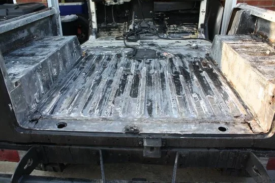

After peeling up my PO-applied bedliner I discovered a ton of rust. I plan on getting a new tub, but for now I just want to POR it, and lay down Durabak. I started sanding away at the paint that was under the bedliner and discovered the entire tub is covered in a fairly thin coat of bondo. Short of sandblasting, what's the best way to remove it? I'm a few hours deep into grinding it off with my 4.5in grinder but I'm going through pads like crazy.

Chemical paint remover with work on filler - especially if it's thin. Still a lot of work - just no dust - wear lots of protection whatever you do.

Torch it. That bed doesn't look to be in that bad of shape. Just a few patches here and there and it should bed fine.

X2, where you can get to the backside of the panel it works great. Don't need that much heat, torch, heat gun, etc, ~250-300F and a putty knife takes it right off, no dust. When done with a torch, from the bondo side, it can get smokey. :hillbilly:

2x on the wire wheel on an angle grinder. I stripped my whole cruiser with wire wheels. Don't use the wire cup ones though, they wear out much faster and throw wire everywhere.

What he said. A knotted cup brush for an angle grinder. That will do it. Cost: Less than $30. Check out a welding supply for something better than a Home Depot type. There is a difference. Pherd is a good brand.

I used a small tank of mapp gas & heated the bondo up, but not hot enough to warp any panels. As mentioned already, it just scrapes off quick & easy. Yes, it's gets smokey, so hook up a fan & blow the smoke away. You'll :eek: if you inhale any of it.
The PO of my 40 had put about 1/4-3/8" of bondo all around bolts holding down the tranny hump. I used an air chisel with a fairly sharp flat blade. Be sure to use eye protection as it flies off like broken glass. It came off in pieces as big as 4". Good luck. <>< :)
