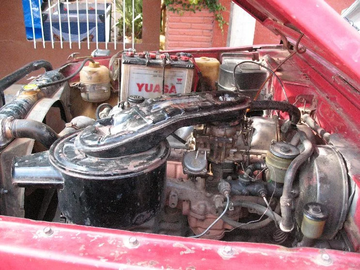

check out the air cleaner and the breather that looks like it goes to the valve cover
it must be a none US 2f air cleaner :cool:
