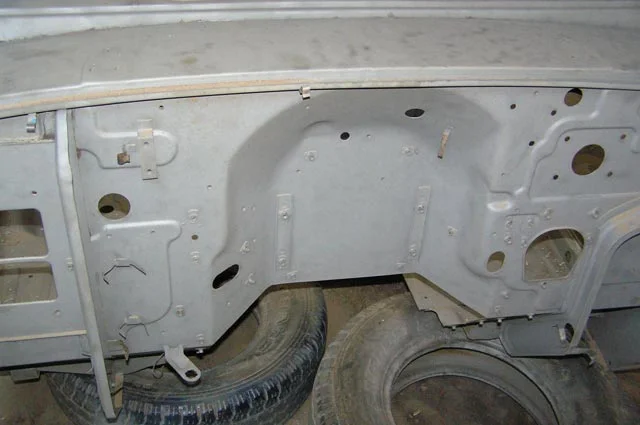

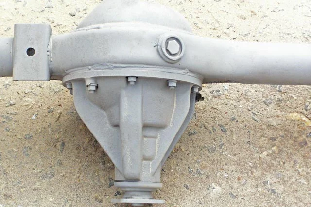

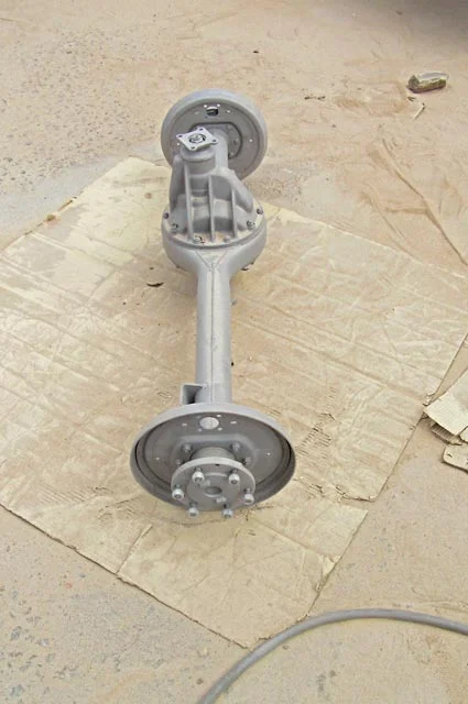

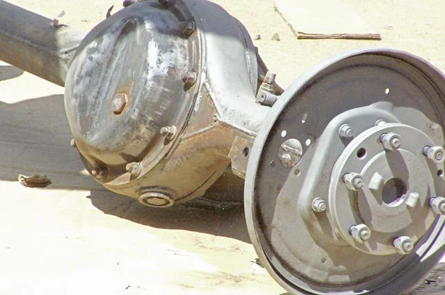

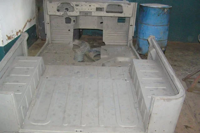

The blasting is coming along... Frame, tub and axles done, starting some of the other panels. Still have to break the spring packs apart... but it feels like real progress :)
A few flecks of blue still showing in a few spots on the tub, but those will be taken off.

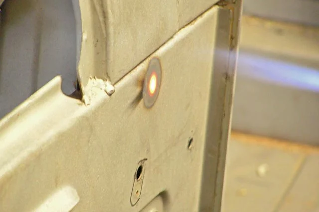

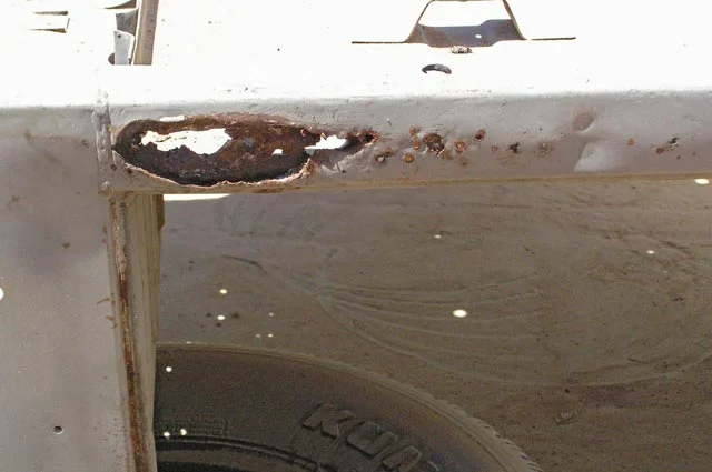

Rot. Well, after 30 years around the world, you can't expect pristine, right? ;)
These are the bad spots - the first one is the bottom of the left quarter under the tire carrier. We'll cut out the skin and see if the rot is on the piece underneath. Maybe we'll get lucky, maybe not. If needed, we'll cut and patch the curved end of the sill piece. The other pic is the usual rust out spot on the right section of the sill. Cut and patch and should be good. I really wanted to replace the entire sill, but couldn't ship a replacement through the diplomatic pouch mail (too big); air freight was about 2.5 times the cost of the replacement sill from CCOT. :frown: So, we'll repair rather than replace.

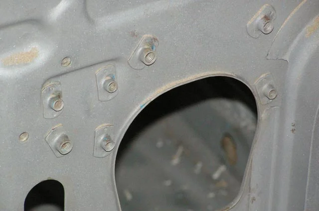

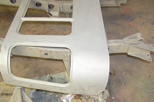

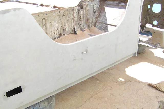

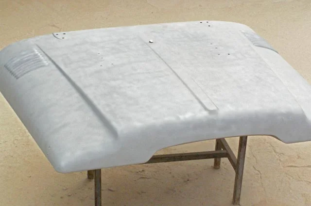

The blasting is moving along quite quickly now. These panels are lookin' GOOD :D

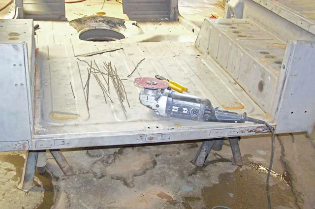

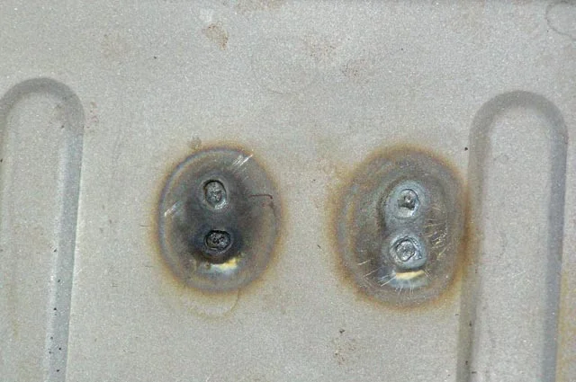

The welder started closing up some of the ummm "non-OEM" holes :o I have drilled in the tub over the years.
The tub will be the hardest part to do. That rust may be really bad, altho compared to some of the saved 40s I see here, my rust is hardly noticeable :lol:
That bit on the lower left needs to come off so we can see the state of the sill piece behind it. I expect to see real rust there. This is why I wanted to get a replacement sill. I think we'll be able to repair and clean it up, tho.

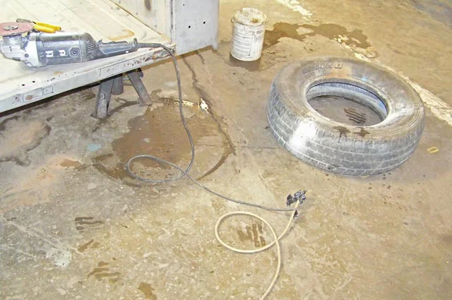

The grinder is just to show the shop actually has one. After all, I'm working with the best panel beater in Lilongwe. And how do you plug in the grinder without a plug? You just twist the wires together and wrap it with tape :hillbilly:

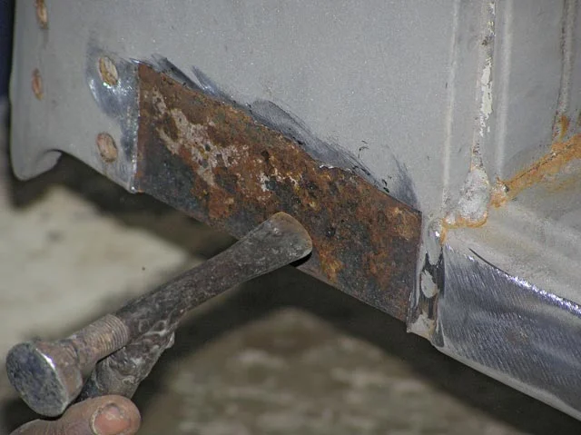

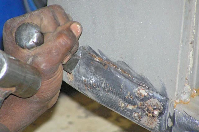

Time to cut that patch out so we can see what's under there...
How do you cut that sheet metal without doing violence to the piece underneath? With a cold chisel, of course :lol:
Sure enough - RUST :eek: Nothing that looks beyond repair, tho. We'll cut the lower sections off the quarter panels and save them to weld back after the sill piece is cleaned up. We'll also take the skin off the middle of the sill and save as much of that as possible. The sill piece will be scraped, blasted, patched as needed, while saving as much as possible. Then we'll treat it with RB and the sill skin with RB before the skin is welded back in place. The inner sides of the quarter panel pieces we cut off will also be treated with RB before welding back in. After the patching is done and everything ground down, it will be checked for pinholes, closed up as needed, then the entire tub will be lightly blasted again before shooting RB.
