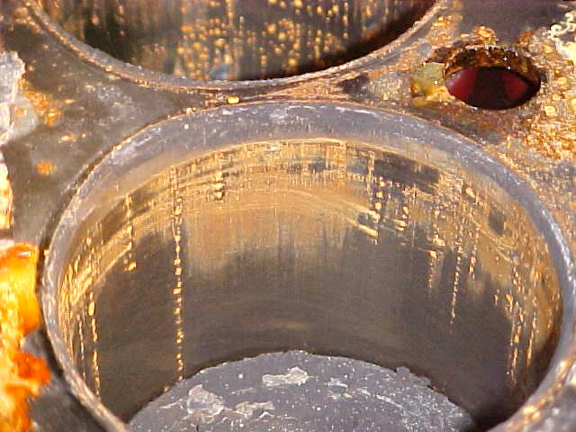

Opened up my engine last week & found the cause...no wonder compression for cyl#4 was <20psi...Also, can't really see it with the rust, but cyls 4 & 5 are scratched.
I was thinking a V8 conversion, but for lack of $$$, I think I just gonna try to rebuild my 2F.
What is the cheapest way to get the 2f rebuilt or should I just try to buy a used somewhere?

The cheapest rebuild is one that involves your labor. If you're able to tear it down and deliver the block to a machine shop, you might squeak by for $1500-$2000. If you want to do half the job, (new pistons and rings) it'd be less but then it'd be only half done. The more common fix is to find a used engine. It all depends on what your goal is.
Looks kinda rough Meatloaf. I would think about a used short block, and bolt all my goodies to it. An entire used motor is gonna cost less than a rebuild.
M
haven't seen something like that since my rod went through the cylinder head of my YZ racing bike years ago.

So what does that to the pistons? Lean running from a manifold leak? Detonation?

motor had 176,000 miles on it...
