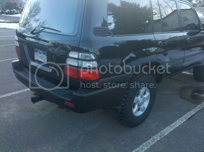

Grille, rear emblems, side trim, and rear bumper. I don't have any good pics right now, let me see if I can't grab one before it gets too dark.
Pardon the bad angles and crappy cell phone pics. There wasn't much room to stand in the front due to the snow and shubbery (Nee!).
Grille:
Rear and sides:
Emblems:
Side view:
Nice look, Fuzz. You were able to leave everything on when you sprayed the p-dip, right? maybe you have a thread on this p-dip mod that I should read?
Search for a thread called "plastidip wheels", I think thats the one where it was most recently discussed.
I didn't pull anything off, just gave it a quick wipe down w/ simple green, masked off the area around it, and sprayed. I didn't sand anything either. I could peel it off and return the truck to stock appearance in a matter of a few minutes (edit: I made the mistake of sanding and painting the grille w/ regular black krylon and hated the way it turned out, so I covered it with p-dip and it looks 10x better - the grille is permanently blackened as a result though).
In retrospect, I'd use isopropyl alcohol instead of SG as it would probably evaporate more completely...but I haven't experienced any adhesion issues so far. The stuff is actually pretty tough once it dries.

Thanks for the compliments. I'm very happy with it compared to the OEM gray...but like Pint's truck, it's black but looks gray-ish in certain light. Contrasts nicely with the OEM gloss black paint, and matches all of my matte black vinyl stuff perfectly.
Alot less prep work than paint though, and it's almost impossible to screw up. Even if you spray it on so thick that it runs, it evens itself out really well as it dries. If you do manage to goober it up...just peel it off and start over! :D

The finish isn't smooth like paint and holds dirt a little more easily, but overall it cleans pretty well. Dirt likes to collect on the step area of the rear bumper, but that was true with the OEM paint too. It's just a little more visible now when dirty. Not a big deal IMO, these things look better dirty...especially the black ones. :D

JB- Rig looks great. I hate to be the only one here with negatives. But IMO the black on the tail lights are a bit much. Never been a fan of that type of stuff. Maybe it's the photo's.

I know the blacked out trim on the lights isn't for everyone, but personally I think it looks awesome...but then again, my truck is black so I'm all about adding more black to it, heh. I sort of did it on a whim when I was taking the orange stuff out of the lights, and I was happy with the outcome. Thanks for the compliments. Still has a long way to go though. Needs more lift! (and sliders, and a rear bumper, and drawers, and...yeah)
