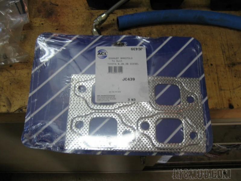

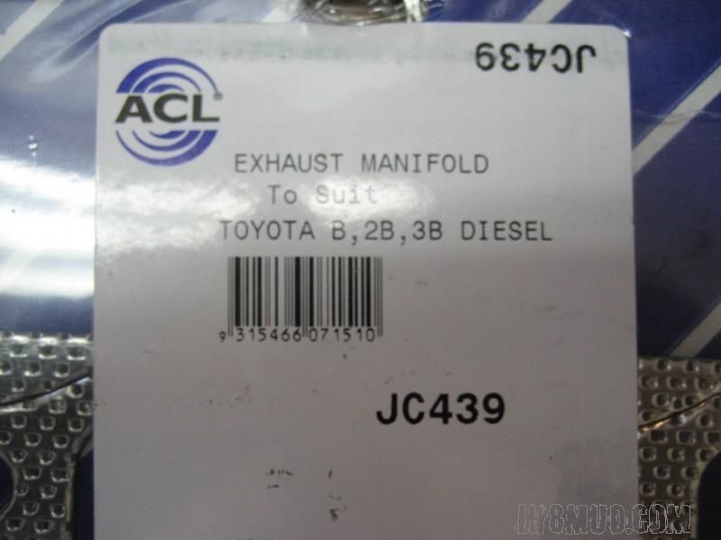

Do you have both a head gasket leak AND an exhaust gasket leak?
For the exhaust gasket leak - If you mean "exhaust manifold gasket" then the toyota part number is 17173-56022 (which fits B and 3B engines fitted to BJ4#). Or you can go aftermarket with stuff like this:
(Above photos supplied by eleblanc/eric)

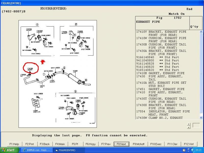

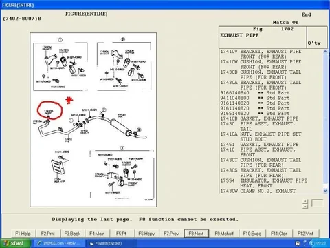

But if you mean the "exhaust-manifold to exhaust-pipe gasket" (commonly referred to as the "doughnut gasket") then the toyota part number is 90917-06047:
But this "doughnut gasket" is a common generic part and should be readily available at any good autoparts retailer at a fraction of the Toyota cost.
