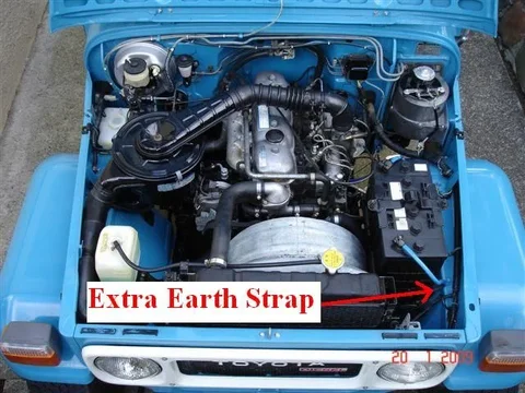

Hi Albert.
Here's my OEM strap between my motor and frame:
And here is an extra strap that I ran from where my OEM battery-earth-strap attaches to my guard. (The other end connects to a bolt on my timing cover.) .... And adding this extra earthing-lead DEFINITELY increased my cranking RPM to make starting easier.
:cheers:
As usual, Tom comes to the rescue with some great images:cheers:
That is exactly where my engine to chassis earth is too. Though it was all gunked up, the connection between the engine and start of the strap, and the end of the strap and the chassis, via the multimeter were fine- it was in the middle of the strap were there was problems- even though after cutting it apart I could not even see any damage to the copper strands?
I could not find a strap of the same dimensions that day so I have a slightly longer one now that just loops a little bit.
Cleaned all the surfaces and bolts back to clean metal and bolted it up- sweet!
Thanks again guys. I checked this morning and I do have that ground strap in the same location near the filter. It does not look in great shape and I will take some time this weekend to clean and replace if necessary. I had a questions regarding the strap, is it best to use a woven strap or can I use a stranded copper wire similar to the battery cables?
BTW Tom your BJ is amazing as always. I can't ever imagine how to get to where you are with your but it is definitely something to aspire to.

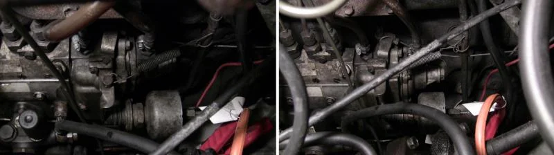

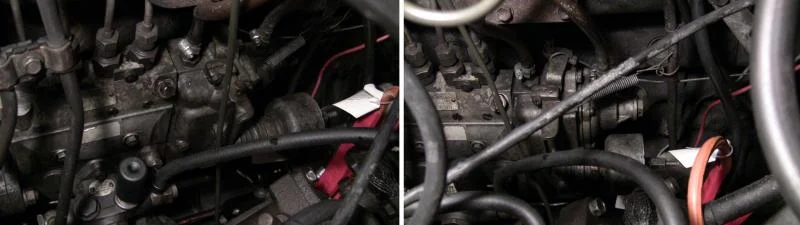

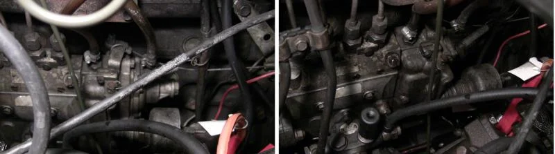

Can u take a photo of your injector pump (including the area rearwards of it) so we can see what exactly you have got?

Regarding the IP. I had posted pictures of the make-shift spring put onto the back side of the pump in a separate post. Was hoping to correct that fix that must have been made in El Salvador (where the vehicle came from)

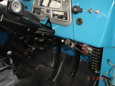

And your photos provide me with another possibility/idea for your engine not firing up. .........Could it be that the arm on your injector pump is in the wrong position while you're cranking?
I say this because that "cable-operated set-up" looks rather inprecise! (Do you know where the "starting/overinject", "run" and "stop" positions for that arm are? And if so, how does that cable set-up accurately locate the lever in each of them?

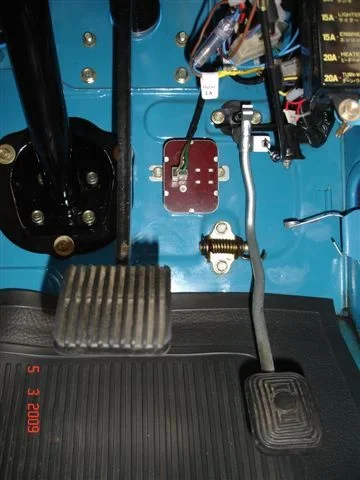

Not having an EDIC, what do you have to set the start/run/stop position for the fuel? I realy can't figure out too much from your photos.
I don't have an EDIC and just have a simple choke cable set up thing ('manual edic')- as far as I can tell, I only have two positions (and the variety of positions inbetween), run and stop. I don't think mine has the overinject position for starting, though I have no problems starting.

Mine is a similar setup except it looks like the armature has two sides a push and pull. On the far side it is connected to the cable that turns the engine off. On the near side, a spring that maintains some tension. Also, the choke cable with the knob located under the steering wheel is broken off. Does it tie in here or the butteryfly valve? Should I be using choke when starting her up? I have not messed with it and did not figure it could be causing the problem with starting. When I push or pull the armature it does not seem to have a set poistion, just remains where it is due to the spring tenshion. How do I know if it is in the wrong position or if could be causing a problem? What is the best position for startup?
Thanks for the extra input guys. Keep it coming :)
I downloaded the high resolution video version and my opinion of the squeal is that it is "normal" starter motor sound.
That "choke" (as you call it Albert) is normally simply connected to your accelerator pedal and is really a "hand throttle". So pulling it out has exactly the same effect as putting your foot on the accelerator. Here are pictures of mine:
The accelerator pedal in turn operates the butterfly valve on the intake manifold. (Foot off = almost-closed butterfly ........Foot hard down = butterfly wide-open)
The internal springs inside your injector pump should indeed keep the "rack" in the "run" position (where it is further controlled by vacuum acting on the leather diaphragm) and from what most people say, your engine should still start easily in this position (without the need to push the lever into the overinject/start position for extra fuel).
If there are any doubts about whether your injector pump is indeed supply fuel for starting - that is another good reason why "cracking the nuts on the injectors while cranking" is desirable. Not only will it get rid of any trapped air there - but fuel squirting out will confirm that your injector pump is indeed delivering fuel.
PS. I don't touch the accelerator pedal on mine (while starting) until I hear it fire up. Then I use the pedal to hold it at a fast idle.

Tom, thanks again. Your vehicle is awesome to look at! Reading this post I realized I actually knew where the choke cable was connected and must have experienced a brain fart when writing. I'll have to find a new one when I get a chance. BTW, when starting the vehicle, I have been keeping the pedal to the floor as stated in the manual. I had good success with this method when the vehicle was running last year. Does the clutch really need to be depressed as noted below?
