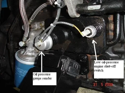

I just searched my EPC using my BJ40 VIN details and it shows the same "bolt" in place of my "cut-out/shut-off switch". Yet my cruiser is definitely "standard" for this part of the world in having that cut-out switch. :frown:
I think this shows yet again that the EPC is not "gospel". (The EPC is correct for your vehicle but not mine.)
But I seem to remember you don't have any EDIC (electric diesel injection control) either - And the cut-out switch is there on my vehicle to work with my EDIC. So I guess this tells us there were "with EDIC" and "without EDIC" versions of the BJ40 produced by Toyota in 1979. And in this respect - our engines are different. (I have seen quite a few references to "without EDIC versions" before but have never seen one "in the flesh".)
And it looks like the same wiring loom may have been used for "with EDIC" and "without EDIC" versions which would explain the disused connectors/wires on "without EDIC" versions. (In different threads we established that the same loom is used for 12V and 24V versions so this is not really surprising I guess.)
My oil cooler:

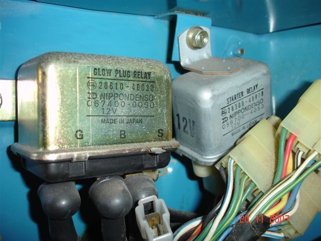

Oh - One more thing. If that relay on your firewall is indeed your "starter relay" then it is an aftermarket one I think. Here is a photo of my starter relay on my 1979 BJ40 where it sits in the passenger footwell area behind that big plastic rectangular air duct (by the way - mine's a RH drive vehicle):
I suspect, from the thickness of the wiring on your firewall-mounted one, that it is more likely to be an aftermarket relay for something else - like the glow plugs perhaps.
