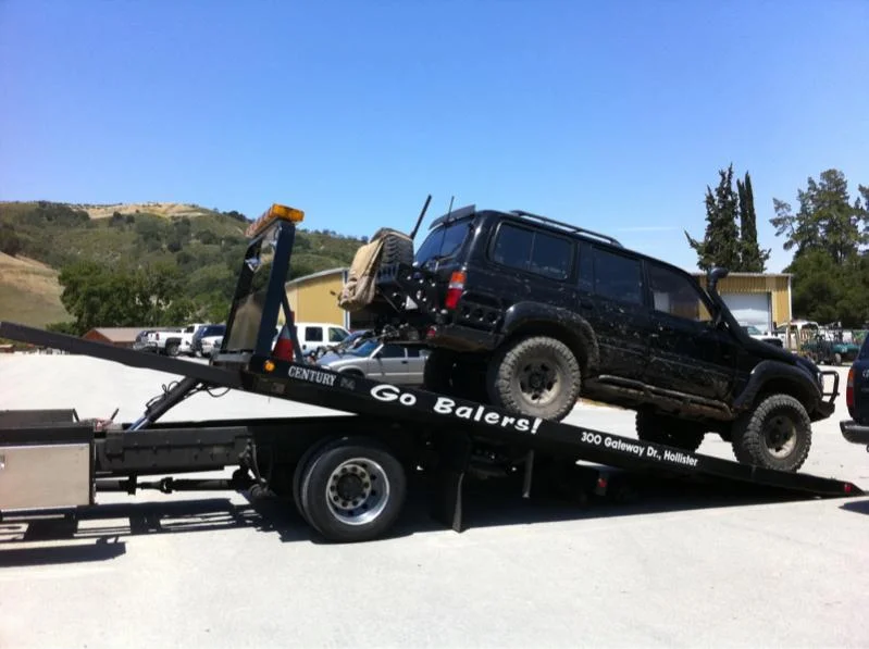

So does this look bad lol? Anyhow, can this be fixed or should I start looking for another axle? Don't ask
Me how this happened just tell
Me if this can be salvaged or not. Theres also a ring inside the axle tube that became dislodged. Hopefully you can see this in the picture.

Bummer, sad to see an 80 on a flat bed.
You will have to remove the 3rd member to relocate the metal shield (what you called a ring). Sadly it is ridiculously easy to do after the 3rd is out.
It looks like a quick grind with a dremel tool will clean up the housing around the seal area. You might want to put some rtv around the outside of the seal if there are groves left in the housing. The same goes for the trunnion bearing area (minus any rtv).
I've also seen how the metal shield can be repositioned from the birf side of the axle tube.
This happened to Semlin (ring became dislodged) and he invented a tool to slide into the ring and then pulled into position and used to pull the ring back onto to the axle tube.
hard to describe the tool exactly but it's been done before. i think it lasted a few years anyway.
X2, cleanup any burrs, seal it up, install a new birf, good to go. That housing is cherry, I have used them much more torn up than that!:hillbilly:

Been there done that. My axle housing had the same gouges. Knocked them down with a dremel and all is well. Why the flat bed? Why not remove the front shaft, remove the drive flanges and drive it home? I drove mine 150+ miles home like that and then for another month around town waiting on a replacement birf.
You did not need the flat bed. You could of easily drove it home.
