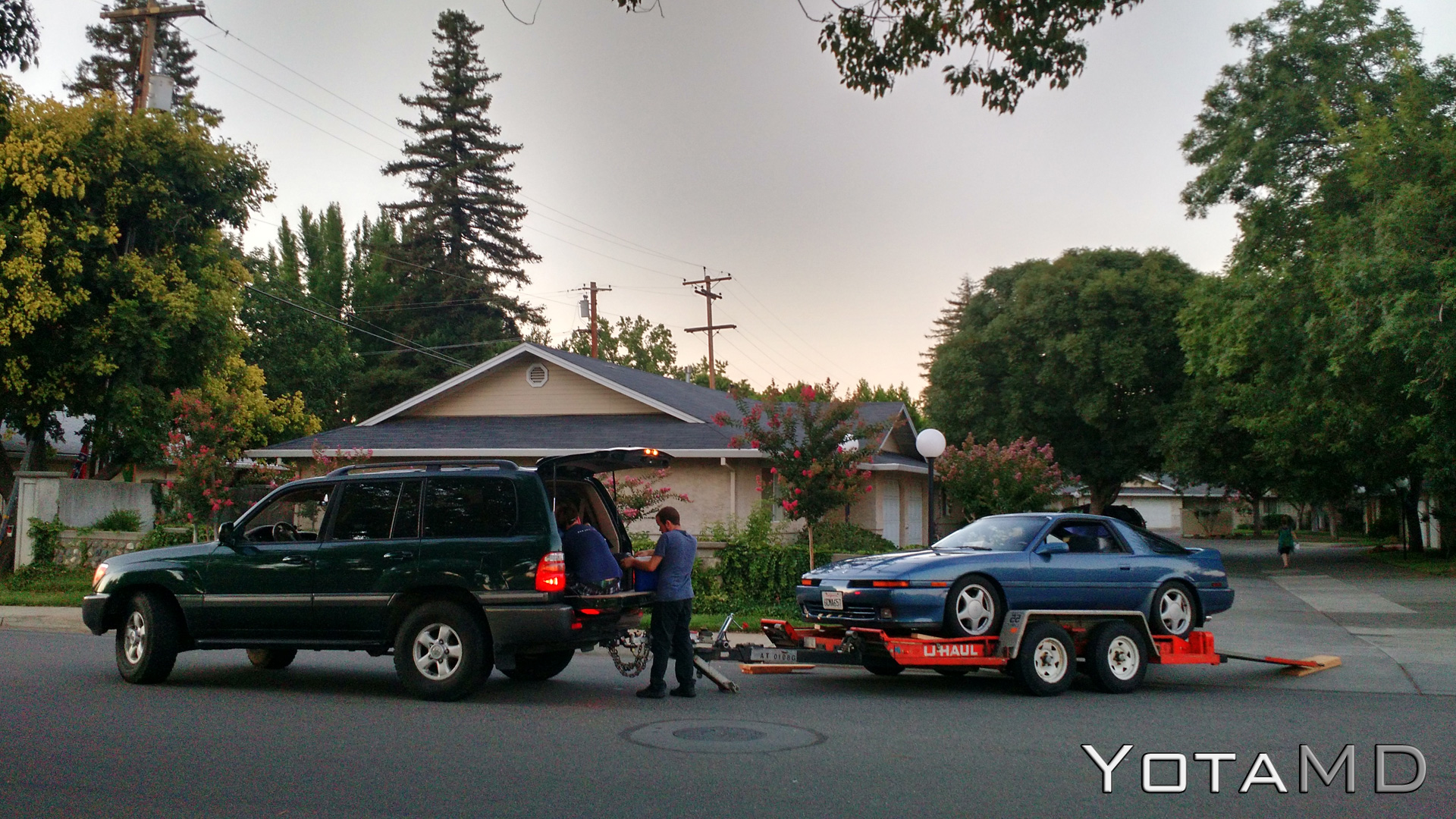

Pics of Supra please, make me regret selling mine.
Gladly!
