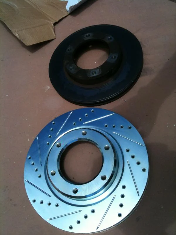

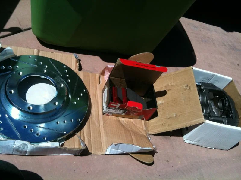

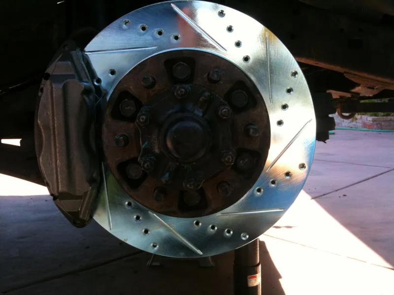

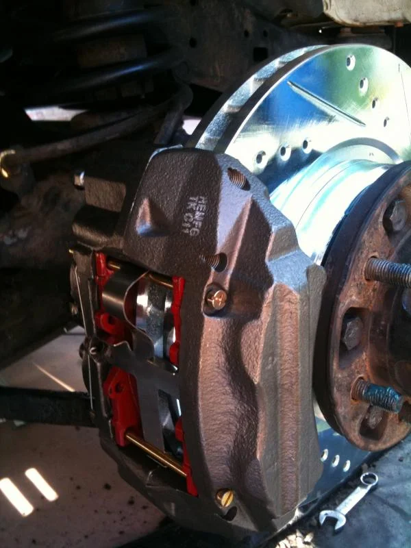

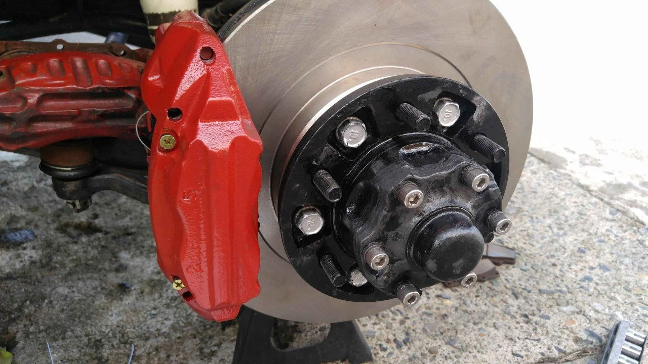

well first of all, thank you to the mud members who figured out how to do this setup. it took me about 3 1/2 hours buy my self with a six pack. the setup is a 91 fj80 with 95 fzj80 rotors and calipers, and 98 TRD brake pads. ( btw stock rotor sheild/air dam wont work with new rotors).
here's some pictures
Nice setup. Please report back on the performance of the slotted drilled rotors and their longevity. What brand did you go with?

Very nice, I am actually sourcing parts for this myself. I also picked up a FF rear so I can go to discs all around. With regards to the backing plates, did you just trim off the shield and reuse the center section of the backing plate?

Did they accept your FJ calipers as cores for the FZJ ones? I found some cheap FZJ calipers to trade in, just in case.

i removed the heat shield because the rotor was to big, guess i'll leave it like that for a while. and all fzj models have same rotor sizes but you can fit 100 series pads if you take the noise cancel plate off.
on a side note the fj vs. fzj brake lines dont match btw (the end bits)!!

There is also grinding down on the caliper a tad bit which others have done.

I got my remans from NAPA. not too bad if you have cores to swap. I have heard that you can put your calipers in the box and take them back to get your cores. I had some FZJ calipers that I had planned to rebuild, but they were too far gone so I just took them in for the remans.

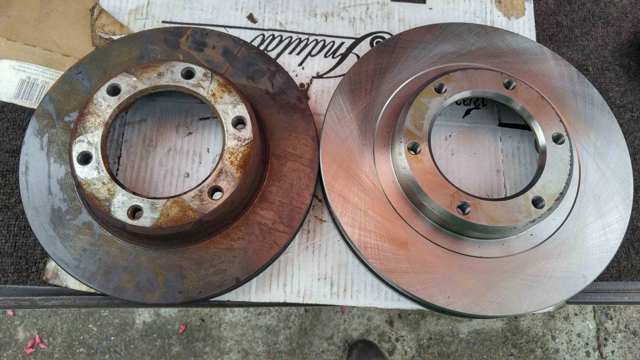

Out with the old, in with the new. From 92 OEM to 93, however I have another 92 with 92 OEM brakes that performs better.
