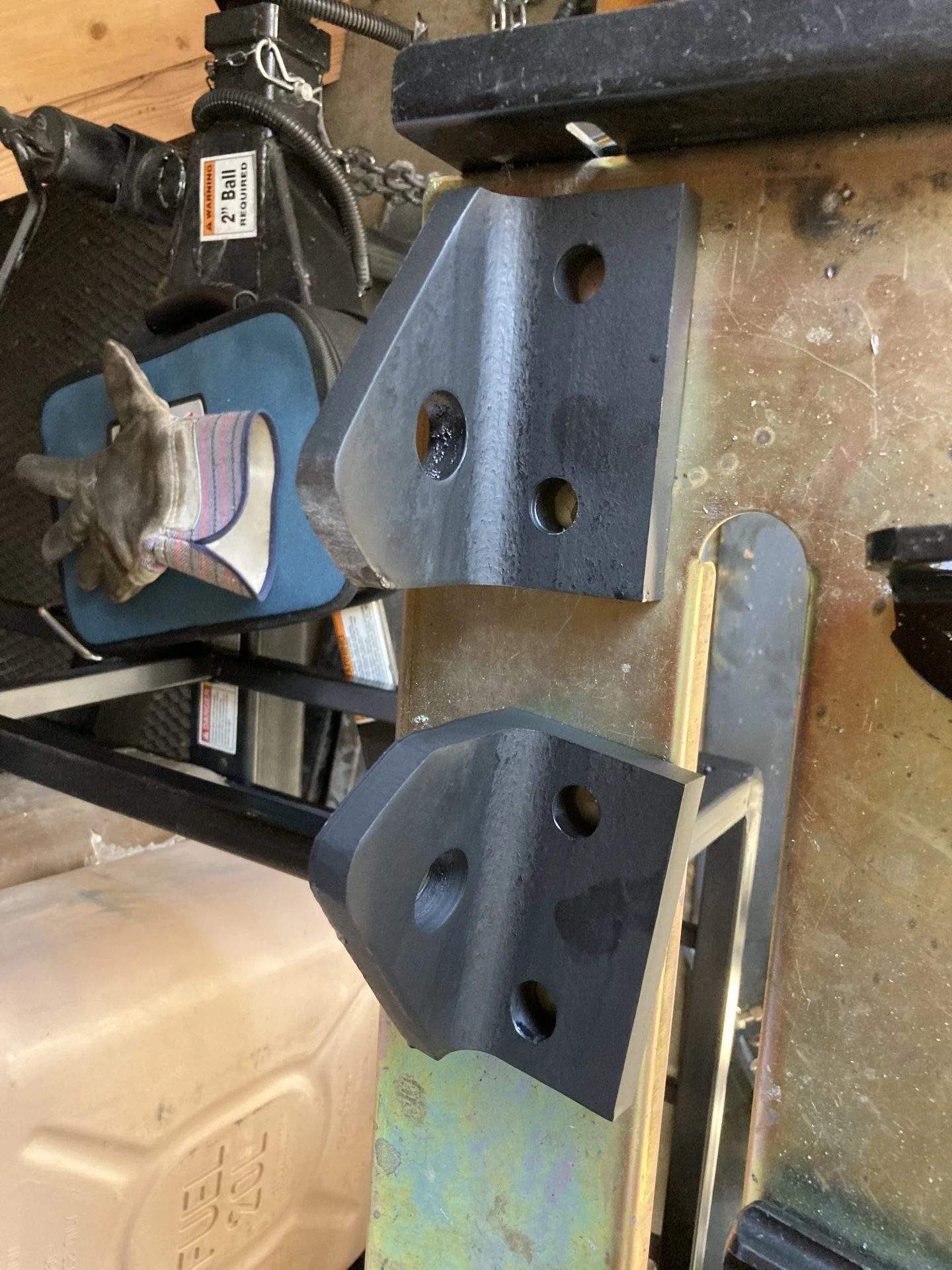

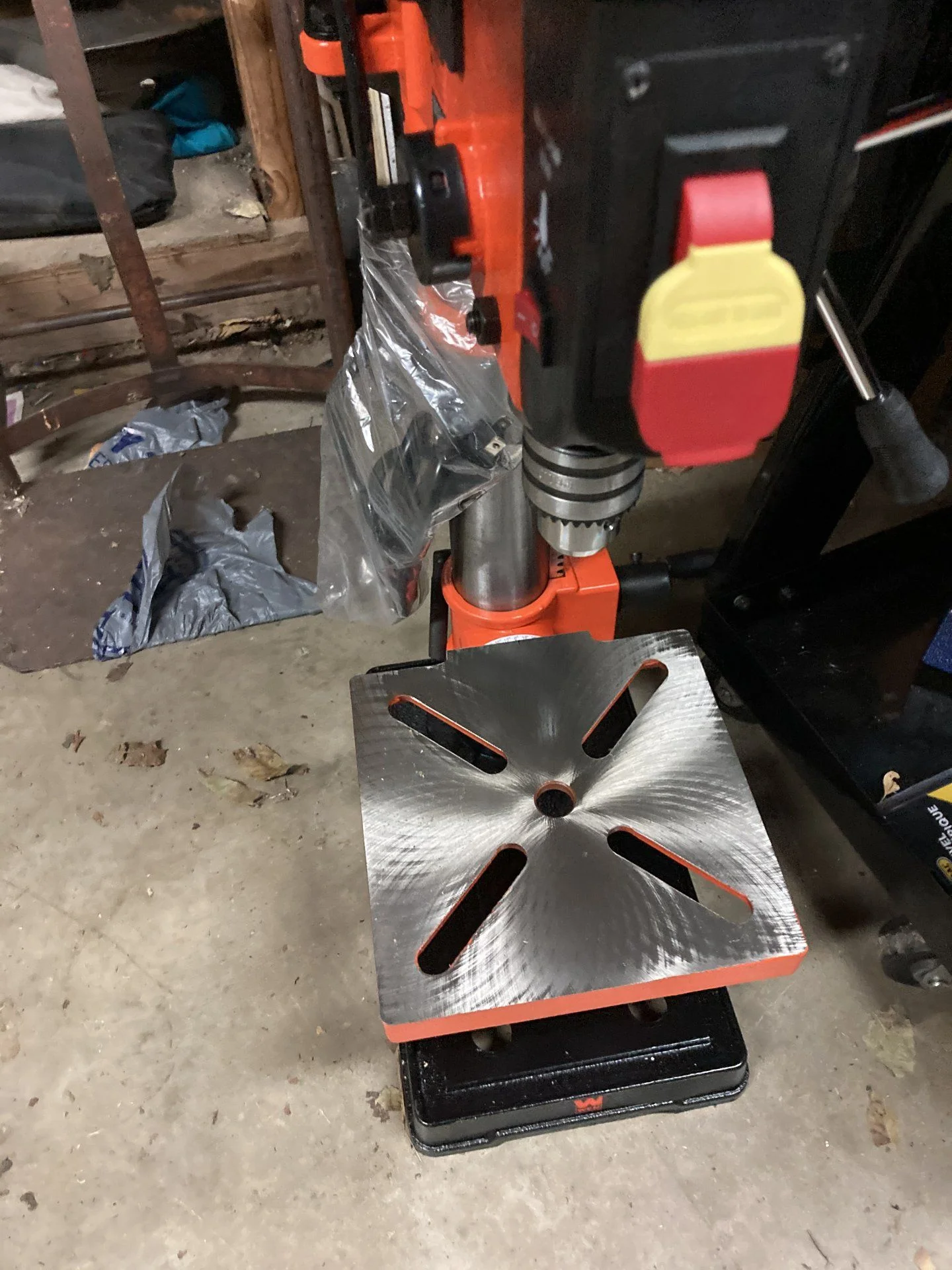

Now that I have figured out how to cut these tow hooks out I need to try out my new hole saw. I realized my hand drill would probably not be the best so I figured I would get a drill press and a vise. Now I have been told to use some type of wood on the top of the plate here. How do I do that? I tried youtube but can't find what I am looking for. It seems I would have to trace this pattern onto a piece of wood and cutout with a jigsaw? Any ideas would be great, I do want to be able to use and move the vise.
Looks like you got an entry level drill press. Those usually don't run very slow. Check if the lowest speed is low enough for the holesaw you plan to use so that you don't burn it up in no time. And use plenty of cutting oil.
Not sure what you mean about needing a wood piece that will follow the (table?) pattern. It is a good idea to have a sacrificial wooden board under the vise if you think you may hit the table with the holesaw if it is bigger than the center hole in the table or off-center. But that's not really necessary if your piece is held in the vise and you are careful or use the stop to prevent the holesaw from going too low. (Do check that the empty space in the vise under the workpiece is bigger than the holesaw, though, and center the hole over that.) And don't think you have to tighten the vise down. On the contrary, in most cases you want it to be able to move freely so that the bit centers itself in the centerpunched divot you use to locate the hole. It is however, a good idea to have some sort of stop to prevent it from spinning if the bit were to catch. Your vise is pretty big for the table, though, looks like half of it will be sticking out, that's not so great.
The 7/8” hole saw was slow going but I got them drilled. I ended up using c clamps to hold the vise on the base. The nuts would not hold it in the correct spot
@TXSunDevil , time n patience is your friend. i'm seconding what was said about drill speed. keep in mind, the larger the hole diameter, the slower the drill speed n keep it lubed/cooled. pcs are looking respectable, nothing to be ashamed of

Thanks, I set the saw on the lowest speed and used cutting oil. I have realized exact repeatable cuts will probably not happen in my garage so I will just fill when needed. This is a process and I am on step 1
