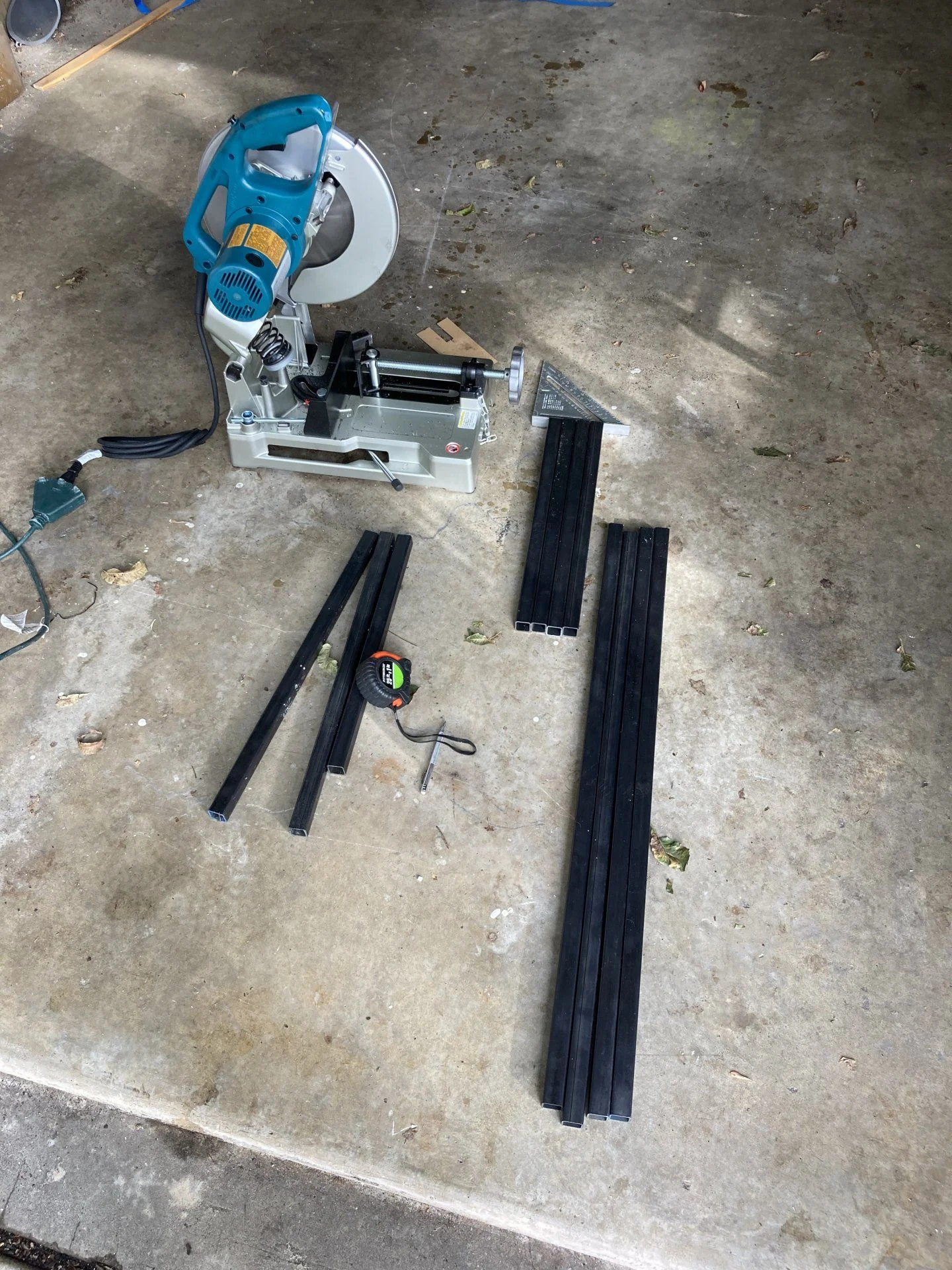

Got to play a bit today. The new saw definitely cut angles better.
Now the problem is getting the EXACT same length. Still very difficult for me. I seem to be within a 1/16"

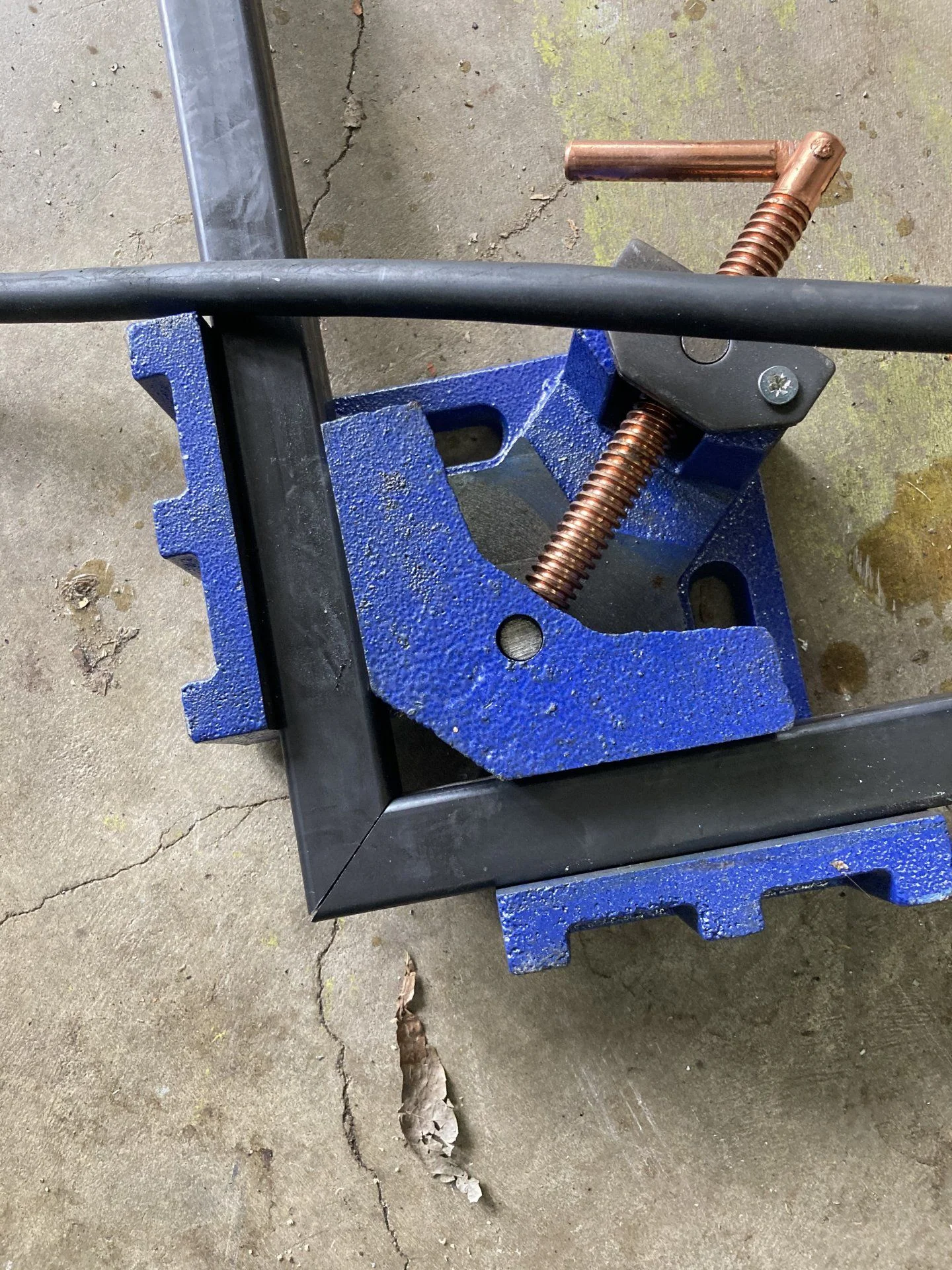

I bought this tool to help with the corners. This coupled with the new saw really produced a good corner.

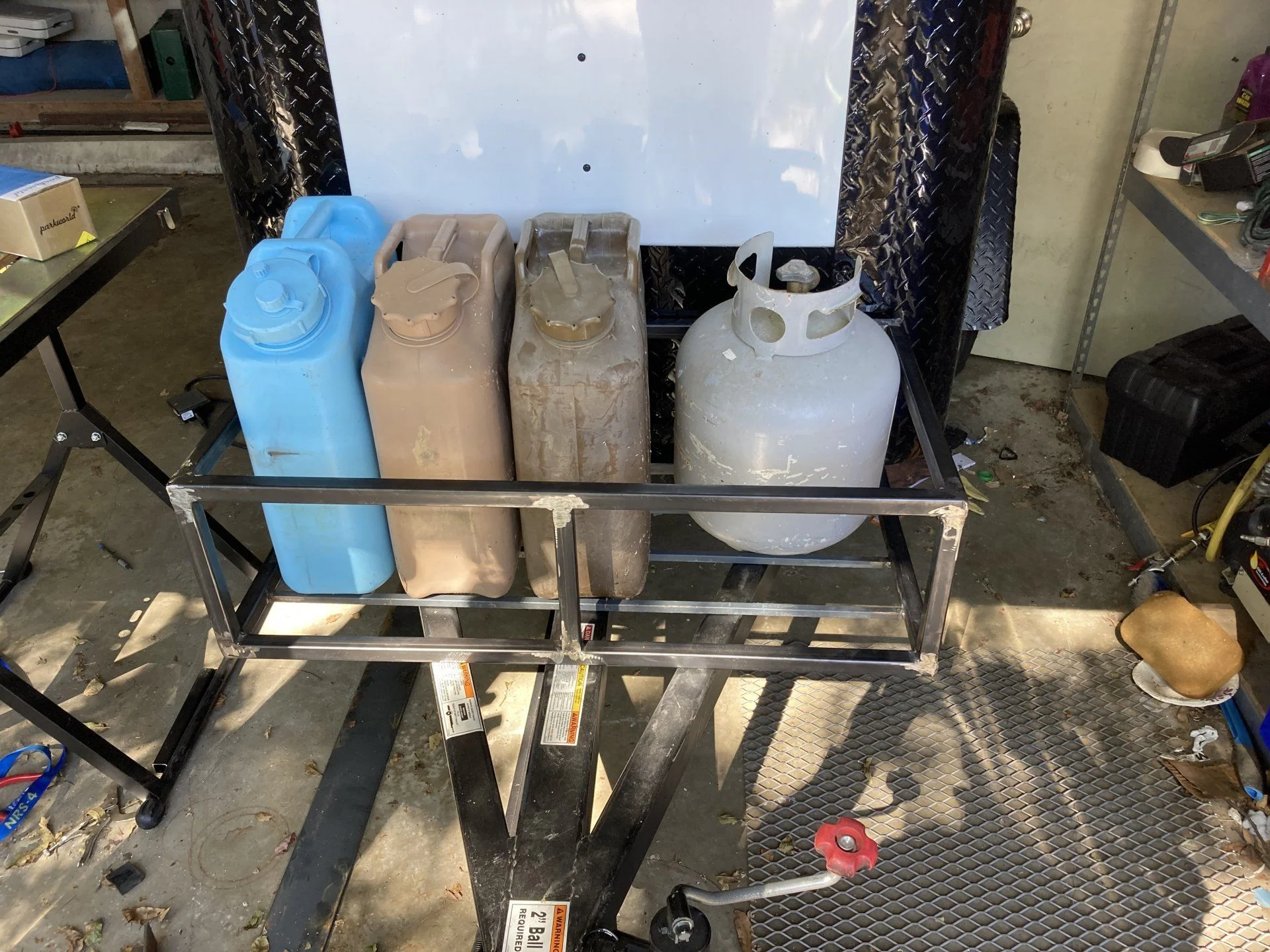

A new saw, new corner clamp, $20 worth of steel and a drive across town, plus most of the days labor to build something I could have bought at Harbor Freight for $35 with a coupon. ;)

If you want exact same length, use a stop maybe?

I have a heavily used ~25 year old HF band saw that I got used. This one, but green and a whole lot less shiny: 1 HP 4 in. x 6 in. Horizontal/Vertical Metal Cutting Band Saw I've found that the PO was correct in his observation that if it is cutting crooked when the cutting tension is set correctly that the blade is tired and needs to be replaced. Buying quality blades is crucial to the saw working correctly. You'll never get anything but crap cuts from an HF saw blade. I buy name brand blades from MSC and get good life out of them even when I do abuse them with odd cuts.
About the only part that really sucks on these saws is the stand. The Garage Journal forum has a thread (likely more than one now) on building a nice & sturdy stand for one. One of my 'round tuits.
I lay out miter cuts with a Starret Tri-Square. A quality one of these is a very good purchase. Mine was found used at the Saugus Swap Meet at one of those guys with a bunch of usually junk used tools for sale. Blade against the fixed jaw and the slide against the blade itself, side of the slide laid flat on the saw's bed.
By laying the first unit cut on top of the next one about to be cut and feeling how the ends match up I get really close to the same length. I make a point of keeping track of the first one and use it only for setting up all of the next ones to be cut.

My HF saw is an old green one too. I make a point of keeping the space between the blade runners as short as possible. It cuts plenty accurate for anything that will be welded. In fact, I can cut a sliver of material without the blade deflecting. Of course, it has to be tight for that.
But realistically, the fit would have to be inordinately bad for welding not to be able to take care of the gap with corners like the above. In practical terms, I think that any of the tools discussed here would be able to do a good enough job with reasonable care. A welder and a grinder: the big forgiver! :)
Really depends on the welding process. the fit shown above is on the bottom end of acceptable for GTAW, but more than acceptable for GMAW (MIG wire comes on a spool for a reason :) )

Welding 45 degree mitered corners can be problematic because of uneven heating on the inside and outside edges. The inside typically heats more and therefore shrinks more so that the finished product will be a couple of degrees less than 90. No amount of clamping is going to change this outcome.
It is better to put a square notch in one tube end by cutting along the inside of one side for the width of the tube and then cutting out a square notch. The left over flap covers the open end of the other tube. It is a little more welding, but the joint tends to stay square After welding.
I do also remember seeing a vid on YT from a reputable channel about how to weld rectangular frames to minimize distortion by going back and forth etc.
