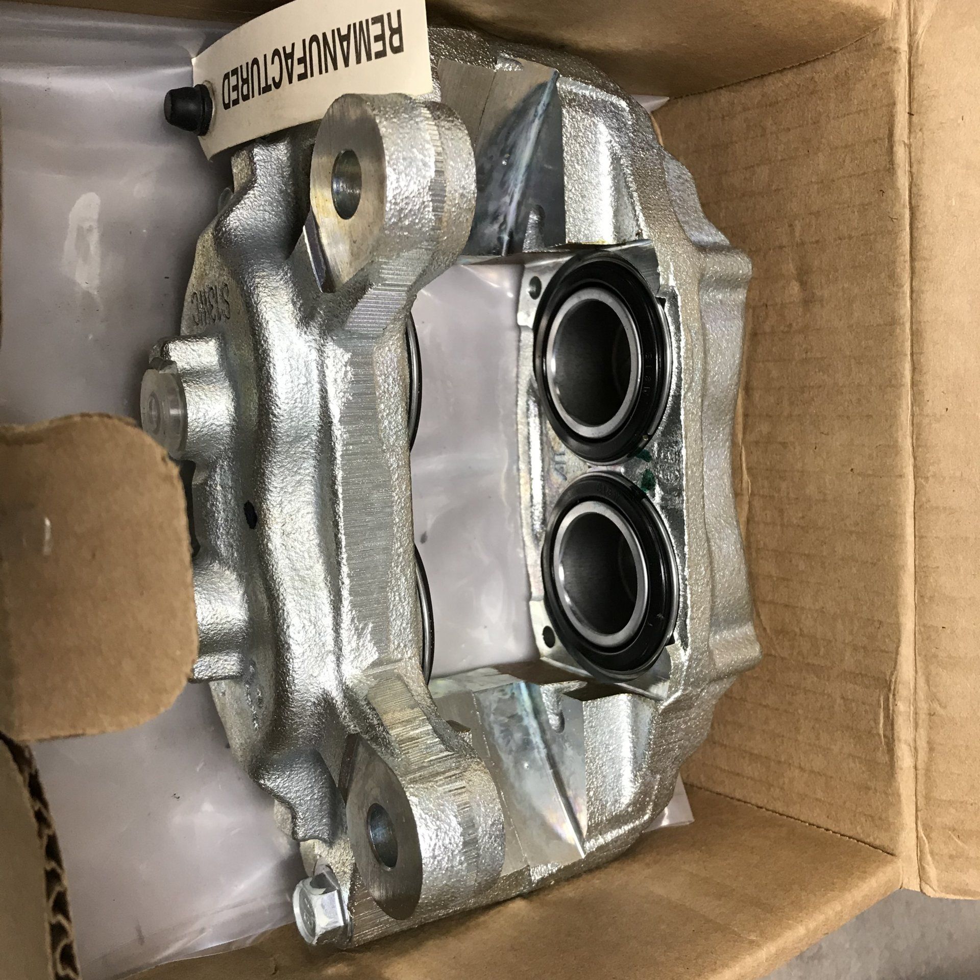

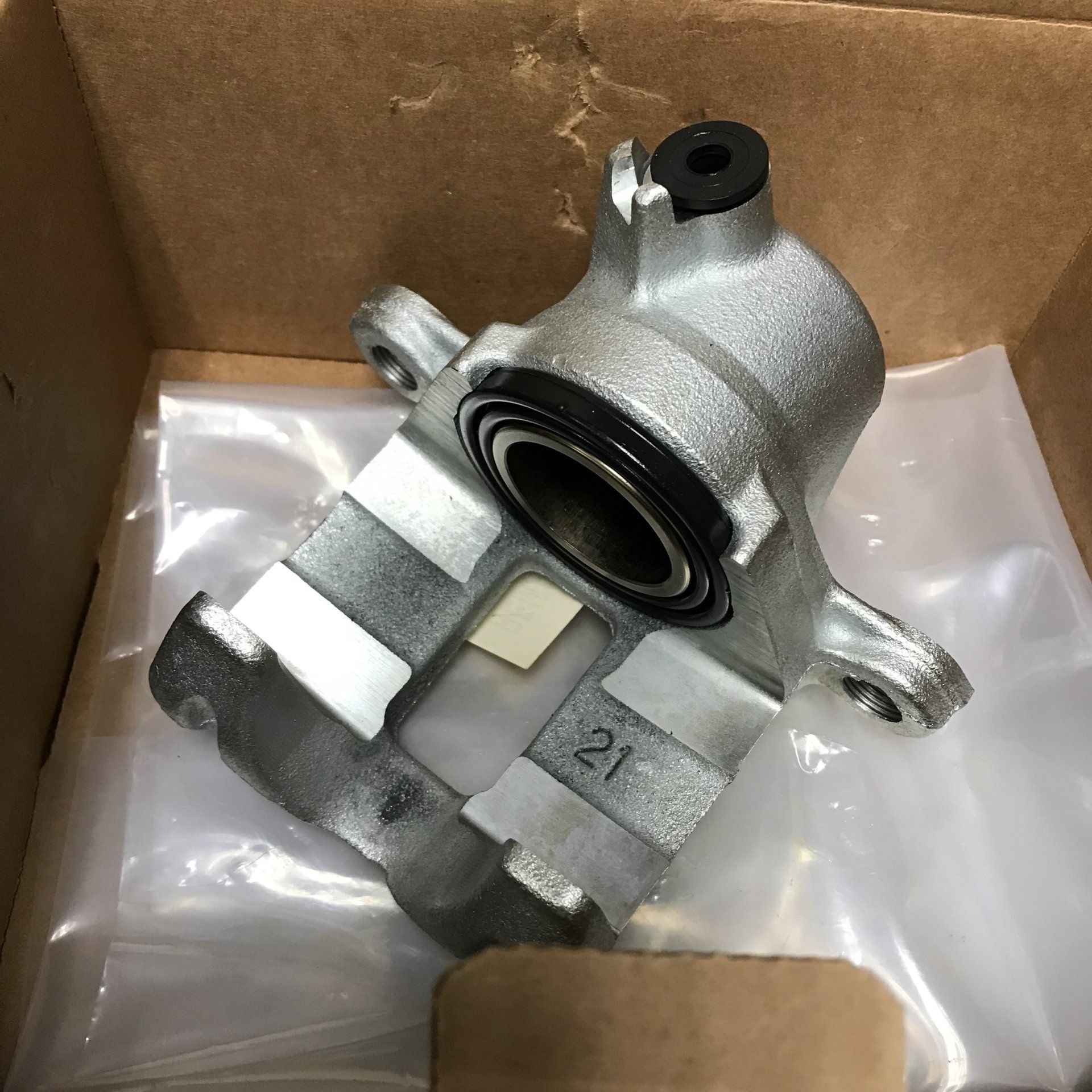

FYI pics of Toyota remans picked up today
View attachment 2026532View attachment 2026533
What part numbers did you order for front and rear?
It looks like fronts are:
47730-60060-84 (RH)
47750-60060-84 (LH)
Looks like rears are:
47730-60110 (RH)
47750-60110 (LH)
Can you confirm?
Edit: I ordered some brake parts from Toyota. Will update my post with part numbers and pics when it all comes in.
