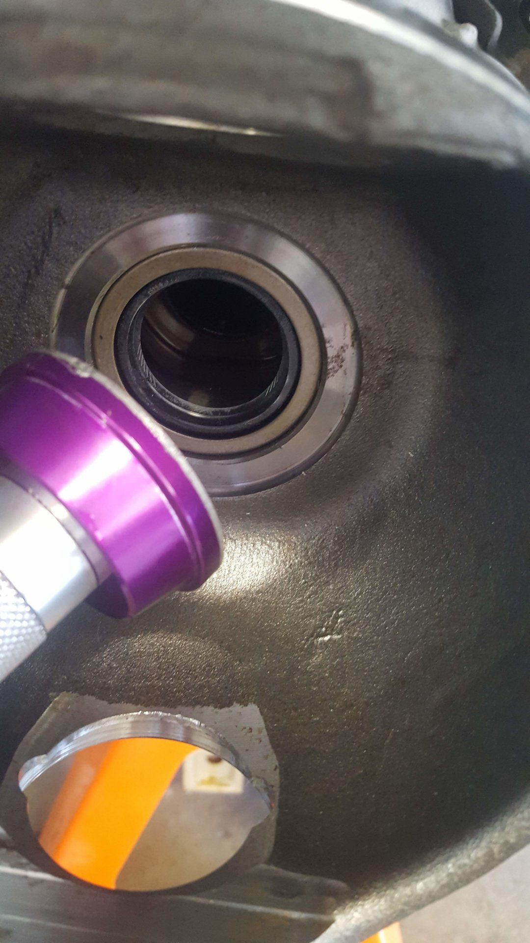

Harbor Freight 50 mm seal and race driver. Perfect for the trunnion race and axle seal. When using it to drive the seal in, the axle housing will "shave off" a hair's width of the diver thereby allowing the driver to recess the seal properly. I've used this 1/2 a dozen times. :cheers:

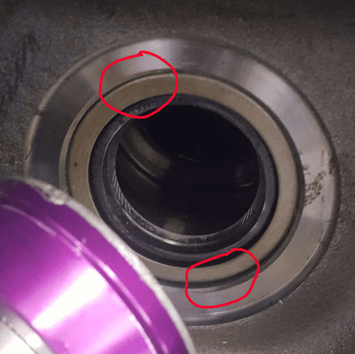

Sadly, that seal isn’t so easily fixed (It does look proud of the chamfer compared to the bottom where it’s recessed beyond the chamfer).
At least if you catch birf soup, you’ll know what happened :meh:
Sure sure pick apart the picture I used but it remains that all 6 axles that I've serviced and twice on my own truck, the seals are properly seated.
Absolutely nothing wrong with the Harbor Freight seal drivers. It should also be mentioned that the kit contains the correct driver for the wheel bearing races.
