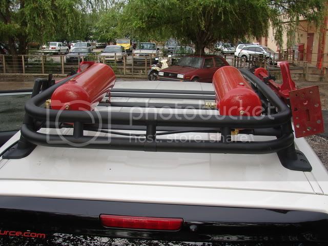

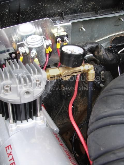

I have used my Extreme Aire for a little while and I am pretty happy with it. It was pretty easy to install with the airbrake hose and push-to-connect fittings from ExtremeAire. I have two Warn 2.5 gal (hotdog) tanks mounted on my roof rack. It's enough reserve to run my 3/8" impact wrench without faim.

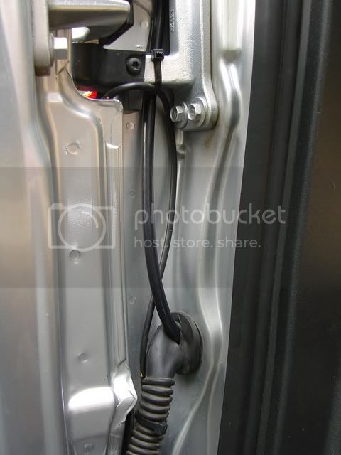

THAT is a sweet setup. Can you fill the tanks with the hatch shut or do you have to have it open so that it dosen't pinch the line? Where did you get the tanks???
I have been trying to figure out how to mount those damn tanks!!

No pinching going on here. There is enough of a gap between the top edge of the door and the frame that the line doesn't bind. I got the tanks from 4WP (they had to order them though) and got them to match the pricing from another online vendor, about $70 per tank, came pre-painted in "Warn Red" too.
