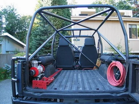

I sure do like my Extremeaire. They make a 24V unit was well. Here it is in my LWB Samurai.
