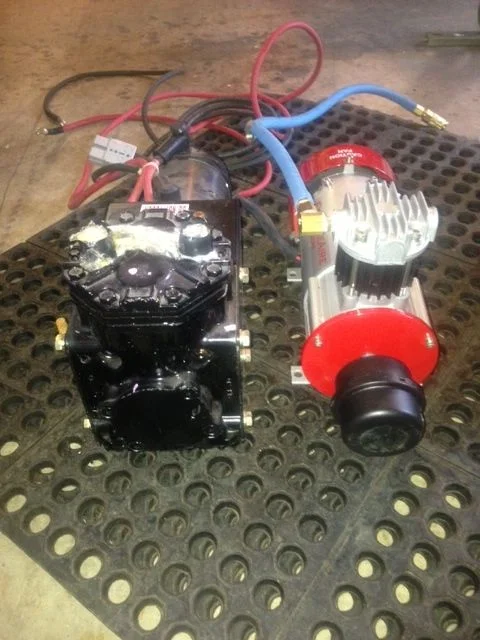

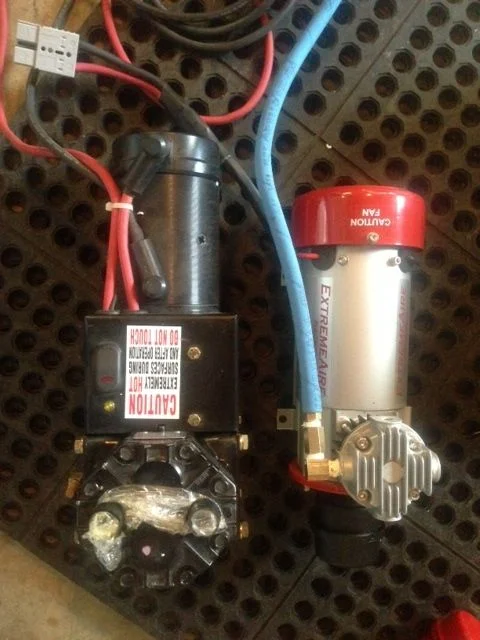

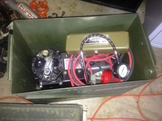

Here my Oasis compressor next to the Extreme wire magnum compressor. Its heavy and stout and fit perfect in a metal ammo can

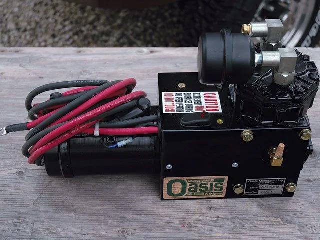

Sorry if I missed it, but any more info on that black compressor? Looks to me like a York that's been converted to run on electric.
Thanks!
