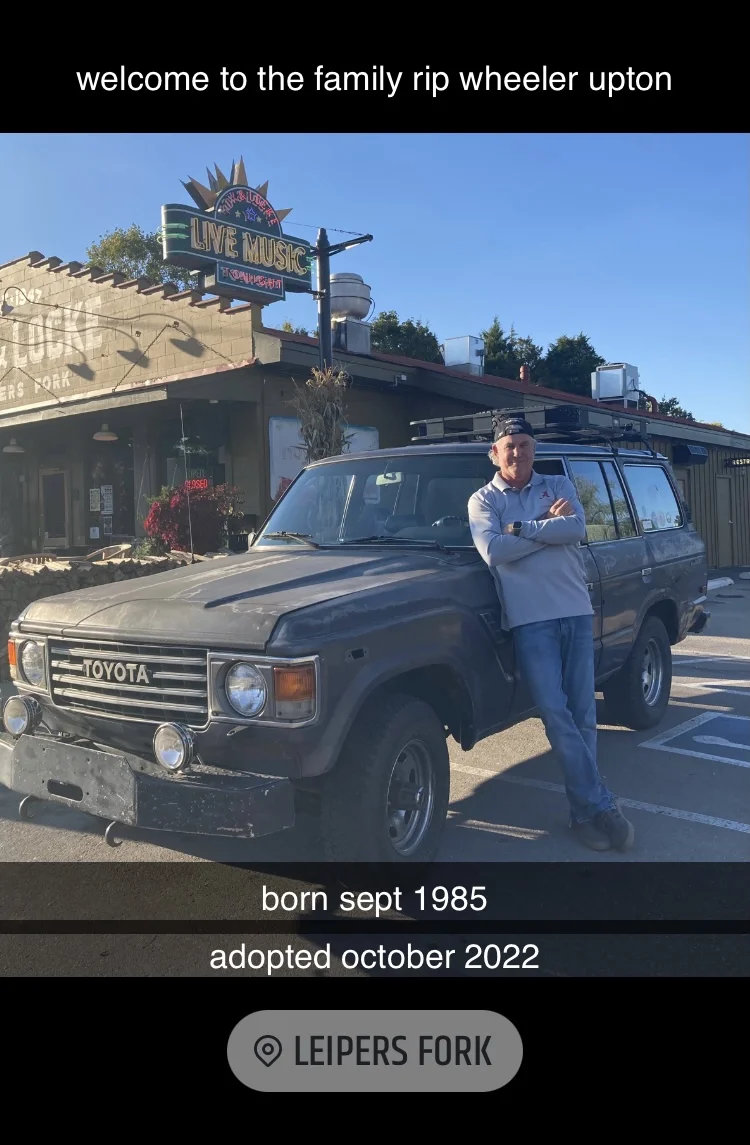

My recently acquired '85 FJ60 has 268k miles. I've been doing the small things to squeeze as much performance as possible out of this 2F.
It's a daily driver in AL, and I'm about to change the oil and filter, the temperature range will be 20-60 until the next oil change.
I don't care about leaks, or which oil will last the longest. I just want the best compression and performance possible for this daily driver.
< Apologies in advance that I have no immediate plans to crawl any rocks or get stuck in mud somewhere. I just know I always wanted a manual shift with round headlights, and Rip Wheeler will still be mine whenever I eventually kick the bucket > 😎
