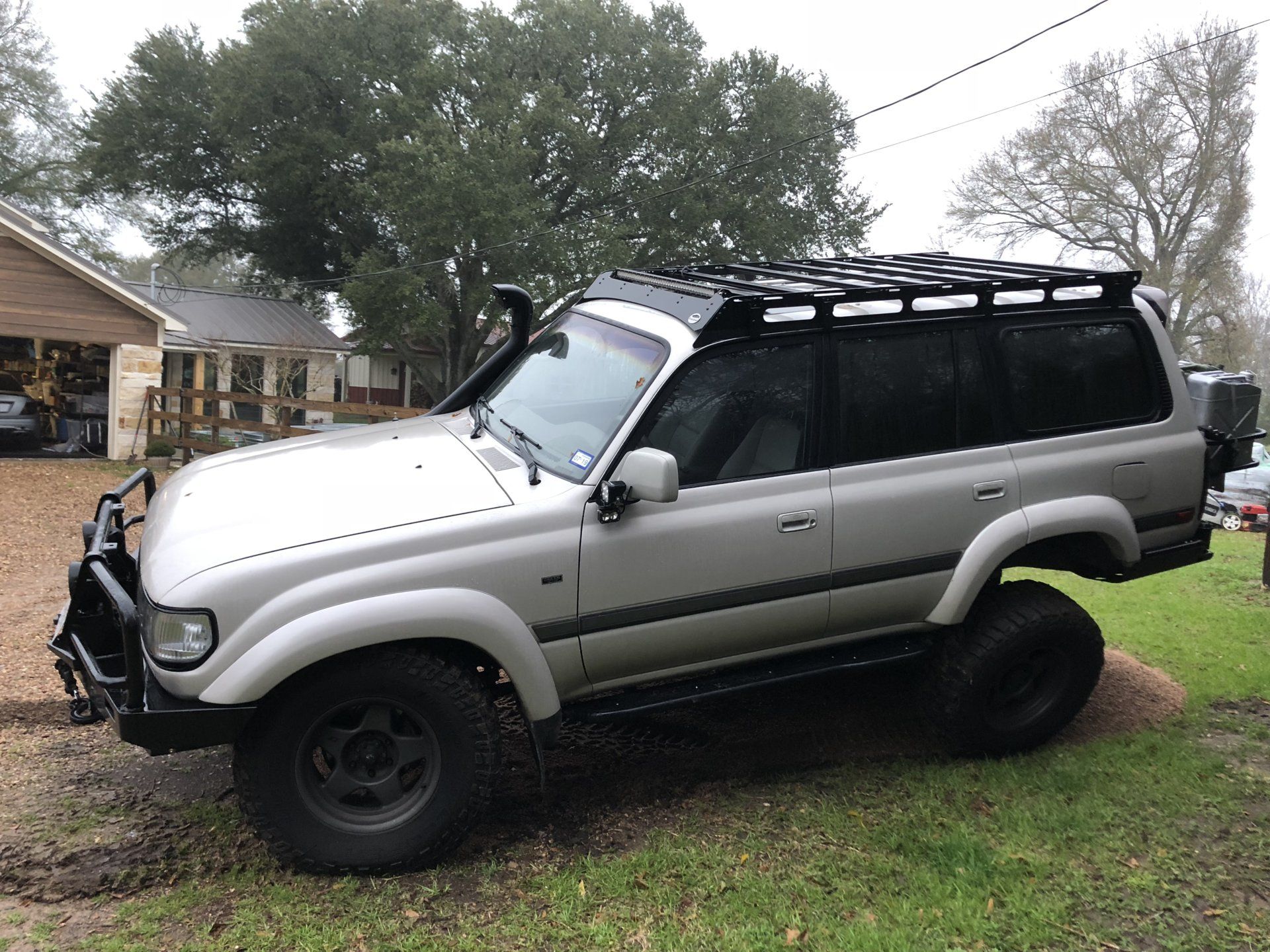

This is with 17x9 -12 offset Method and General X3 Grabber 35x12.5 on a 91:

Sounds like the short of it is stock rims work and wider stance wheels can work with flare trimming.
