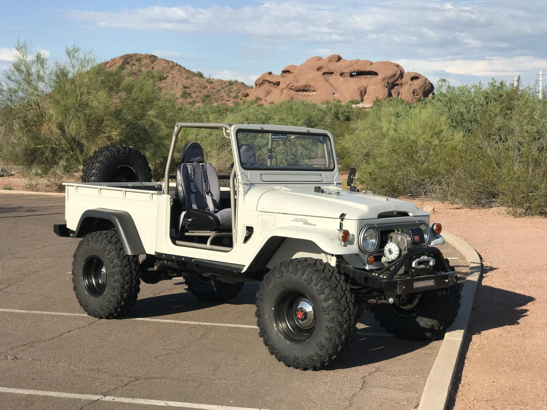

I have a carbed Chevy 383 stroker in our FJ45, I want to go with a fuel injection system and would like to hear what you may recommend.

No advice on F.I. but that's a gorgeous rig! Nicely done.
