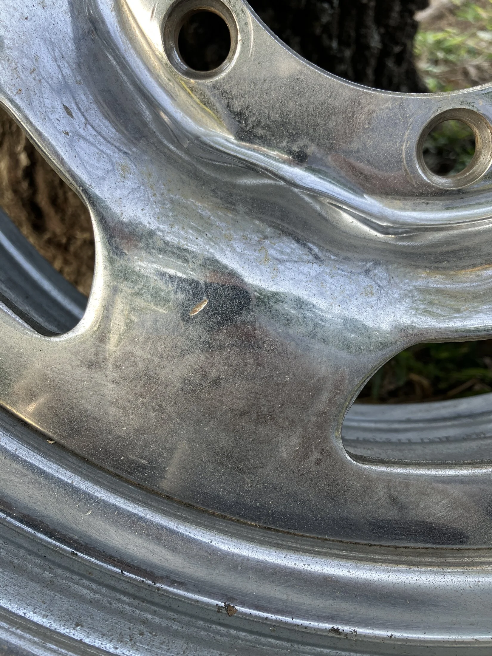

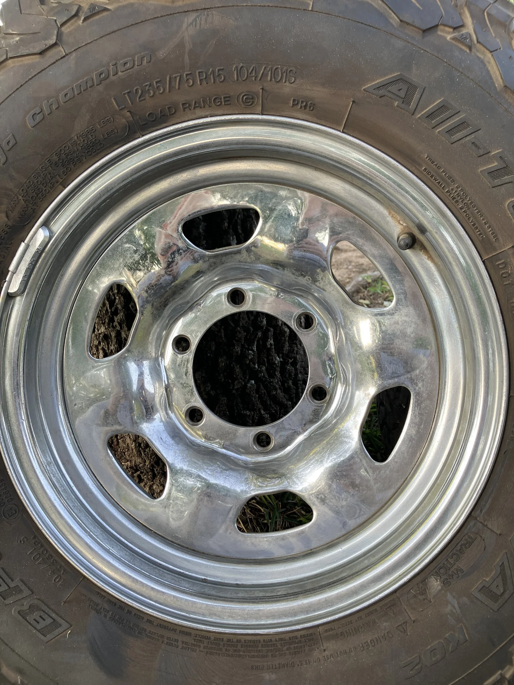

I just finished my 3” lift OME suspension and knuckle rebuilds. Man my wife is happy cuz that’s messy work. I’m painting my rim center hubs and the rims look pretty good but these water marks seem kinda deep.
What’s you favorite chrome restorer product?

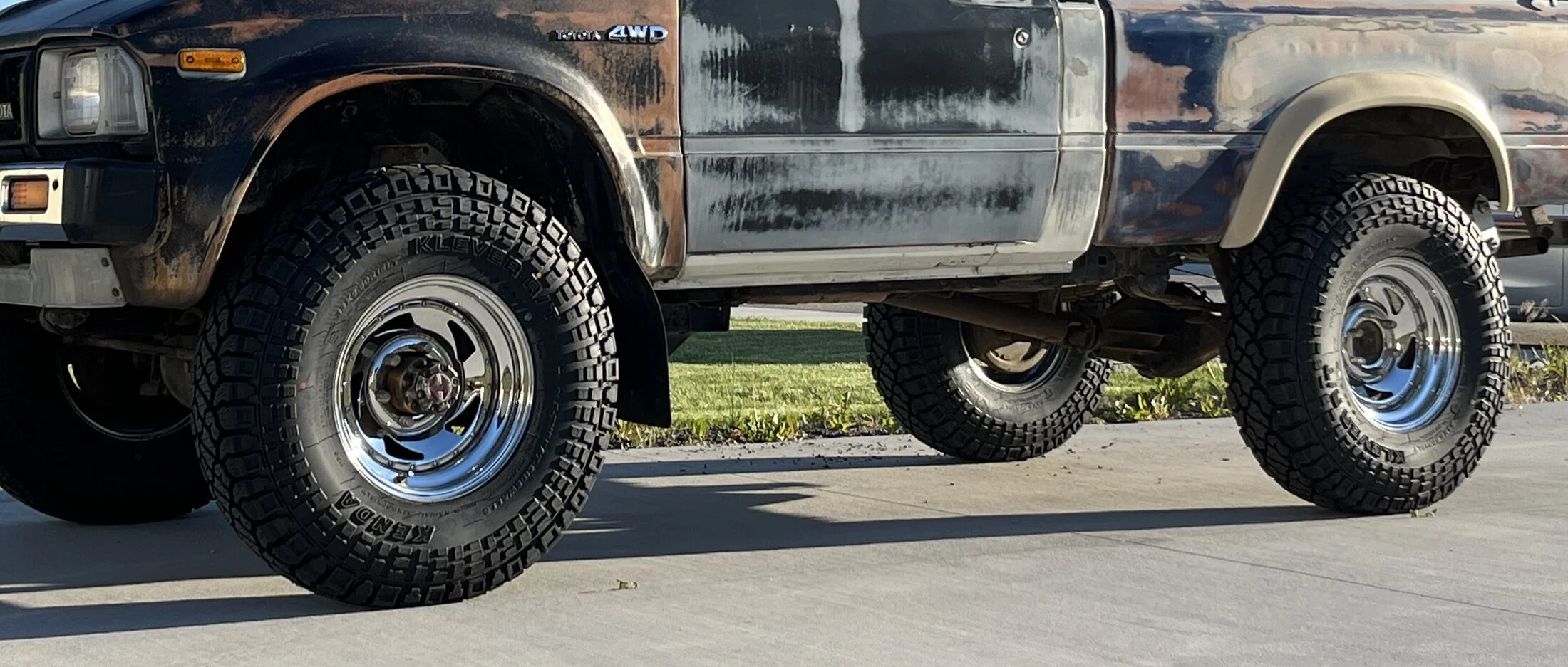

This. Use it with foaming glass cleaner and light pressure and it will only take a few minutes per wheel. Get a new piece of steel wool if it starts to pickup dirt. The chrome is many times harder than the steel wool and will not be scratched by it unless you are putting a lot of excess pressure. I did a set of 5 of the wheels pictured in ~20min last summer.
