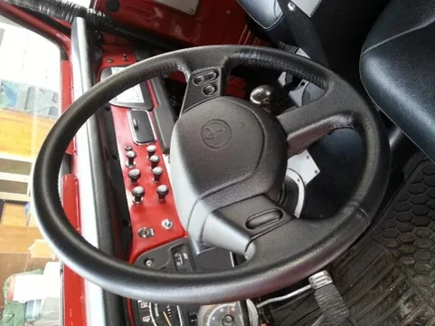

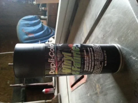

Didn't plan on sharing until I saw this cool thread. Needed some more leg room for steering but I didn't want to spend over $150 for a Grant wheel and adapter. Stopped by the local junk yard and found this wheel in a 1993 Toyota SR5 truck. Fit right onto my '73, just had to drill a couple holes in the bottom and add two tapered hardened steel pins for the turn signal canceling. Works great, 15" wheel and about 1/2" more dish than the original. Only cost me $10 for the wheel, $6.85 for the paint (wheel was grey) and $1.70 for the pins. I can take pictures of the pins if anyone needs...

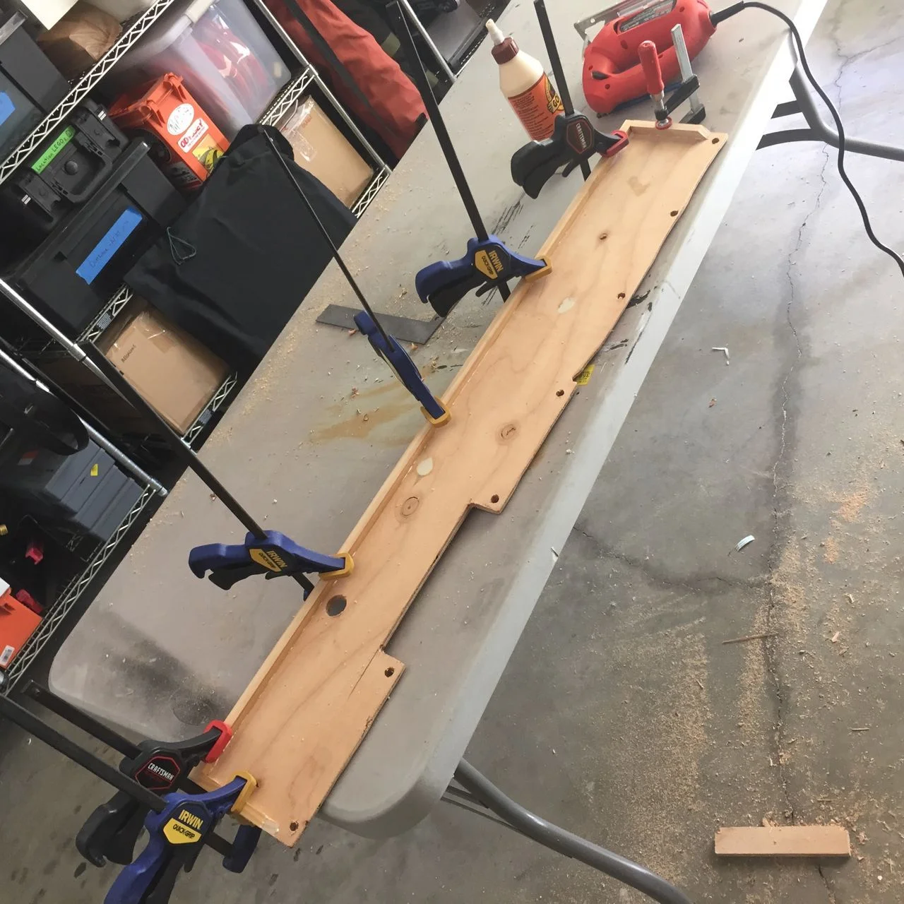

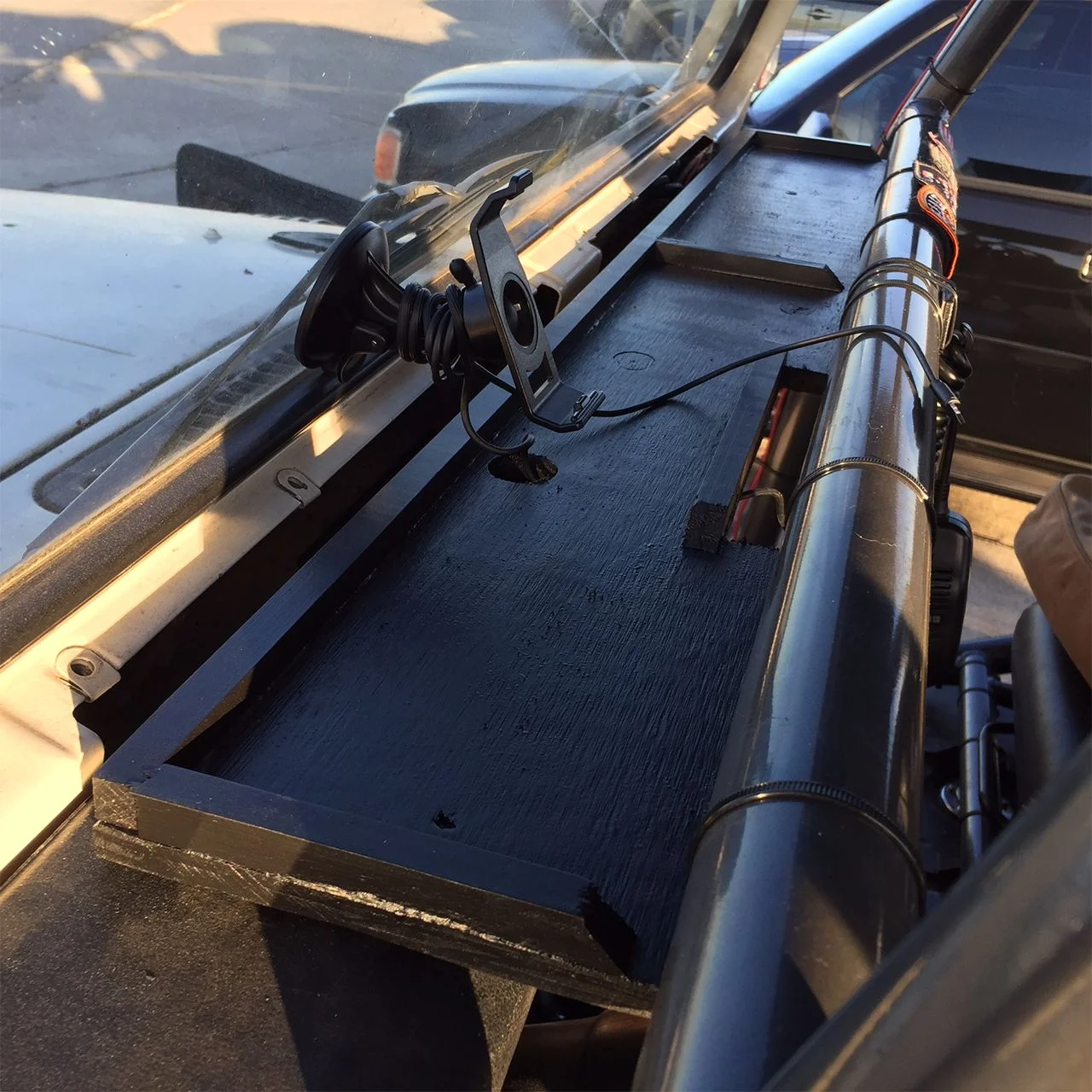

Made a simple shelf that attaches to the cage crossbar and rests on top of the dash pad.
