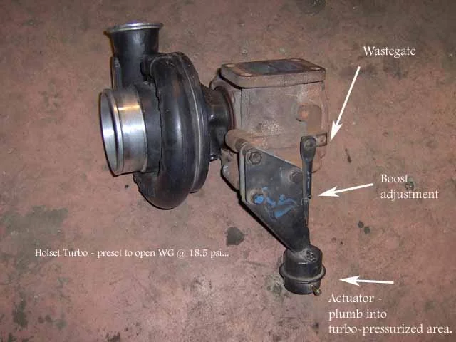

They are internal wastegate with external wastegate actuators. Just like a Cummins Holset turbo, just much smaller. Here is a photo of the Cummins trubo. Basically I agree with and am saying everything you are saying in the second paragraph above. And if it is OVERboosting then adjust the wastegate actuator to let off the excess boost where desired. All this sounds very difficult and complicated but it is not at all...
example of how adjustments work on this type of turbo. The Saab 2.3 turbo is JUST like this, exept much smaller. I believe it is a Garrett T3 turbo of some sort and lots of muds available for it. I think this would be a great turbo for a 3B and it's where I'd start over an AXT kit for $2G. Unless money was growing on trees for me. We turbo'd my 2H in a weekend (which was probably overkill) using a homebrew trubo we took of a 4L Mitsubishi engine that cracked it's head. Wasn't hard at all. There is something to be said for the exhaust manifold built for the turbo but I don't think it is that mandatory IMO...
From turbo's on gassers as you would say I know my way around wastegates whether it be internal and external and adjustable wastegate actuators. The GTR I help out on has 2 HKS 2530 turbos with internal wastegates both with adjustable wastegate actuators. The standards don't come with adjustable actuators they were an option. I didn't realise you were talking about adjustable wastegate actuators in your post.
In fact most factory turbo's I have come across don't have adjustable wastegate actuators. They can be made fairly easily though.
I'll be running a boost controller though. I like the flexibility of using as much boost when needed. A dual stage solenoid as well for 2 boost presets and when its off it will be either factory boost unless I have adjusted the actuator. Having said this a turbo with a non adjustable wastegate actuator doesn't really become a problem. As the boost controller can bleed air going to the wastegate to get more boost before the wastegate will open.
The beauty of an adjustable wastegate actuator is you can set the minimum boost though. If say factory boost is 7psi but I wanted min boost 9psi I would adjust the actuator so it opens the wastegate at 9psi which also stops wastegate creep, ie opening the wastegate sooner than it needs to be. Rather than keeping the wastegate at 7psi and using the boost controller to get more boost. Then the boost controller, will take over from 9psi and up. The advantage of doing it this way is you get less of a chance of boost spikes.
That cummins turbo certainly looks good, with a big compressor housing and small turbine housing. I'm not sure if we can get those easily here in Australia. What's the exact model no?

well we are lucky with the Cummins because they are adjustable. Not that I have ever adjusted it ever, in fact I pulled this housing and ended up trading it for a non wastegated housing. The 4BT is pushing about 25 psi of boost now and has lots of pep of course :) honestyl I'll have to look at the saab closer to see if the actuator is adjustable on that one. I thought of it as not a big deal either because of a boost controller (worst case resort) but the Saab opens at about 13 psi I blieve (I'll have to check) stock whihc I think should be perfect for a 3B if you ask me. One thing that did strike me though today looking at it again is that it is small. Damn small. But again maybe that is not an issue and in fact possibly a good thing...
Anyway, Cummins cronology is pretty easy. They are all holset turbos....
in the states...
through 1993 they were H1C turbos, small compressor wheel and one size compressor wheel all through the whole series of all the hoslets mated to Cummins. They all had very large exhuast housings (16cm2 for a 4BT and 18.5cm2 for 6BTs). Stock this put about 12 psi to my engine, same with the 6's I think too.
In 1994 they started playing the power wars (and again perfect example of how turbo largely depends on preferance) and they made the compressor wheel much larger, went to a 4" :eek: air intake system and 3" tubes for their air-air intercoolers. They reduced the size of the exhaust housing (again same turbine) to 12cm2 so all of a sudden well over 20 psi if you wanted it. But the wastegate set to release at 18.5 psi. For '94 only it was called a WH1C (basically an upgraded H1C) before they redesigned it and called it a HX35 through I think '99. There is a '97 only auto version that has a 9cm2 housing wastegates (so very small) that is also badass - this is the turbo I actually wish I had...
I hear there are some neat turbos off C series (big rig) cummins that are pretty cool and also bolt up, like a HX55 which is huge and I think can also be choked down with a small compressor as well...
That's good to know. I might have a look around the wreckers here, truck wreckers especially and see what I can find. I like the idea of having a big compressor but really small turbine so it still spools but doesn't run out of puff in the top end, plus having a large compressor doesn't heat up the air as much.

the holsets are not ball bearing as far as I know, they definetely use oil and are only oil / air cooled, not water cooled so that is where a lof of the euro turbos have it beat particularly... They are big and the beauty is you can choose what exhaust size you have. I liked the 4" but my safari snorkel is 3" so I adapted it back down to 3" regardless. 4" is slight overkill unliess you have a big 6 cyl I suppose. It is really more of a PITA for me personally, I spent close to $100 ib tubes and adapters and shipping to get the right adapter, and I have to pull all the plumbing off just to get to my oil filter!
Anyway, yes the cummins turbos are different. Again nothing wrong with a little turbo though IMO for the reasons stated about. But it makes me realize just how big these turbos are :)
