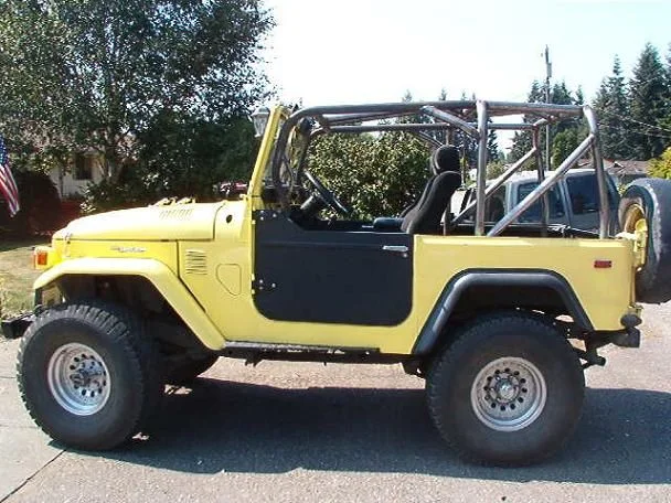

i did mine with duplicolor spray on bed liner about 5 years ago and love it. if you get a scratch just spray it again, i have thought about doing the whole cruiser with it.

the duplicolor stuff has a fairly smooth kinda bubbly texture not ruff on the skin at all and any shucks, checker, ect. should have it in spray cans.
