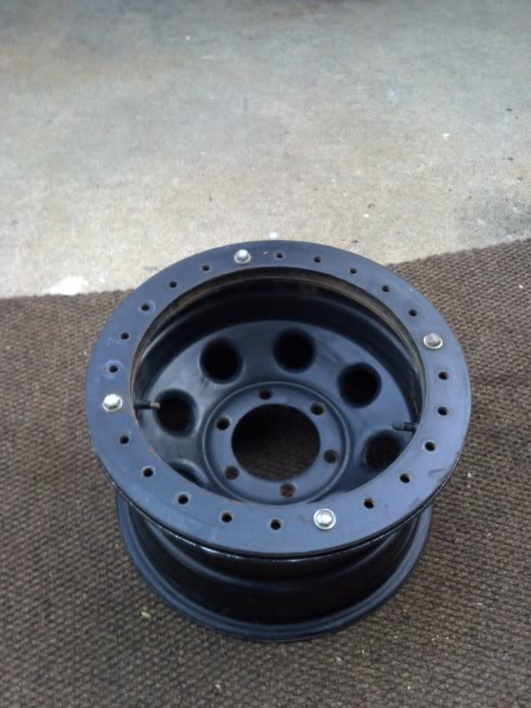

Might be able to mudship to the Roundup. I brought a set of split rims back last year from Georg to Daniel Watters.
hmmmm... 4" backspacing , much prefer 2.5". good idea though. It was kinda tongue and cheek but what the hay, I responded to his ad.
