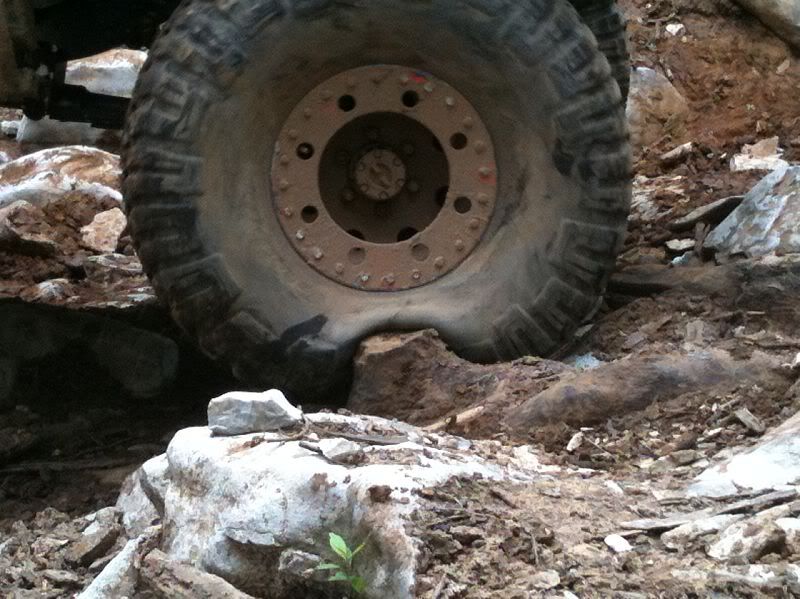

Another good example... Look at how huge that tire footprint is!!!
This should also make people realize how much running low air pressure can help in the mud too. LOTS more weight distribution and hence "floatation".
wait a minute, if I am not mistaken, it looks like you are on flat ground.... Should I tilt the picture for greater effect?:grinpimp:

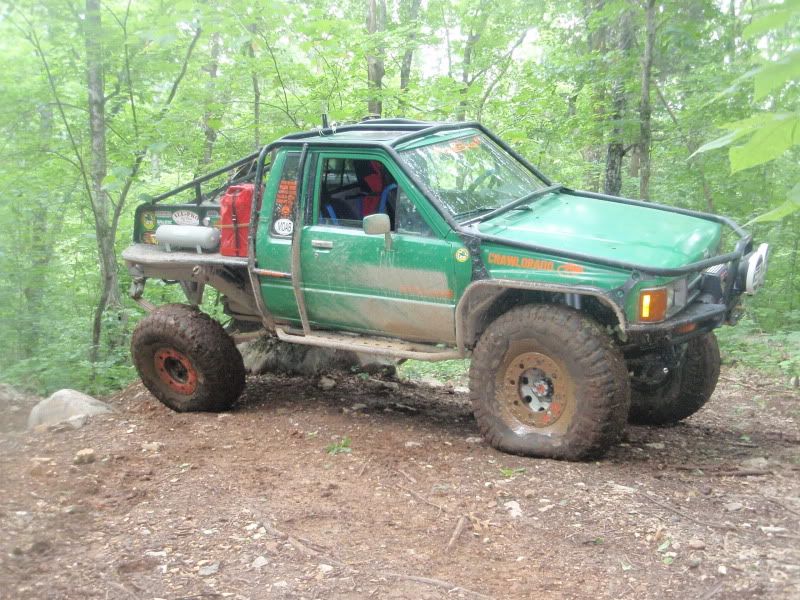

Sid and Christina in Hot Springs. Crawled up this without any tire spin.
Not having lots of tire pressure gives you better traction and provides for better ride quality.
You lose a little ground clearance, but not a big deal.
