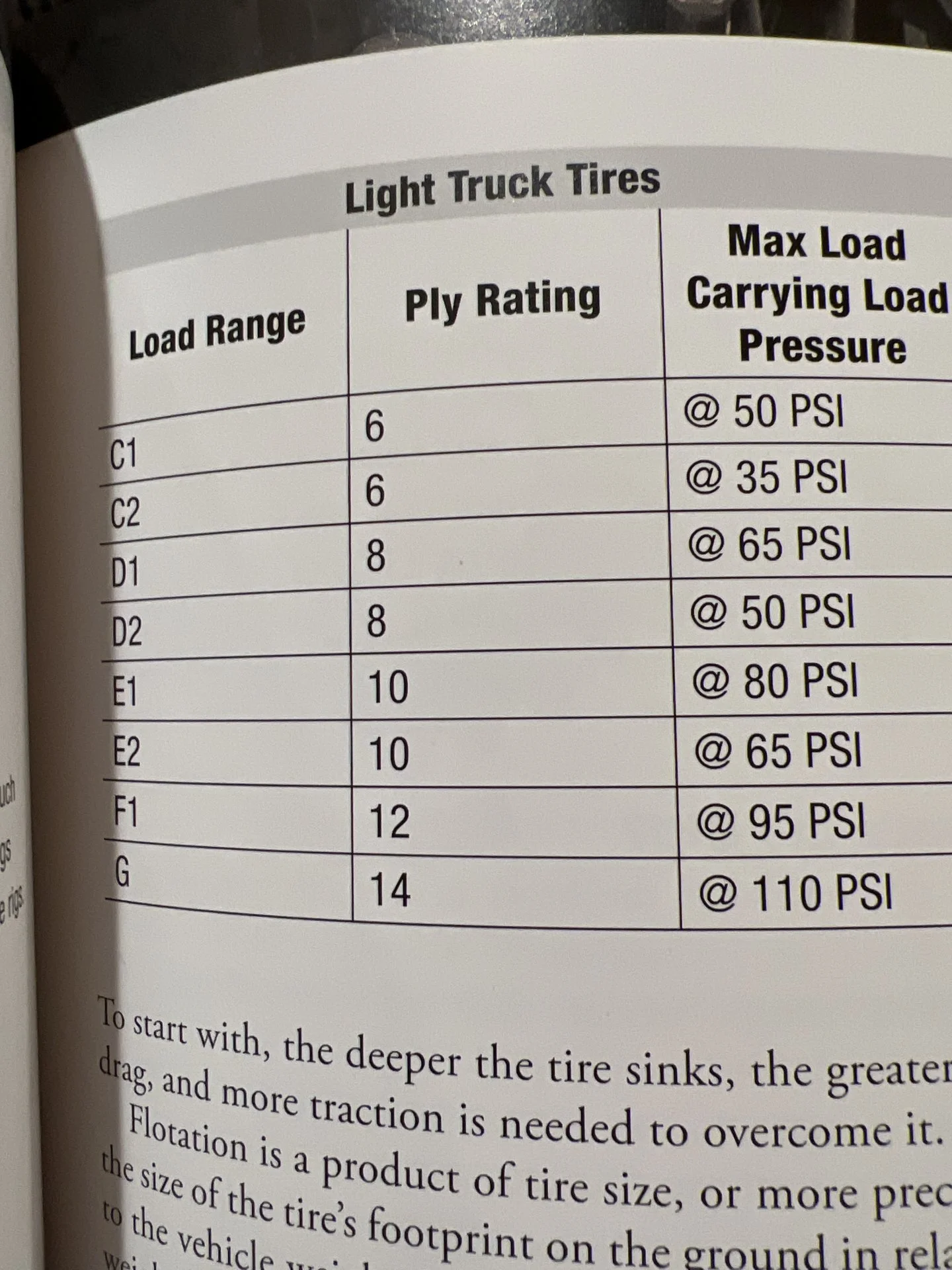

With your requirements why not seek out a size with a C or D load availability?
I had the same question. Basically zero advantage to an e-load tire on our vehicles.
What about number of plies?
