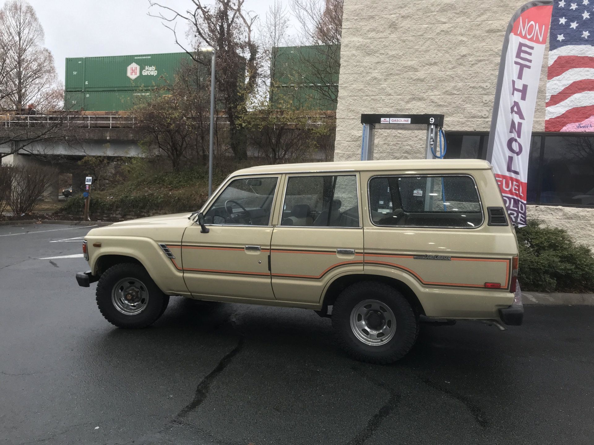

Tried searching to see if this had already been covered but couldnt find anything (maybe I didnt search hard enough:meh:). I have been obsessing over the multitude of problems I inherited after taking home my new-to-me 1985 FJ60. As it is a Land Cruiser, meant to be wheeled and beat up- "fun", I would love to make sure it doesnt fall to pieces as soon as I take it out on a trail. I know this could be opening a can of worms when I use the word "required", but I would really appreciate opinions of more experienced Mudders when it comes to this subject. I'm running a partially desmogged :confused: stock 2F, stock suspension, Goodyear Wrangler A/Ts, and nothing else special. As I am 21 and on a very tight budget, I'm not searching for a SEMA spec setup, but basically what are the bare bones basic setup options I should check out for Grandpa before he makes his maiden voyage under my command.

The only thing that comes to mind which hasn't been said already is recovery points. On the front end, I assume you still have the factory tow hook, which should work great (just remember to only loop straps over it, no hook to hook!)
Now, what about the rear end? I can't tell from the picture -- do you have anything to use as a recovery point on the back? A hitch works in a pinch, whether it's a receiver or just a tongue like my truck came with; you can just put a honking big shackle through the hole the ball mounts to. The tow chain loops on either side of the tongue or receiver aren't beefy enough to safely tug on, though, for situations where you're seriously stuck in mud/snow.

There is a hitch and actually a hook on the rear bumper as well (my skull found the hook was when climbing underneath to pull fuel tank:clap:)
