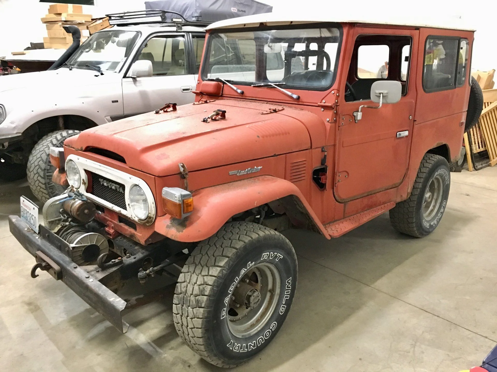

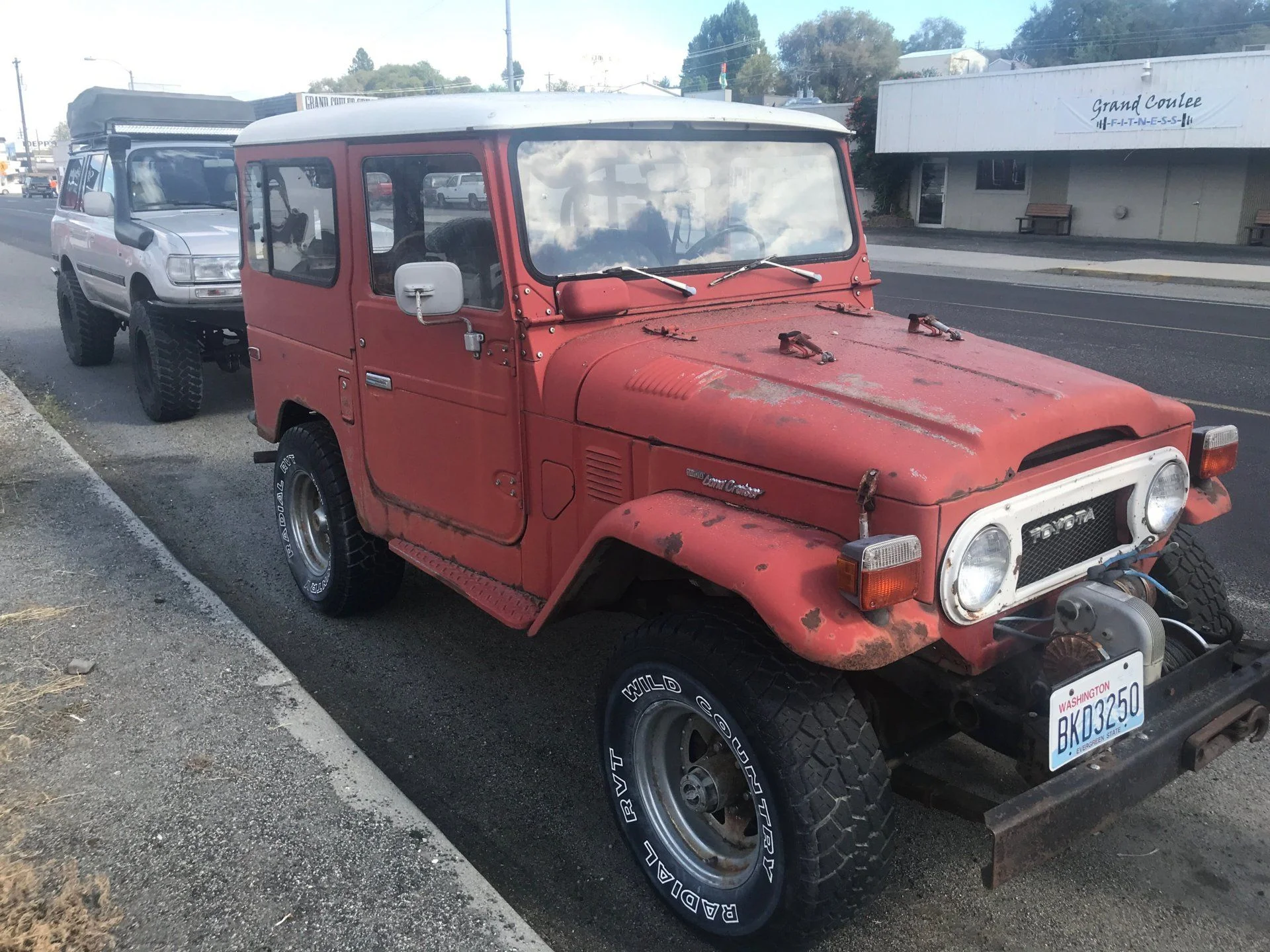

On a trip my GF and I came upon a FJ40 in front of a hardware store, the town it was parked in is off of the beaten path and peaked both of our interest! Her interest being I WANT IT AND I NEED IT!! I did everything I could to keep her from the fever! We drove another 700 miles and talked about it. Was it meant to be?? Yeah! It was a screaming deal!! I have enough projects, she has me as a project!

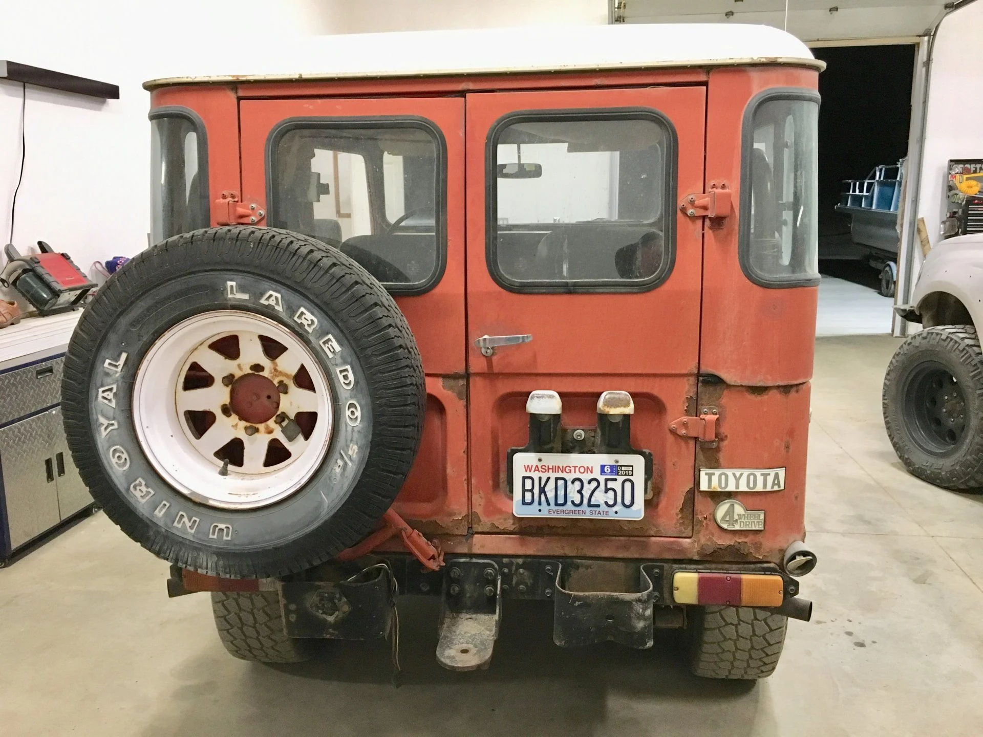

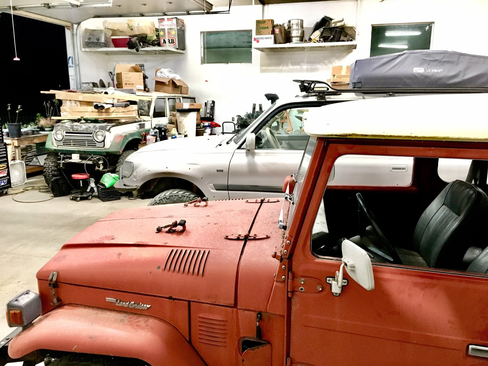

1978 FJ40 that was in a field for 15+ years! Some ether, some love and it’s headed back to the shop!
This rig is so cool!! I owned a completely stock 1975 in 1992. I’ve had many since, but zero in the beautiful stock form! I can’t wait to give it the love it deserves!

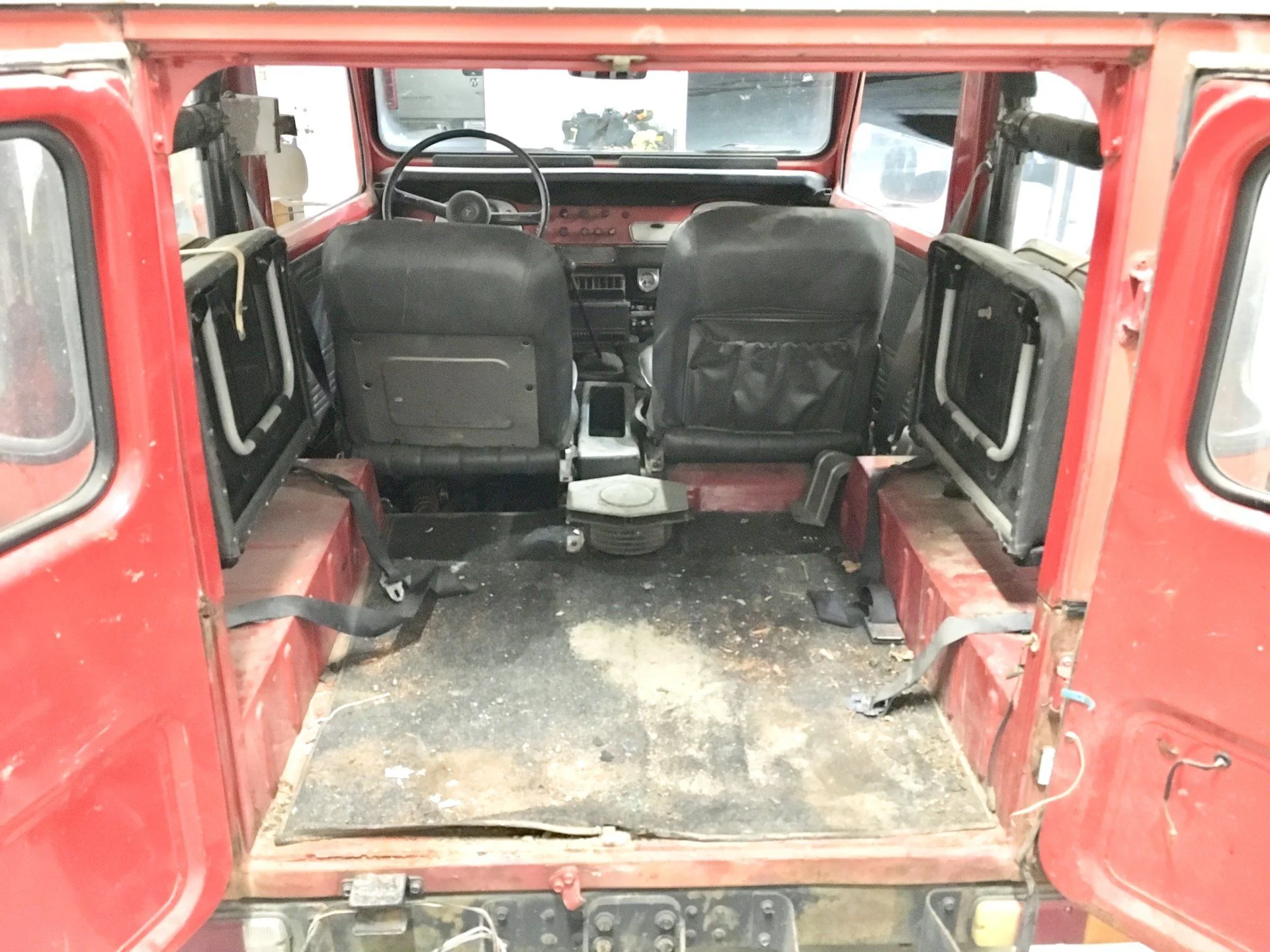

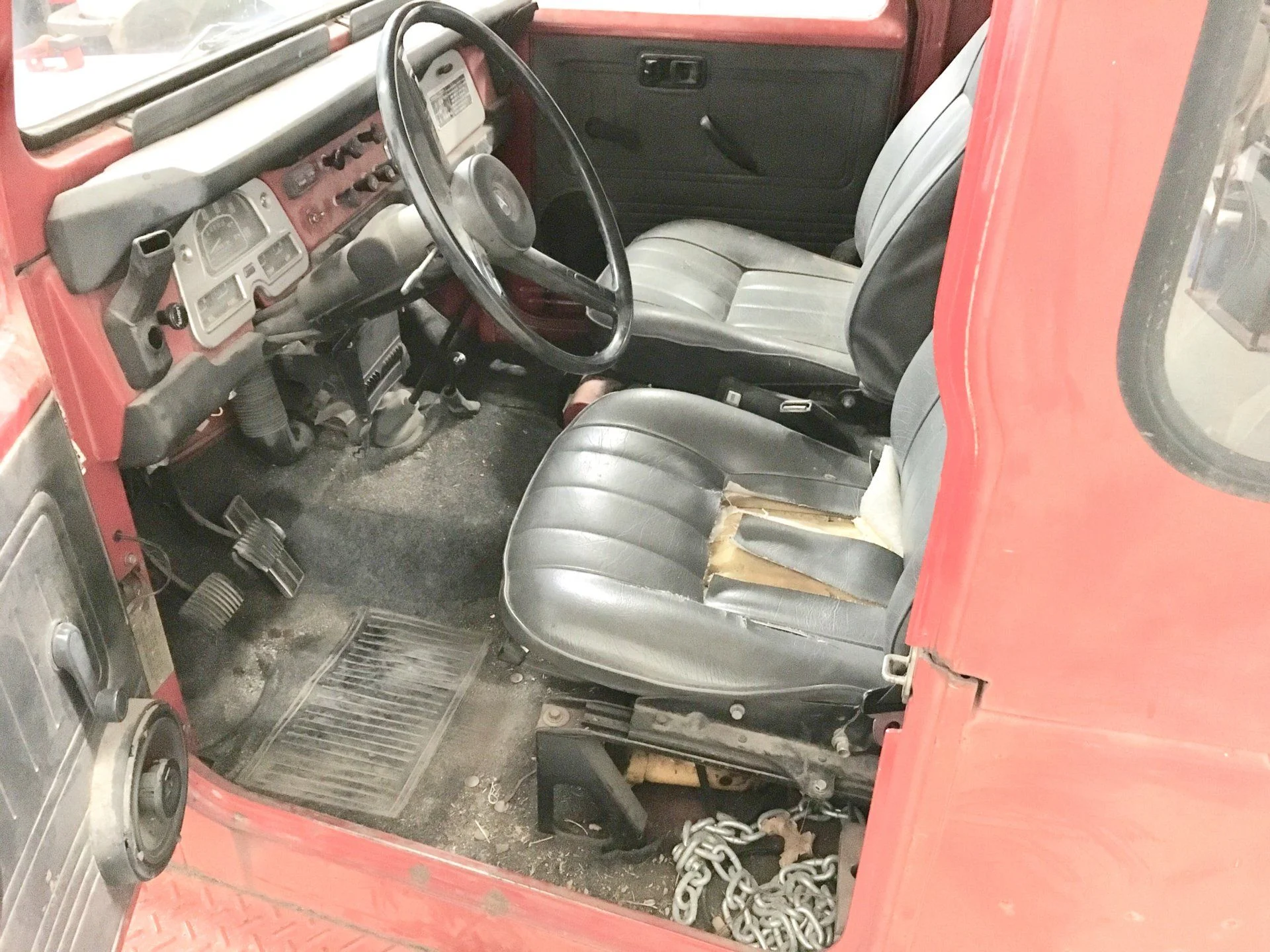

It is actually my GF’s rig!! (Yes I am a lucky man! ) she picked it up for $5250 and came with diamond plate rear corners(don’t worry), tailgate when the top is off, full convertible soft doors, new solenoids for the winch, and another set of new studded tires/wheels.. also brand new brakes all around

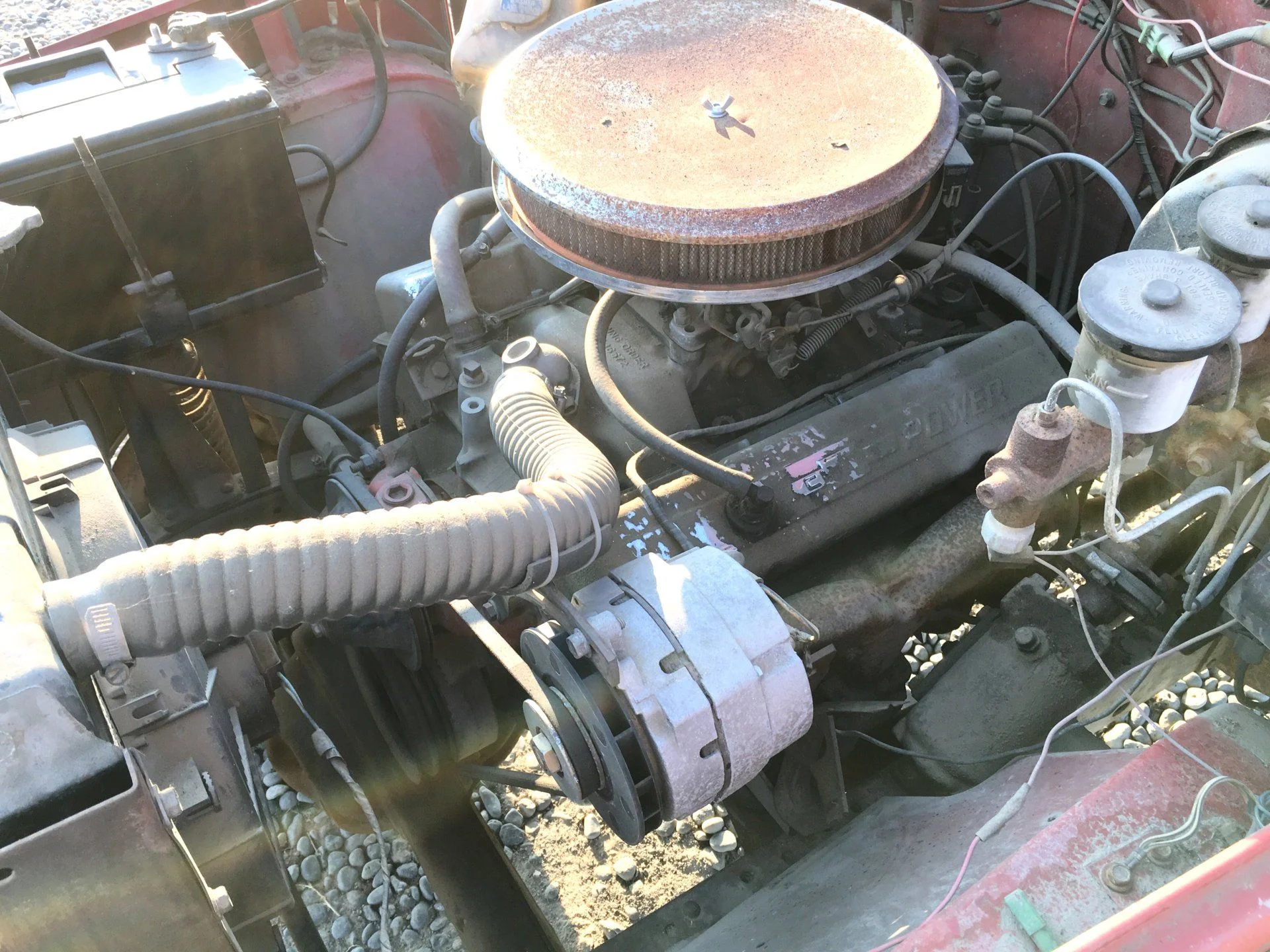

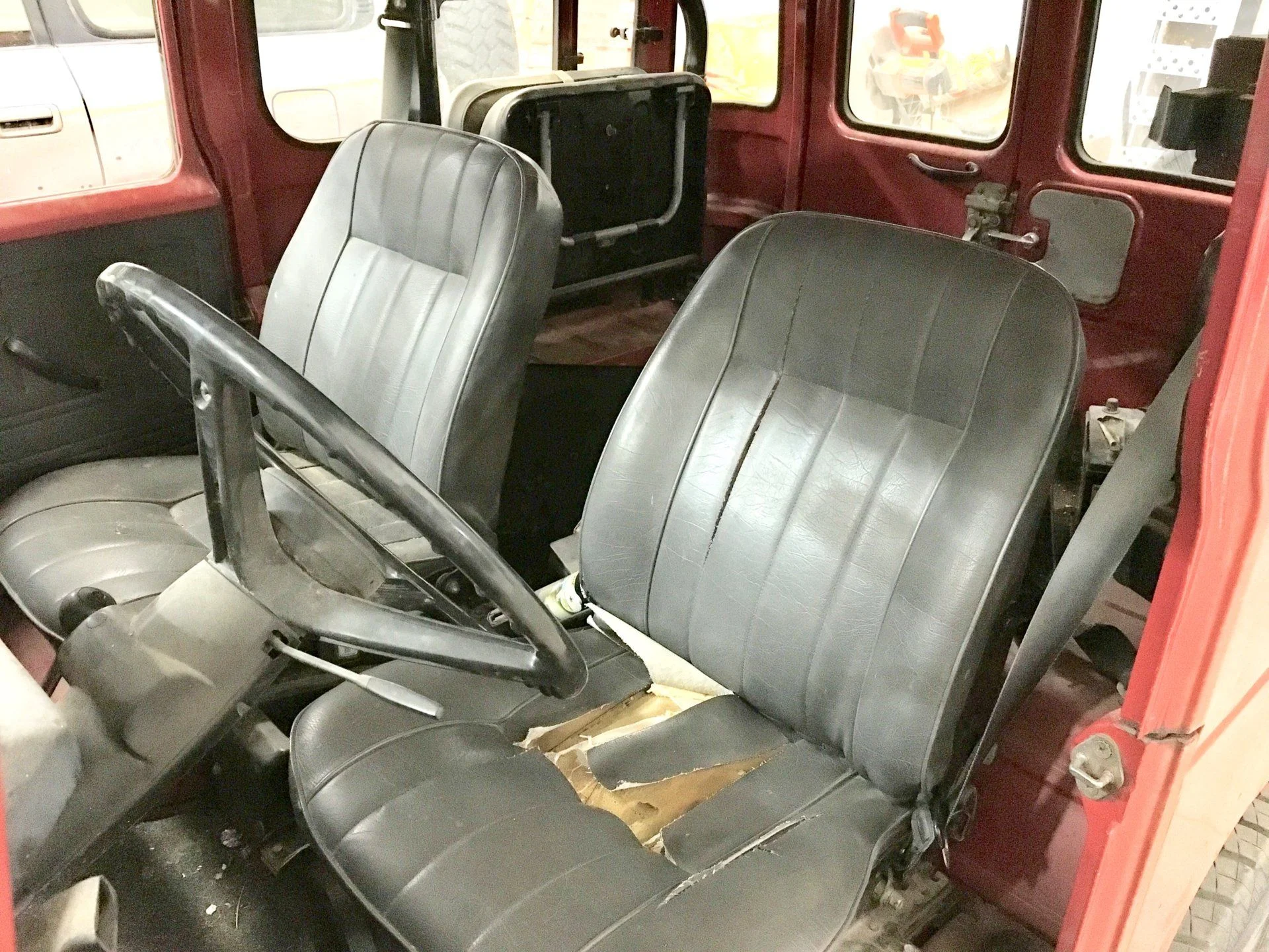

I guess I can’t say “stock”, it does have a V8 (trying to track down the original I6) but runs very very well considering it was parked for so long and it was done right! It has a squeaky throwout bearing sagging headliner but otherwise as to be expected.

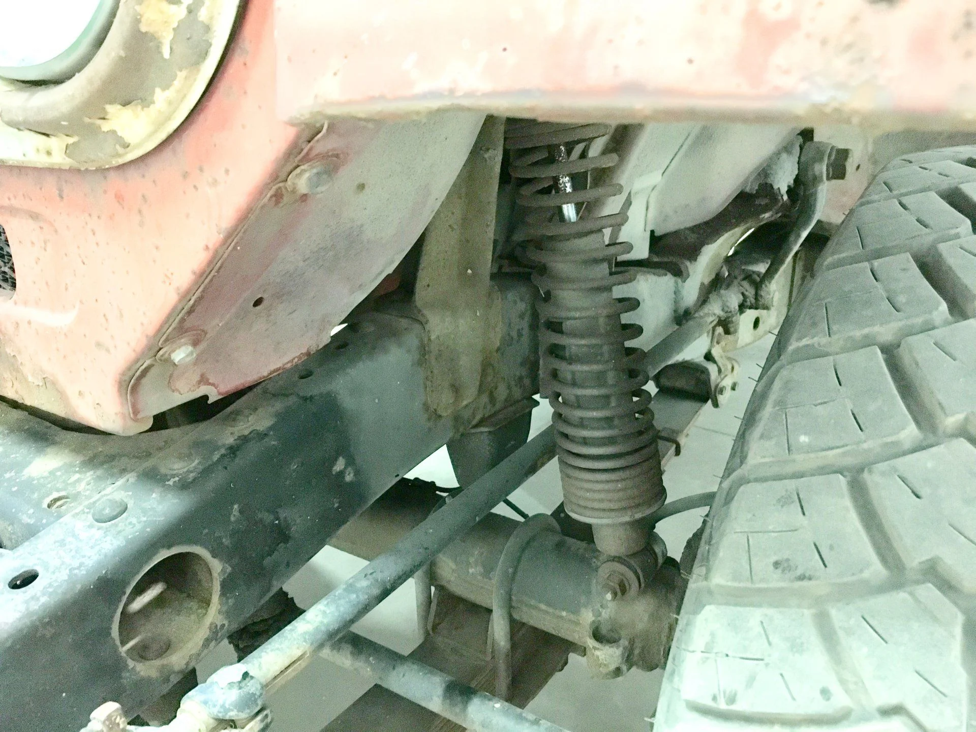

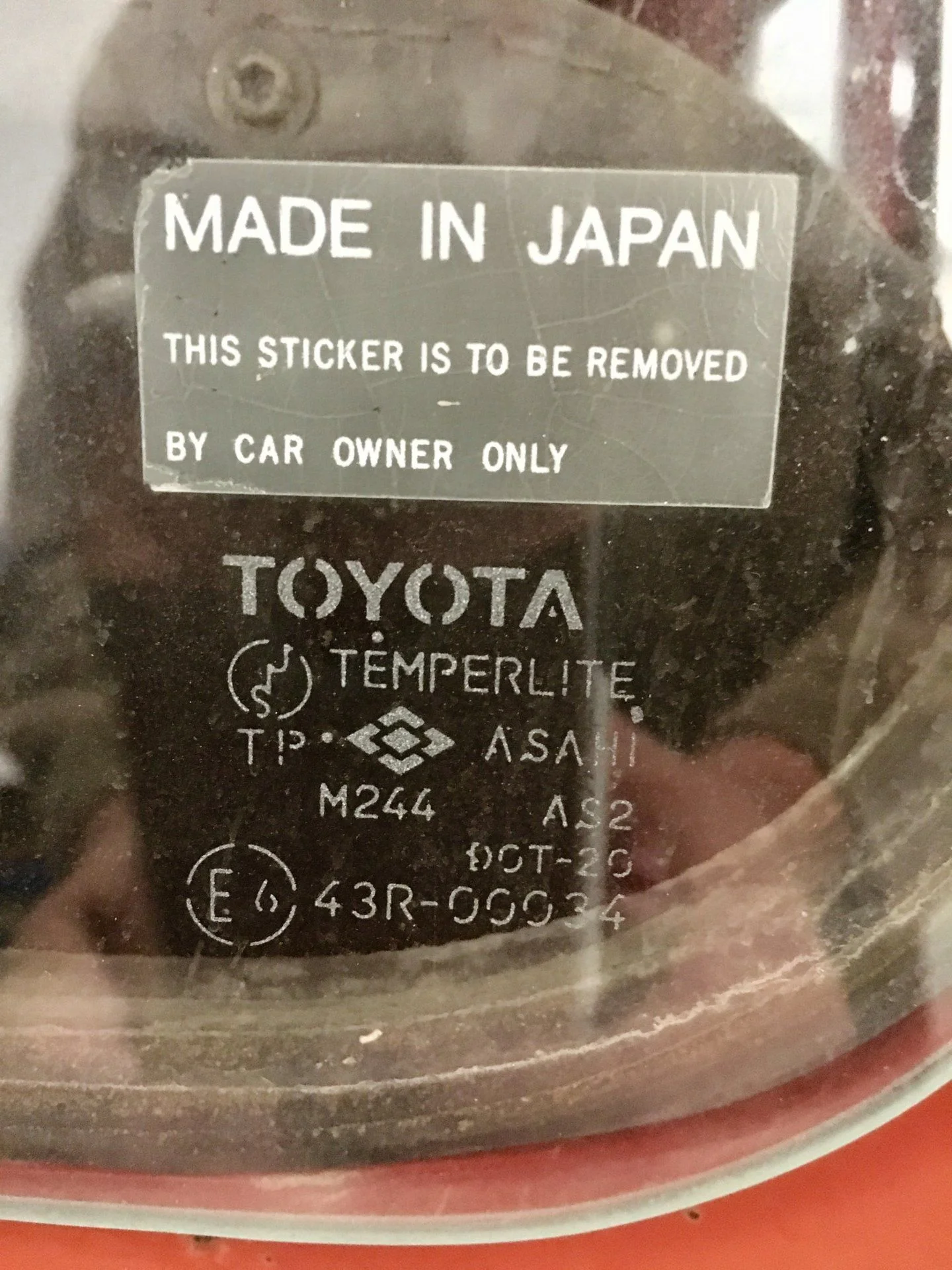

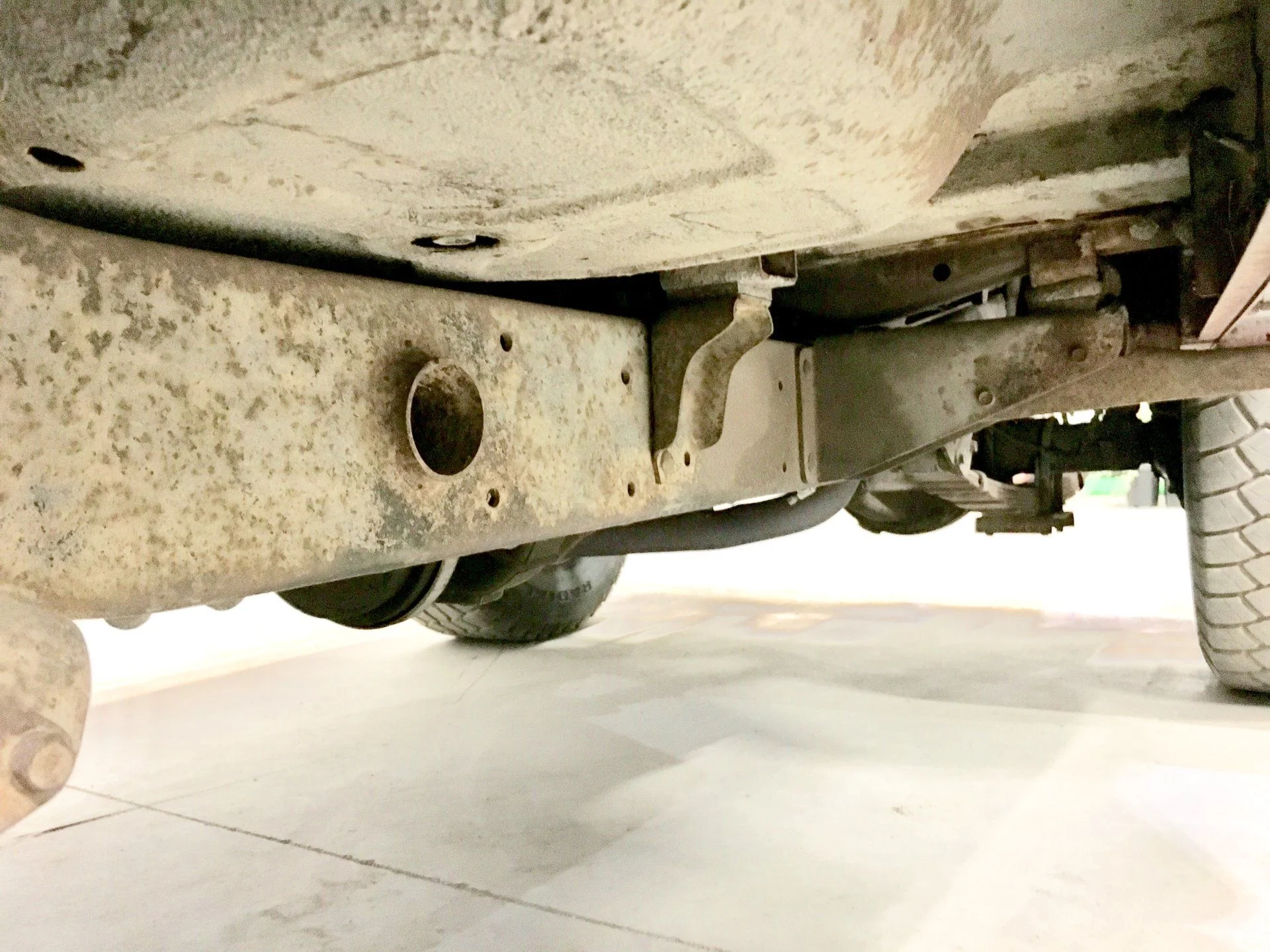

Plan is to replace the spring bushings and drive it! On the fence about washing it as the patina is so cool! I did wash the factory Toyota windshield as I’m pretty sure it hadn’t been done in 15+ years!
We’ve talked about power steering but I think it’d be easier with some 33/10.50’s on stock steelies!

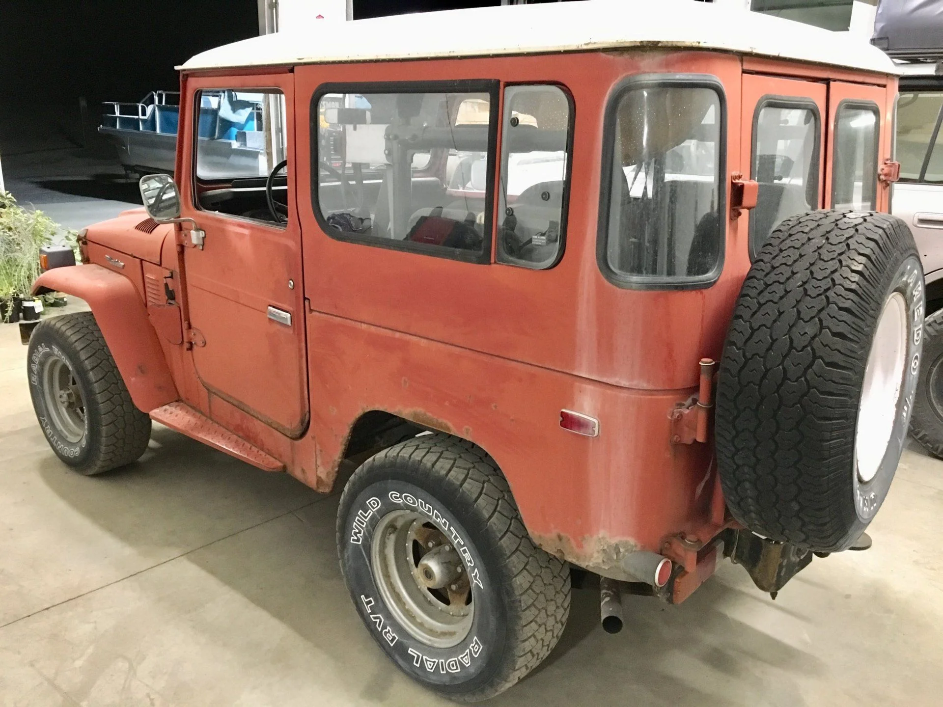

It does have some rust(mostly surface), and contemplating blasting it and patching some, but, I just love that patina
Nice score.
Looks like a great candidate for the patina appreciation treatment of a scrub with CLR and a worn out scotch bright pad followed by a wipe down of boiled linseed oil.
Looks like your girlfriend did awesome, hard to find a WA cruiser without huge rust issues. Good luck finding the original 2F. :cool:

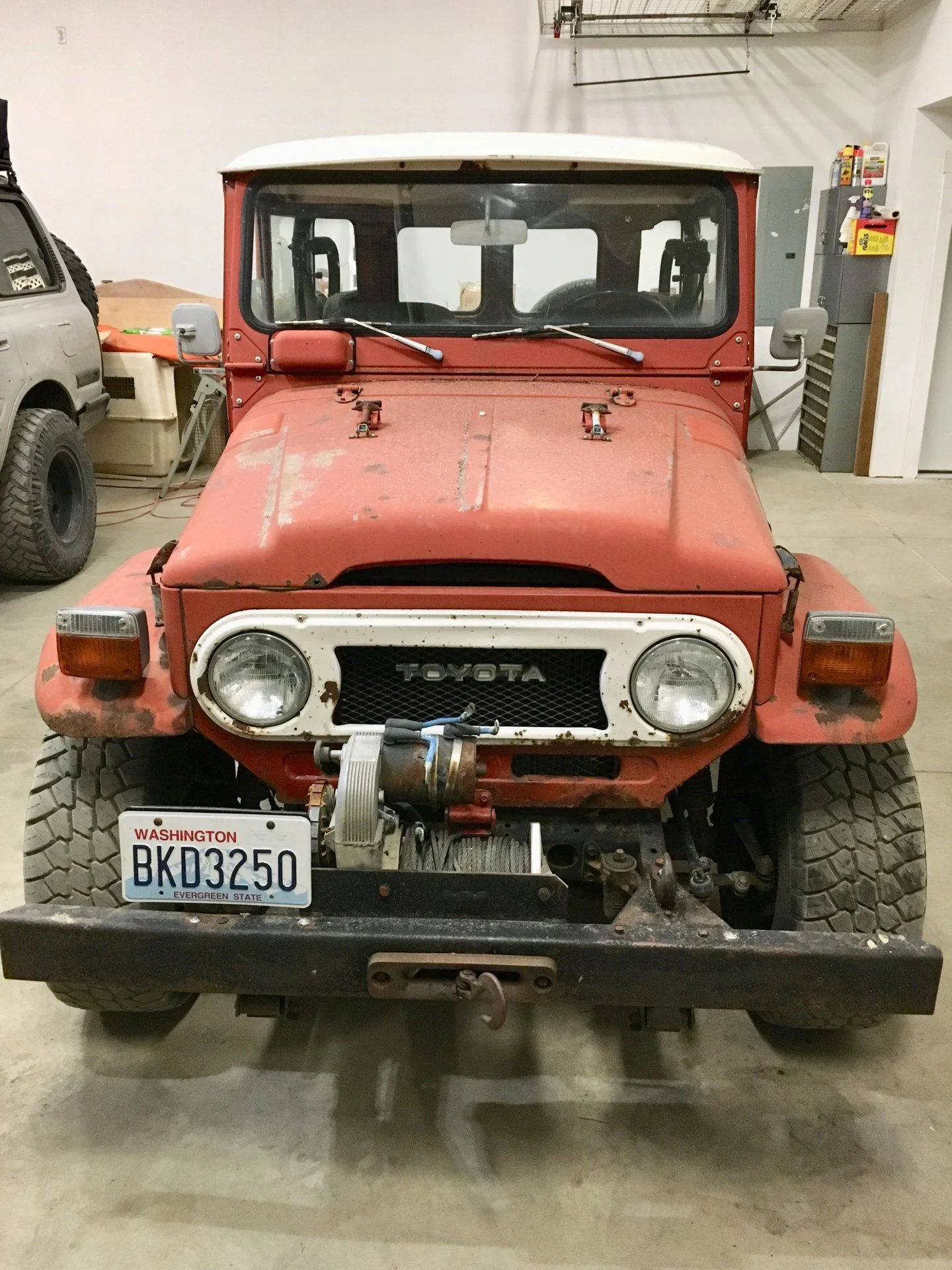

Eastern WA not quite as wet as western WA, but I'd still try and find a splash guard that fits under the radiator. That will help keep the engine bay a bit cleaner in wet conditions, less water getting pumped around by the fan. Nice rig, have fun, and keep her (both of 'em!).
Score.
I’d look at getting a formed hose to replace the flexible one. They have a bad habit of wandering and flexing and getting eaten by belts.
I think it’s a ‘74 Chev pickup hose that’ll fit... but the last time they looked at me funny, walked into the back with the old hose and came back with one that fit. The hose from the ‘70 Bel Aire donor also fit.
