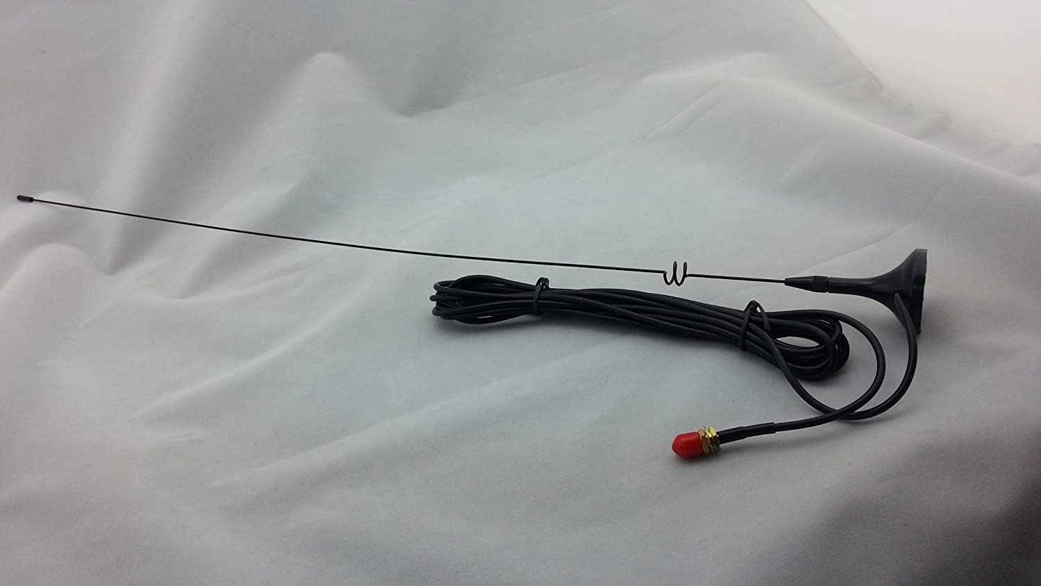

Edit: Would this antenna work with it. I noticed the 144/430 frequency and was thinking you all used 146.400 and seeing as I know nothing about these radios was wondering if the "144" in the description meant it was only for that frequency or if that is just to show it is a dual band antenna.

Jynx, as I'm fresh on studying for the HAM tech license, I can tell you that the Nagoya antenna is recommended by many with the radios .
My understanding is that the 144/430 refers to it being a 1/4 wave antenna for 144 and 5/8 wave for 430
Here's an antenna length calculator. It shows the 1/4 wave for 144 should be 19", but the Nagoya shows to be 15". Nonetheless, it's popular.

the 144 and 430 reference two different bands or ranges the radio can transmit on... thats why its called a dual-band radio. Think of the analogy of uhf and vhf.... the tv can receive on both (back in the old caveman days)...but it has to be made for that. Same way on the radio stuff. THere are single band radios and dual band and triple band. Basically that means that the radio can transmit and receive on more than one band. When you think of band...just equate that to a range of frequencies.
http://www.arrl.org/files/file/Regulatory/Band Chart/Hambands_bw.pdf
http://www.arrl.org/frequency-allocations
Notice the range spelled out for 2 meters and 70 centimeters
The most common band used is 2 meters or the range of frequencies between 144-148.
The noted handhelds above apparently have some expanded ability to transmit-receive. Bands can generally be considered a range of frequencies that a radio can receive and or transmit on. Ham radio has naming conventions for all that stuff. See links on that.
For off-road the 2 meter or the range of frequencies we use is between 144-148, the 2nd most popular frequency set is the 70 Centimeter one.
