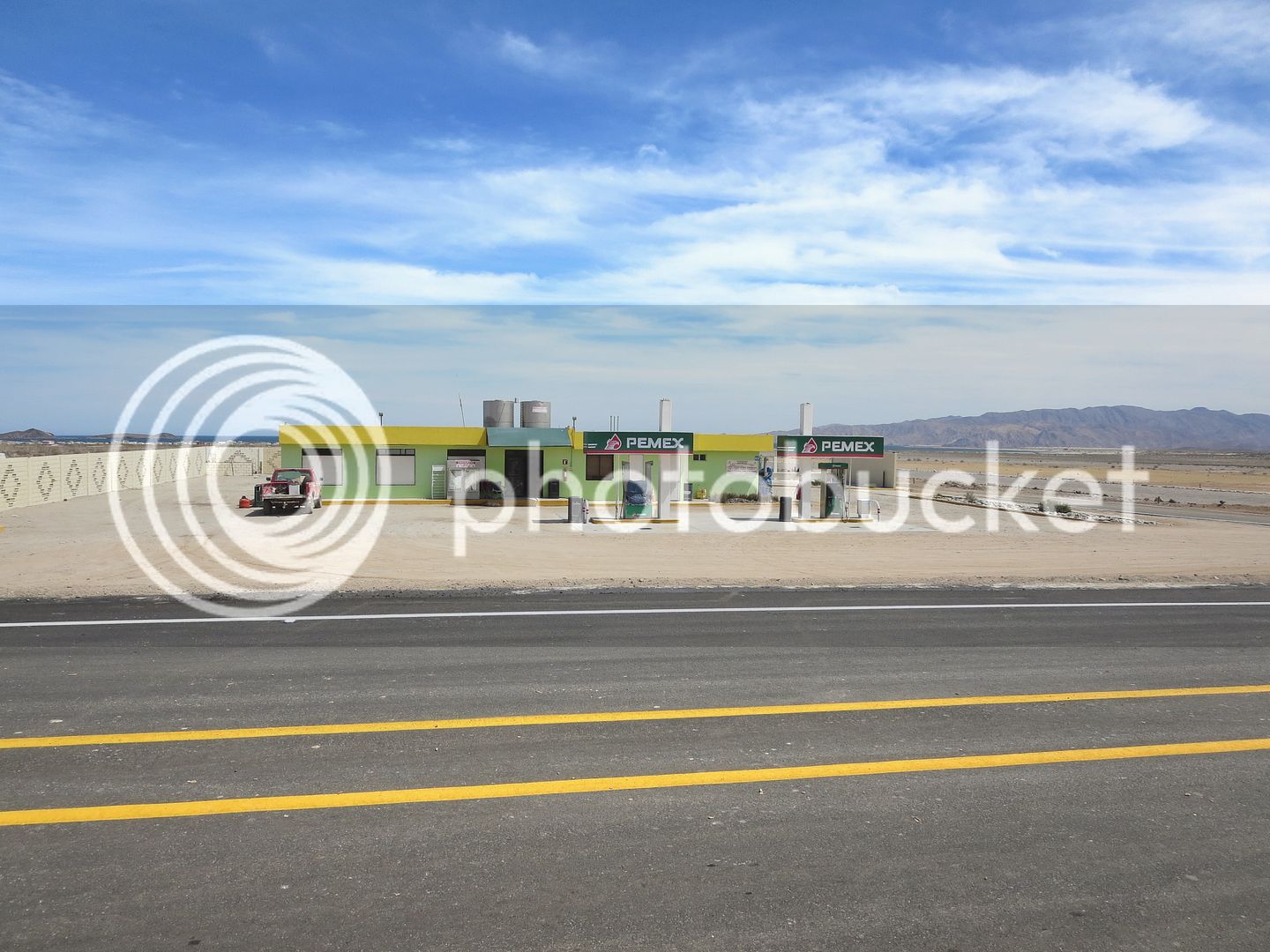

For Mike. This is the gas station in Gonazga Bay. It's paved. Bummer. (Pic from BajaNomad.com)
