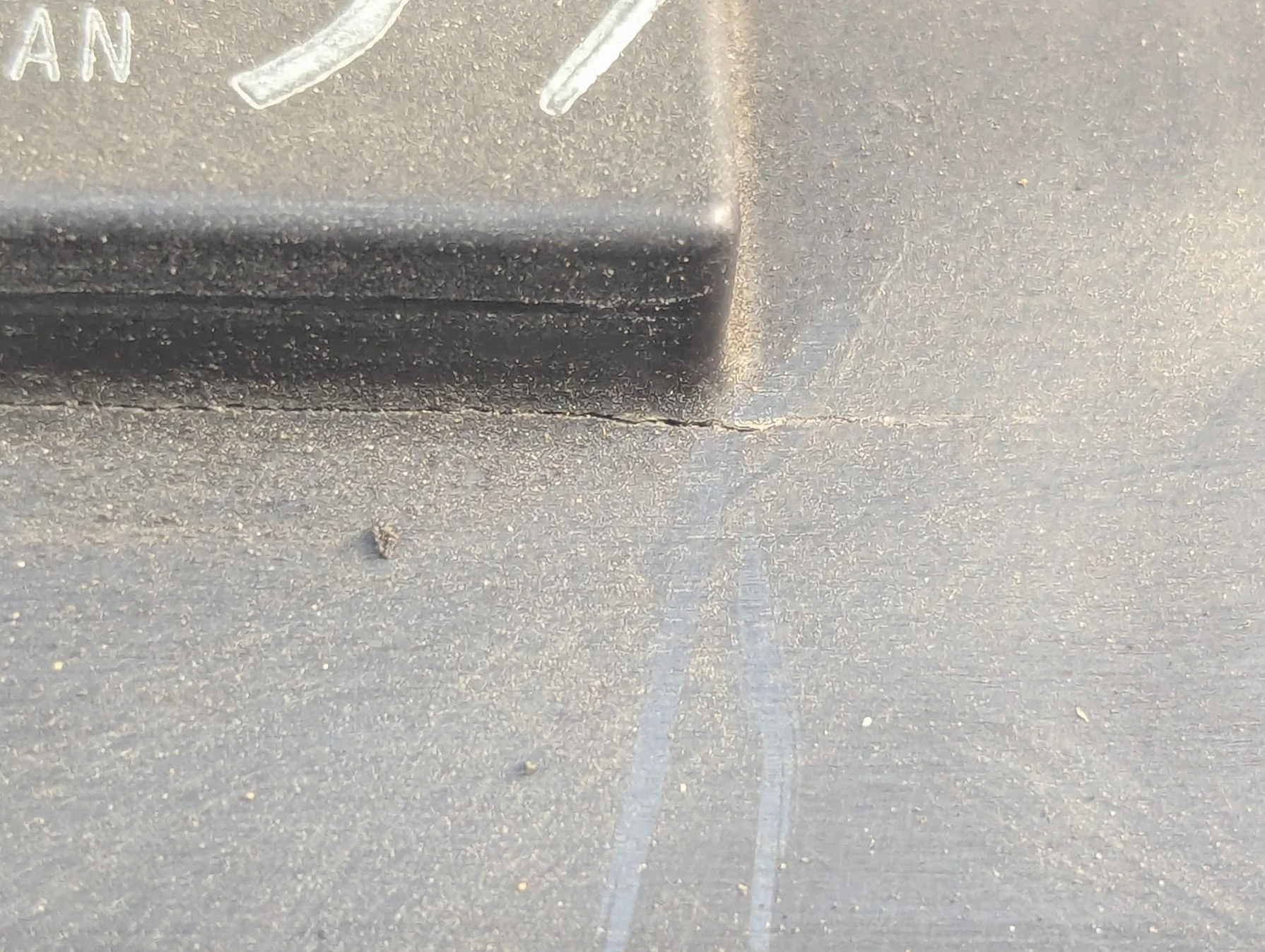

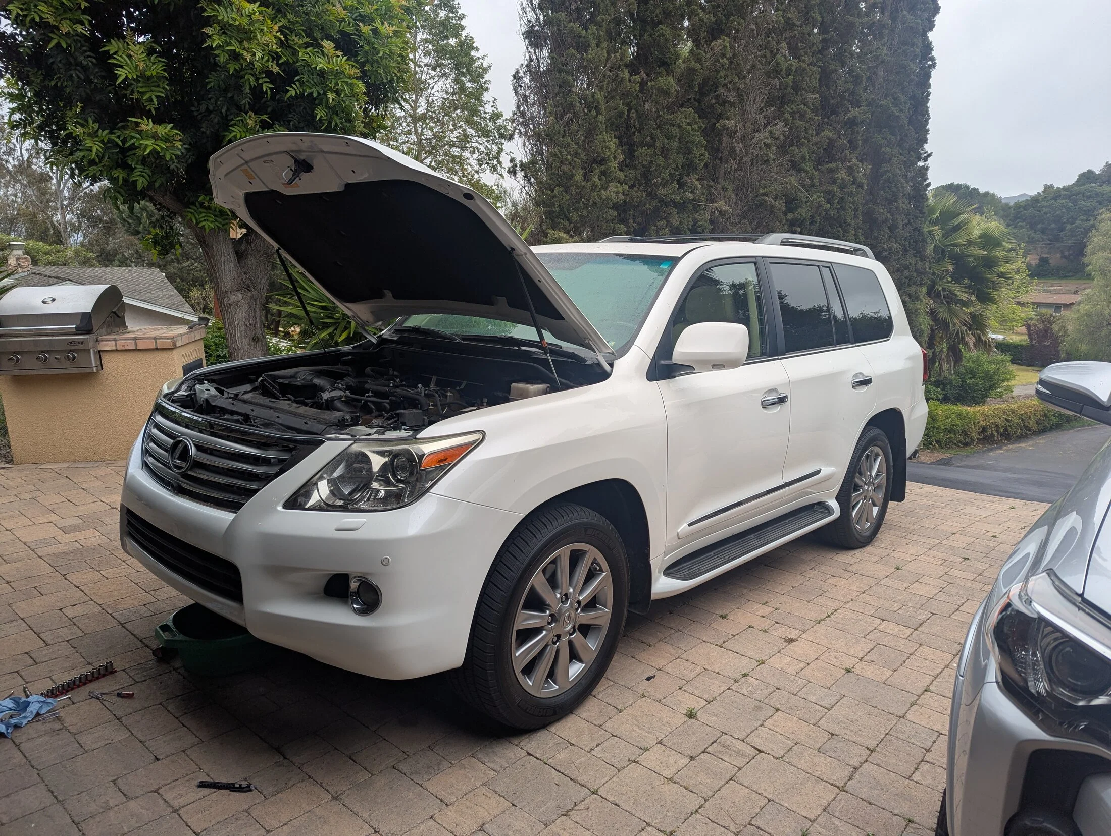

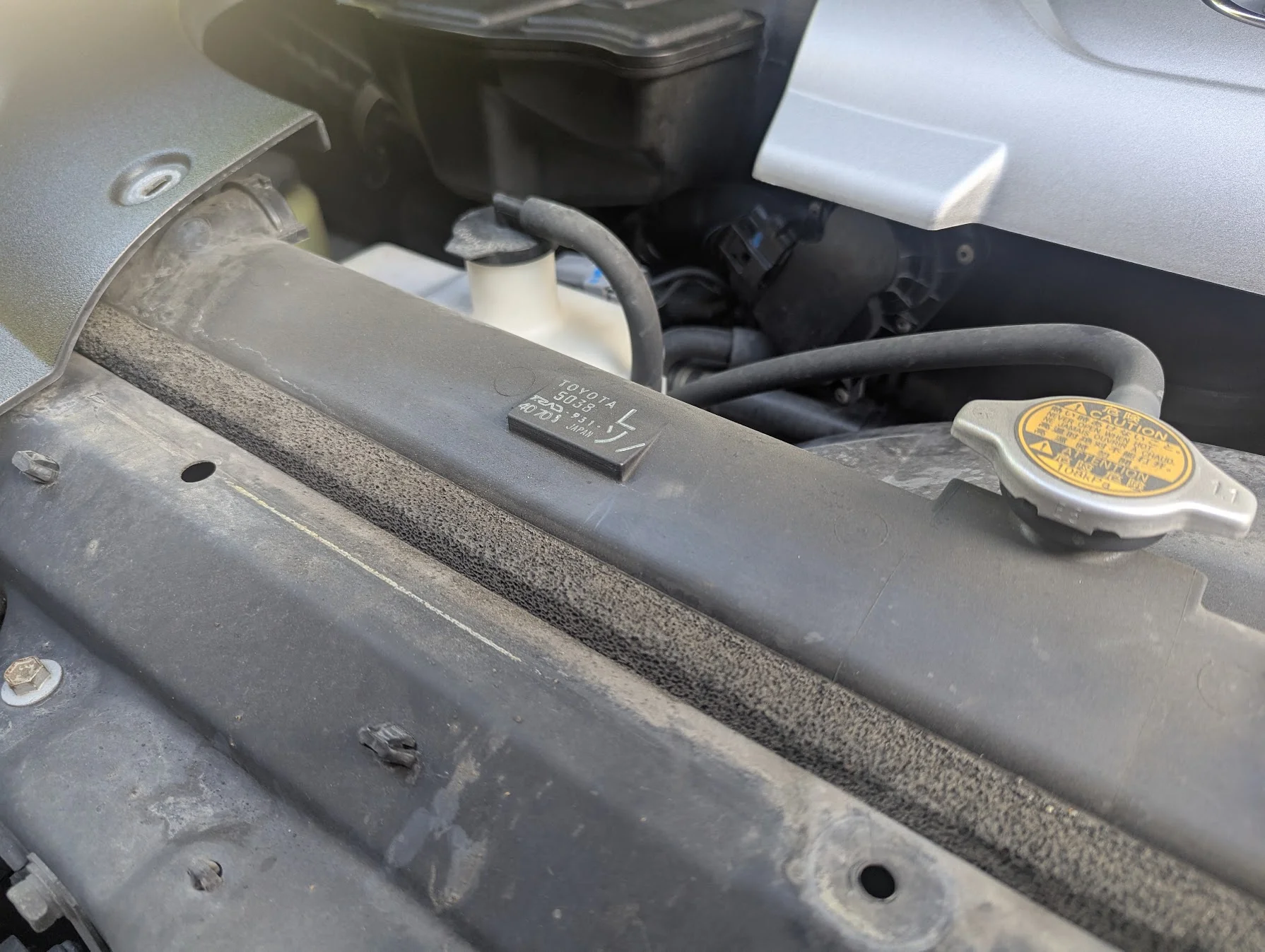

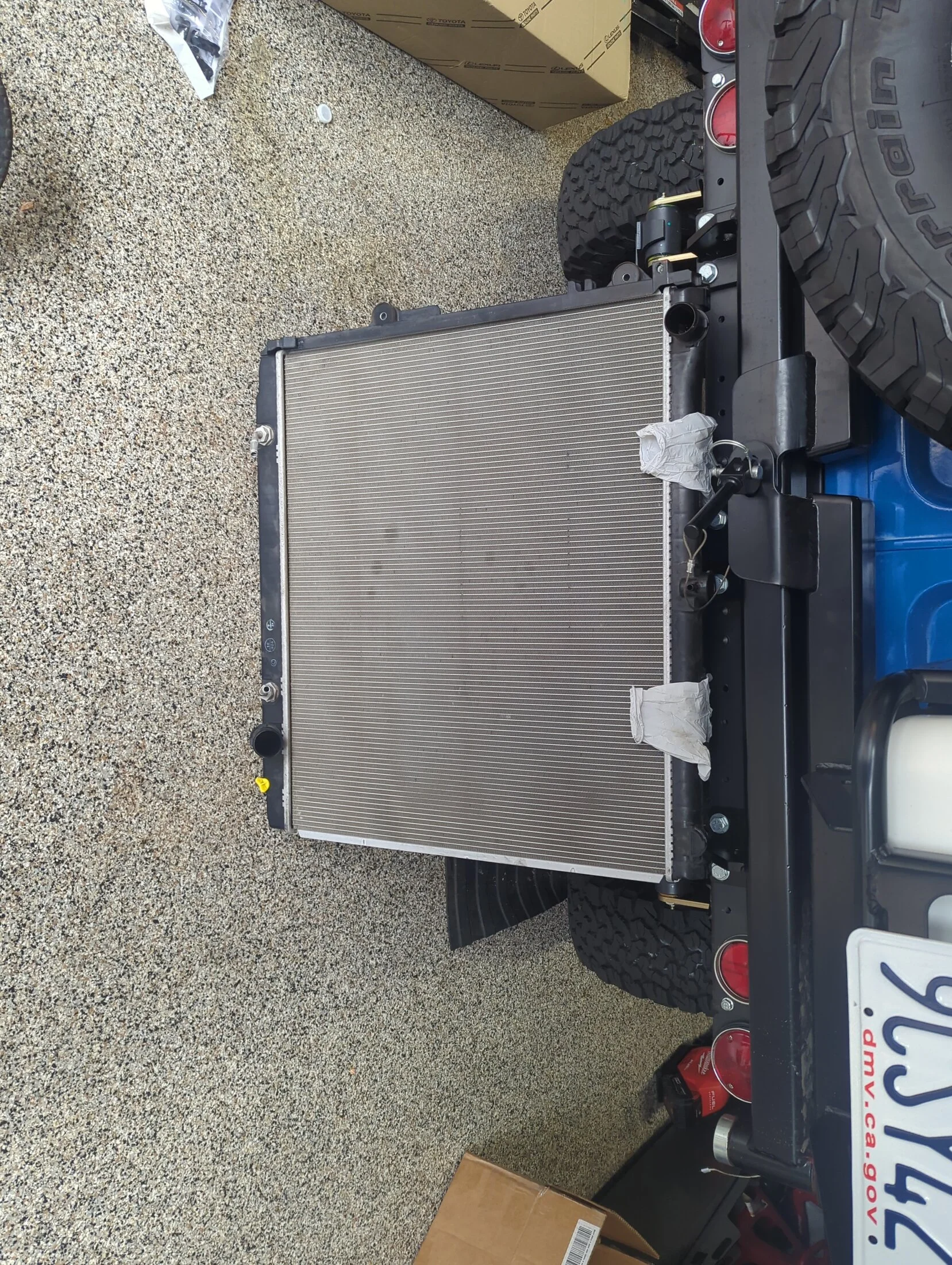

First order of business looks to be the radiator. Thanks to post here on Mud I was able to go out and check that I have the older variant of radiator and I have a hairline crack forming. I'll get one ordered and just do the hoses and heater T's at the same time as well. Kinda funny these were the first two things I did on my 100 as well back in 2016.

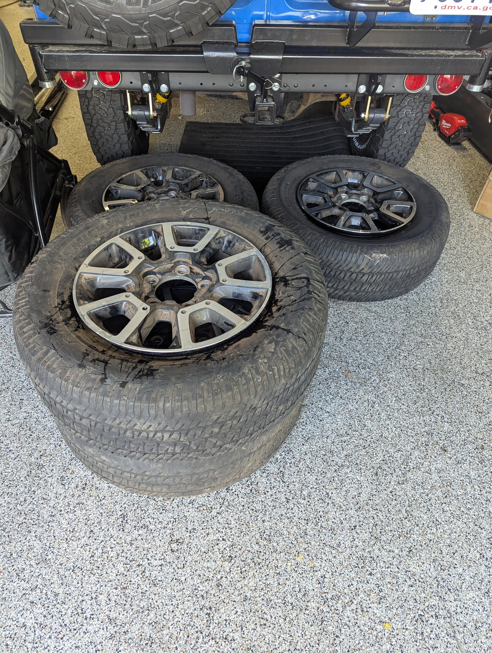

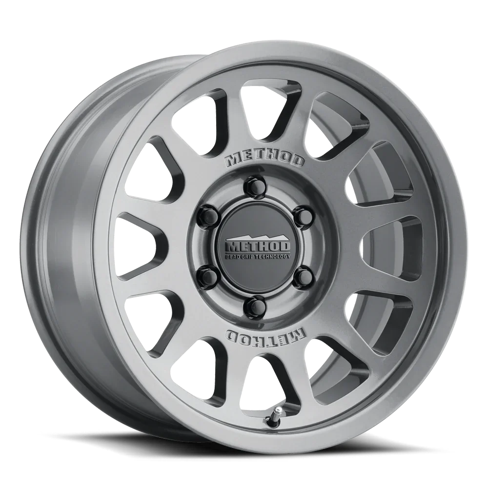

I have a rough plan going so far for LX after looking around at the vehicle some more today. All 4 tires have different DOT Date Codes and 1 is from 2018. The spare looks original from 2011 lol. I'm really not a fan of 20" wheels so I may splurge and change wheels/tires now. Thinking Method 703's in 17x8.5/ET35 and a 275/85r17 but still looking around. Convoy has one that I like as well. Kind of insane what Rock Warriors and the Toyota HE wheels are going for these days.

Google “cracking method wheels” and you’ll see why. I personally know 3 people that have cracked Method wheels.
There’s a reason they’re cheaper than most. Same reason you see tons of them for sale used

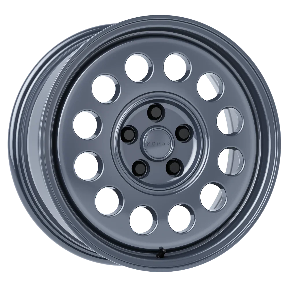

If you don’t find an OEM option you like, although not a fan of their suspension, Icon makes decent price 17” options that seem to Hold up better than methods.
Check Slee’s site, he offers them in lots of styles and sizes. I personally like the “Vector” model
I love the look of the Convoy as well, but in my limited research they had kind of wonky offset options for the 5x150 pattern

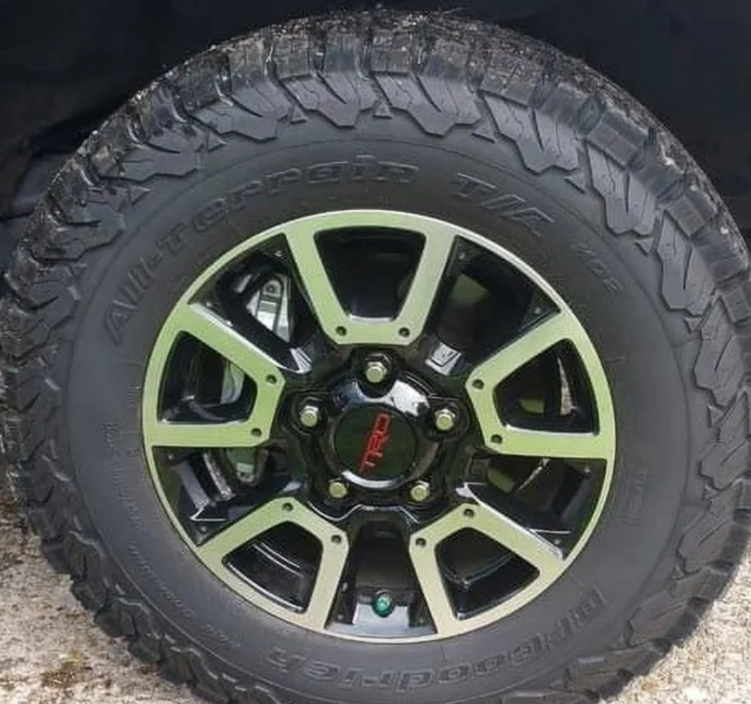

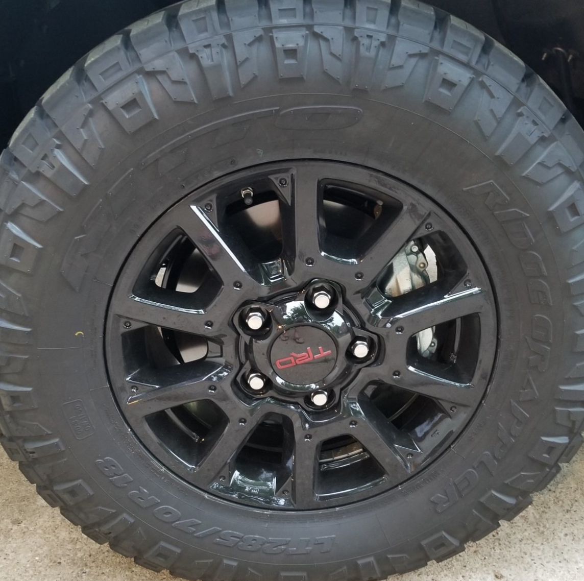

There’s also a Tundra TRD (non BBS) variant that many folks here get and paint black.
They can be found super cheap and plentiful
If ya like the look, you could probably find a set, get them powdercoated and still be ahead on $ wise from a set of new aftermarket offerings.
And they’re the right offset, 18”, etc..
