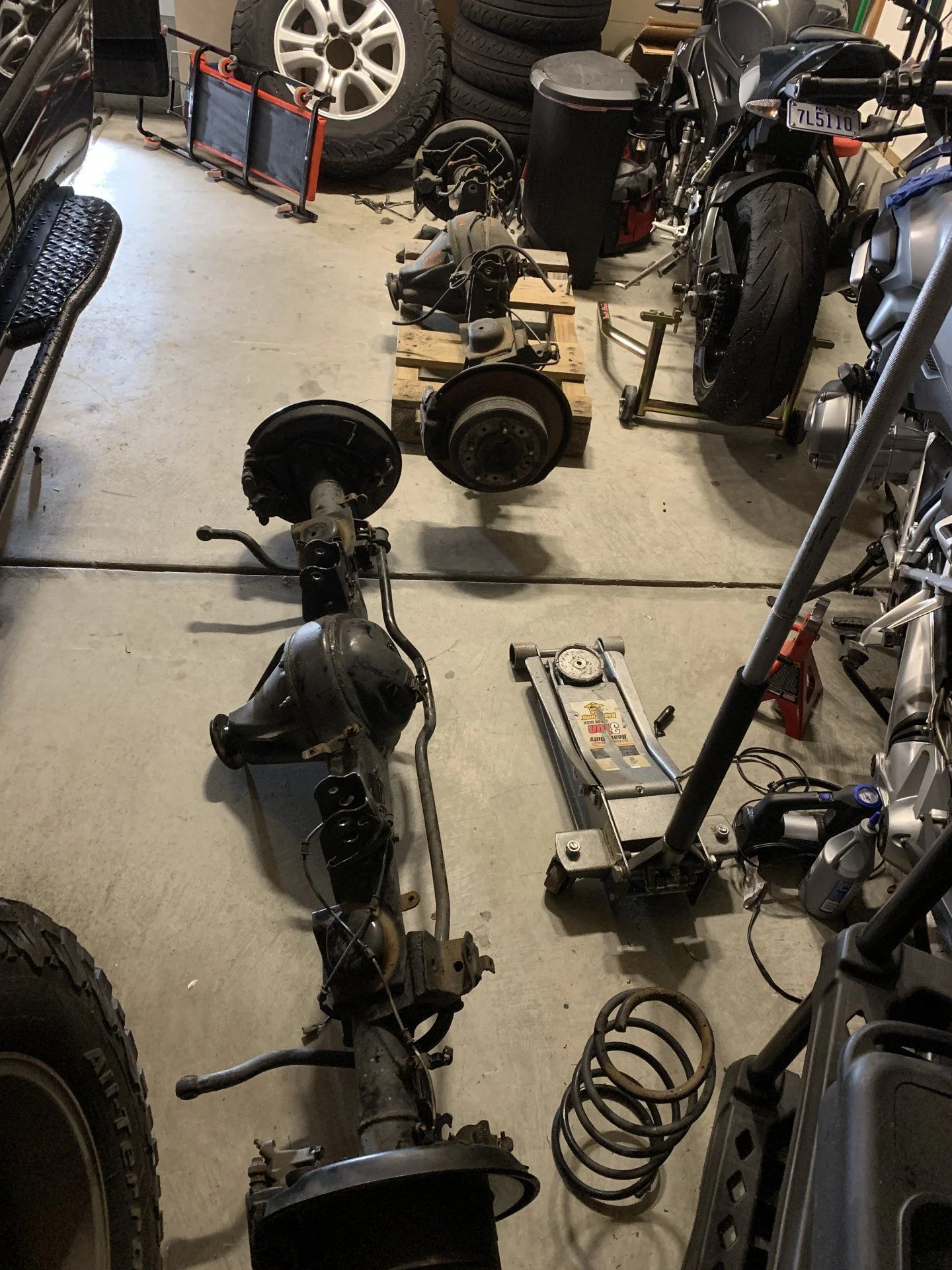

Tore the old axle out and slapped the new one in. It's all located and what not but will hook up the brake lines, speed sensors and other misc. items tomorrow.
Old Axle vs. New

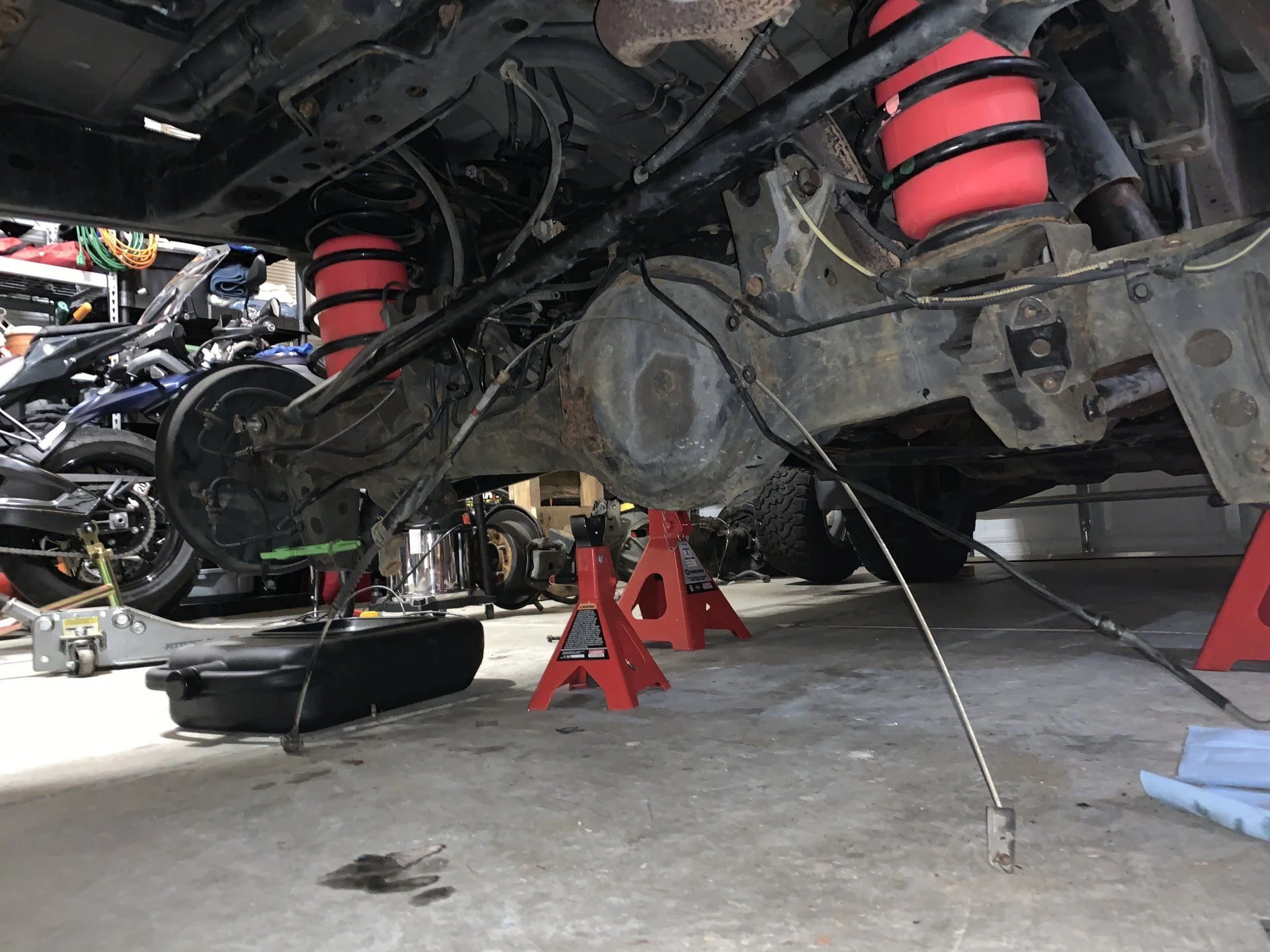

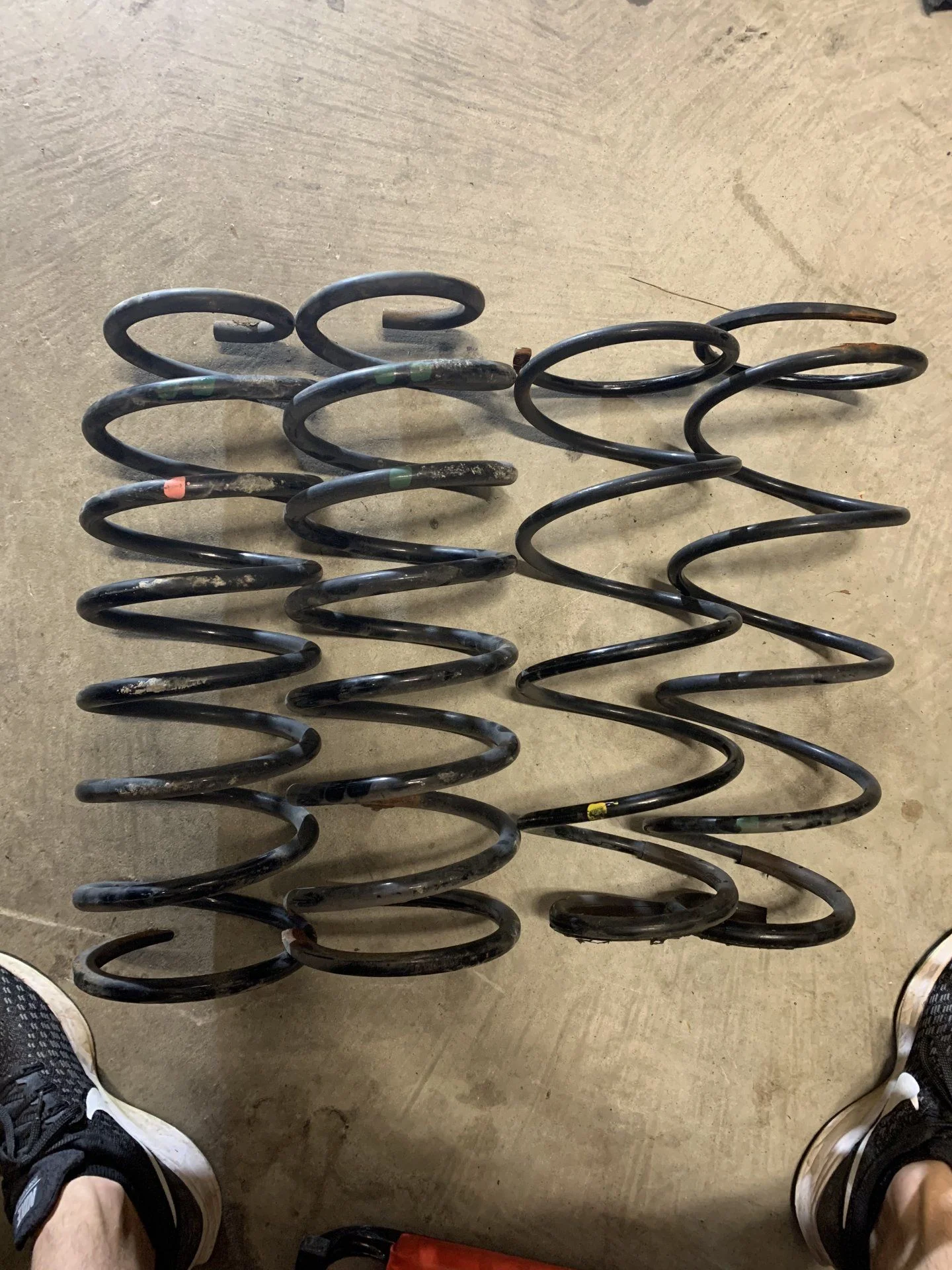

Also snagged some springs from a 2003 Land Cruiser (non-AHC) from the junk yard for cheap so threw those in to try out. Going to play around with the AHC pressures to see if it helps or if it's too springy. LX springs on the right, LC springs on the left. The idea is that the LC springs didn't have AHC to help out so they're stiffer and *should* provide a little relief on the AHC system and help with towing.
But....just in case, I also threw in some Air Lift air bags that I ordered. I'll be towing my autocross car around a few places this summer and last time I towed by Dad's Austin Healey 3000 up to VA, the AHC defaulted into low a few times. This should solve that issue! New axle located.
Really need to get some POR on it. Looks very out of place since the rest of the underside is POR'd
Old Axle vs. New

I put some well used 80 series rear coils on my LX with AHC. If I didn't have the extra weight from my bumper the hydraulic pressures would be too low for the AHC to function properly. From what I have read the 80 series springs have less spring than the 100 series. You may have to add a lot of weight to get your pressures right.
Well, dang. You did get motivated. Sorry I hadn’t gotten back with you yet this week...I’ve been busy dealing with an investigation at work.
What bikes do you have?
no worries man. I have a BMW S1000R. Planning on 2 track days this weekend if the weather holds out.
I’m also babysitting my brothers 1200GS while he’s in CA for the foreseeable future.
Good to know. I was reading more and more last night and was seeing that it may be too much spring. I'll try them out and crank the TB's a little to see if I can get a workable pressure. If not, I'll go back to the LX coils until I find reasons to finally buy a rear bumper, if ever.

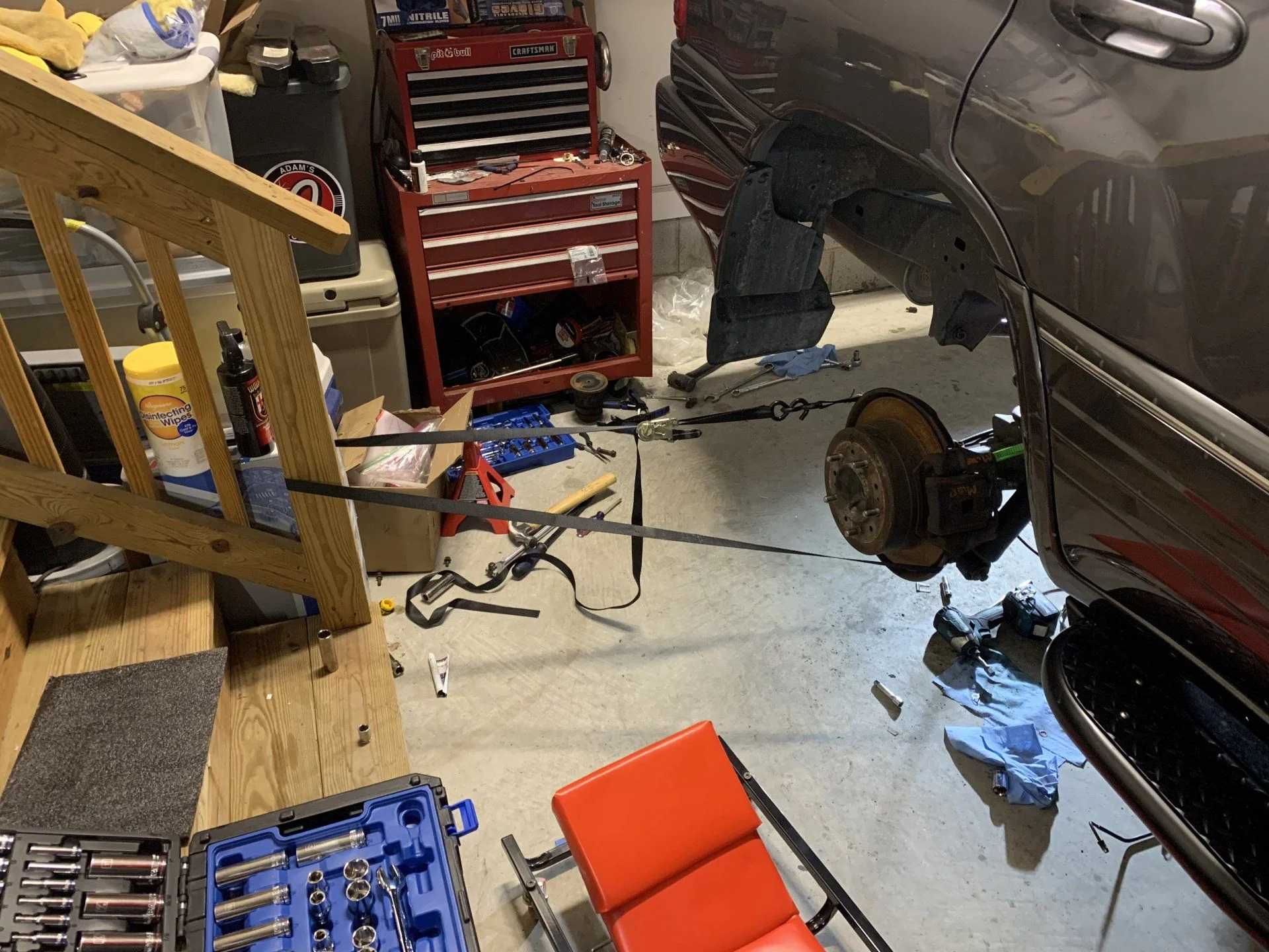

Well didn't get to finish up today as I had wanted. Fought the panhard bar for longer than I care to admit and, as usual, had to undo and redo a couple of items to get them done in the right order... It really wouldn't be a DIY job if everything went absolutely smoothly!
Seems like the panhard bar is tweaked as it wouldn't line up! Even when the length was correct, the bar itself was twisted inside the mount and wouldn't seat. Ended up using some redneck engineering with a ratchet strap to hold length and a pair of vice grips on the bar itself to twist it as I fit the bolt through. PITA!
All that is left is to put the tires on, lower it down and bleed the brakes. Then I need to finish plumbing the new airbags. Everything else is buttoned up and torqued.
