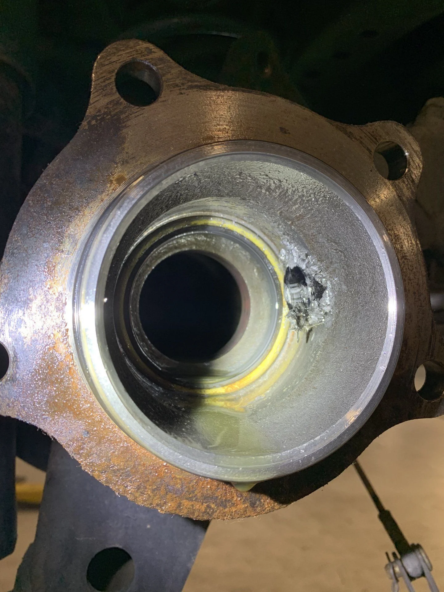

So my 2003 LX470 is leaking from the rear driver-side axle seal again after having them replaced at the dealer last August. Took it back to the dealer this evening thinking it was an installation error but it turned out to possibly be a dying rear diff. They tore it apart and invited me back to take a look. Below is what was found...
Pics of the speed sensor (magnetic) and all of the shredded metal shards. Techs thought that one of the bearings in the rear end is dying and the shards of metal in the oil caused the seal to fail again.

is the 03 lx a 4.11 of 4.30 gear ratio? If 4.30 then my vote would be to get an Elocked axle assembly from a 98-99 100 series.

I think the 03's are a 4.10 with the 5-speed unfortunately. I'm calling ECG monday to ask for a quote

Yeah I was definitely surprised to see it. No noise yet and regular oil changes during my ownership but here we are...Lately, I've been towing a lot more to various races and so something newer with better MPG and more power for towing would be nice. We'll see. Going to try and decide a path forward next week. May go test drive some stuff this weekend.
If you plan to sell it I’d replace seal and just be upfront with buyers on the potential issue. I bet ecgs is gonna be around a grand to replace but that’s just a guess. I can’t see the rationale in dropping that and then moving to another vehicle.

Agreed. I may pull the center section and look for anything obvious. Seems straightforward.
If you want to sell don't do ecgs just get a new rear axle from a junker and sell. Go for the diesel Cherokee over the hemi.
If keeping I'd still say go for a replacement axle from a junker unless you are looking to do an axle at the same time or do the front gears as well.
Actually look for a locked axle from a 99 and a 4.30 front from a 00-02.
98-99 had through weak front diff's.
You will get better gearing and a locker for a much better deal that way.
