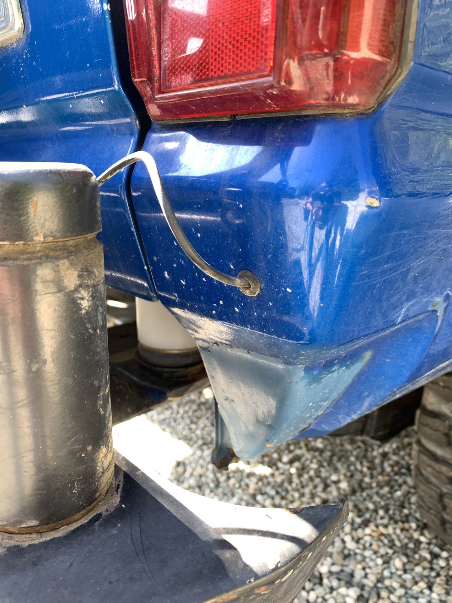

That’s how I routed mine. Really no other option for license plate area. You could look at bumper mount instead to avoid drilling the tailgate.

I have a bumper with swing outs so my license plate is closer to the right tail light, but same idea.
