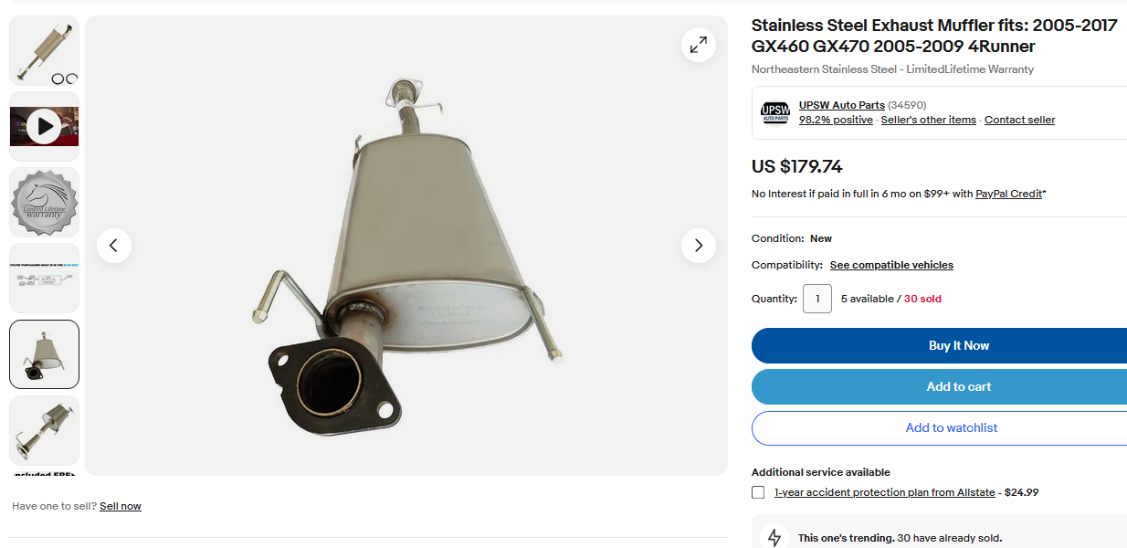

Thanks for that Info.Be careful with that exhaust, it might drone like crazy at highway cruising speeds, particularly with the turndown at the end that will reflect exhaust noise off the pavement and back into the rig. The muffler they include is pretty short and there is no resonator to reduce the drone between ~1,700 and ~2,400 RPM that can be quite loud in a GX (this corresponds with ~55-75 mph cruising speeds). This doesn't bother some people, but drives me crazy on the highway.
You might want to find a takeoff GX/T4R stock exhaust from a less-salty part of the country if you are drone/noise sensitive.
Knowing that you have a welder, I built much of my exhaust using Amazon SS flux core wire and various 304 SS pieces from eBay/Amazon/Summit Racing/Stainless Works. I now have a legit mixed 304/409 SS system (the OEM system is 409SS but I think it has mild steel flanges). A few flanges, some straight pipe, bends, and a muffler, and you'd be golden. I did all of my cutting using cutoff wheels but have since upgraded to a metal-cutting bandsaw that would have made the cuts easier.I'd never get $1200 past the Supreme Allied Commander.
Will prolly just get 2 Flanges on Ebay and Weld them on using our 110V Lincoln & Wire Wheel and VHT what I have.
