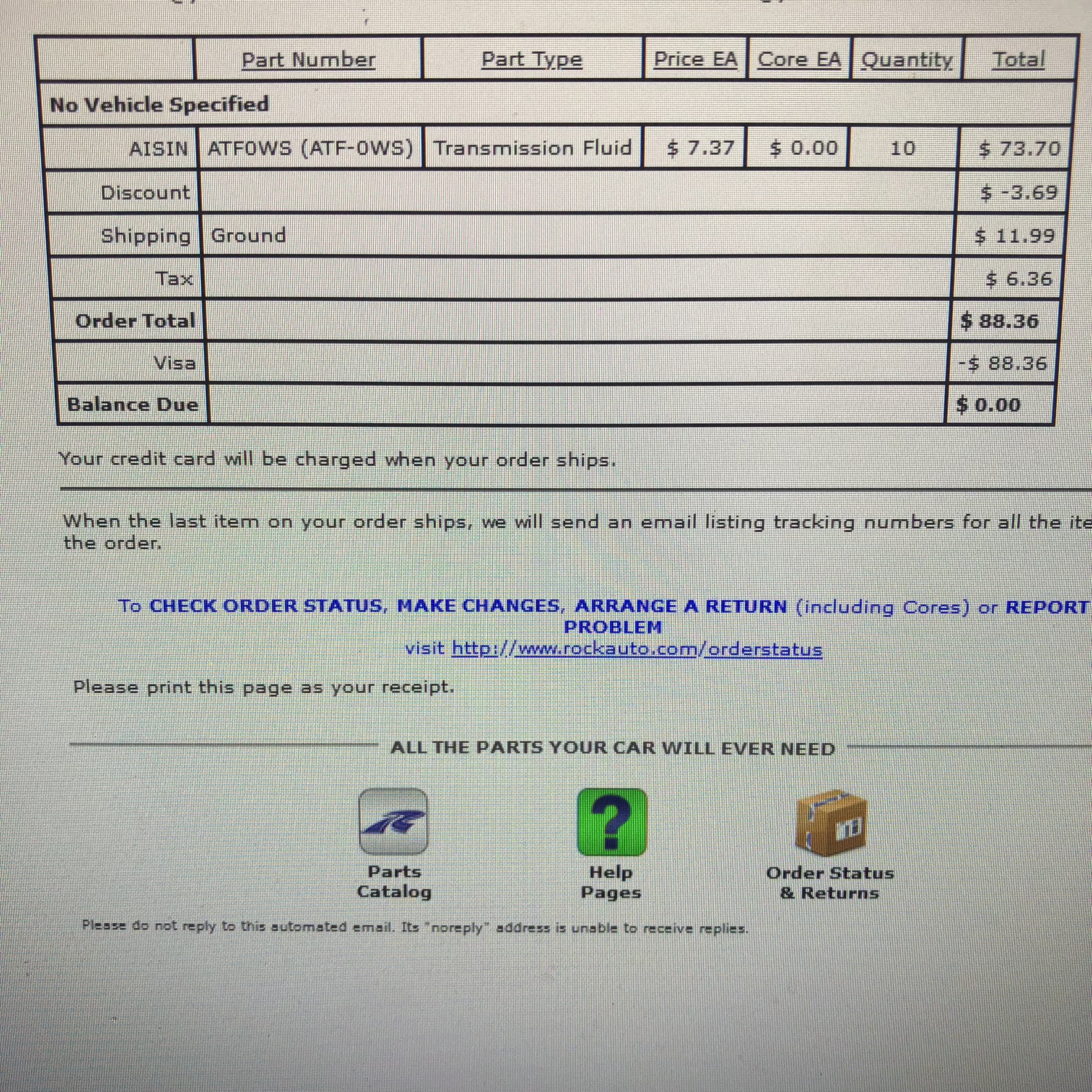

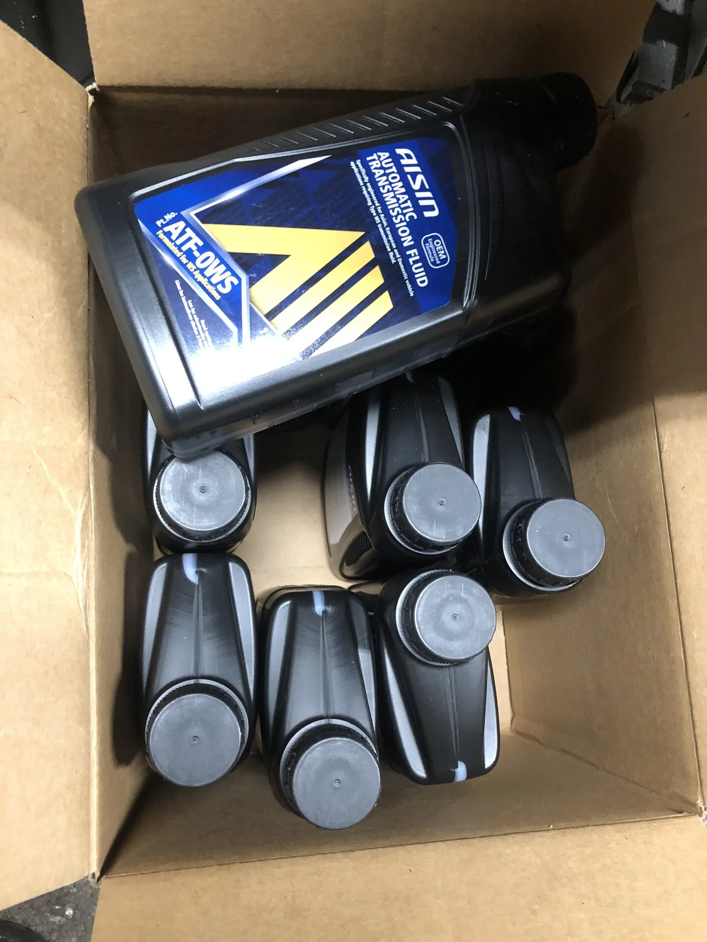

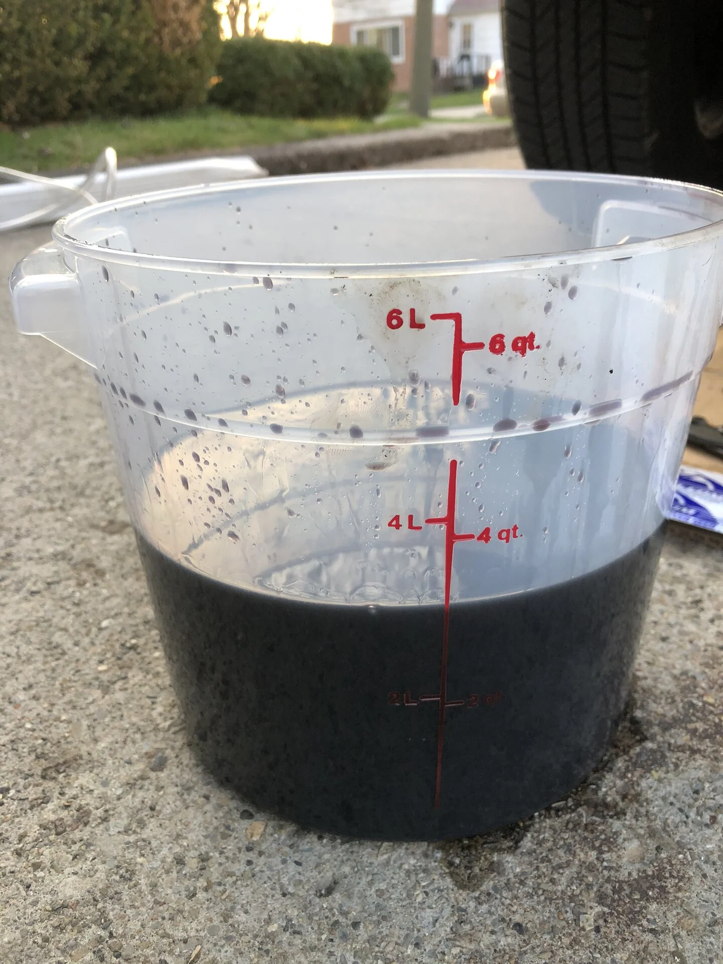

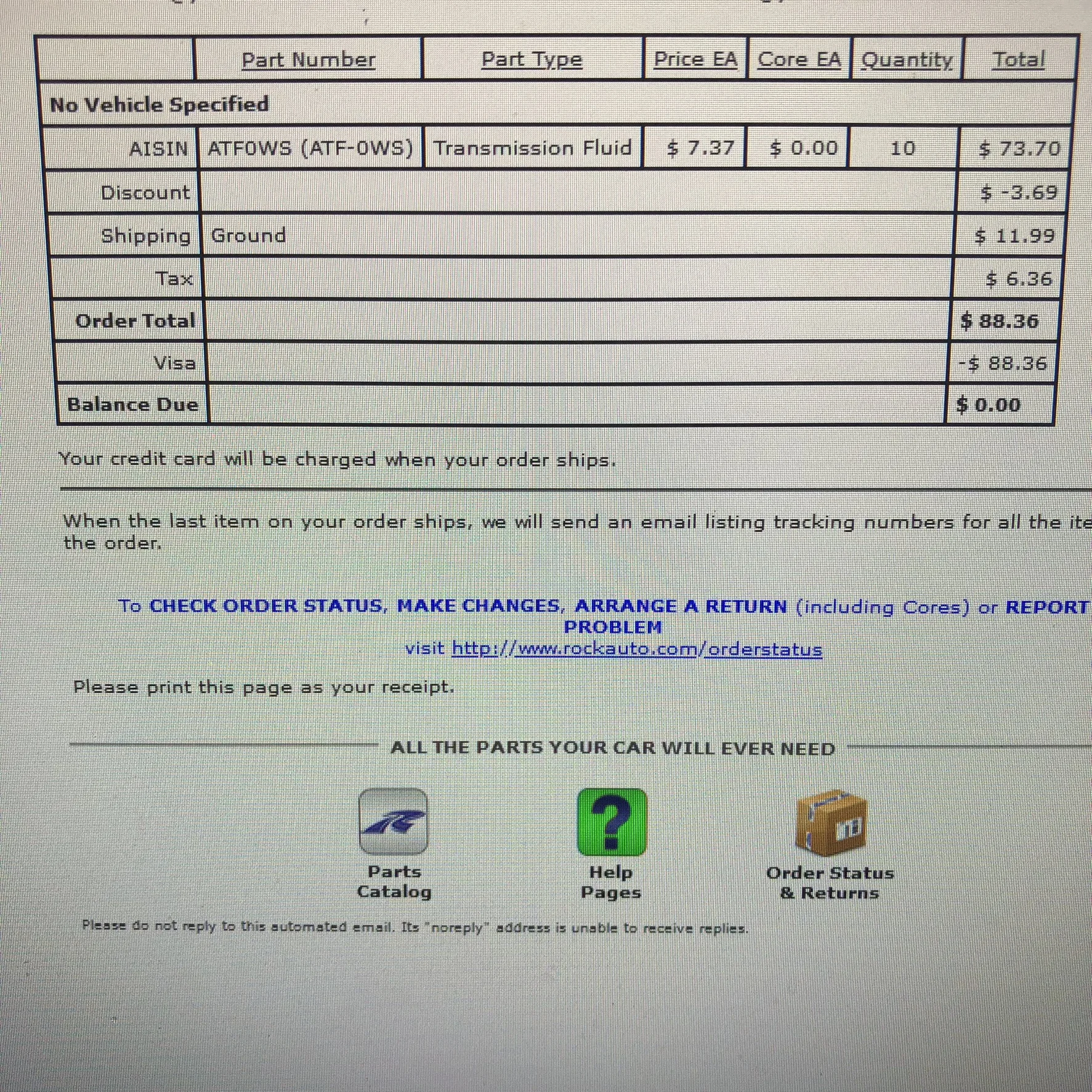

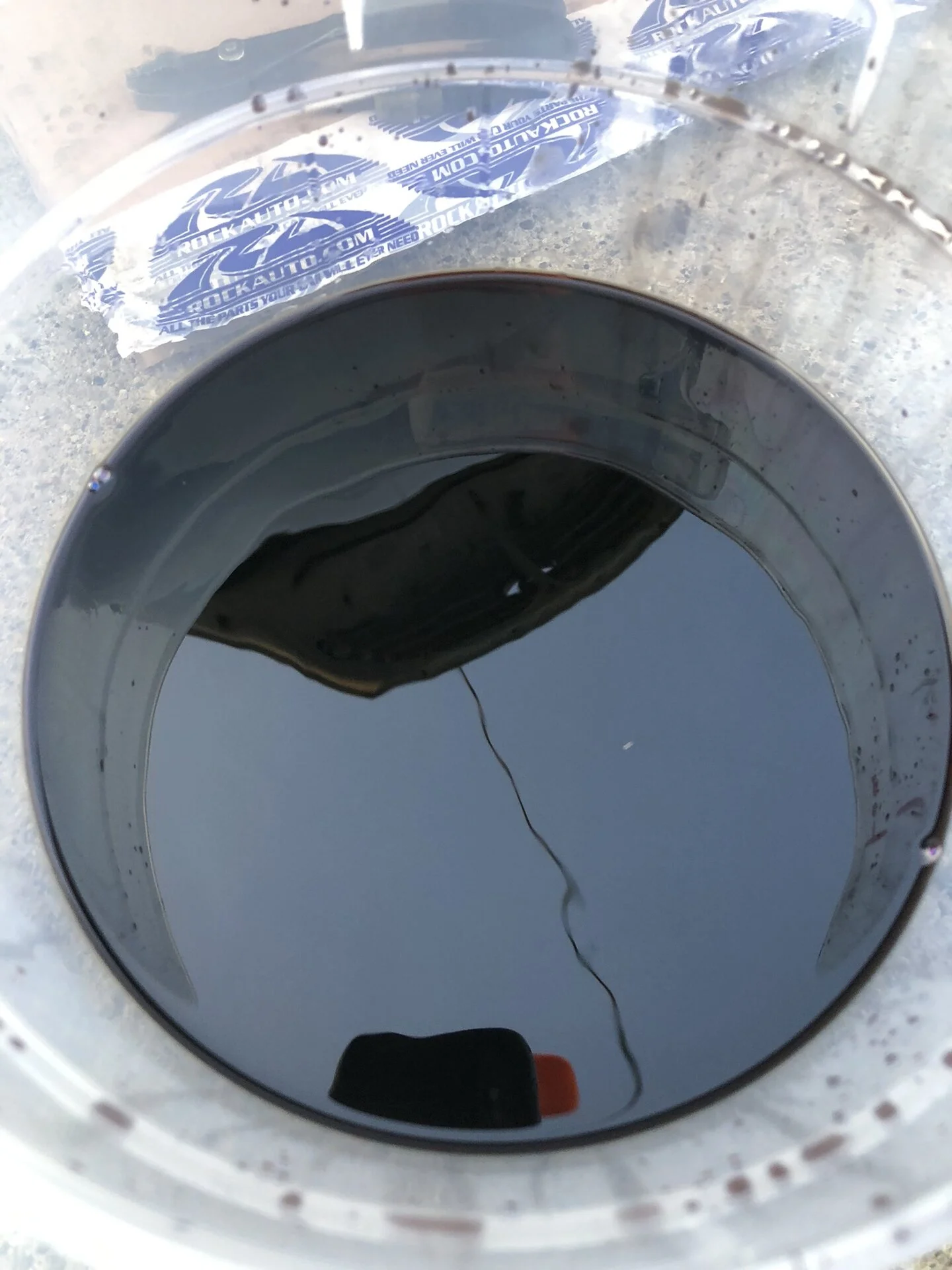

Tranny Fluid Likely Never Changed - Drain, Measure, Replace with Aisin ATF WS - Change by Dilution to Protect Torque Converter - Drained & Replaced 10 Qts - Done

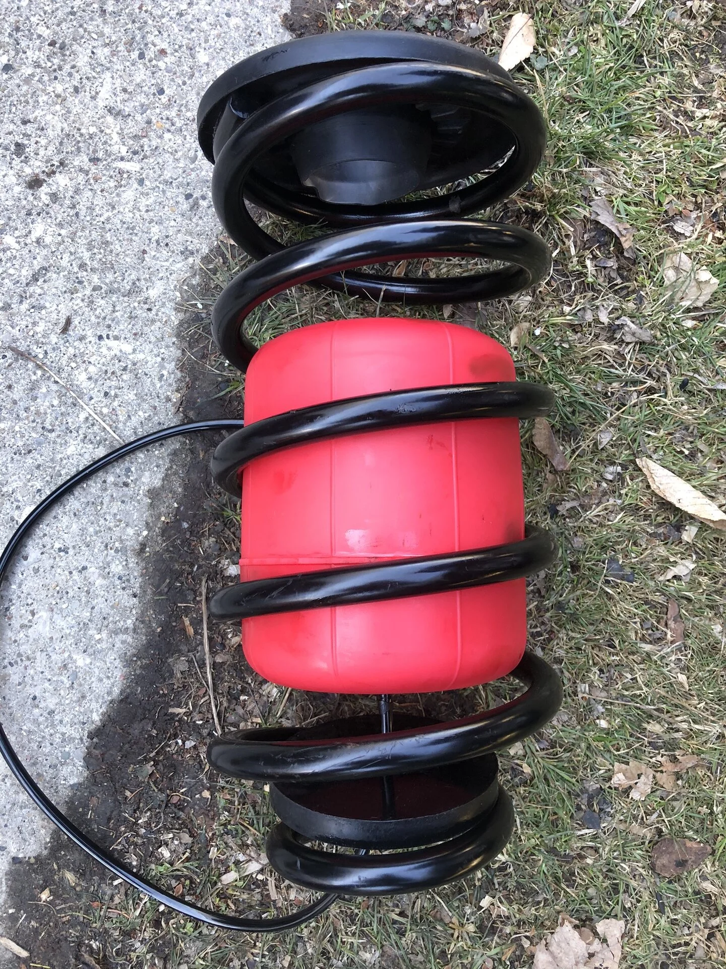

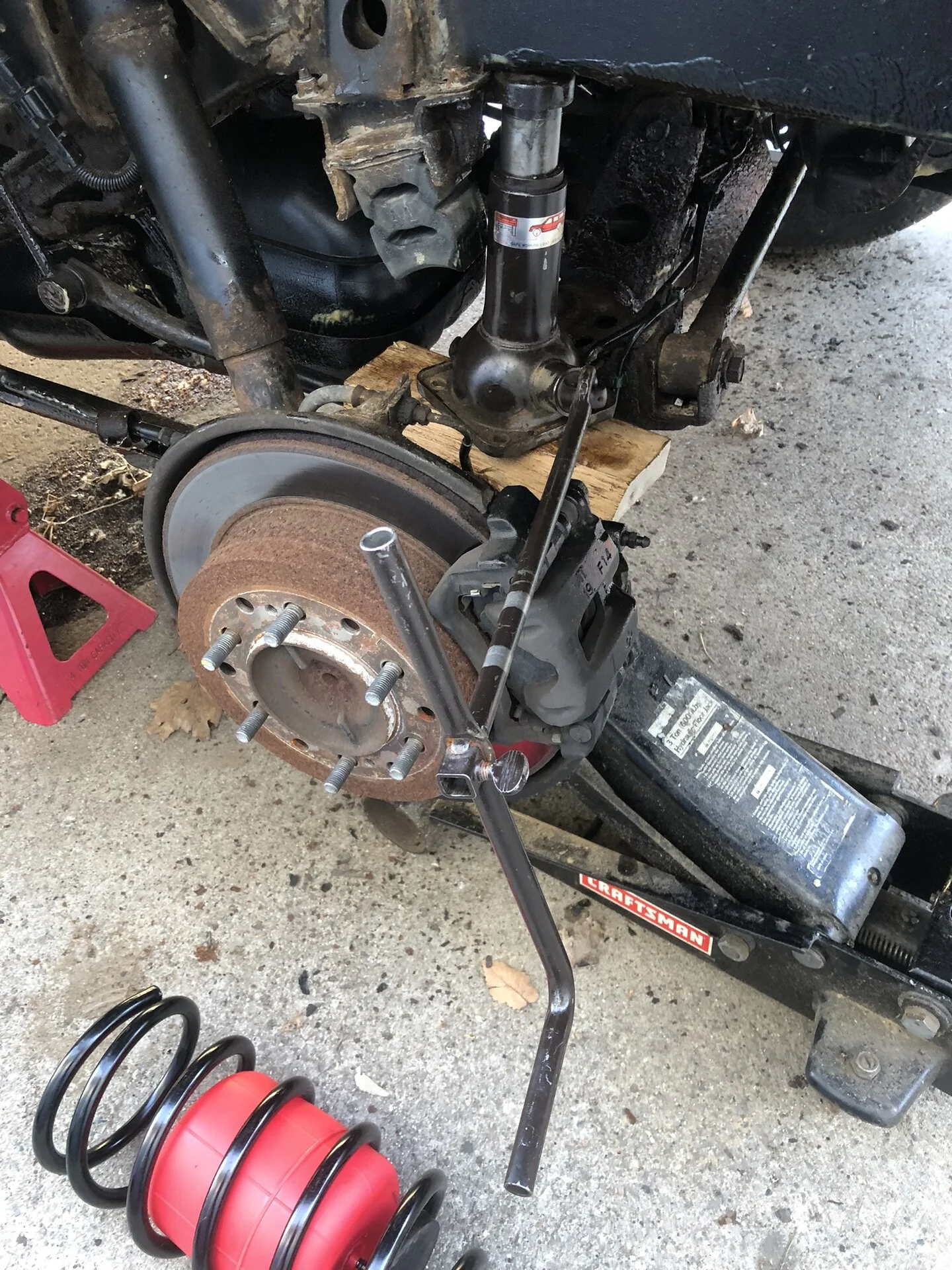

Rear Airbags Leaking - Already Replaced with MOOG Coils (Part # 81045) and Airlift Bags (Part #60809) and MOOG Spring Isolators (Part #160061) for Top of Springs. Plumb Air Bags to Schrader Valve. - Done

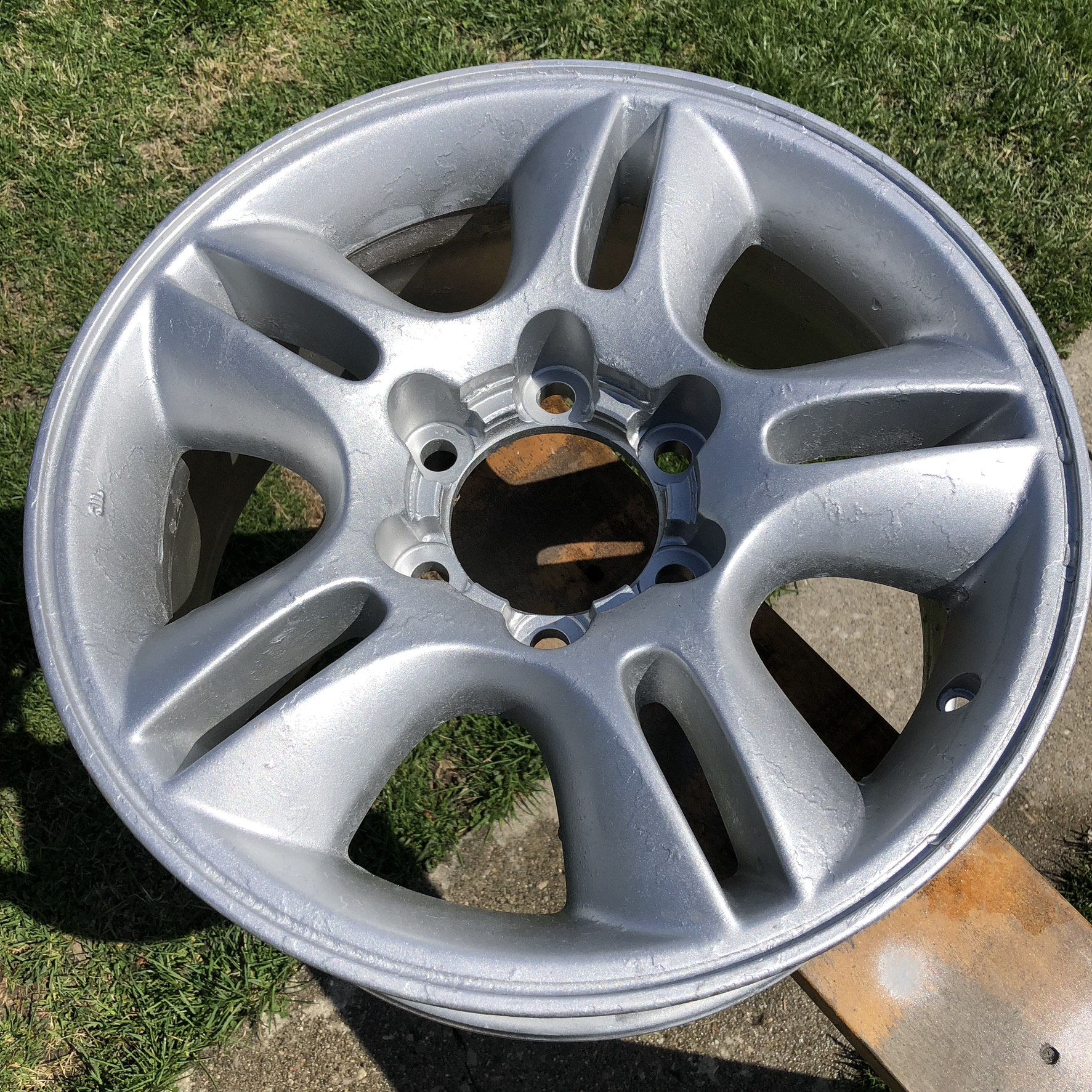

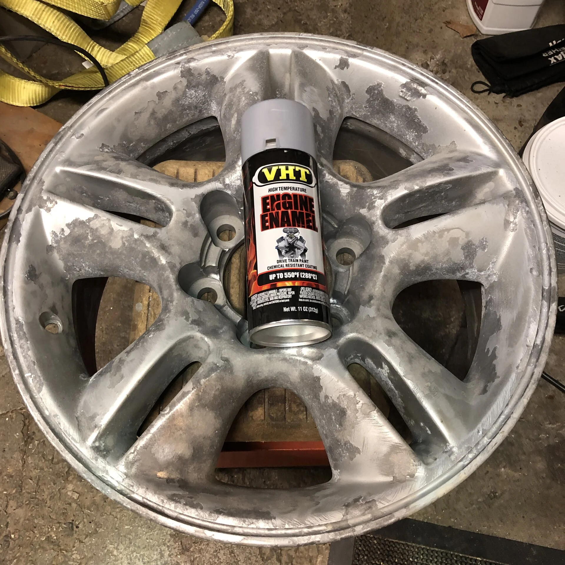

Spare Tire Trashed - Corrosion - Sand Blast & Repaint with VHT - Get used Tire for Replacement - Went another Route. Bought New Tire Ebay ($105 and Used Tire Ebay ($45). All Tires and Wheels Match. Sell Original Spare??

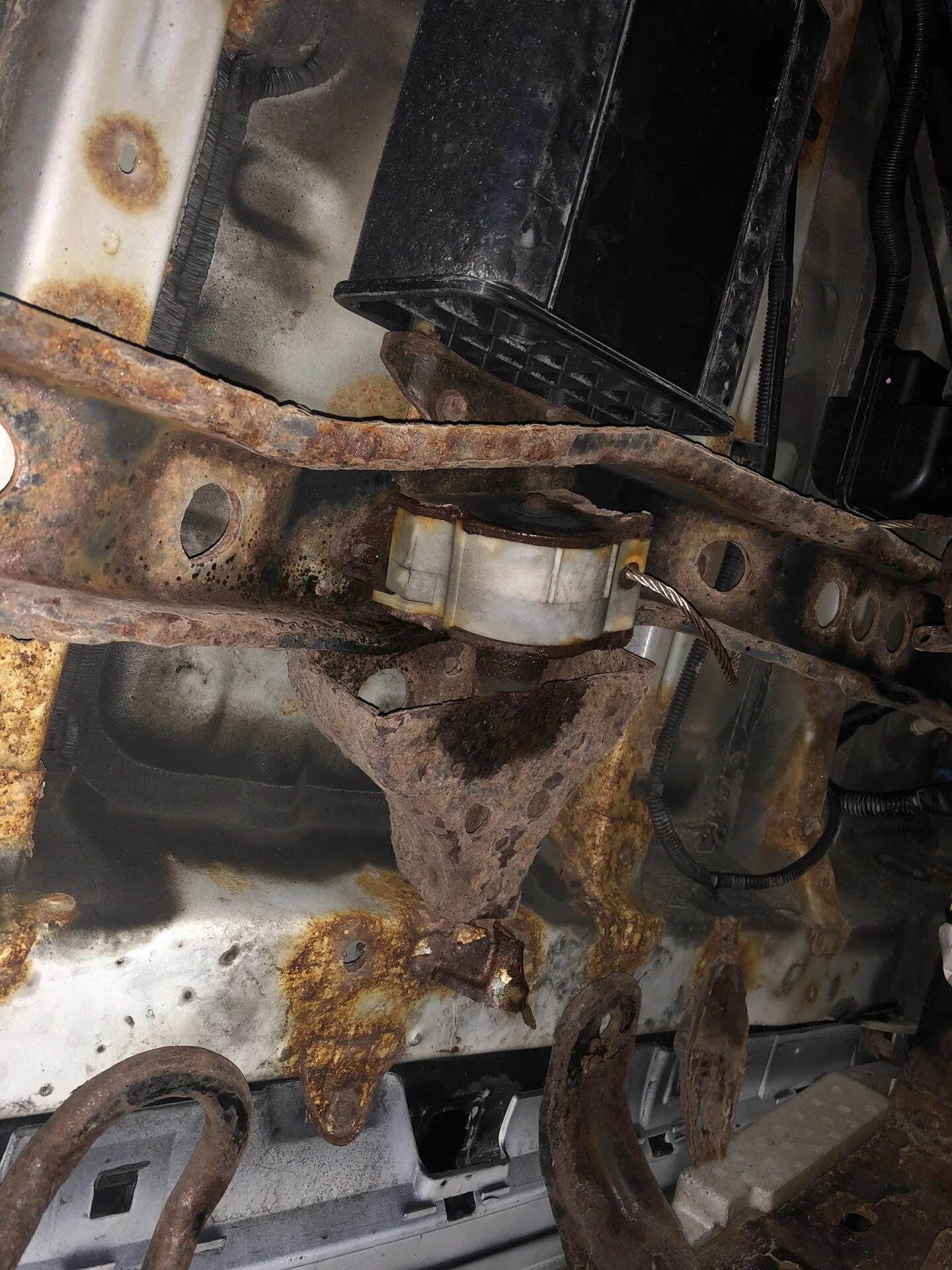

Rust under Passenger Brake Light - Remove Housing, Wire Wheel, Naval Jelly, Brake Parts Cleaner then Prime & Paint - Done

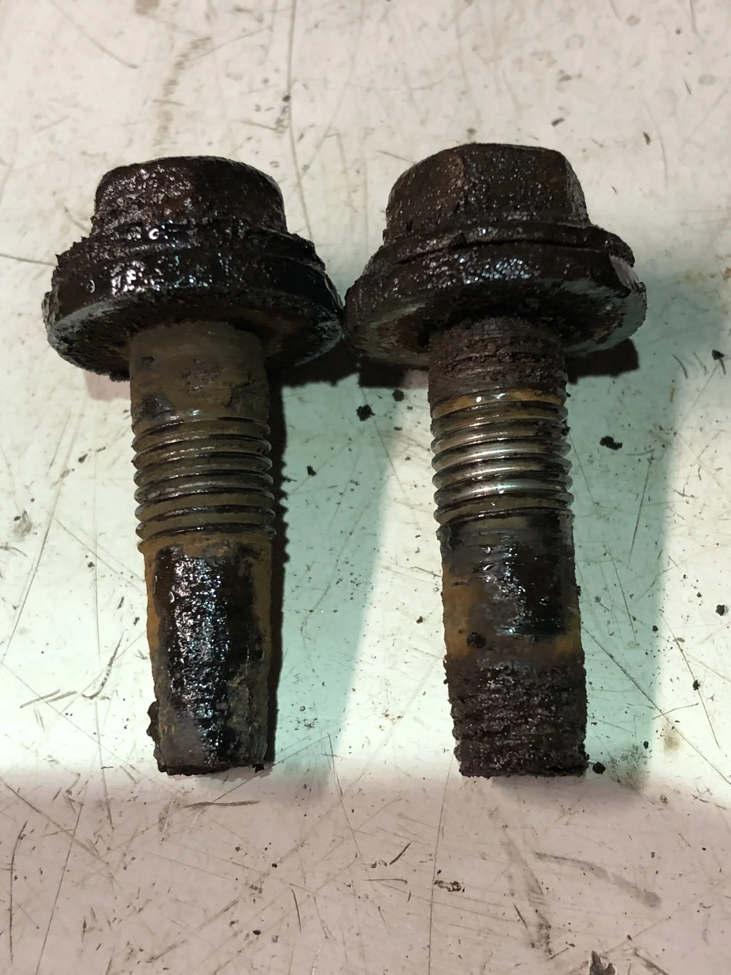

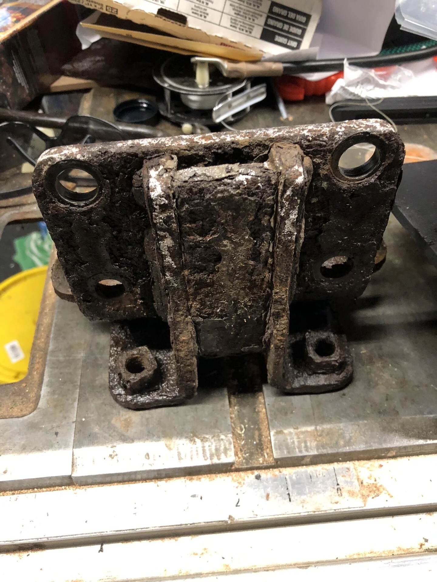

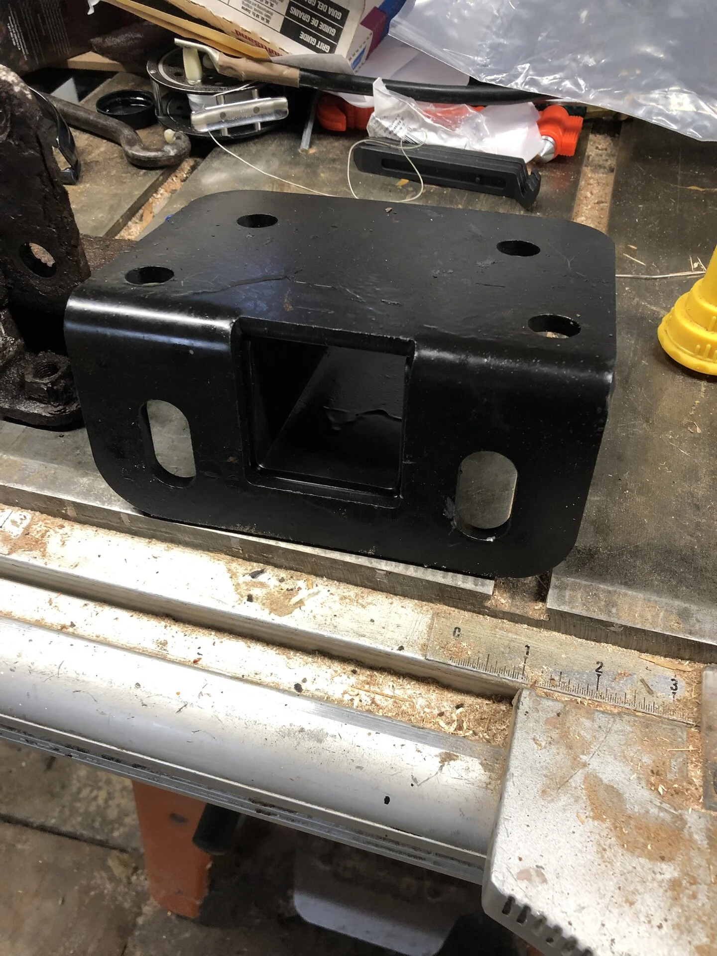

Remove Rear Hitch Plate - Weld and Bolt on Hitch Step from Ebay - $40 - Bolts Snapped off - Drill & Easy Out - Bought Drawtite Hitch Amazon $200 - Need to Relocate Light Harness

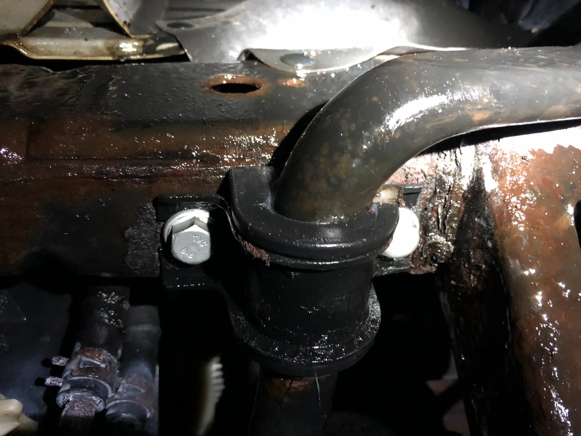

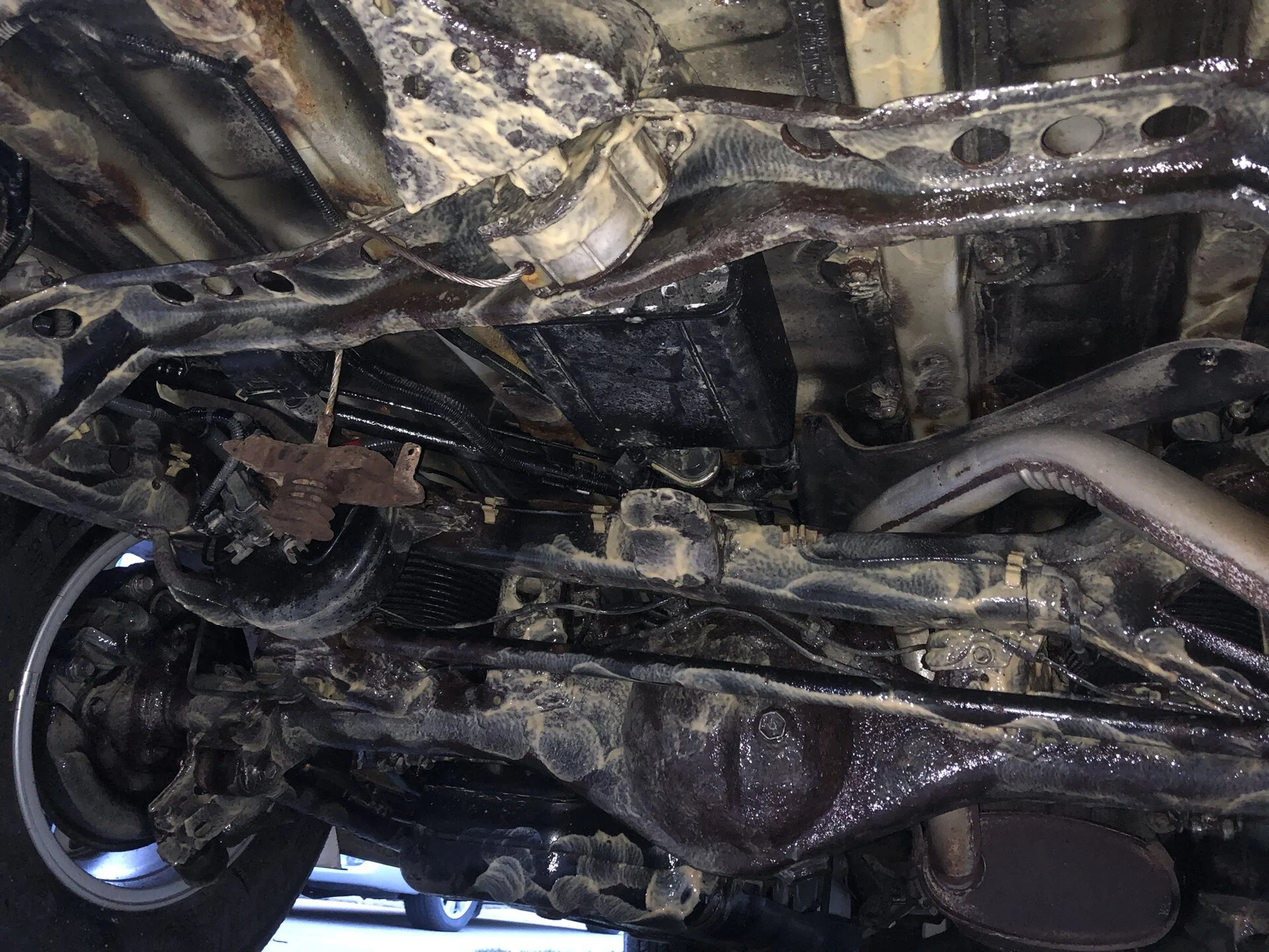

Rusty Chassis - Wire Brush, Compressed Air, 2 Gallons Fluid Film - Done

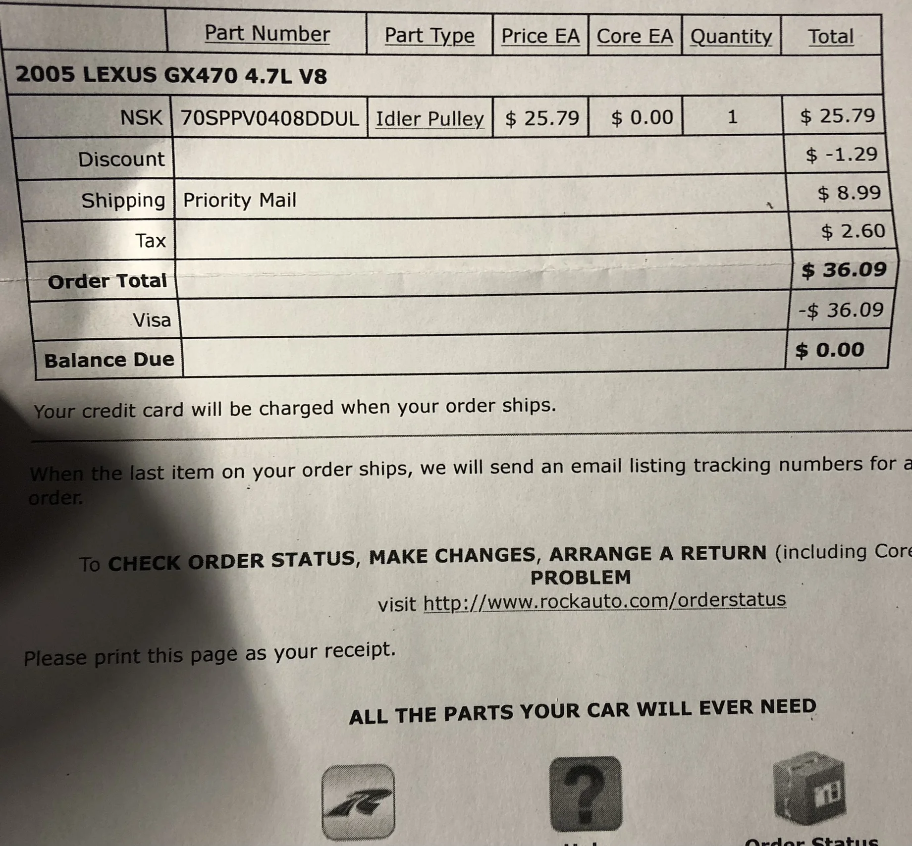

Replace Squealing Idler Pulley - Replace with Nachi bearing - Ordered SKF RockAuto $36 - See Post Below - Done

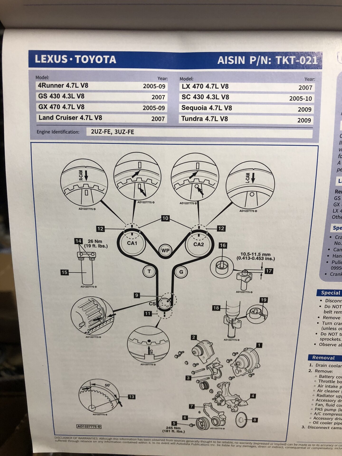

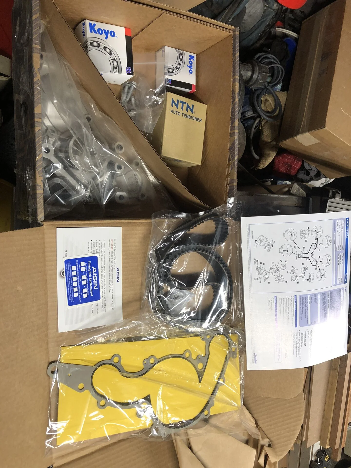

Order Tools for Timing Belt Replacement - Crank Tool, Caps to stop Leaks, etc

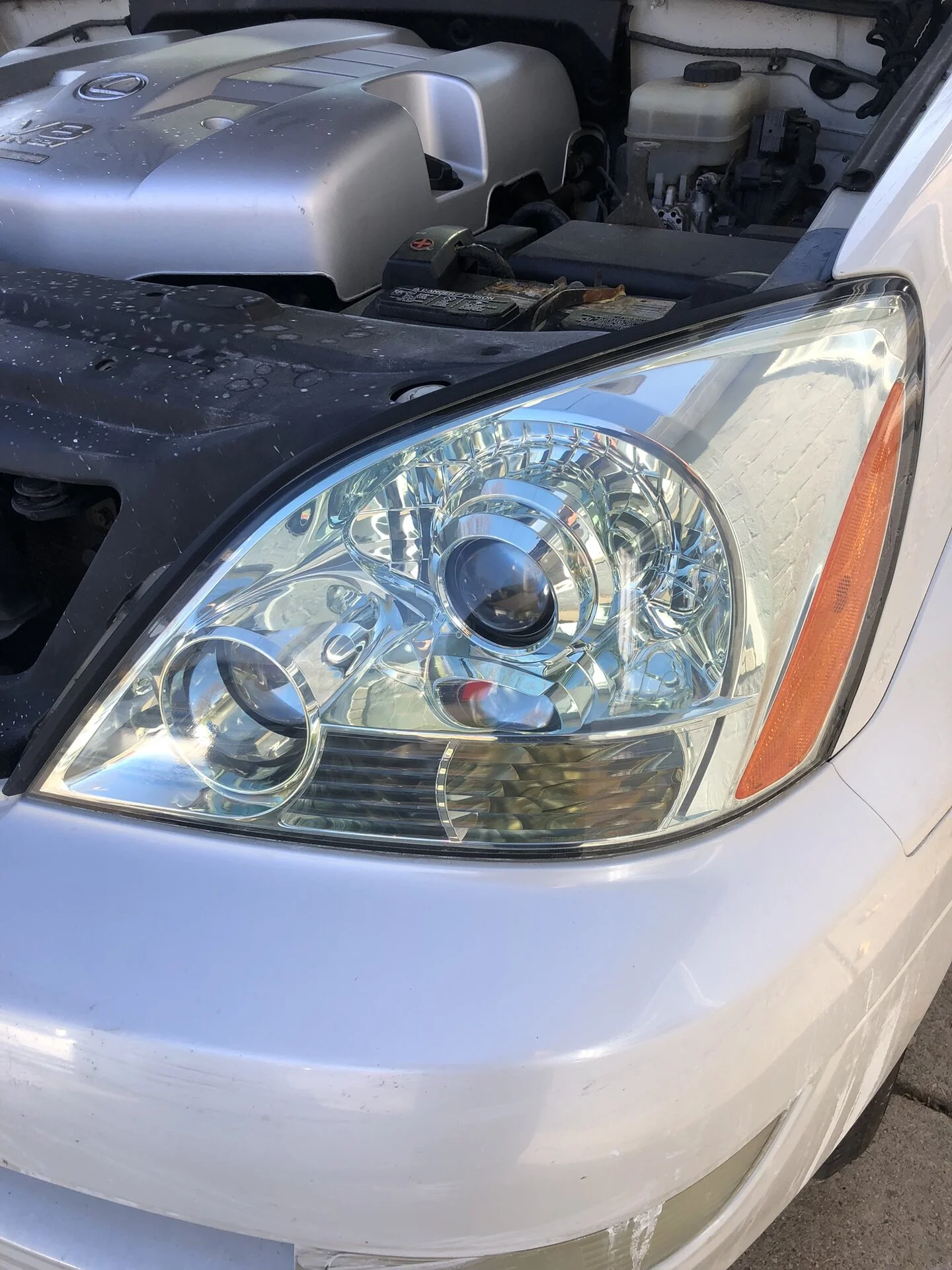

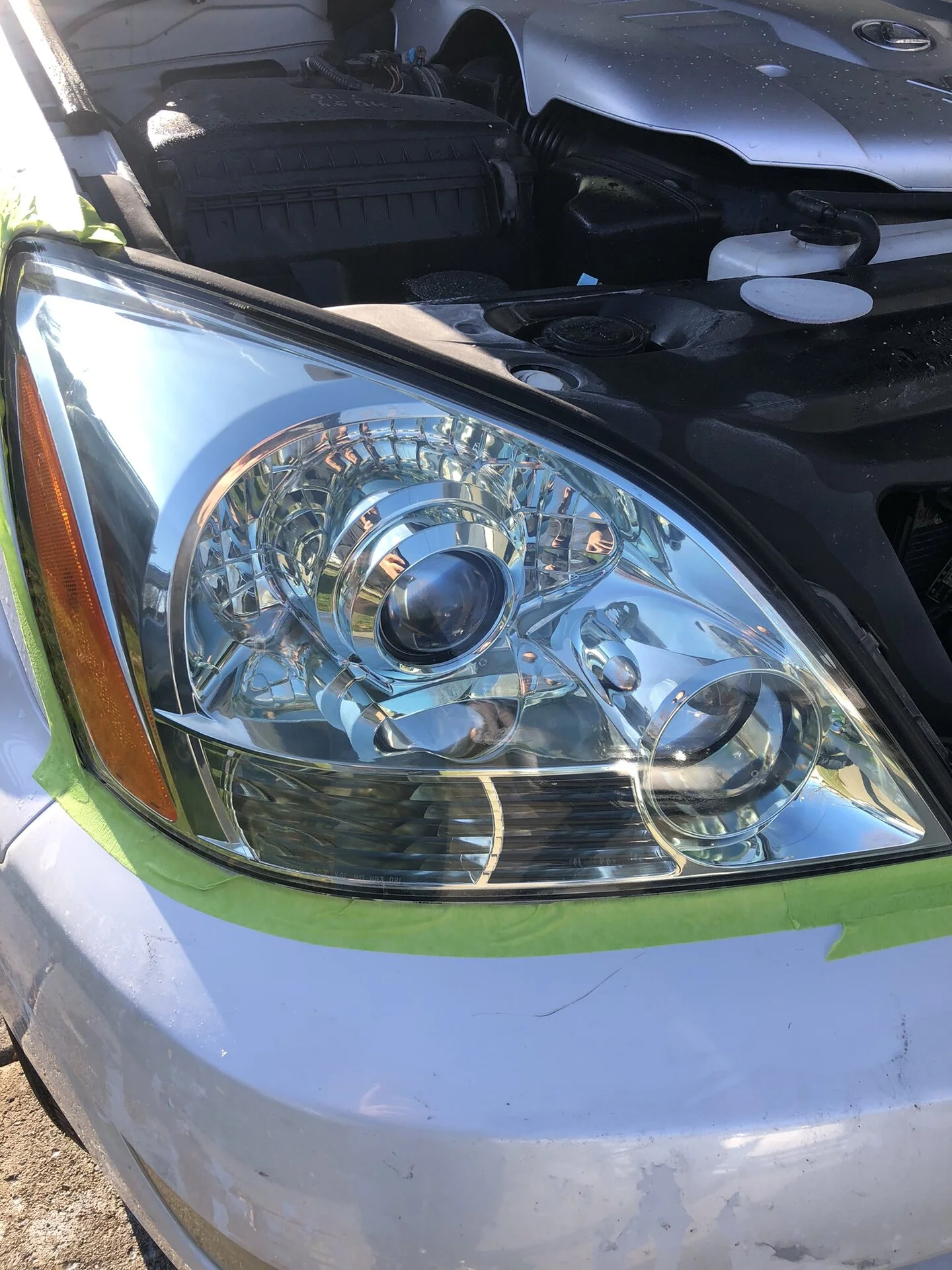

Polish Out Headlights with 3M Kit in Drill - Ordered Ebay - Done

Before
Before - Went over it with Wire Wheel in Drill.
For a Spare it will be out of Sight 99% of Time.
Now headed to Marketplace/Craigslist to find a decent used Tire.
Tranny Fluid Ordered for Exchange
Old Bearing was making Noise
NSK From RockAuto is same as OEM - Arrived in 3 days

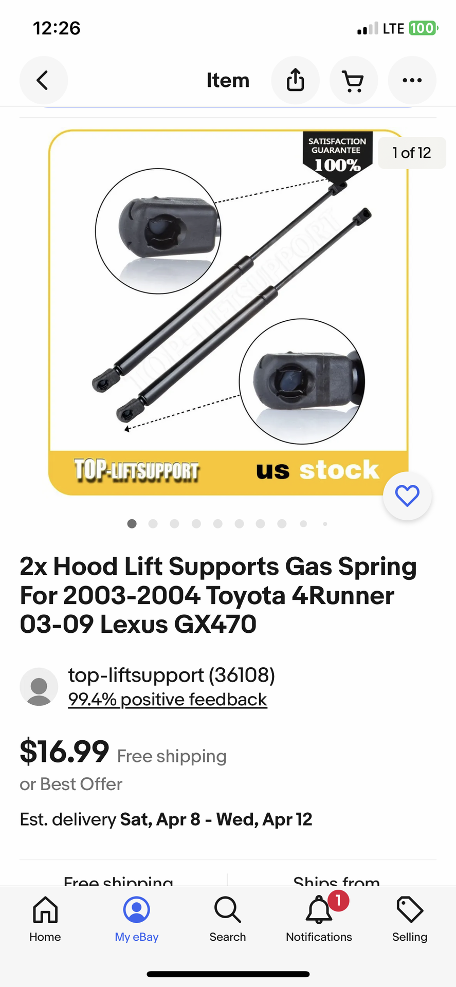

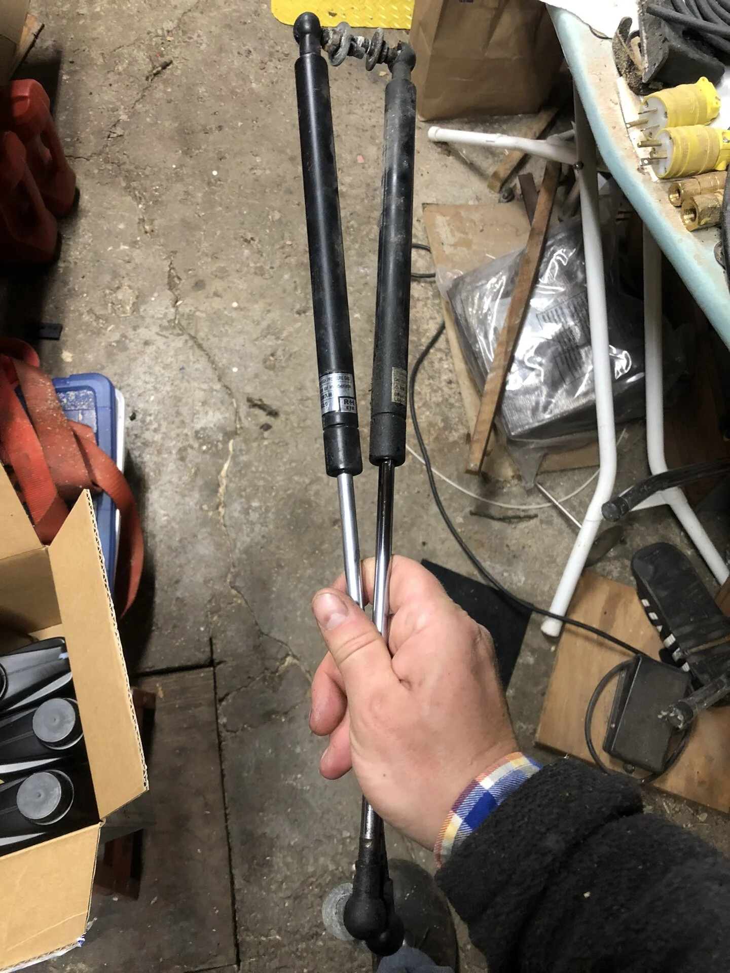

Old Hood Gas Struts No Longer Holding Hood Up - Leaking
New Struts Ordered from Ebay - $17
M12 Open End Wrench to Remove - 5 Minute Job - Use Piece of Wood to Support Hood
These will not Fit - Too Tall. Wasted $10

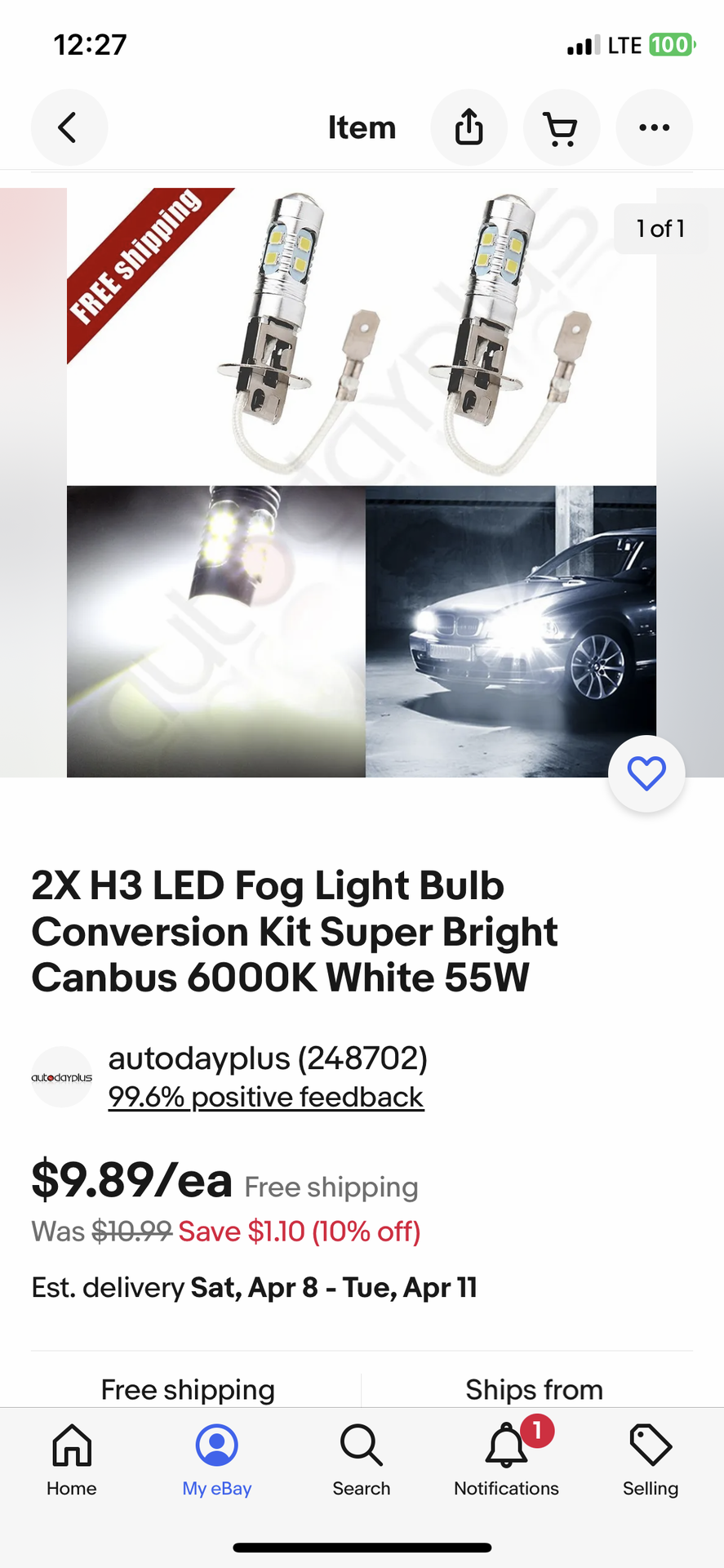

Fog Lights - Halogen --> LED from Ebay - $10
LEDs too Tall - Could not Use.

You will find those fog light bulbs probably have near-zero output (likely due to the ol LED in halogen fixture issue) I changed out my golf cart lights with some of them and the amber running lights are brighter than they are lol.

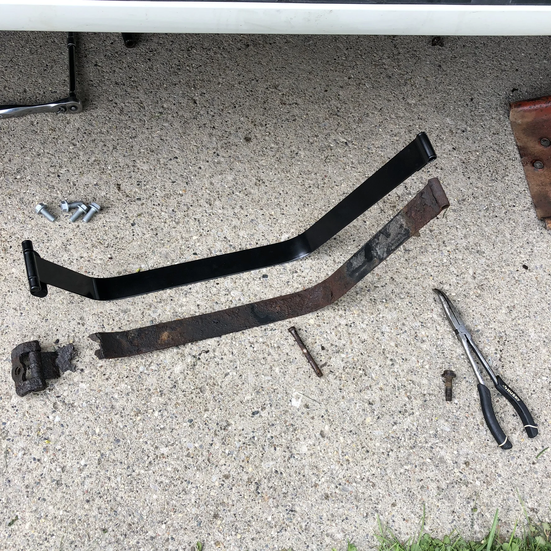

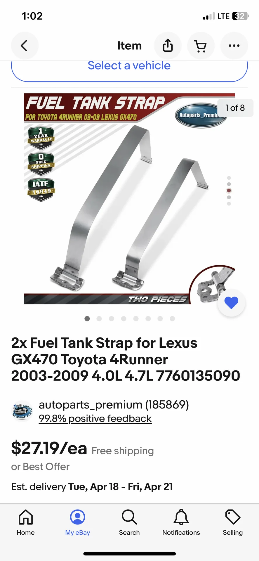

Rear Fuel Tank Strap Rusted Through.
Powder Coated new Straps from Ebay.
Wire Wheeled Pins and Coated with Ceramic VHT after Heating them with Torch.
Tank is Plastic & Shield is Steel.
Shield is Prone to Rust on Inside.

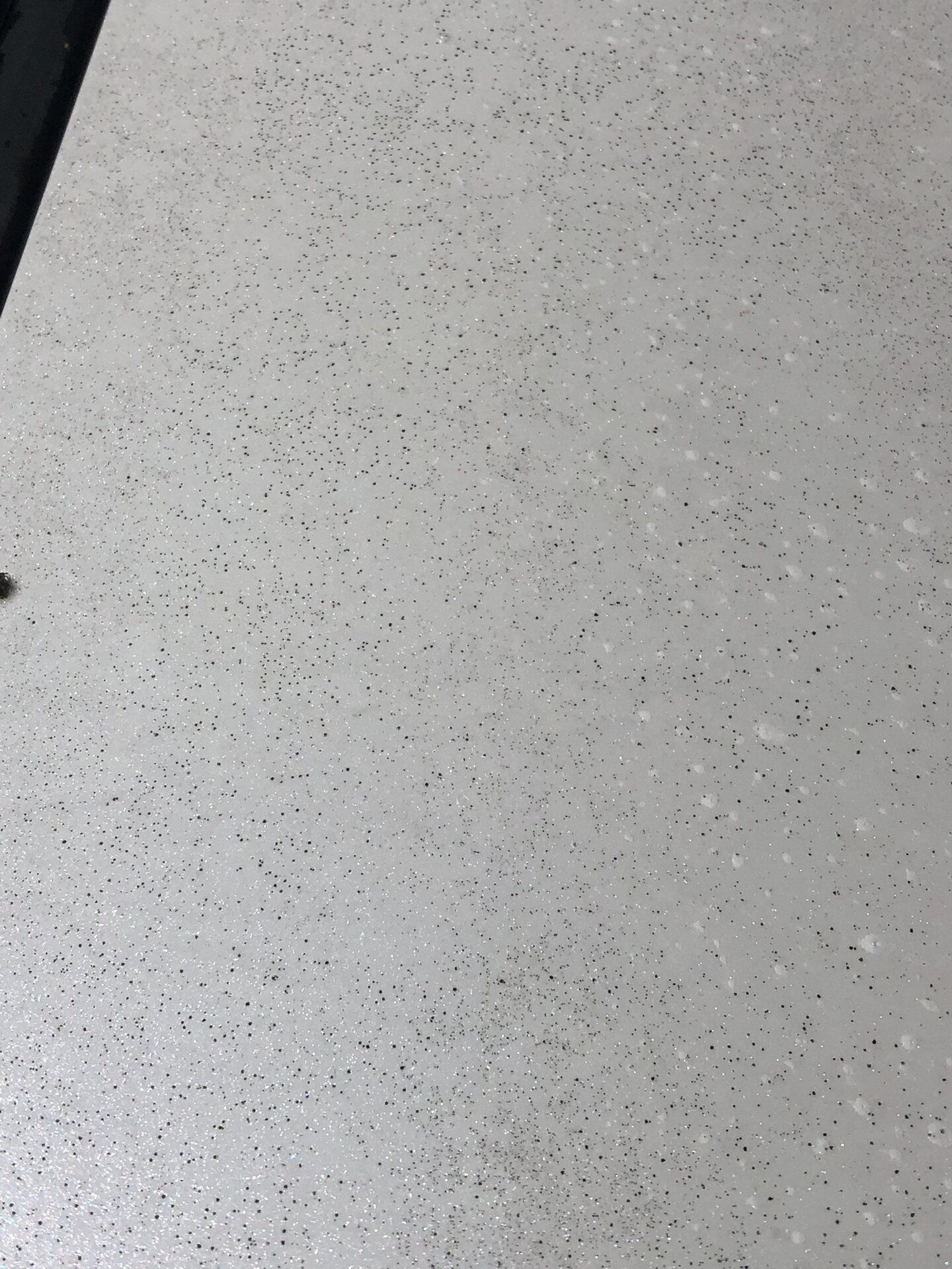

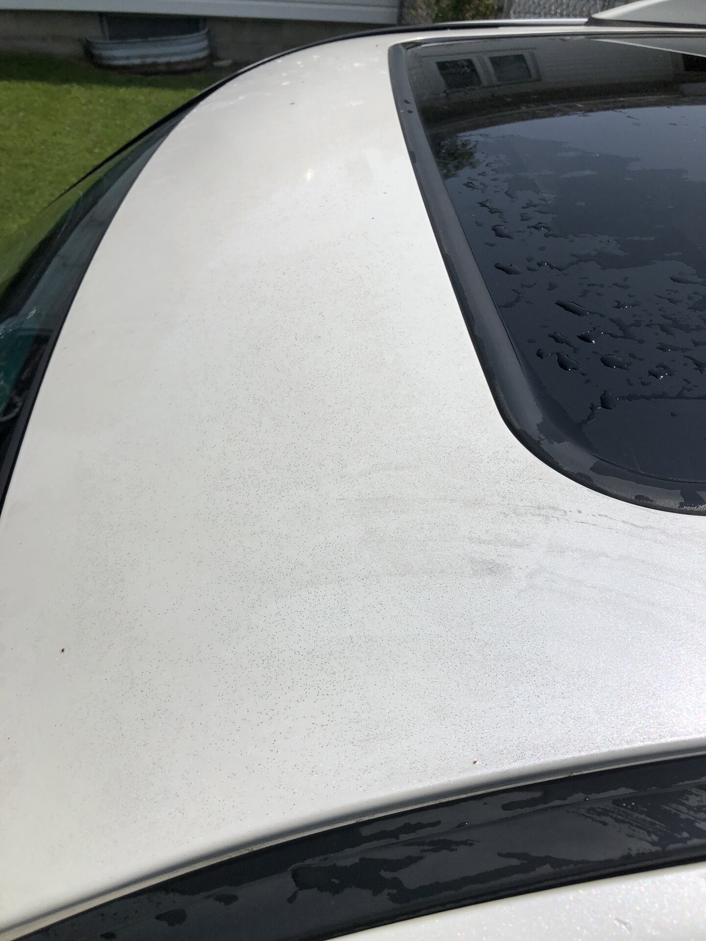

Black Dots on Paint - Appears to be Mold.
Wiped with Degreaser and Coarse ScotchBrite - Rinsed with Hose
Then Waxed
This White Pearl is Beautiful Paint with Lots of Sparkle.

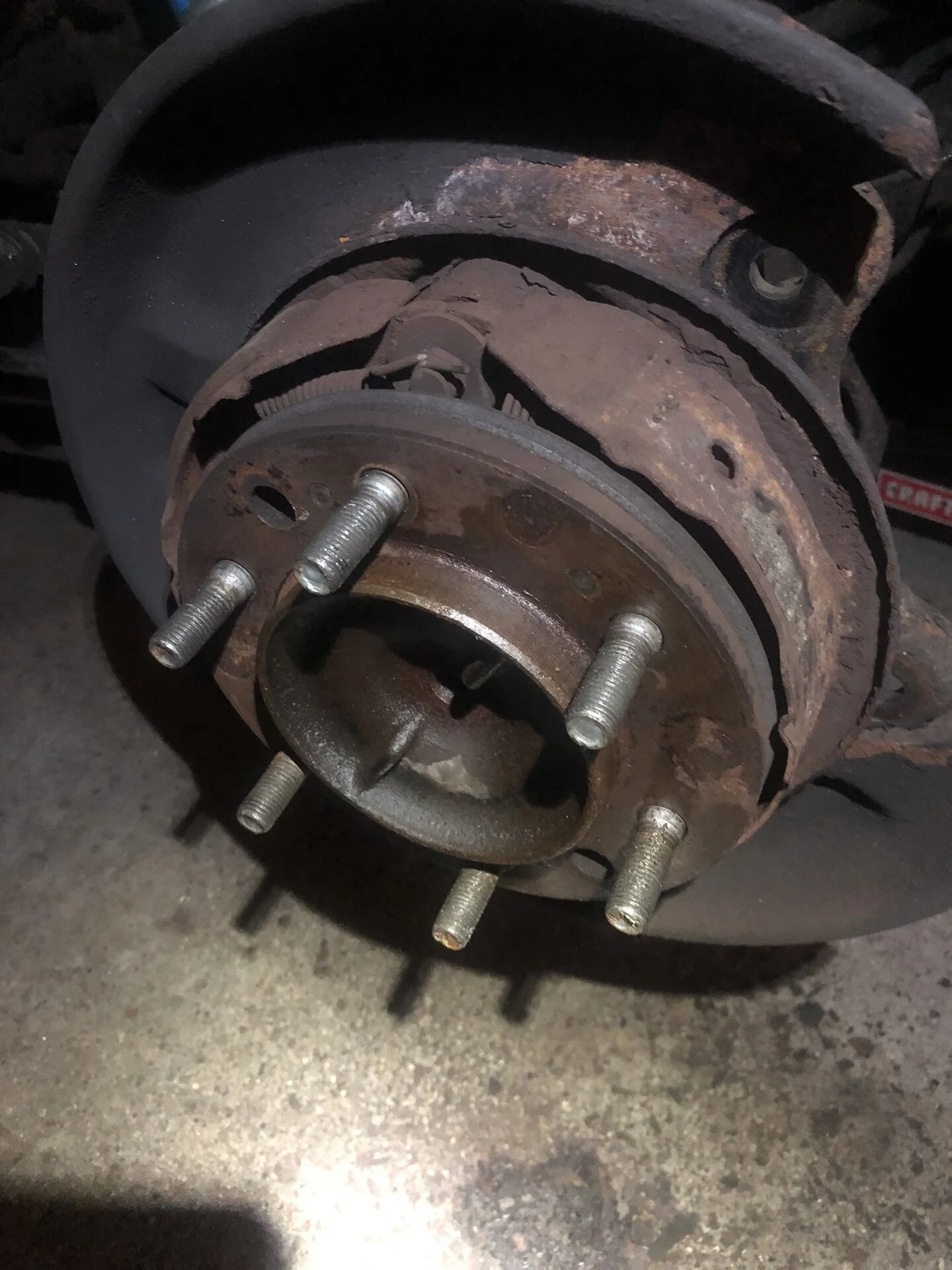

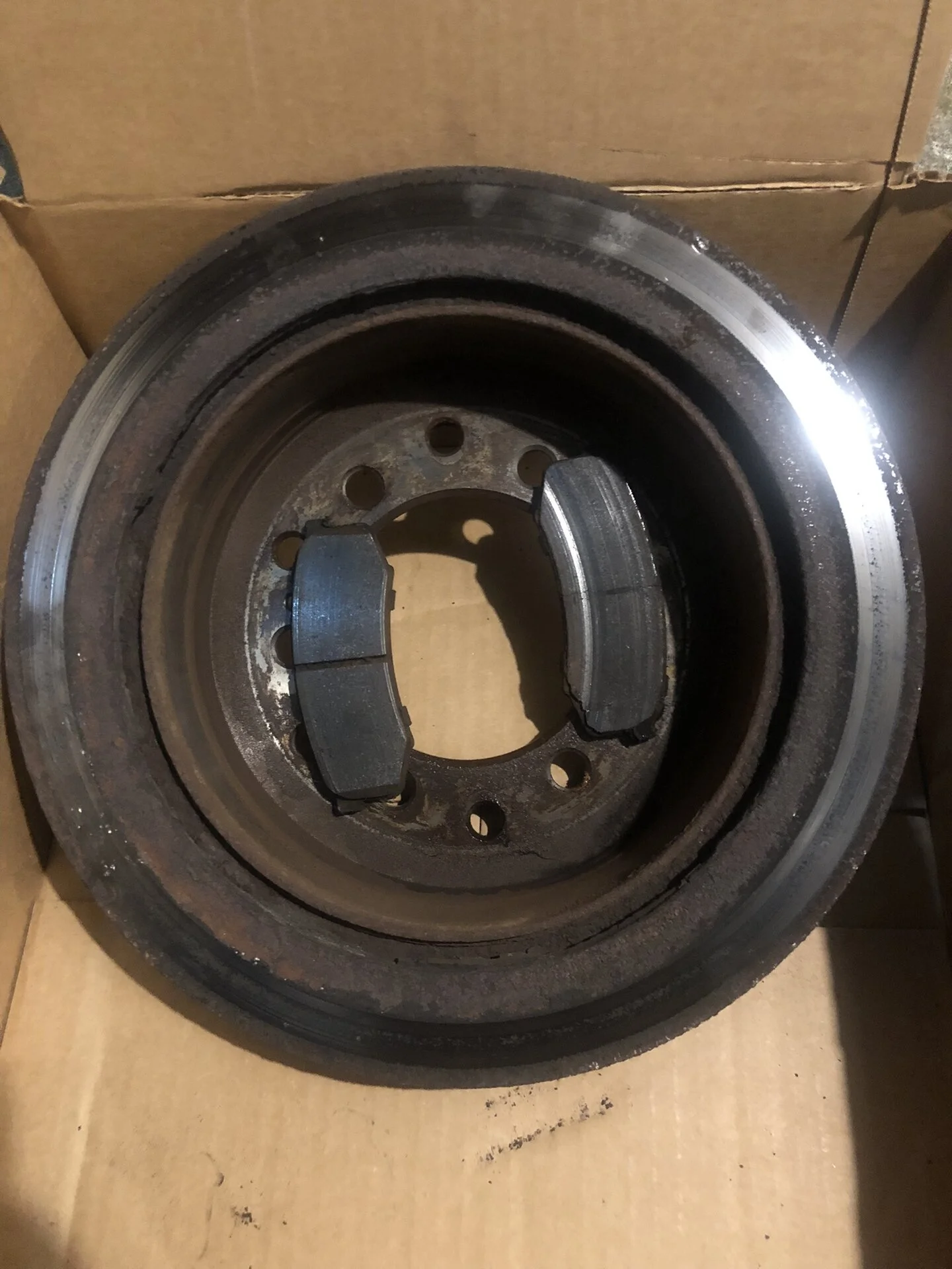

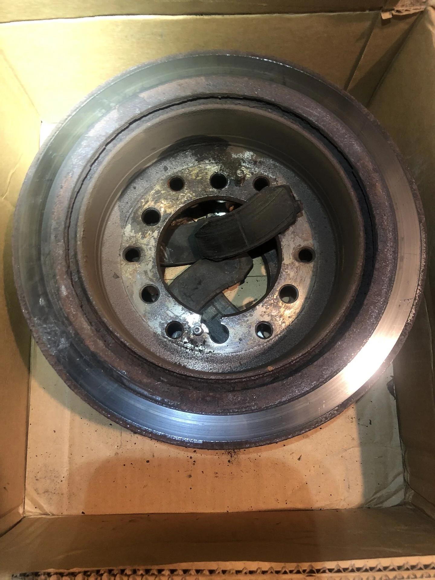

Out with the Old
Both Rotors were Trashed on Inside Surface.
Drivers Side Emergency Brake Shoe Pulled off With Rotor.

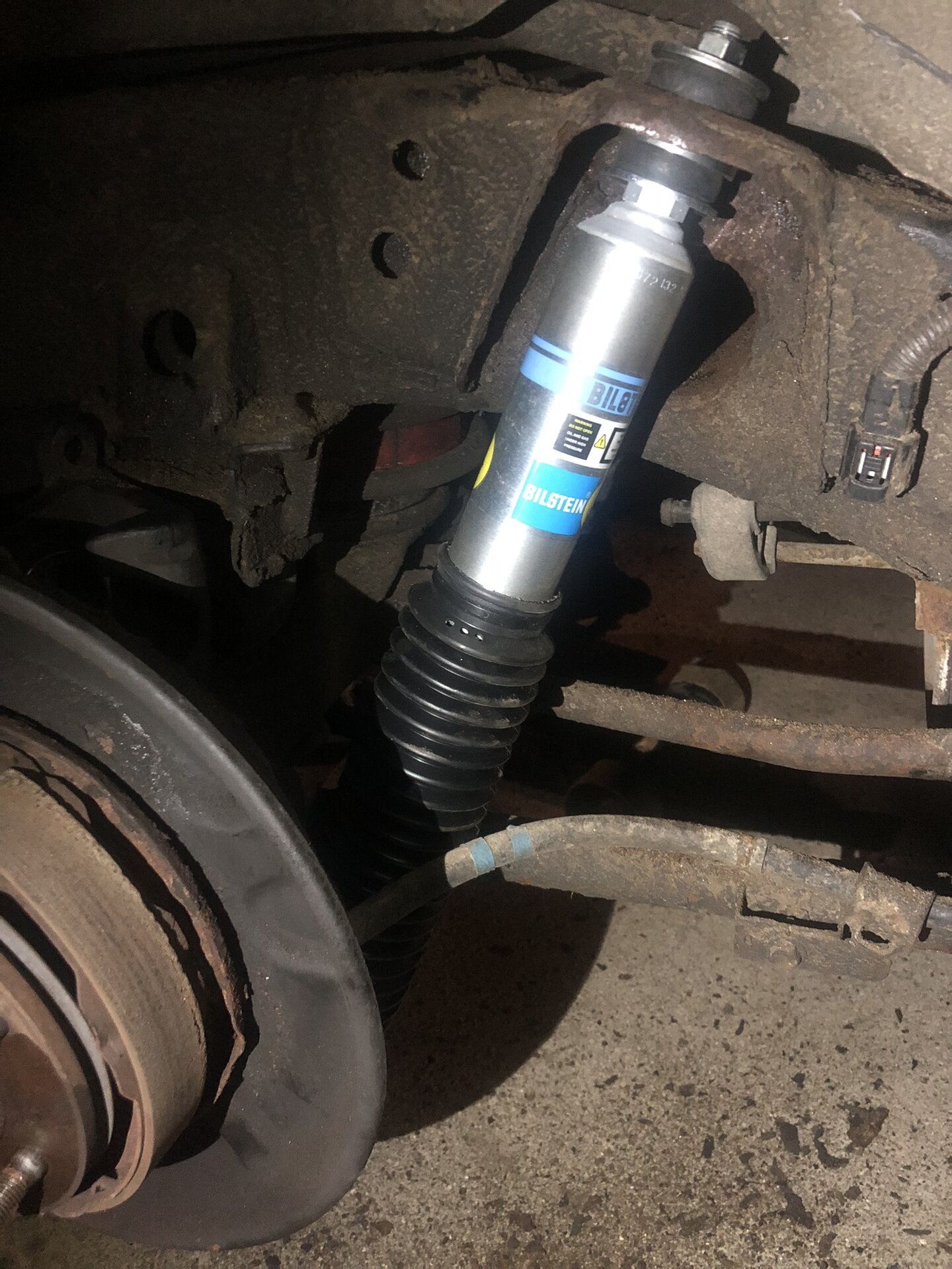

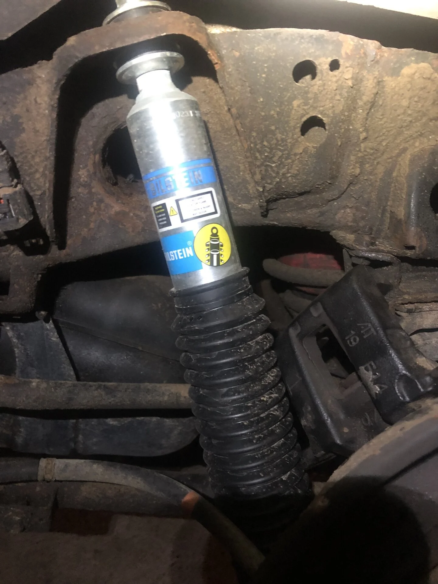

Installed New Bilsteins While in there.
Cut off Old Shocks with Sawzall for Top Stud and 17mm Socket for Bottom.
Pretty Easy Retrofit.

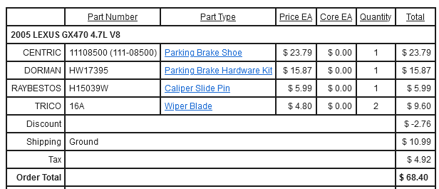

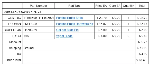

RockAuto.com has best prices, Cheapest Shipping and Parts Arrive Fast.
Always Google and Apply the 5% off Coupon which helps Cover Tax.
E-Brake Shoes and Hardware Kit on way.

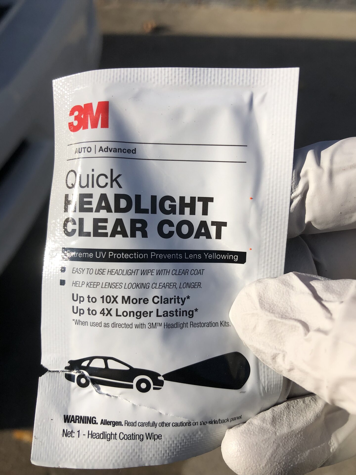

Polished out the Headlights
I cannot Recommend the 3M Kit Enough
Takes 30 mins per Headlight and the Results are Outstanding.
Chuck the Velcro Pad in a Drill and Spray with Lots of Water while working thru the Grits.
Finally Wipe 2X with the Clear Coat & Remove Tape.

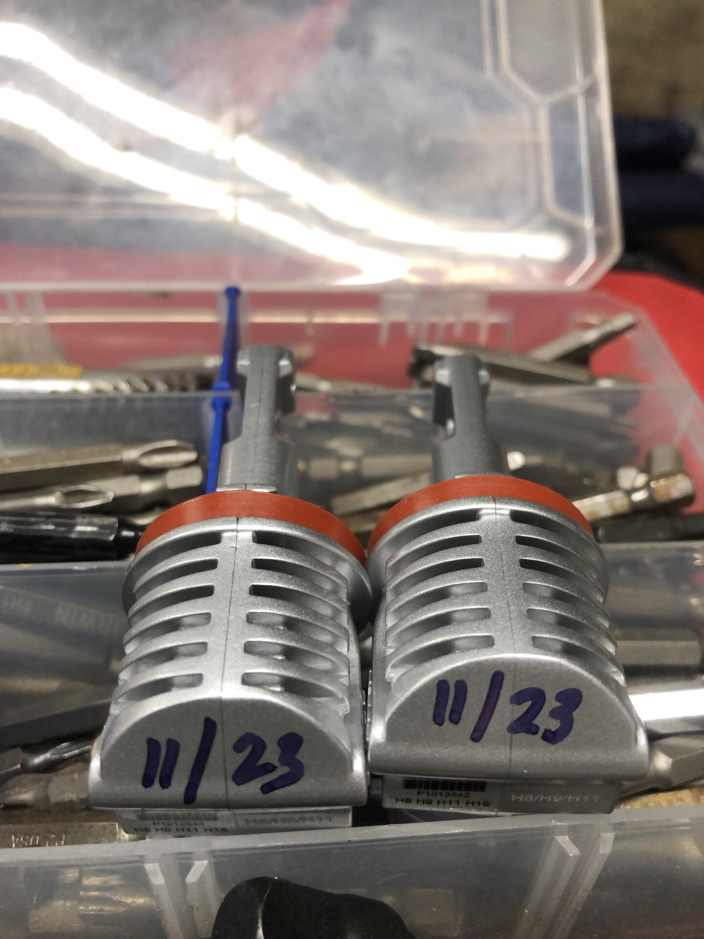

Added some $30 LEDs from Ebay.
Prefer the LEDs with Fanless Drivers, as Reliablity is Assumed to be Better.
*I've had some Ebay LEDs last a very Long TIme and other Last a very Short time.
**Upgraded ($45) to the LED Headlights from Superbightleds.com and they lasted the same as the Ebay ones. Some very Long others Short lived.
Write the Install Date with Sharpie so I know how long the Item Last - Especially on Cabin and Engine Filters.

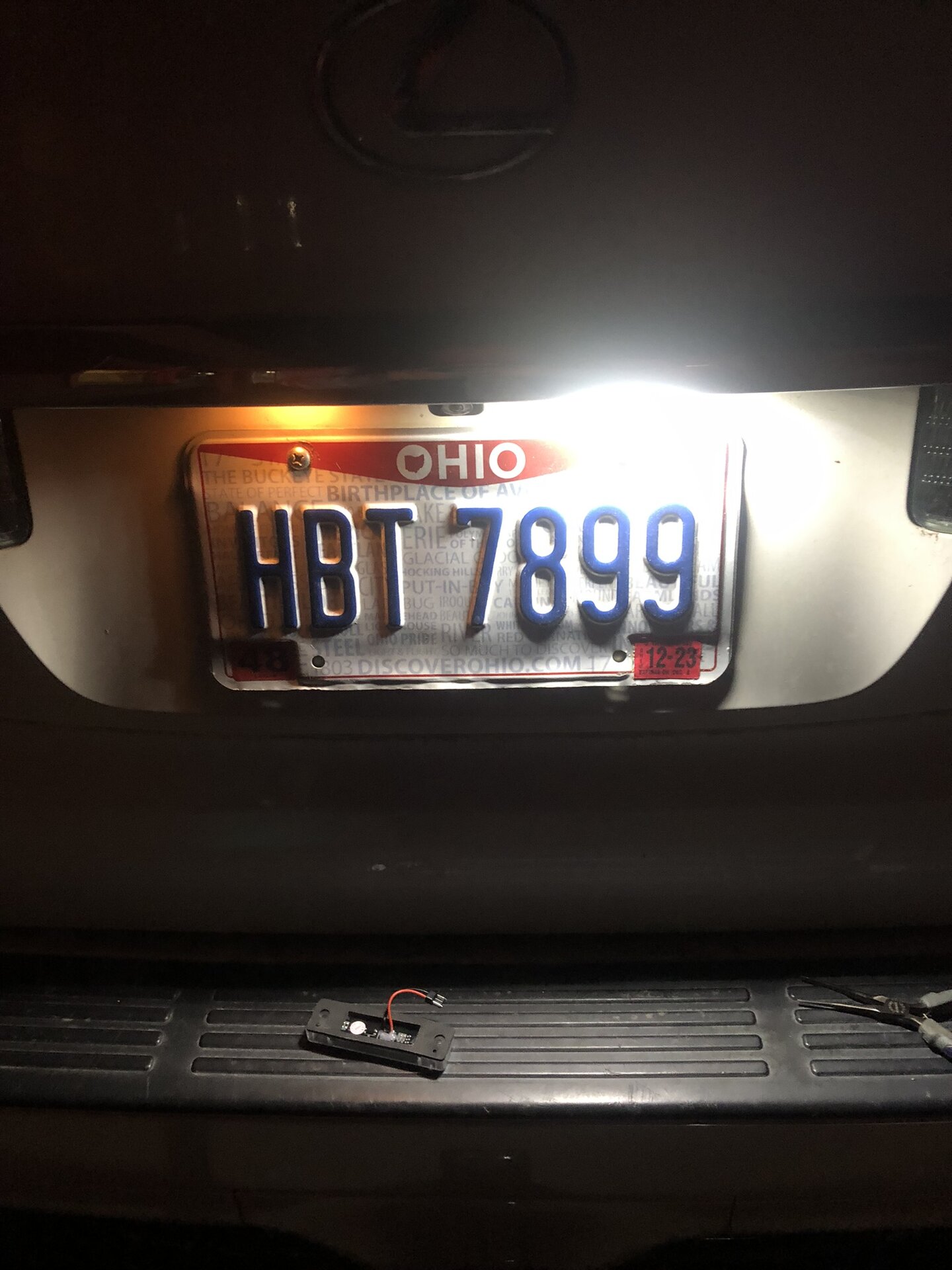

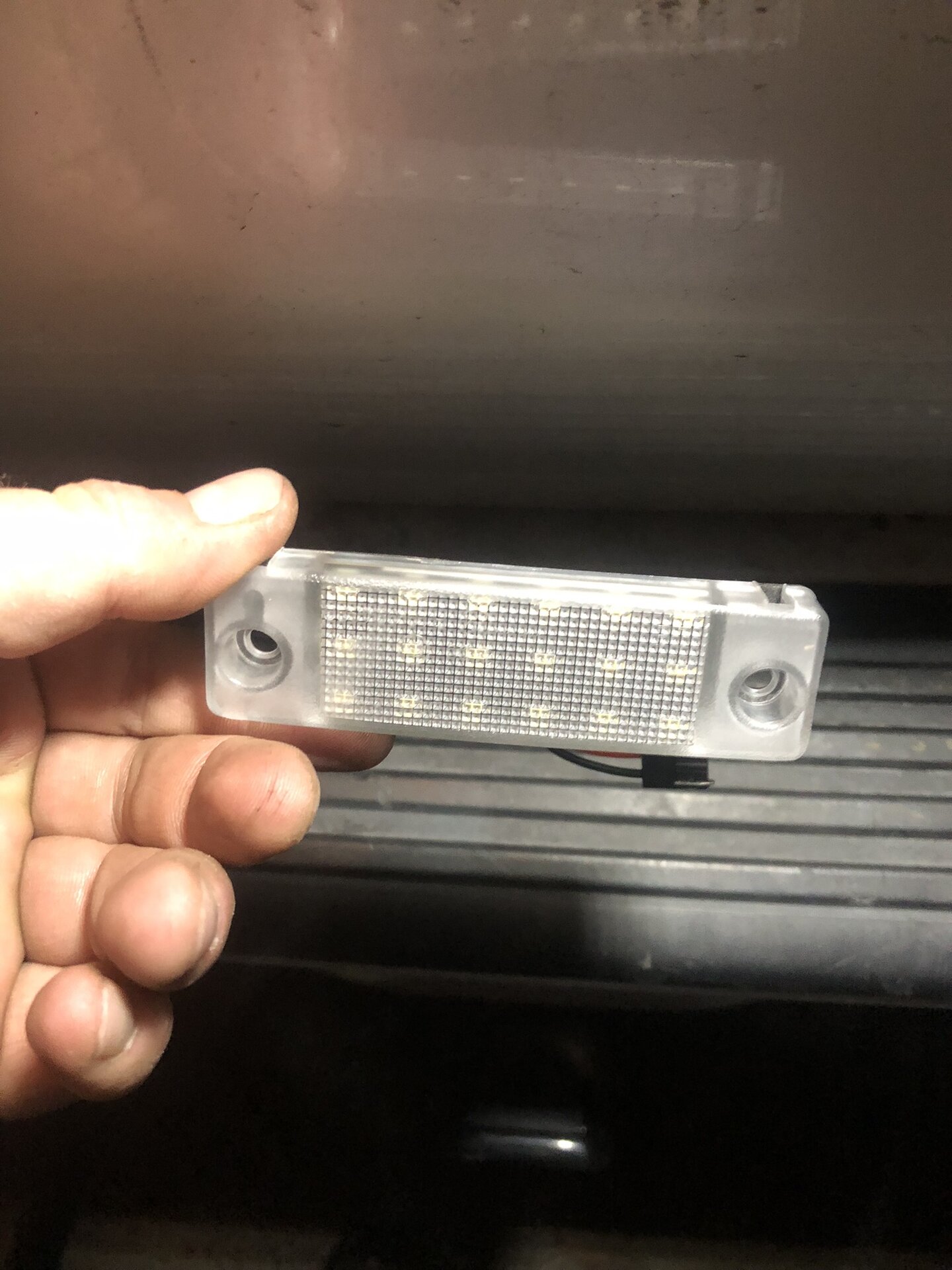

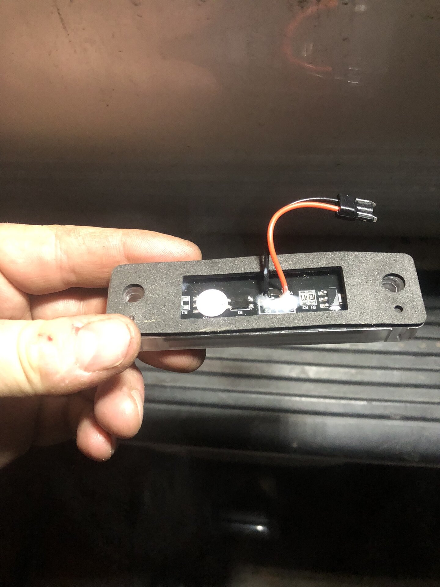

Replaced the License Bulbs with LED Panels.
LEDS are from 4 Runner so I put a Single Hole and Screw to Secure them.
No Comparison in output, voltage draw, or durability.
Once and Done for Life of Vehicle.
LED Pair is about $15 on Ebay or Amazon.
Ordered a Set for the 80 Series
