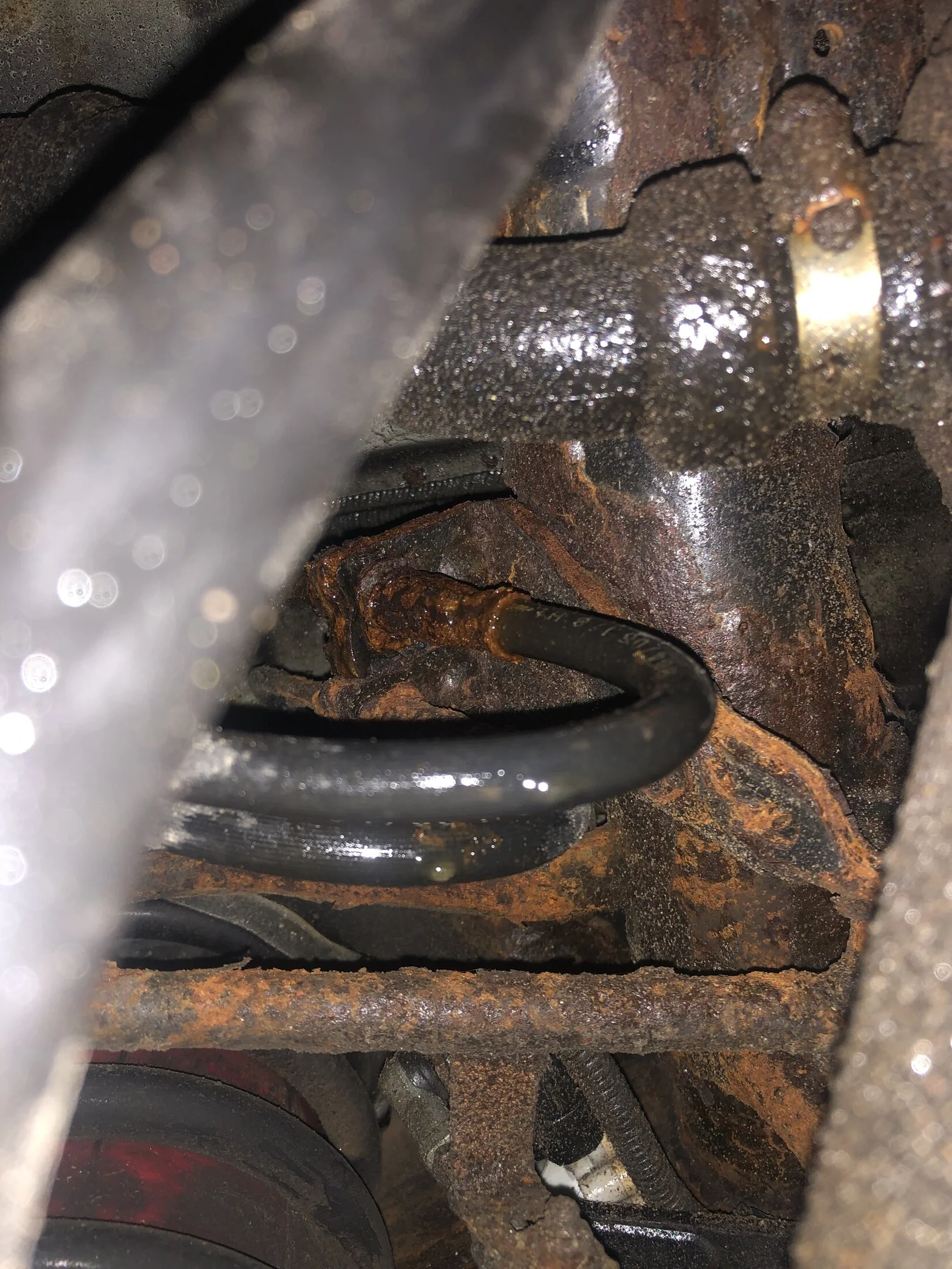

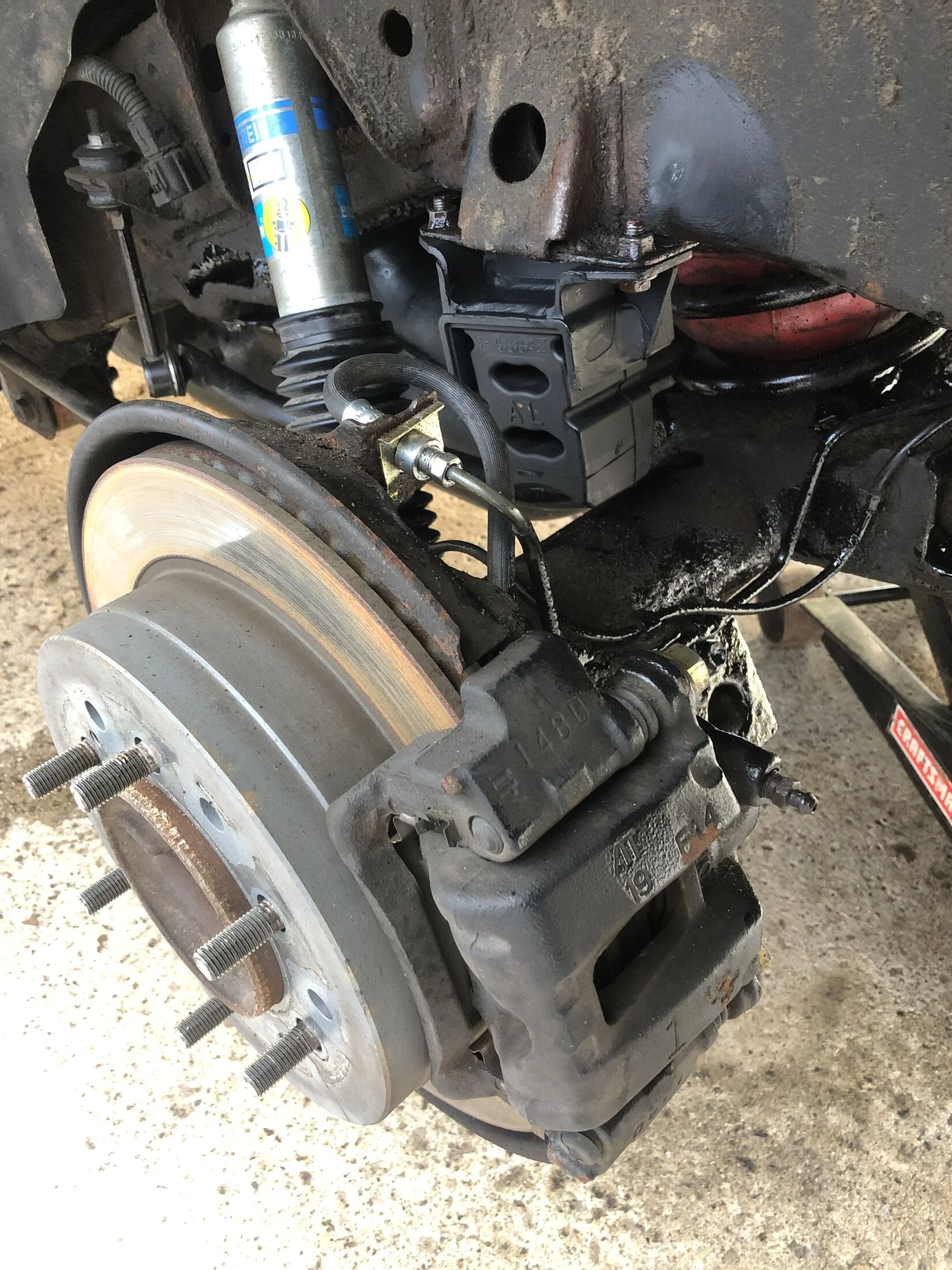

Puddle on Driveway led to Discovery of Leak at Rear Brake line where it Connects to Hose that Allows the Axle to Articulate.

Ordered all new Hoses (Dynamic Friction on Rock Auto) including Front Hoses. 8 Hoses Total for $80 Shippped.
**Hoses are likely Fine, but the fittings that Connect them are Rusty Trash and no Longer Hex Shaped to fit a Wrench.
Heat, Kroil, and Patience are Necessary when doing Brake line work.
1 Brake Line Clamp broke a Bolt off but all others came free with Heat and Penetrate oil.
4 Replacement Brake Lines were $143 from Local Lexus Dealer. They were ordered on Thursday at 1PM and arrived at 9:40AM on Friday - Incredible.

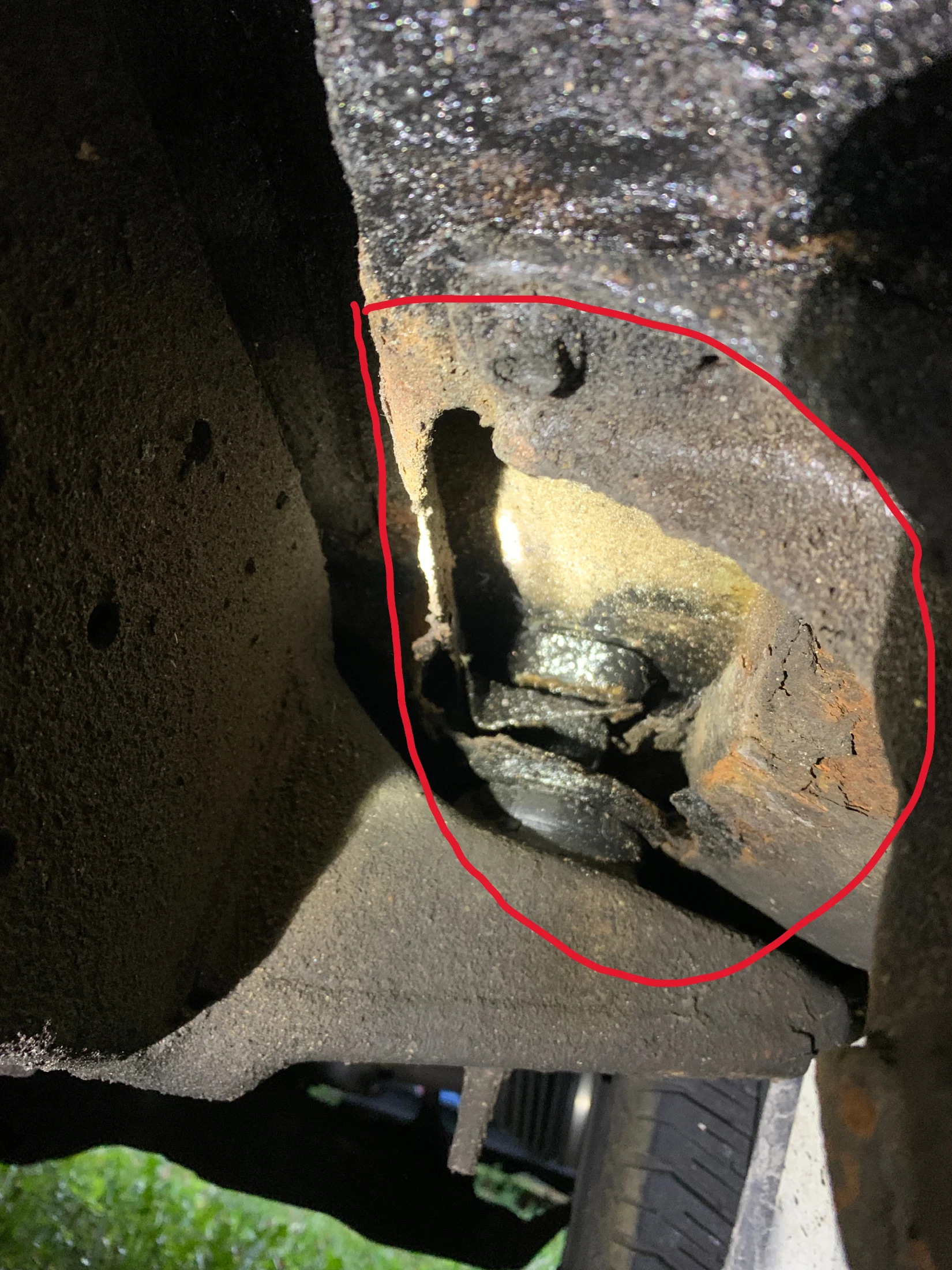

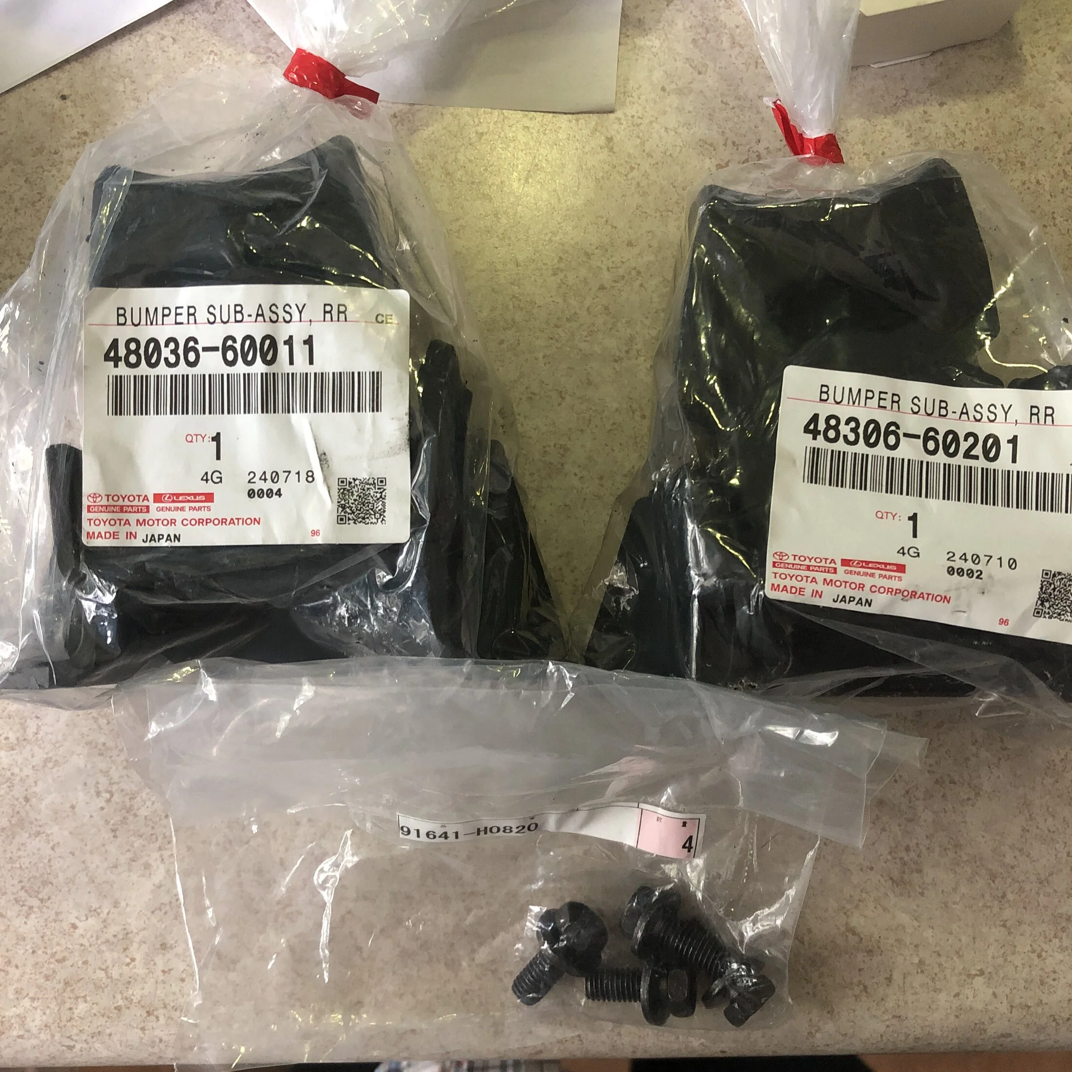

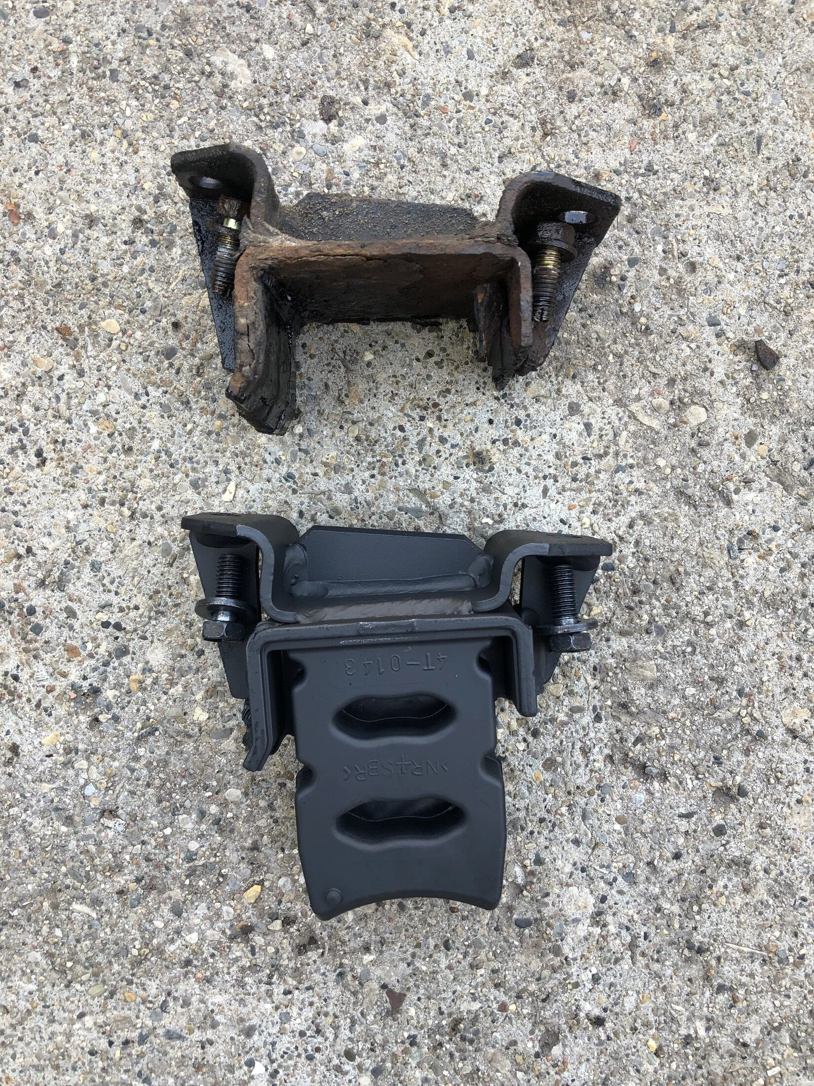

New Rear Axle Bump Stops
Rubber Rusted off Old Axle Bump Stops.
Ordered New ones on Ebay $86.38 + $6.69Tax = $93.07 - Came with New Bolts
Remove Back Wheels then Kroil & Torch to remove Old Stock.
Replaced Wheels and Torqued Lug Nuts.
Soaked Front Bump Stops in Kroil - If they can be Removed without being Broken off they will get Replaced with Energy Bushings from RockAuto.

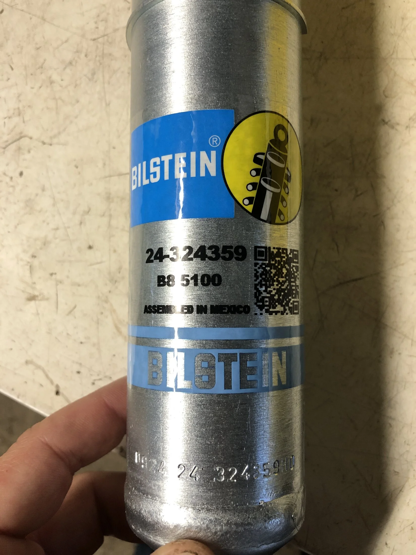

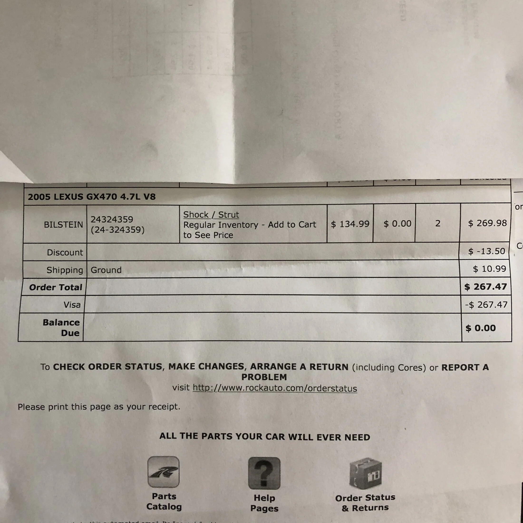

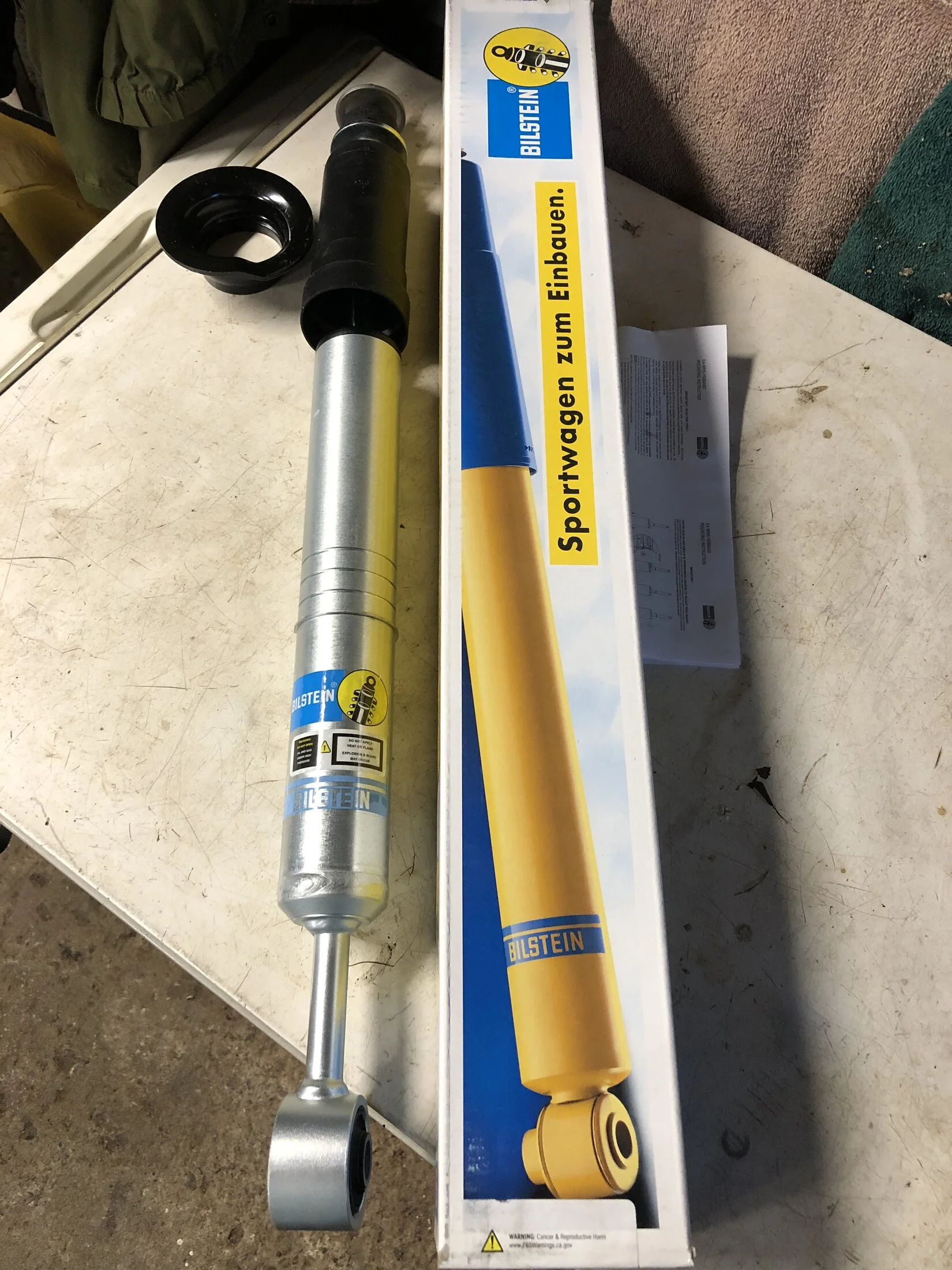

New Front Bilstein Shocks (5100 Series) Rock Auto
(2) New Front Shocks - Bilstein - Rock Auto
**Move Circlip on Shock body (shown below) for up to 2.5" Lift over Stock Shocks.

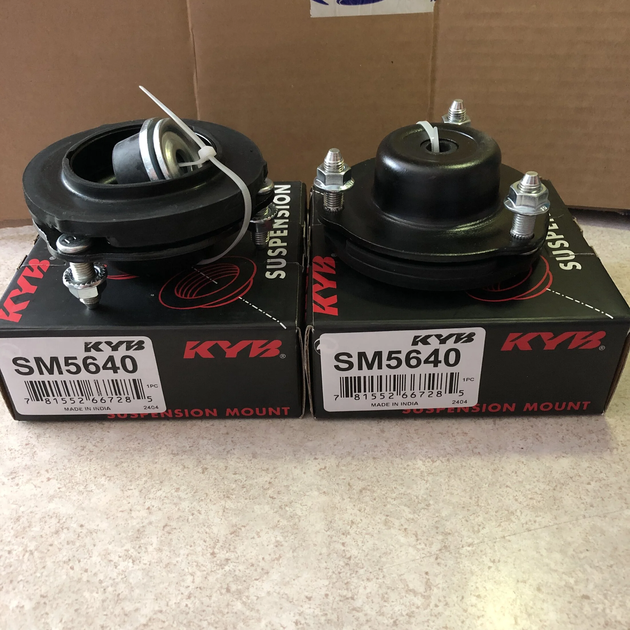

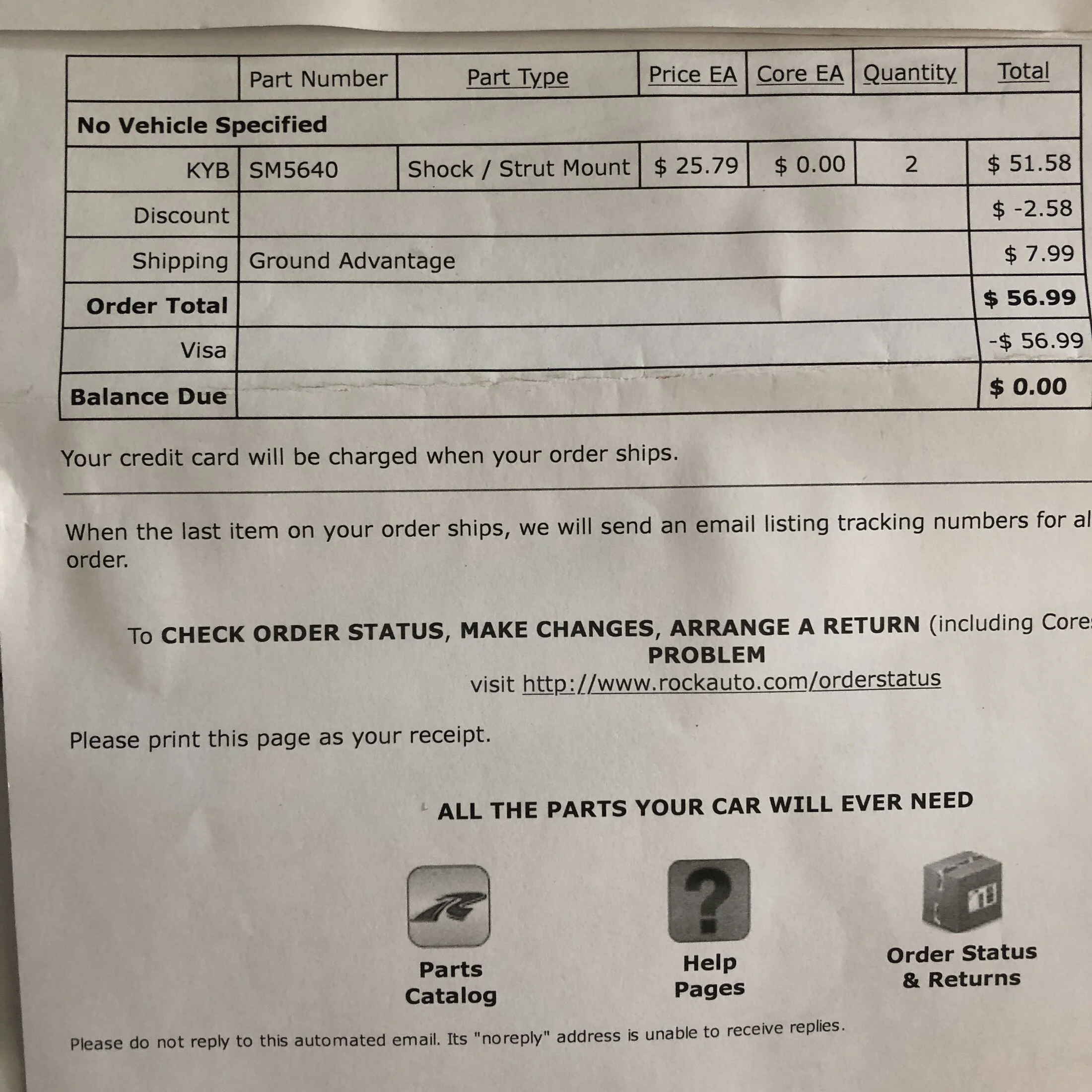

(2) New Strut Mounts - Rock Auto
Strut Mount Receipt - Rock Auto

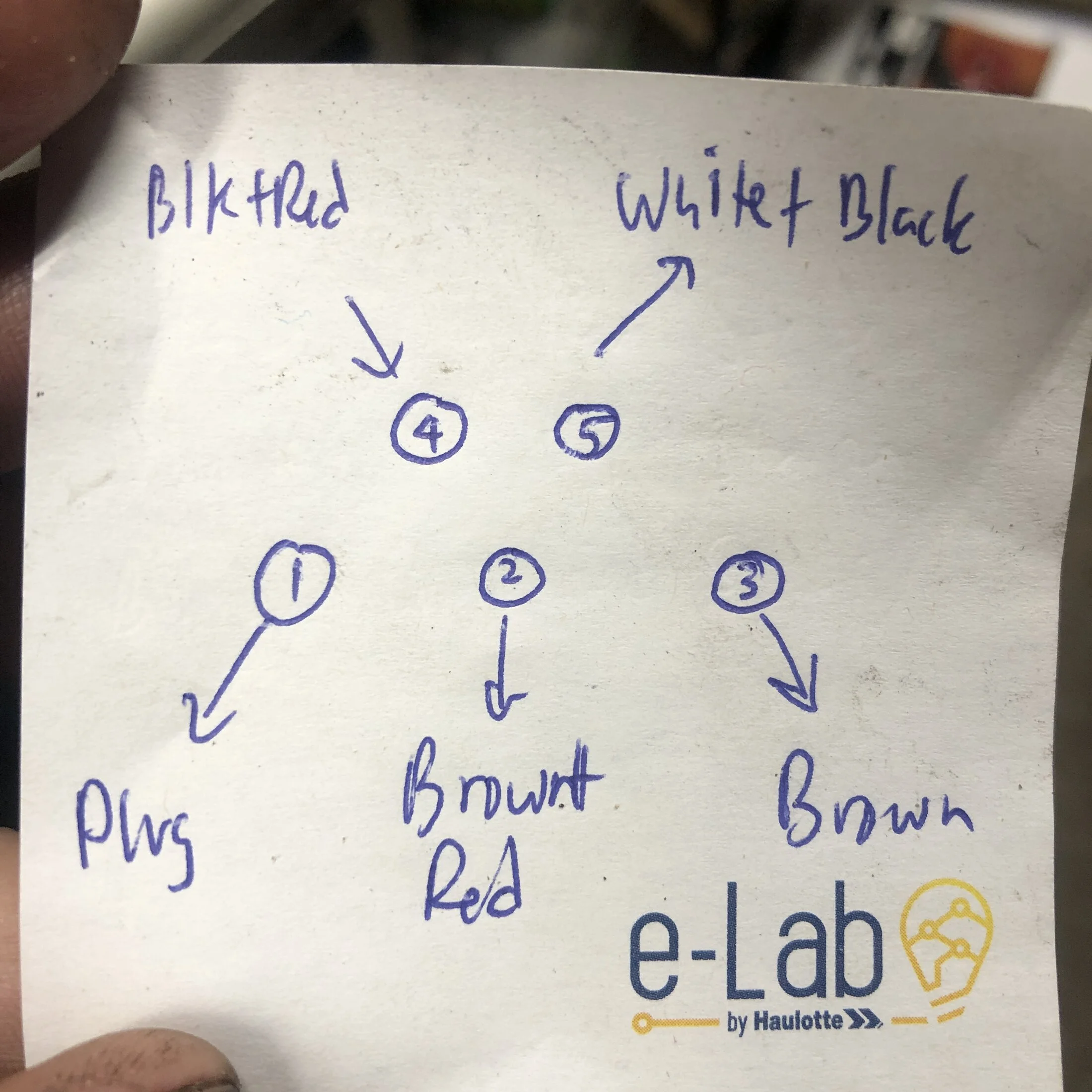

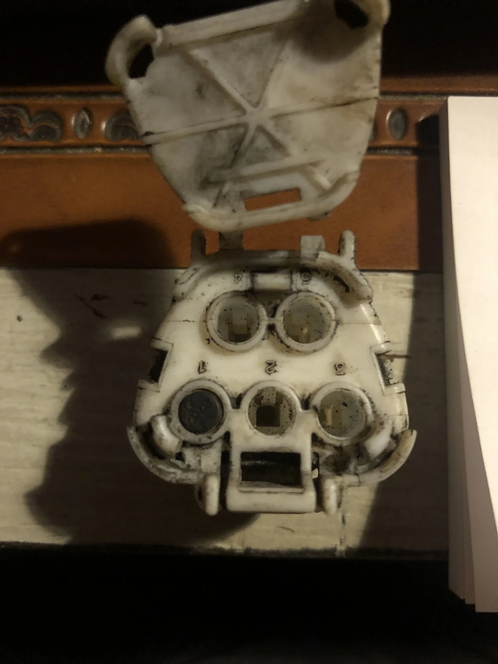

Fuel Tank Electrical Plug Wire Colors and Terminal Locations - May Help if Wires Get Pulled out of Plug.

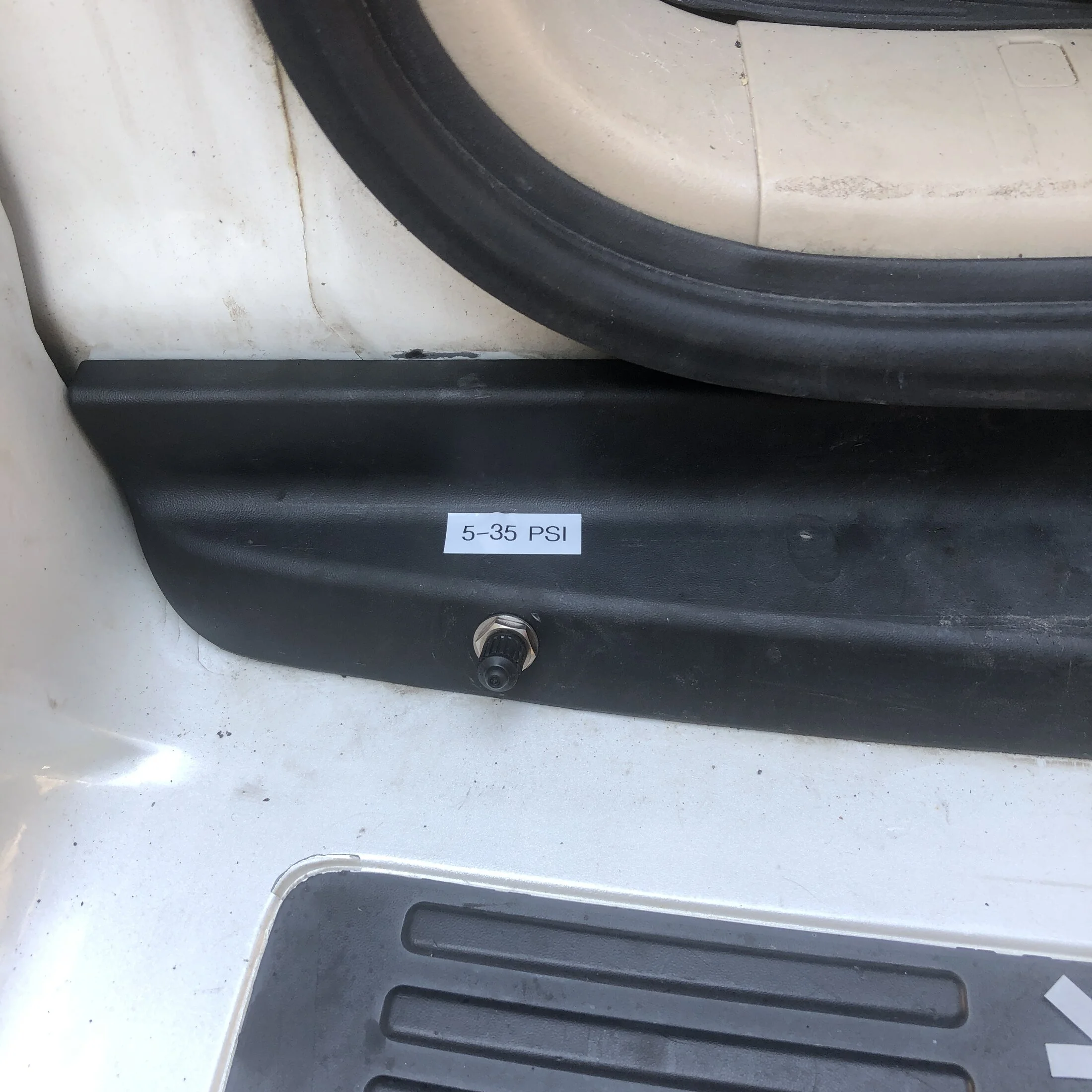

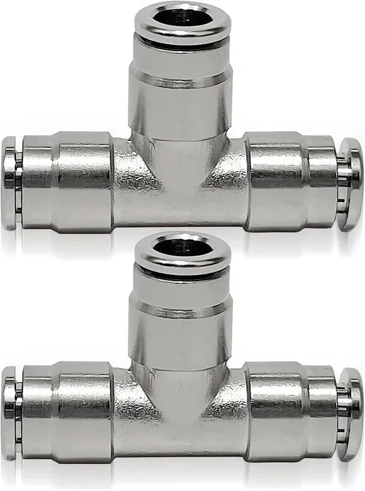

Ran the Air Lift Suspension Bag Air Fitting (Schrader Valve) out the Drivers Side of Rear Door.
Easily Clears the Door, yet will be easily Accessible.
*I am a Big Fan of Label Printing everything for ID unless your Memory Very Strong.
**Your Local Parker Store Carries the 1/4" Line and Metal Push to Lock Connectors.
Much More Durable than the Kit Air Lift Provides which is Plastic Barbed Tees

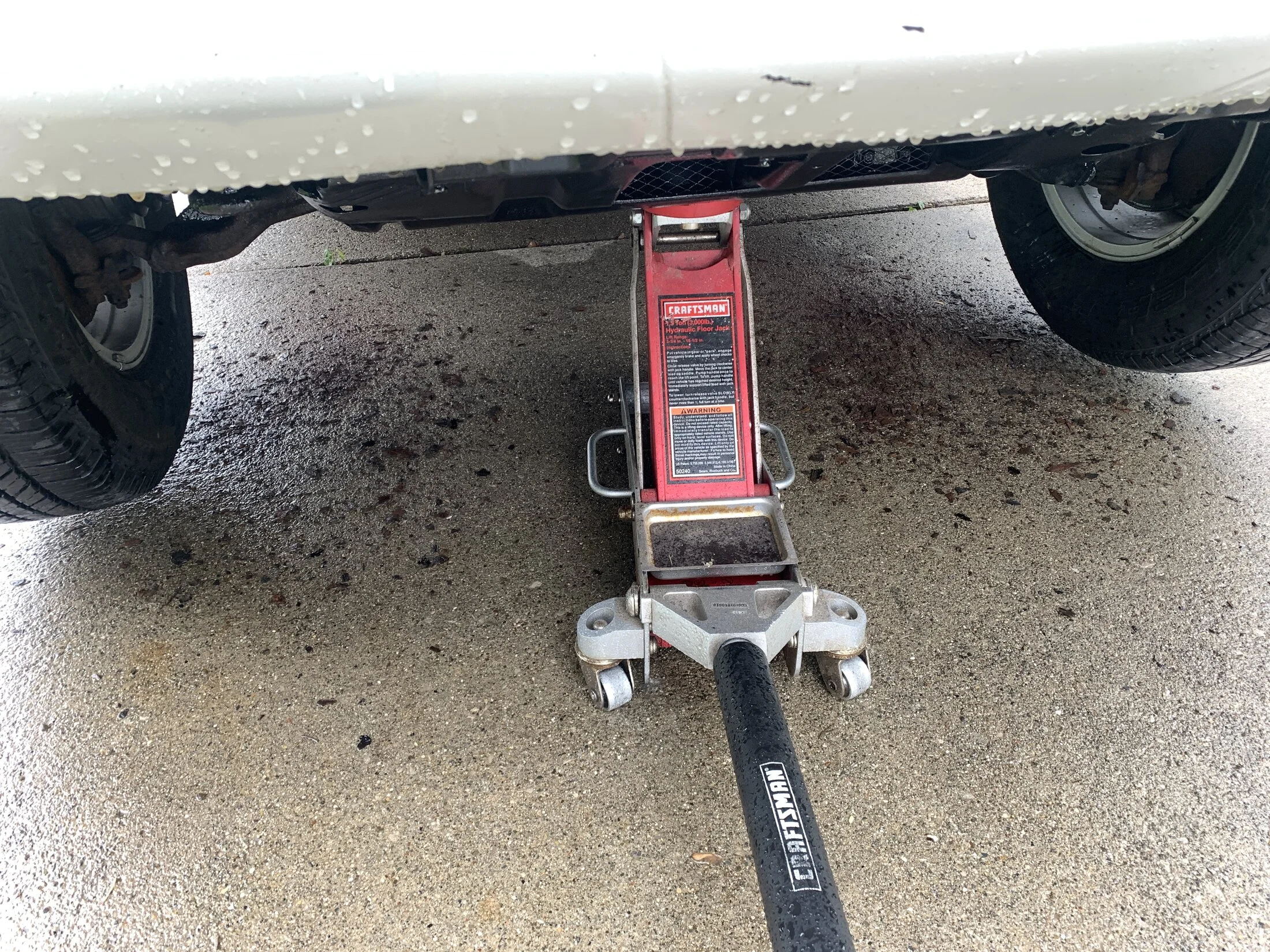

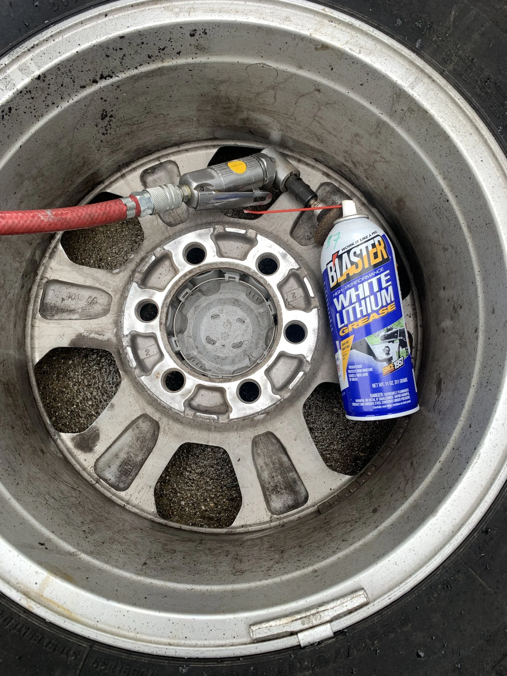

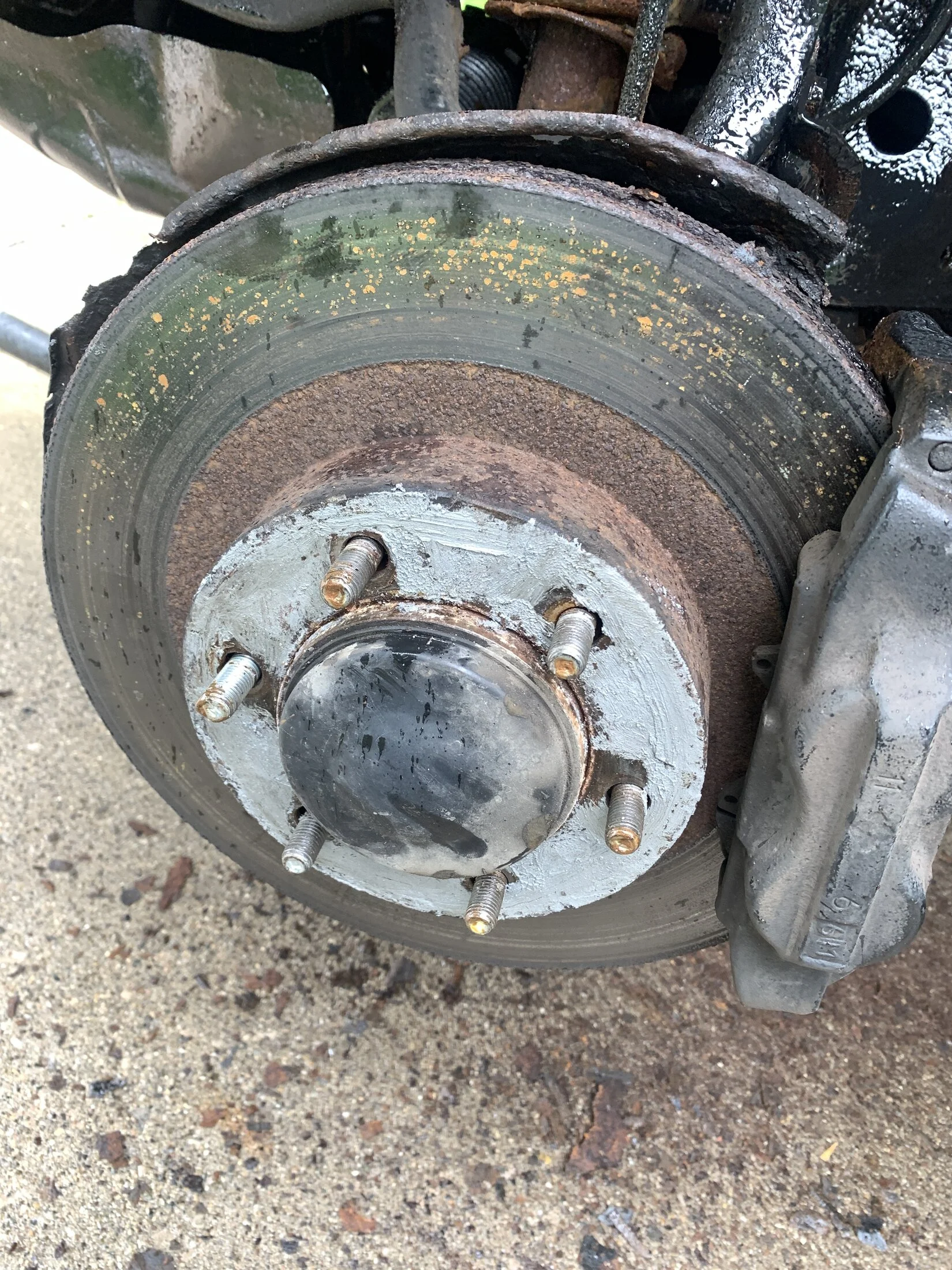

Rotated the Front Tires.
Could not Kick the Tires off. Rim was Corroded to Rotor.
Would have been a Nightmare on Side of Road with Flat Tire.
Ended up Using a 4 foot Prybay and Prying Behind Wheel.
After Wheels off Buffed the Wheel and Rotor with Scotchbrite on Angle Grinder.
Applied Never-seize to Rotor and Lithium to Wheel.
Knocked front Rust off Using Wire Brush and Compressed Air.
Sprayed Fluid Film with Compressed Air and Astro Sprayer.

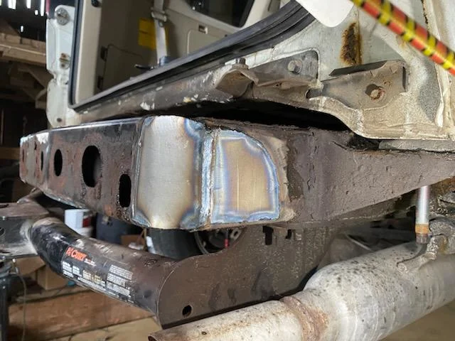

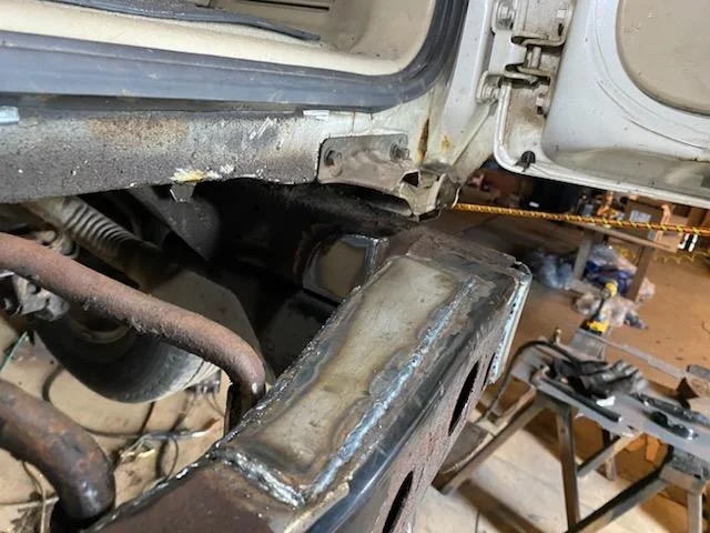

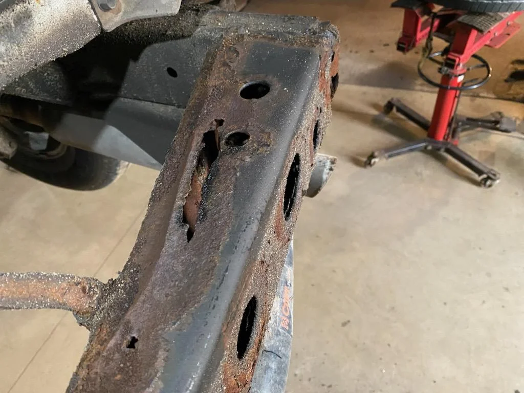

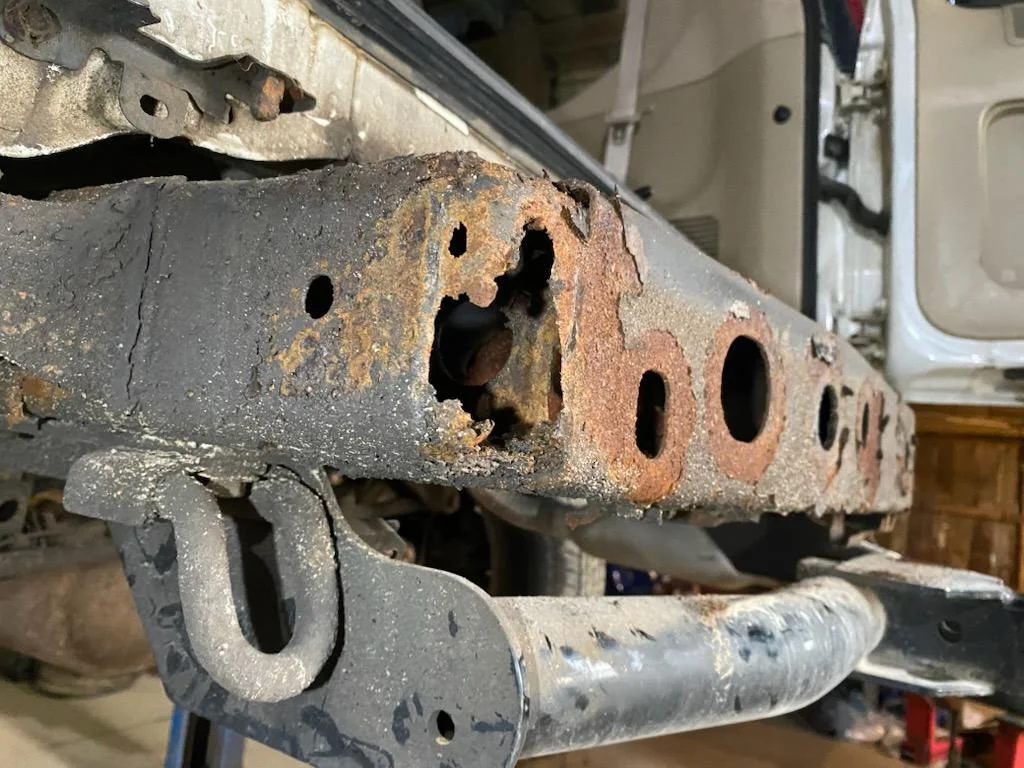

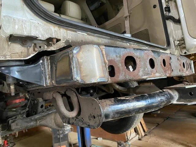

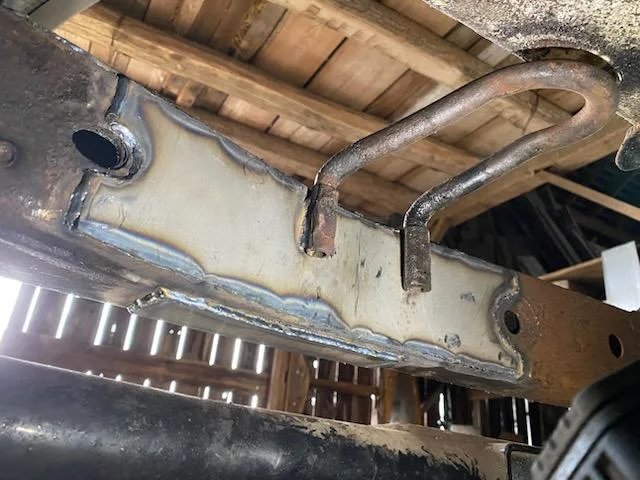

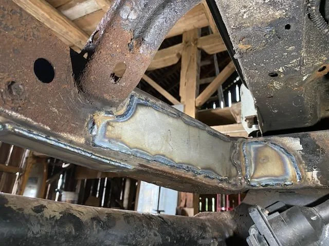

Took Lexus 1 Hour South for Frame Repair on Sunday.
Found Guy that Does Frame Repairs Full Time - He Mostly Does Chevy Trucks.
Here is his Facebook Page with Before & After Pictures: https://www.facebook.com/ethan.reddick.2025/
Here is where he gets Replacement Components: autorust.com - https://www.autorust.com/
  • He puts truck on 2 Post lift then Supports at All Corners with Stands
  • Plasma Cuts Rusted Components Out then Grinds till Flush.
  • Welds in New Plates or Piece then Paints and Fluid Films.

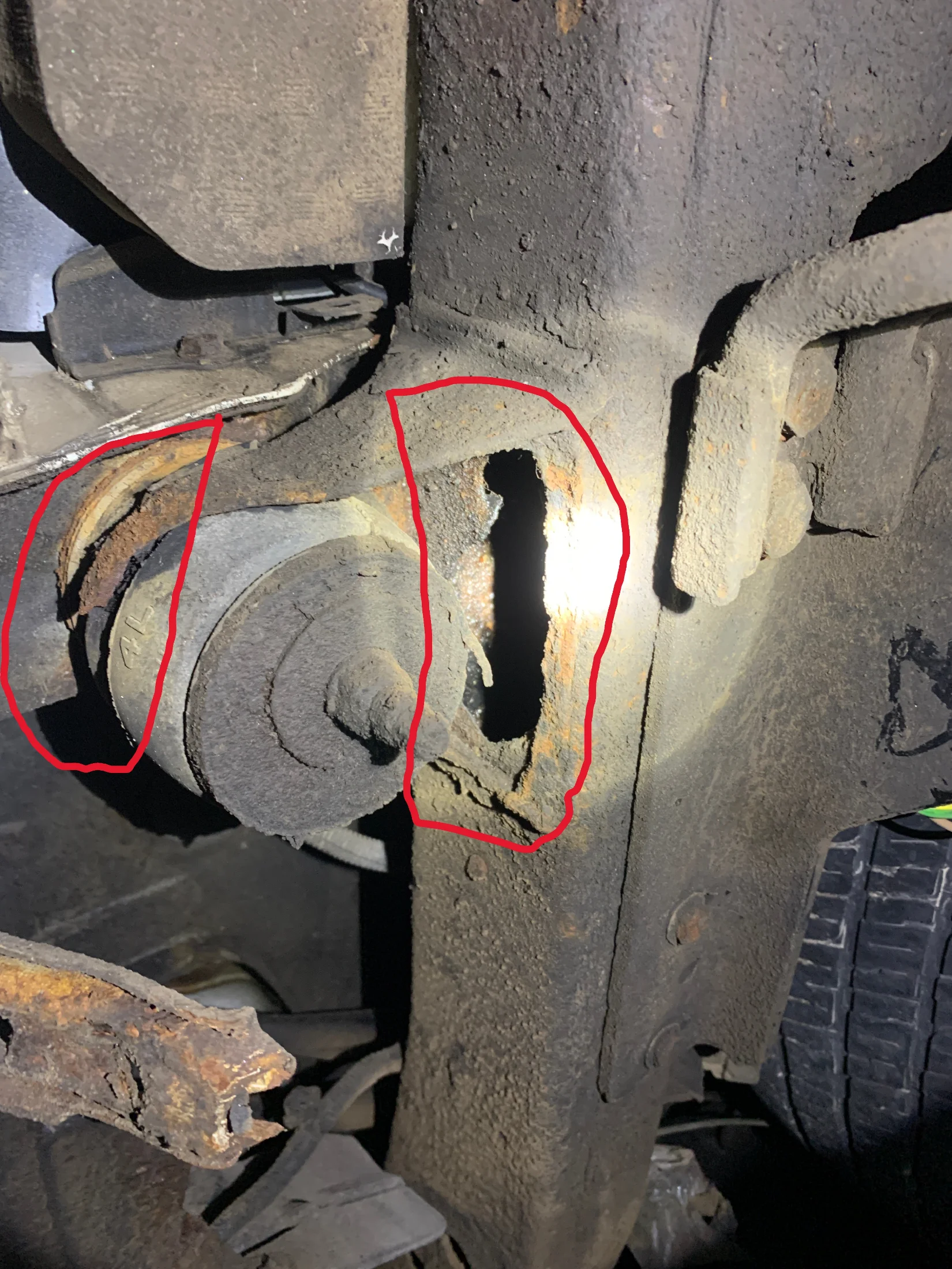

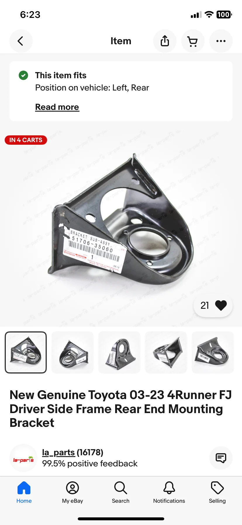

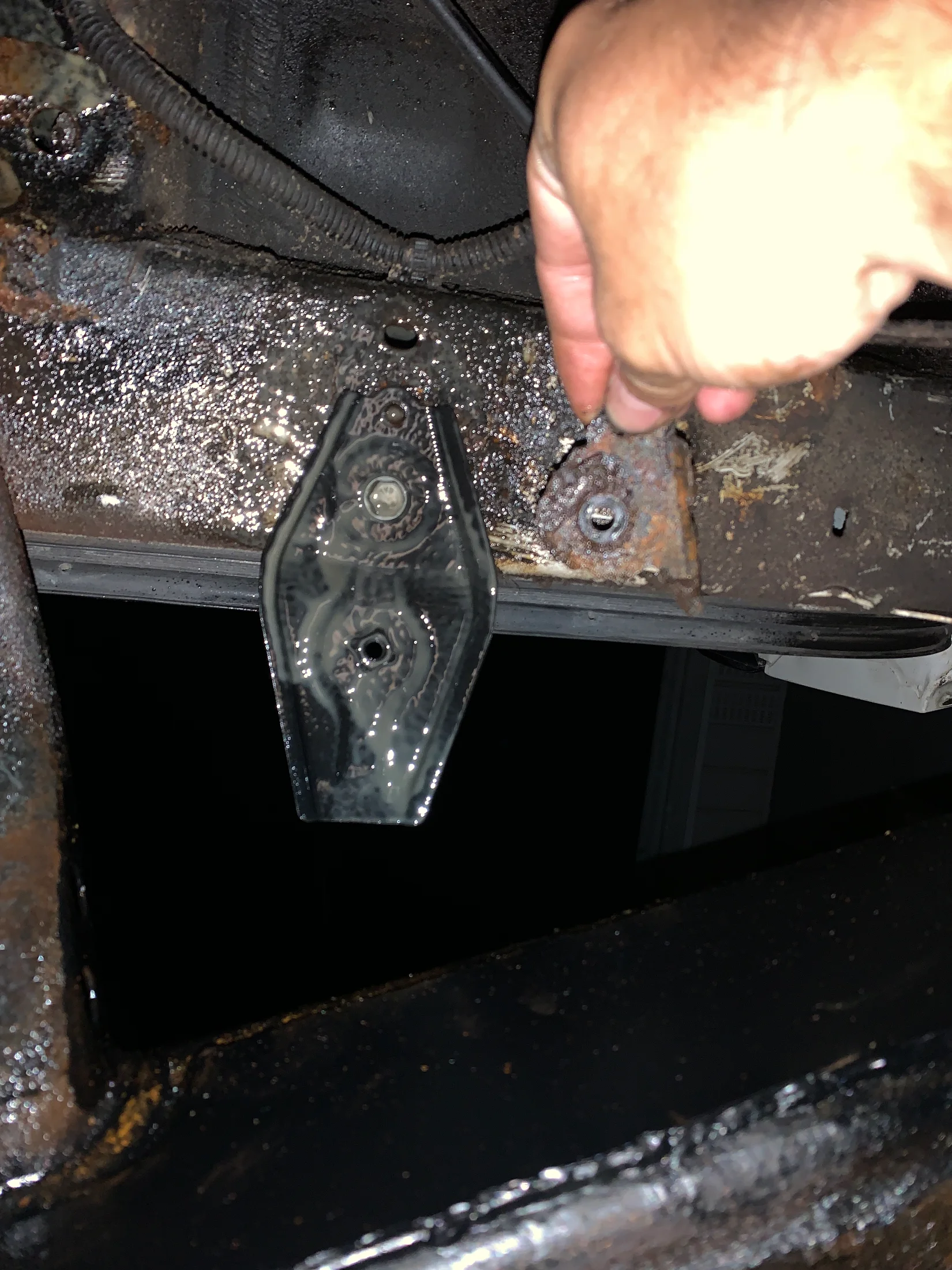

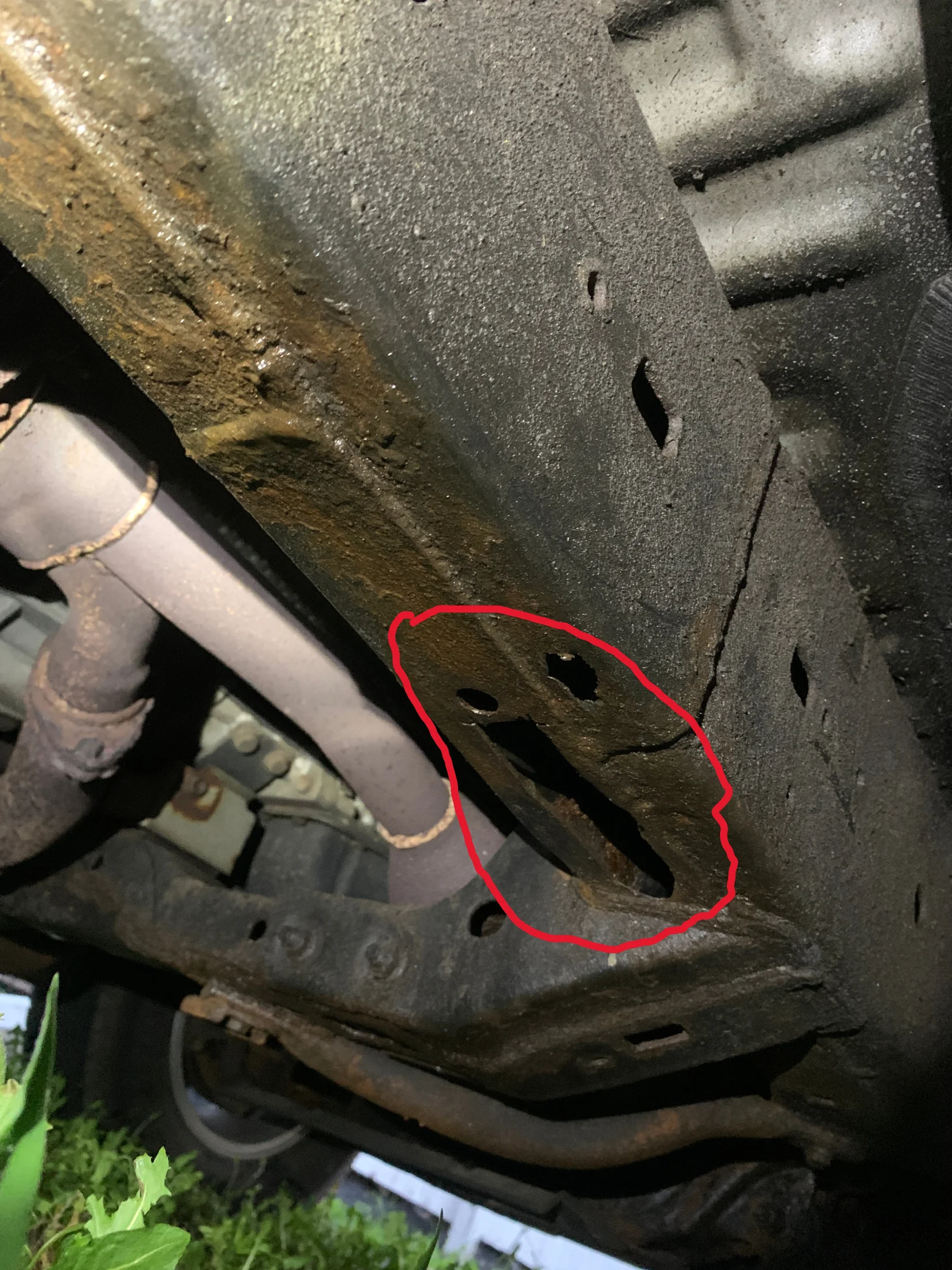

I purchased the frame Body Mount on Ebay from Japan - came in just a few Days - see pic.
Rear Frame Body Mount - $58 Ebay - Direct from Japan

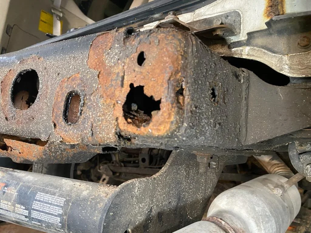

Rear Bumper cover was Removed.
As Suspected Rust was Worse than Visible.
Will Post the After Glamour Pics.
This Guy in Mid Ohio does nice Work!
Next will Wire Brush Everything & Coat with Fluid Film
Bumper Cover Brkts were Completely Rusted off Bumper Tube - After & Before Shown

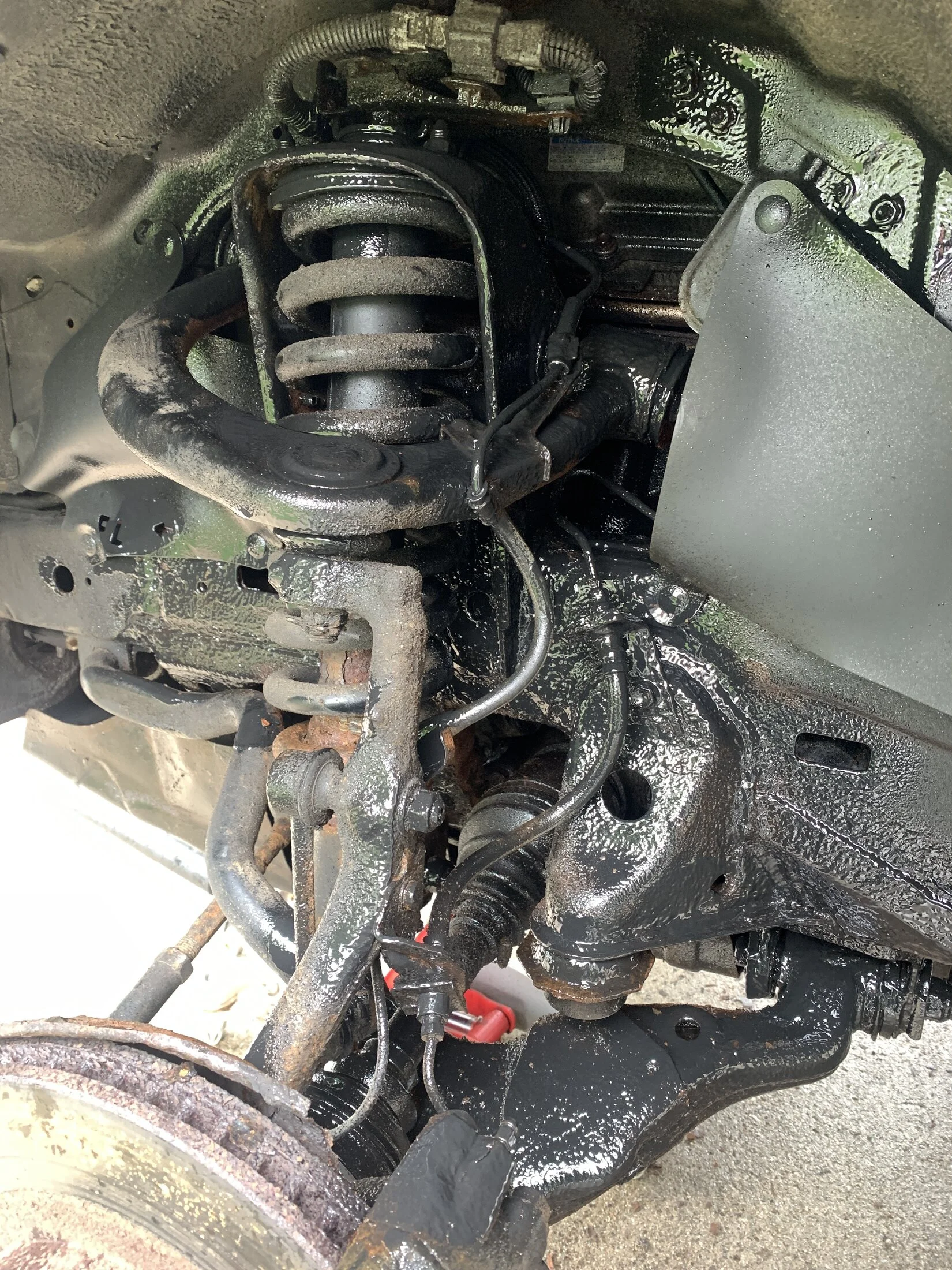

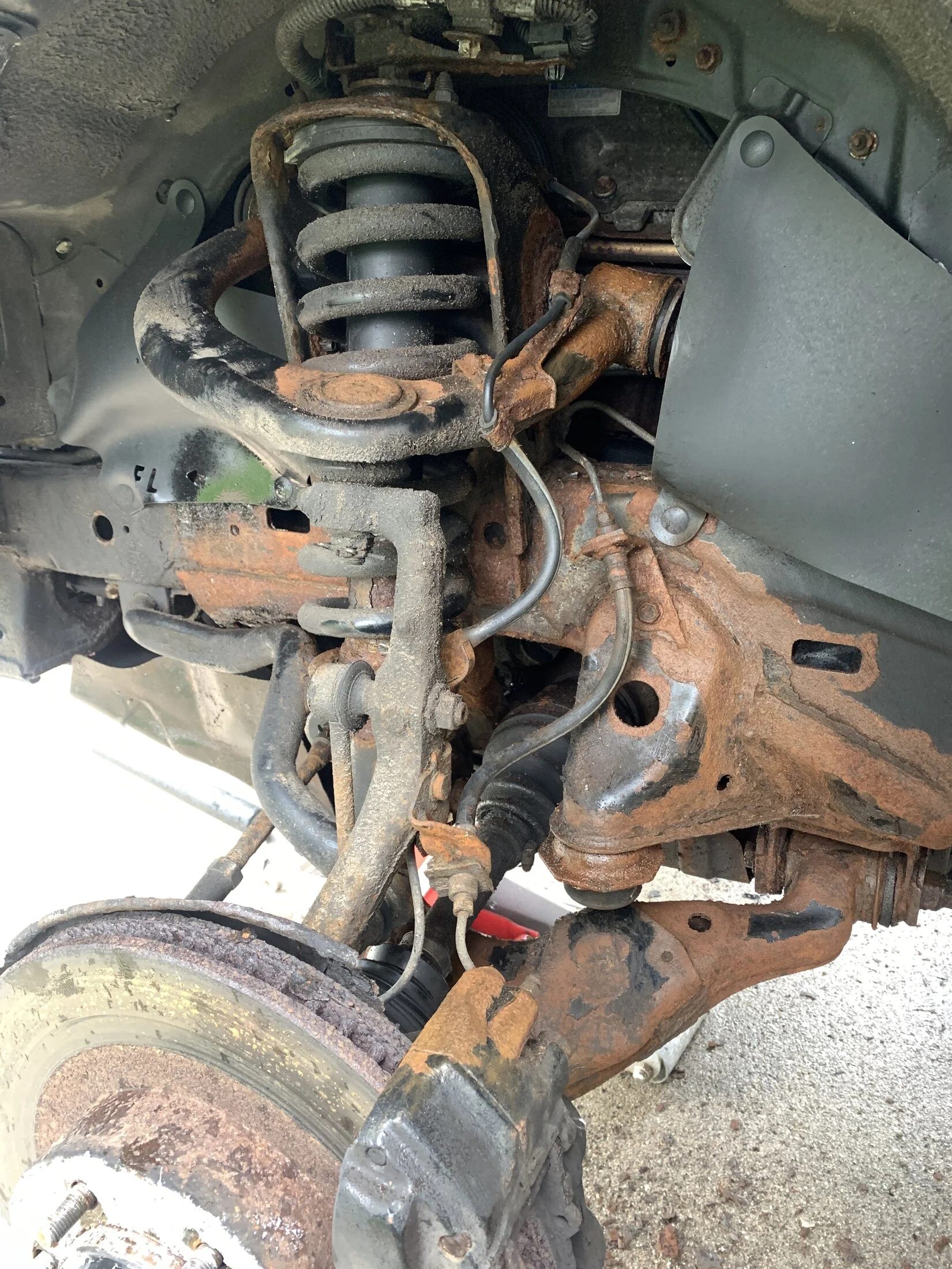

Took a Day off Work and installed the New Shocks, Rotors and Sway Bar Links - All from RockAuto - Scroll up to See Parts & Prices.
The work Really Hurt my Legs and Back or I'm just out of Shape. They Ached for Next day.
Started at 10AM and went till 8:30PM
Broke 1 Bolt on Drivers Side Bracket that Holds ABS Sensor - Used Stainless Hose Clamp to Hold Bracket where Screw Broke.
Old Shocks were Original and when Fully Compressed did not Retract.
Only way to get Sensors off Top of Shocks was to Bust them with Pry Bar (Torqs heads were Gone in screws).
Shocks were Set at .85" Lift and the Front to Rear Body Height Looks Consistent - No Measurements were Taken.
Takes 2 People to get New Shock in as it is Heavy an Needs Manipulated while Pushing Lower Link Down.
Spring Compressor works Much Better with 2 People and it is a Little Scary Restraining such a Strong Spring.
Used an additional Qt of Fluid Film on everything that was not Grease Covered.
