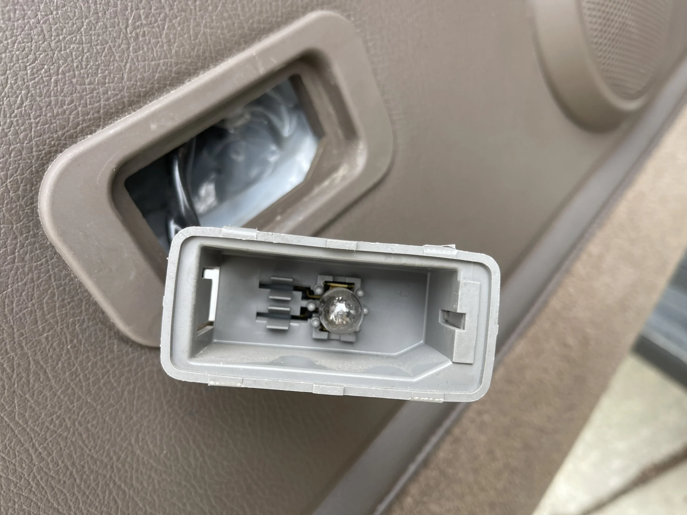

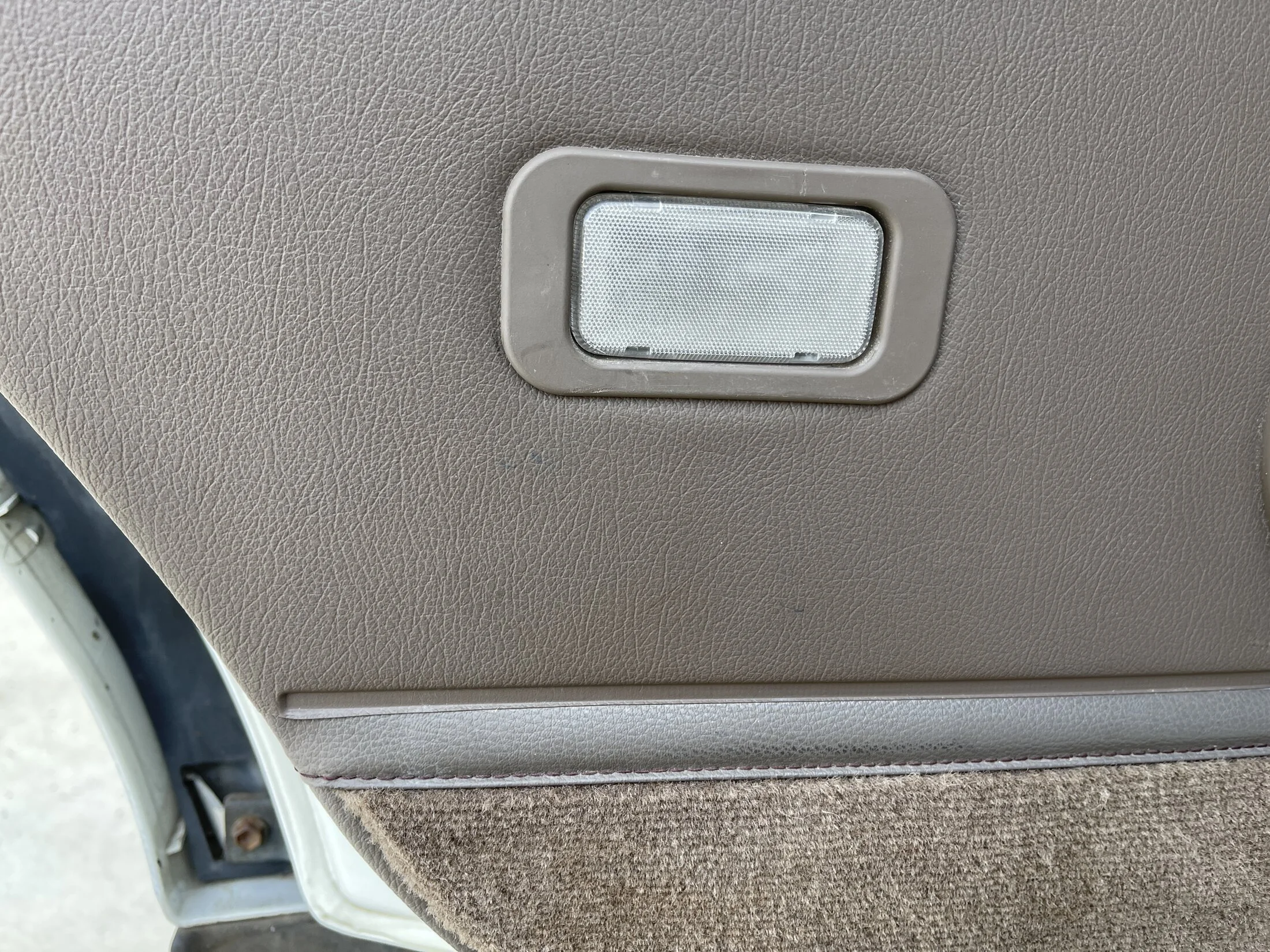

The courtesy lights on both back doors are not working. I suppose it is possible both bulbs failed, but I wonder if it could be something else that affects both. First off, I'm not sure how to remove the cover to get to the bulb. There aren't any obvious indents that a screwdriver might fit in to pop it out. Suggestions?
Could be bad bulbs, switches, or a corroded splice. check out this thread. Also, you can use a small screwdriver or plastic trim tool to remove the bulb housing from the door panel. It will rock sideways out of the panel. Pry between clear plastic lens and brown surround.

Thanks. Door switches look clean and rubber is supple. I got the whole bulb assembly out, but can't figure out how to remove the bulb. Doesn't seem to be as simple as pulling on it. Suggestions?
Pull it straight out.
Replacements are sold as the whole housing.
Unplug the connector and swap into a known-good location to see if it's the bulb or an issue with the power.

Great suggestion. The back light works in the front door, so it looks like the both back lights are not getting power.
Anything obvious I can do to remedy this?
