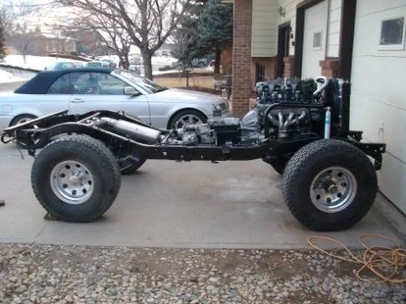

Here's what it looked like a few months ago:
