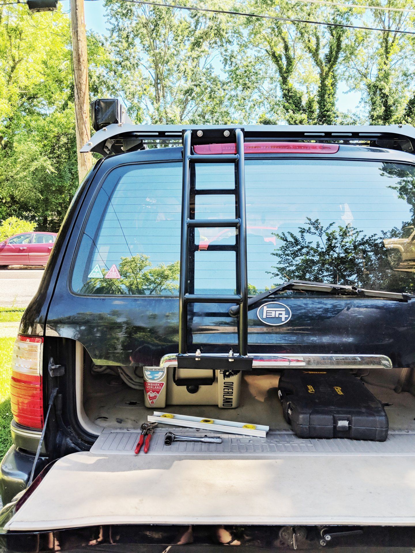

The install itself was very similar to the GOBI instructions. You position the top bracket, hang the ladder, position the assembly left to right, mark the bracket locations and then install the brackets. They include aluminum adhesive-backed strips to tighten the set screws against, and some 3M protective film to protect the paint. I opted to use 3M VHB adhesive tape instead. I did have to open up the bottom edge mounting tabs to fit over the aluminum strip and the LX metal trim:
Final left-right adjustment:
The ladder fits well, holds my weight just fine and I think it looks good too. I added some mounts to it and use it to hang a shovel and an axe. I also have a BROG spare tire bag with recovery gear that I hang on it:
Overall, I'm happy with the ladder. It does what it's supposed to do, it was in-stock/available unlike the competition, and it's available in raw steel for less money. The ladders are available here and priced at $175 raw and $225 for PC.

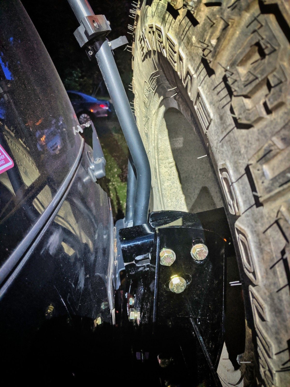

I like the concept of a side ladder, but the mounting concerns me. Are there any issues with the fact that it rigidly connects the frame to the body? In this case, one end of the ladder mounts to the bumper (which is rigidly attached to the frame) and the other connects to the body (which is connected to the frame through flexible bushings). Any flexing of the body on the frame it seems would cause a good amount of stress on the ladder and ladder connection points.
You can find more info and a few more pics of this ladder on the website, Gamiviti , so far it's worked out great for my use and it has enough play to slide up and down without being a concern when flexing.
