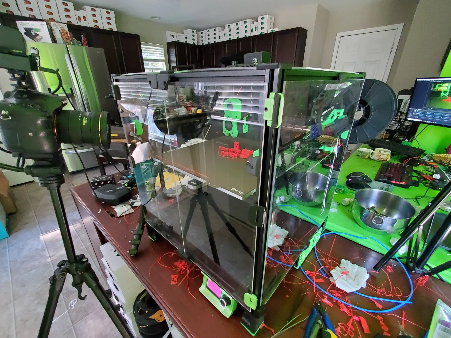

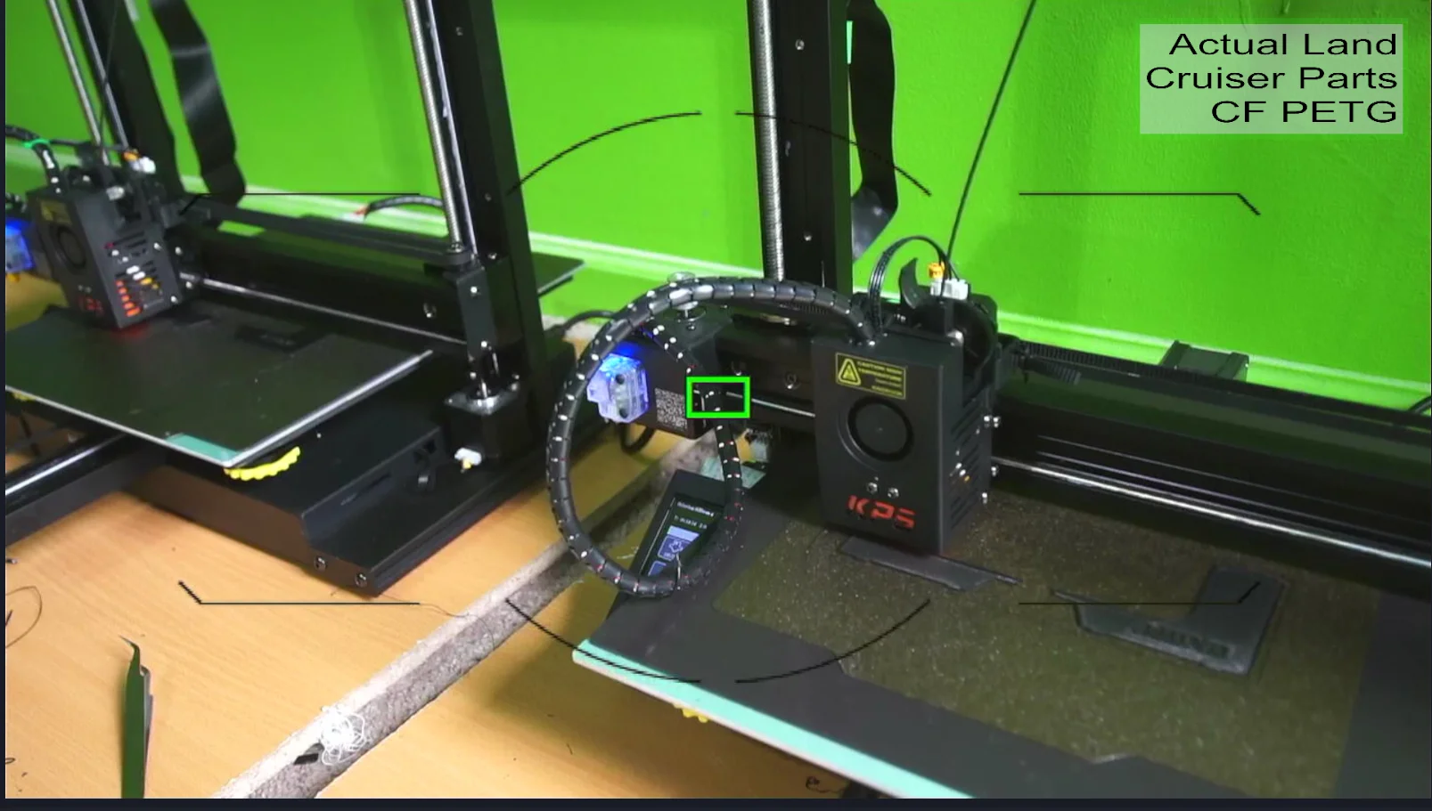

I threw 2 in the oven in carbon fiber petg.
Live feed here:
and

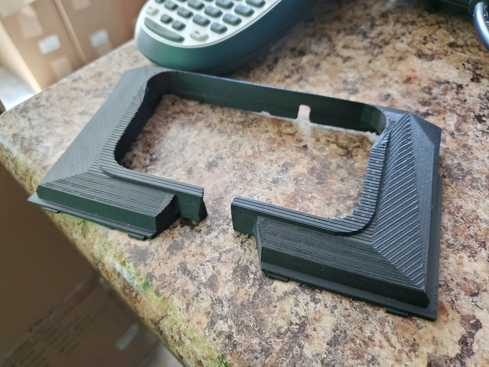

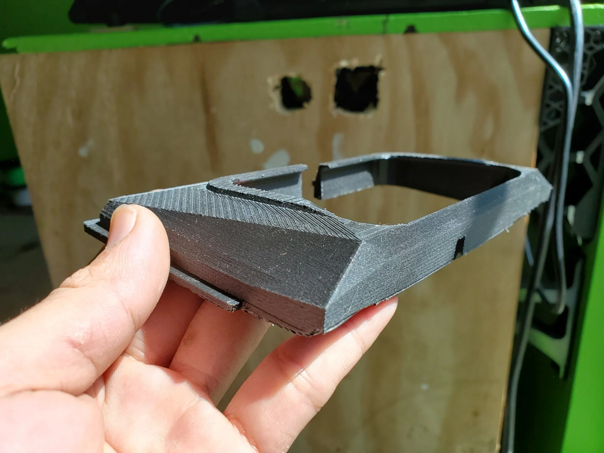

First one done. Will clean it up a little later, this one was just to test support settings. I will make the top more smooth/fix the ironing settings later today.
Also will try to clean up the overhang area in last photo.

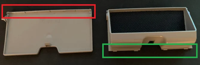

How do I pop the sunglass insert thing out to put this in?
Awesome!!
So the red box is where it clips in. The green box tabs just slide in. So if you put something real thin between the plastic pieces in the red box area it will come loose. Something like guitar pics or something similar work pretty good.

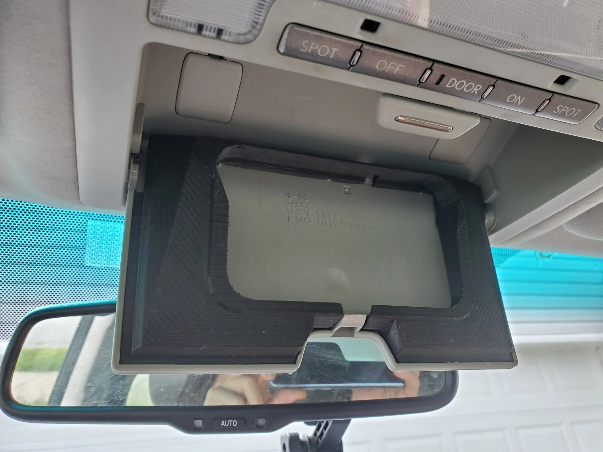

Sorry been moving slow. Checked fitment just now and looks good.
Whoever wants one just dm me your address and I'll post one your way: your version will look better than mine/the test print.

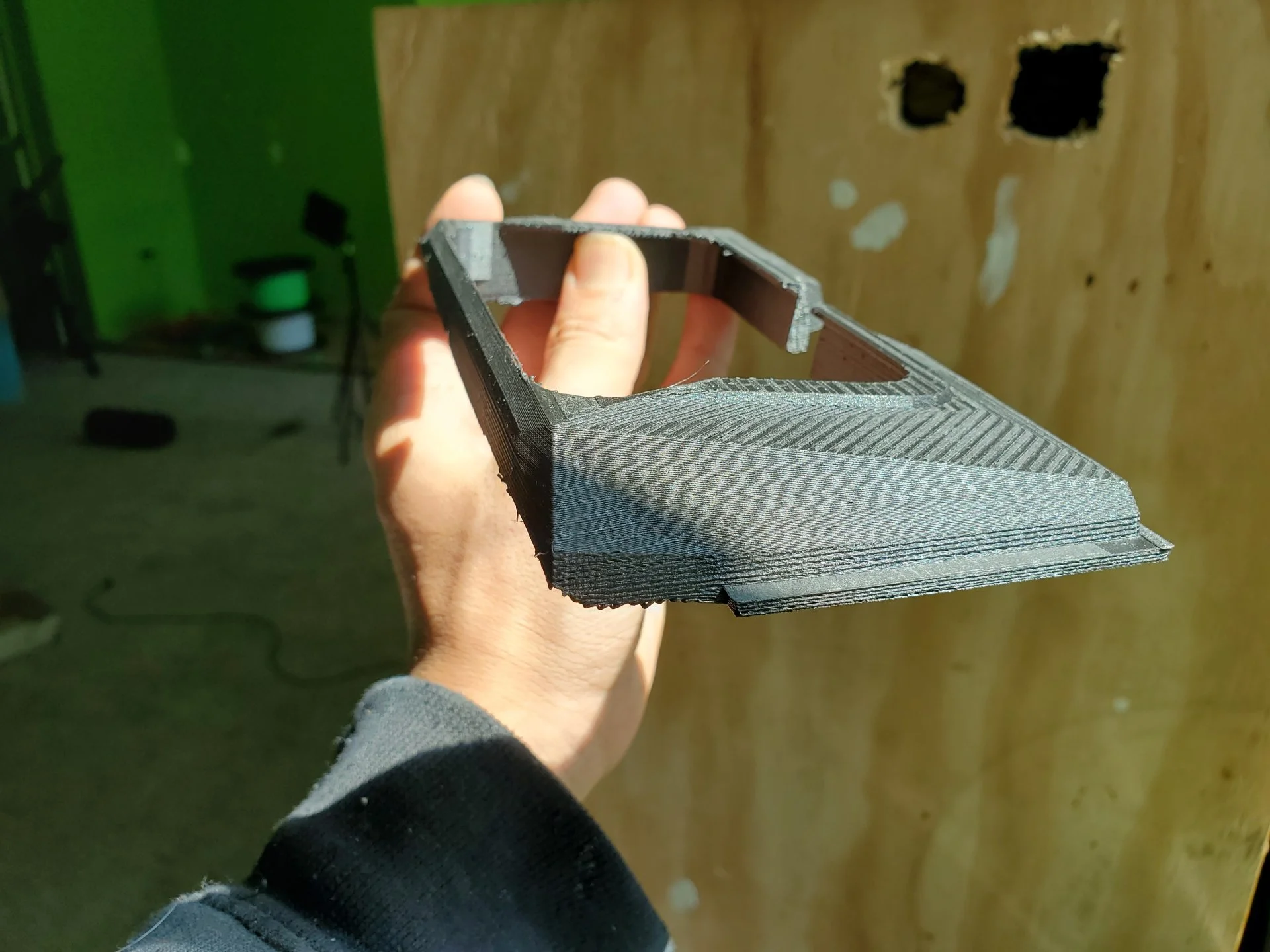

Also, ABS machines will be ready soon if you want one that won't melt even in Arizona. The one shown in photo is Carbon Fiber PETG, which will survive most climates.
For ABS i have Voron Fluorescent Red, and Black. I will assume Black unless otherwise stated.
First ABS test prints for auxbeam switch holder today, and @TeCKis300 cup holders this week.

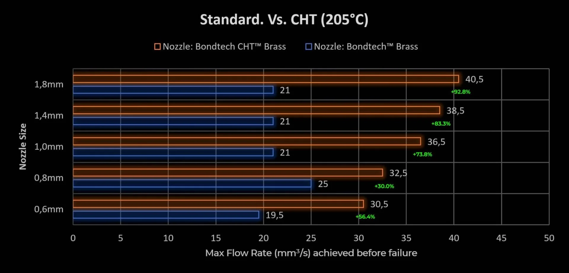

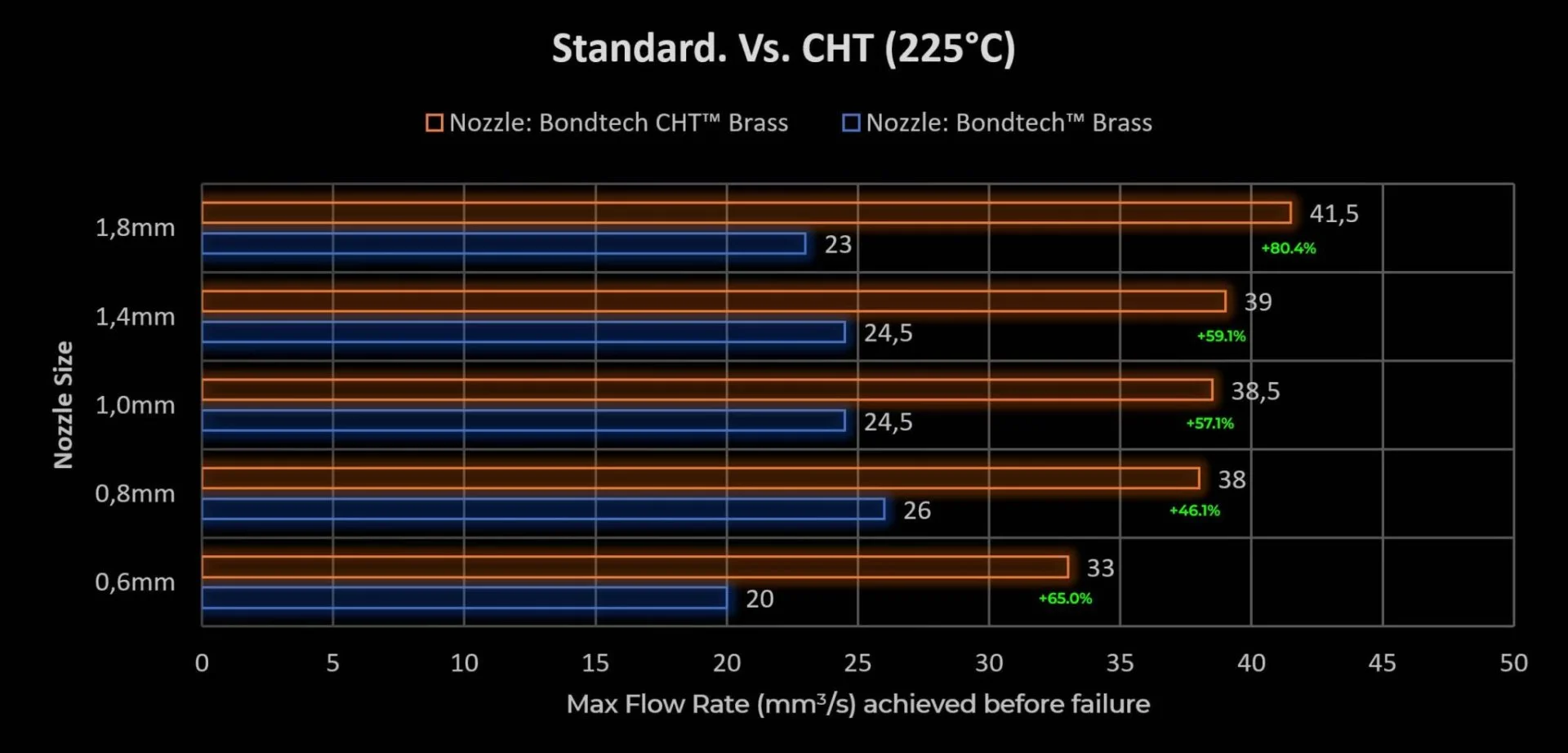

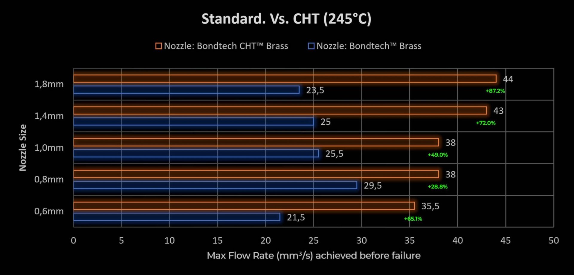

By the way, if you are referring to the CHT nozzles from bondtech, you can actually get up to 100% increase if u combine with higher temps as well.

You're all over this. And I gleaned a few nuggets on that. I've only ever gone with the bog std .4 nozzle. Need to branch out here as I'm rarely printing detail parts. Thanks!!

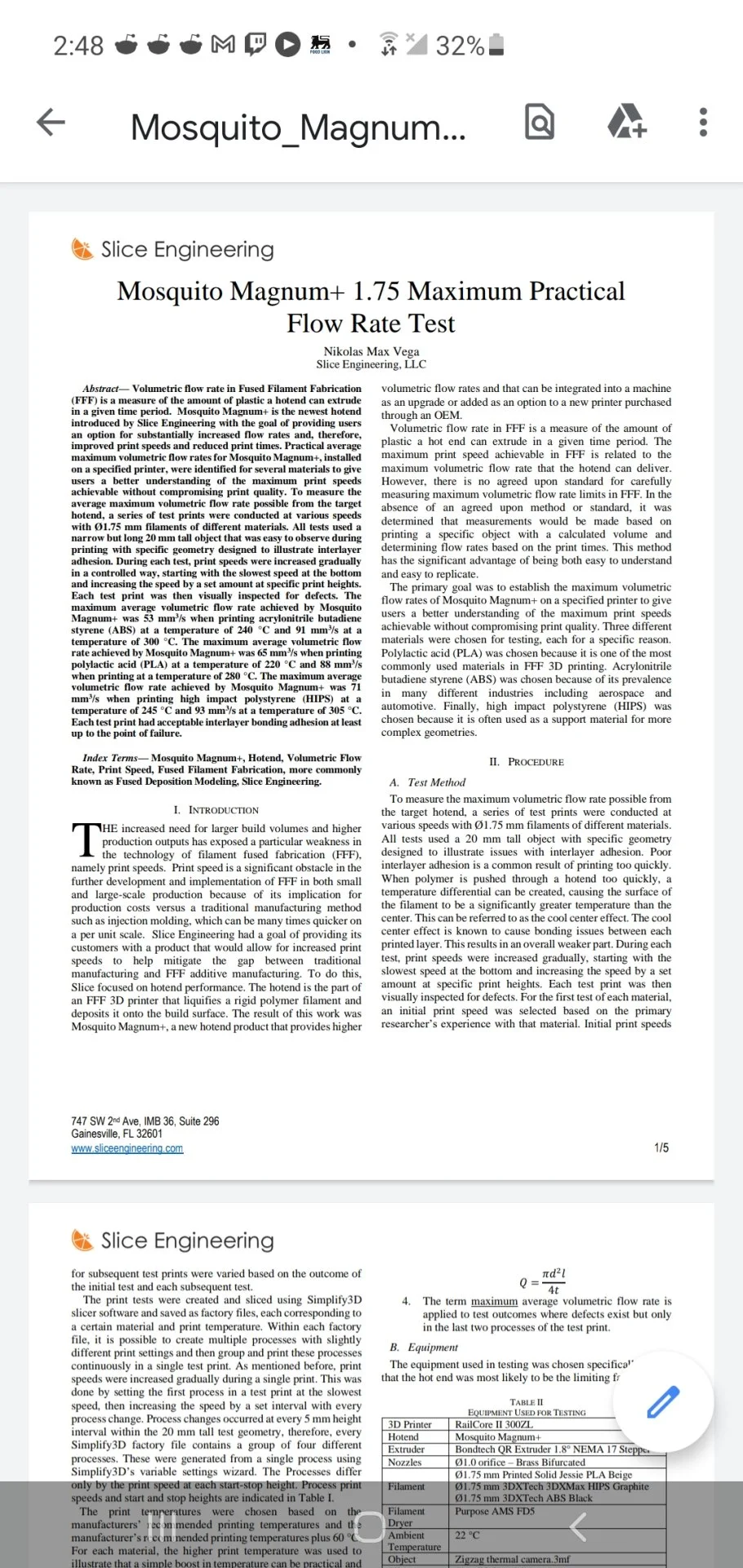

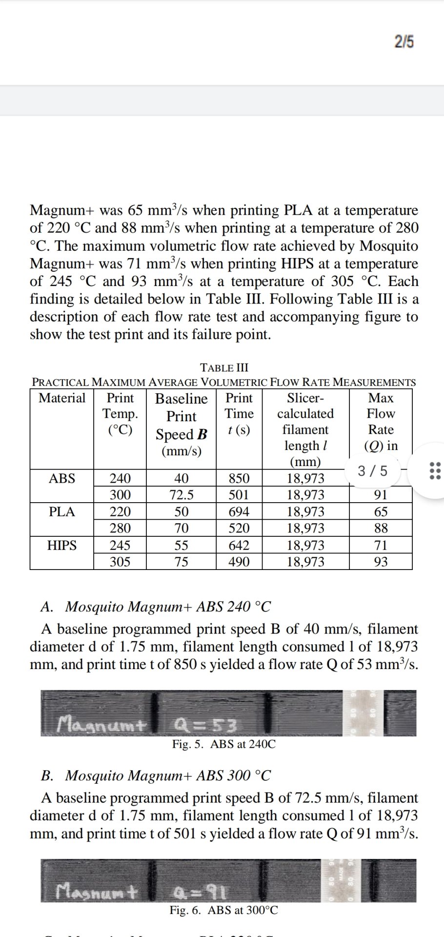

Thanks for that. More goodness to dig into.
My pleasure boss, it just basically says temperatures do have an effect on flow rate, and so does nozzle inlet (like the triple helix/twist on the CHT)and even size of the nozzle orifice; bigger and hotter is better for melting things faster. The CHT is special because it cuts up filament and melts from the inside, and that's usually the coldest region and the biggest bottleneck when trying to melt fast.
Also says flow rate (how fast you can deposit and melt plastic) is most accurate measure of your printers true printing speeds.
