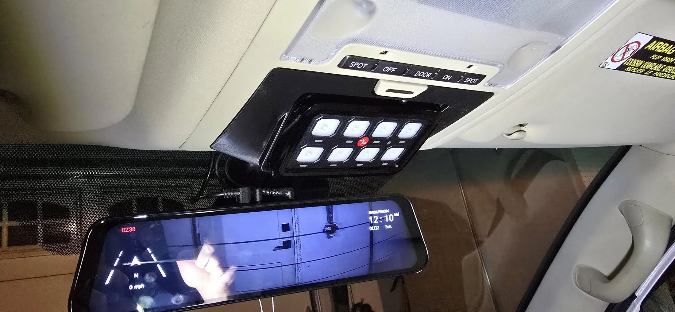

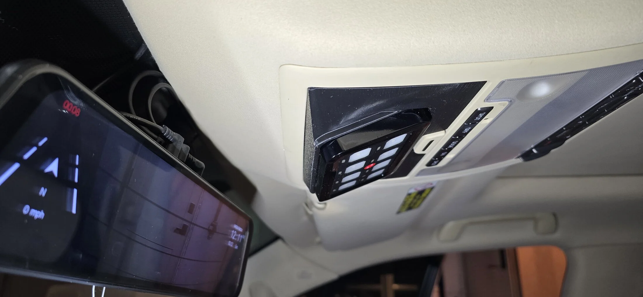

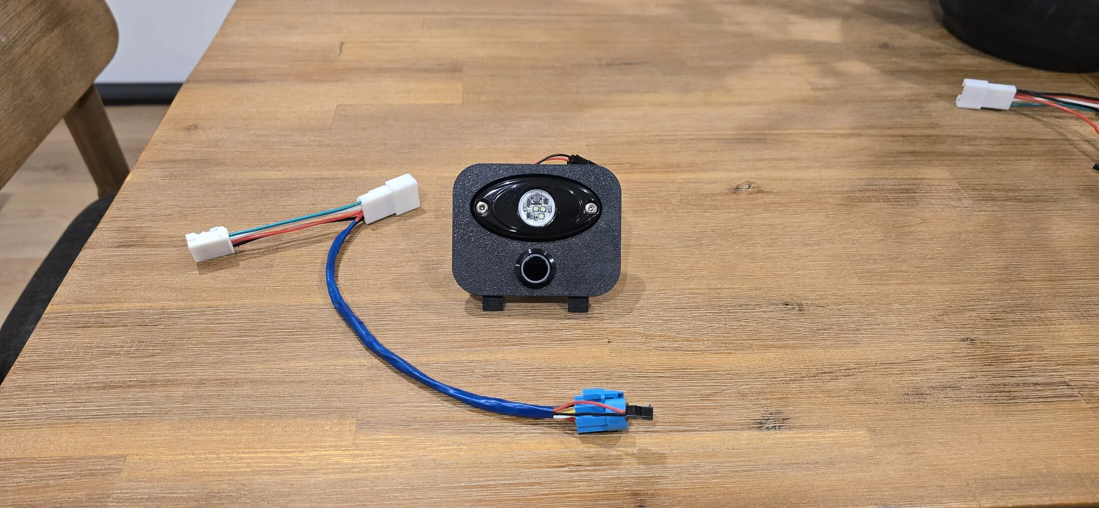

For my LX, just drew up and printed this sunglass holder location auxbeam switch mount (still needs final tweaks and reprint in carbon fiber reinforced material) and some recessed cargo lights.
Looking good.

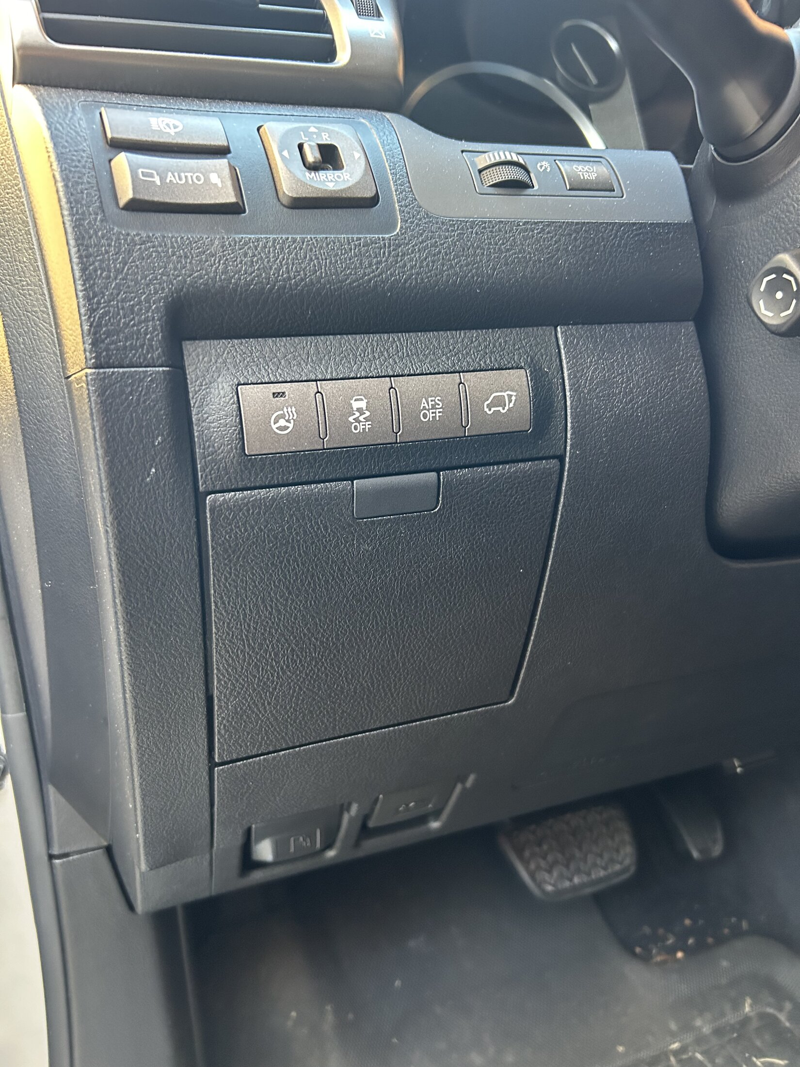

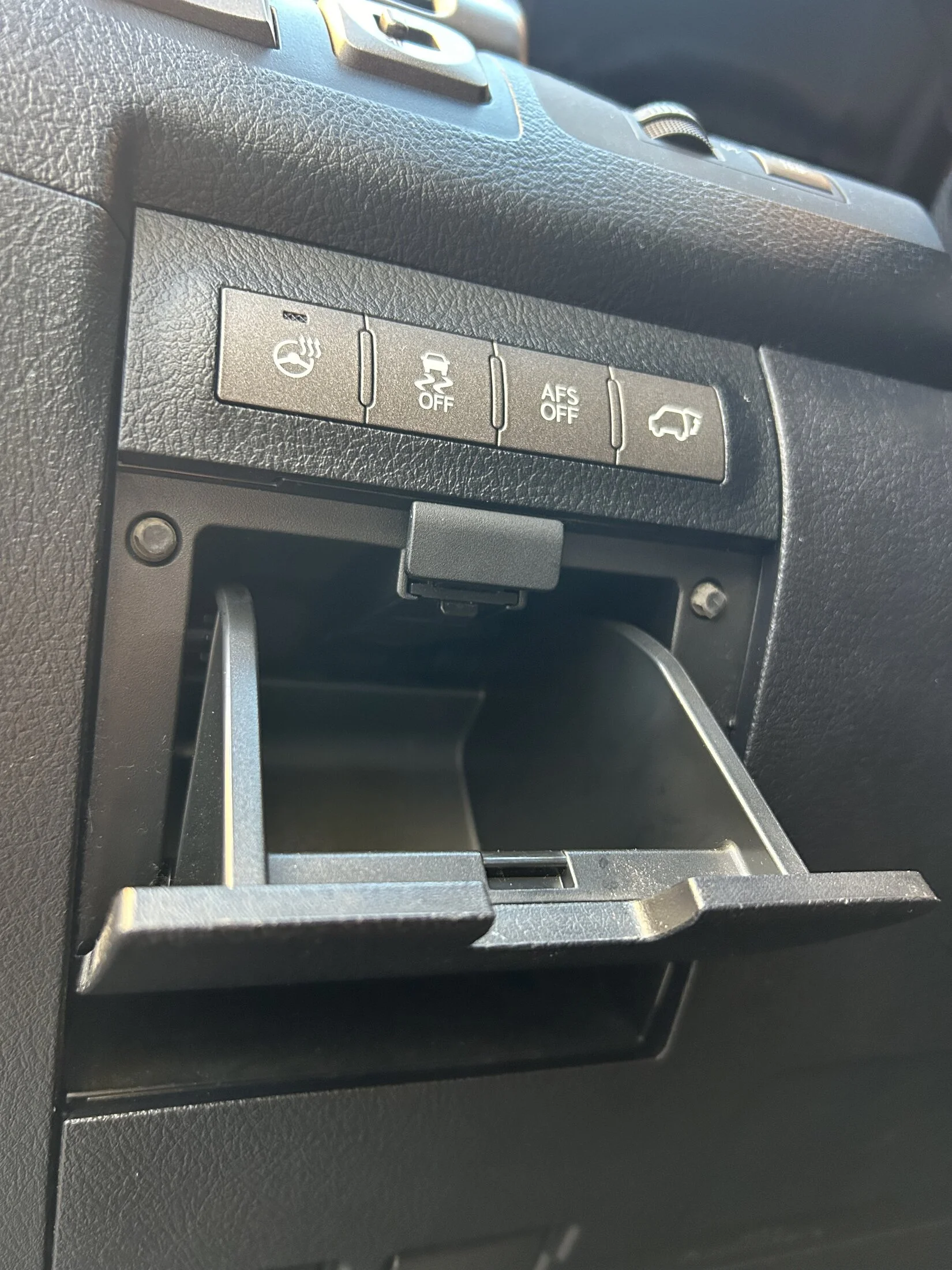

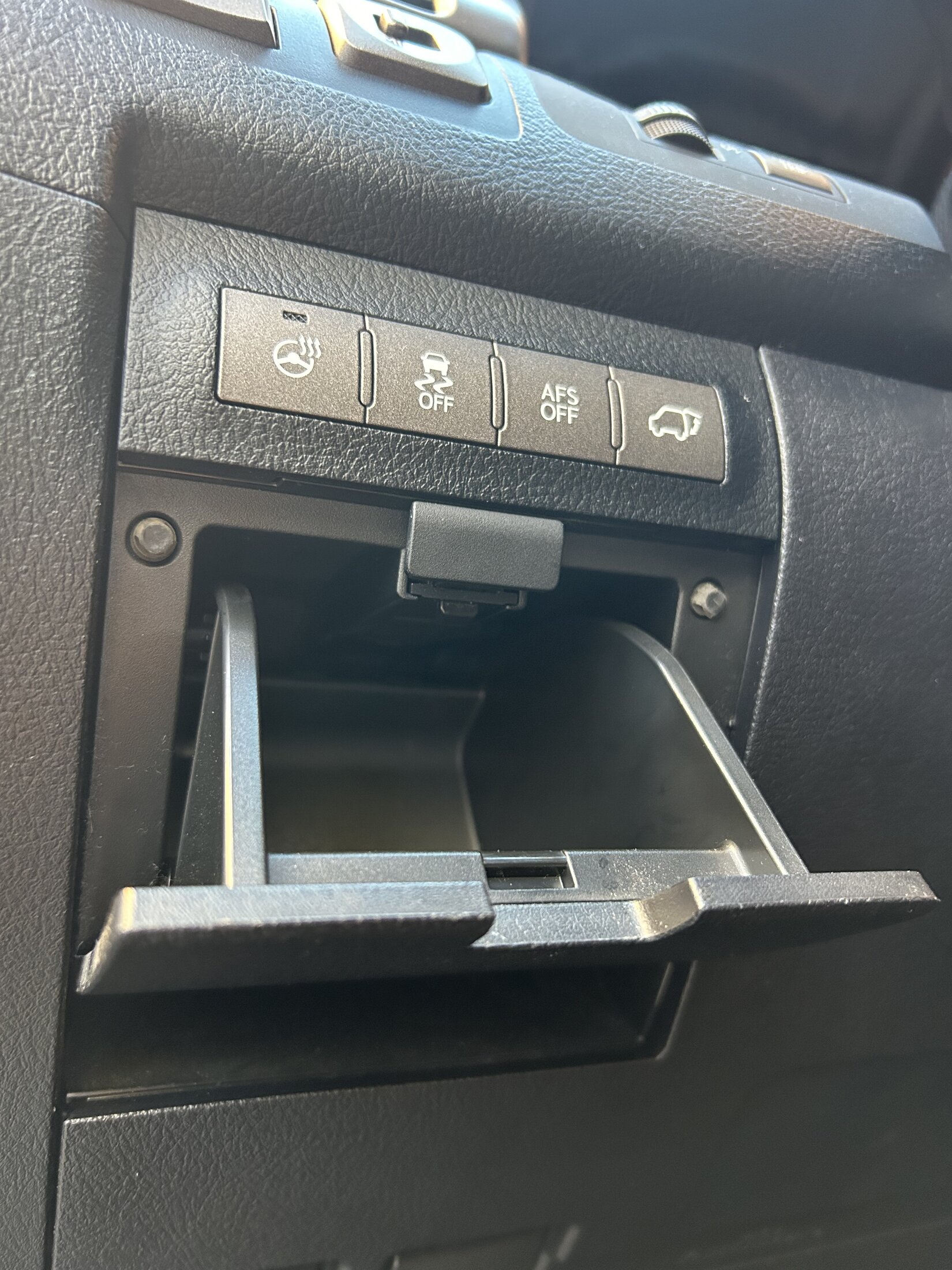

I have a 2014 and this is what mine looks like.

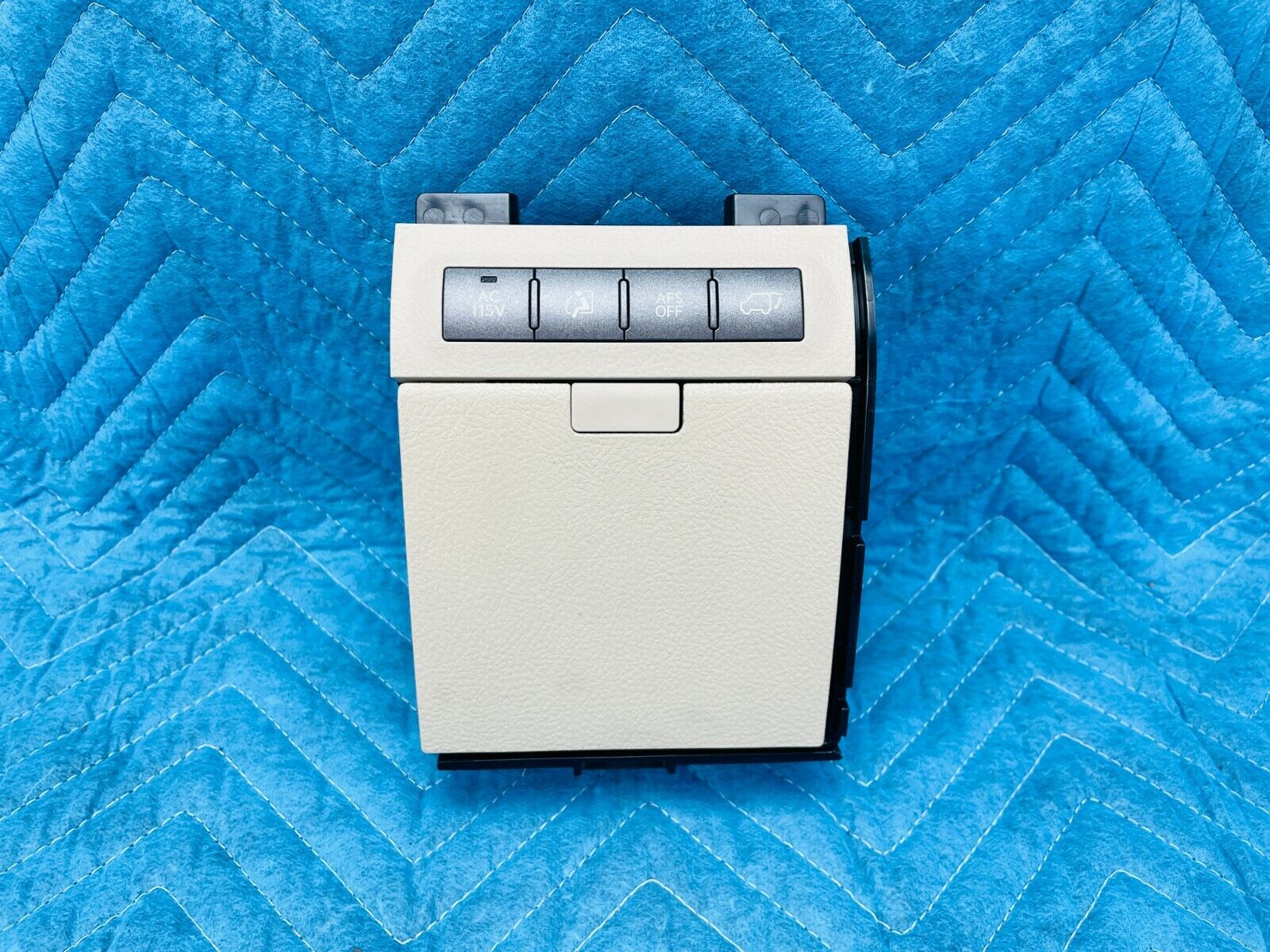

Not sure if the button panel and cubby are all-in-one or if you can separate them and just replace the cubby with a dummy panel (preferred route if possible).
Don’t think I’ve seen anything similar for the LX. Why not just mount it over the cubby? Would be the easiest and cheapest. If you’re not going to use the cubby, just mount on it. That’s what I did in my 200 similar to the SDHQ panel. I just cut out a hole and mounted it. Looks the exact same as the SDHQ, except without the tacky SDHQ engraving on the side.
They are separate pieces. Each one is relatively easy to remove. If I recall, correctly, you need to remove the lower panel first, then a few bolts, then the panel below the steering wheel (but above the knee airbag). Then each of these panels (cubby and button panel) just pulls out with relative ease. Obviously there's a wiring harness on the button panel.
I hear ya. Last I was under there, the button on the right side are routed as such so they likely won't reach over to the left side and vice versa. The easiest option would definitely be to get rid of the push button cubby on the left. If yours is 08-15 then it's the same as mine and I can already model the cubby blank, if it's 16+ I don't have access to one.

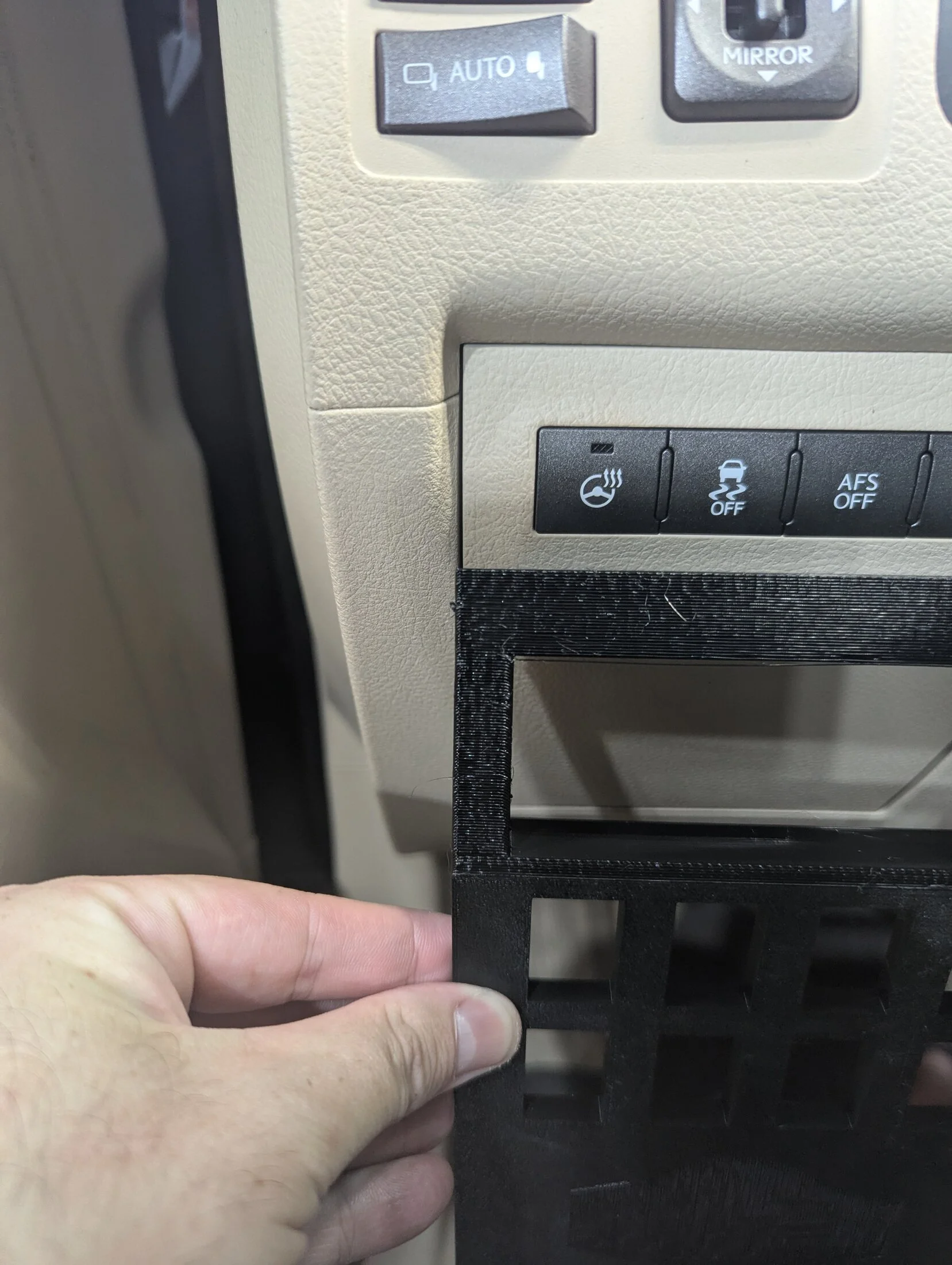

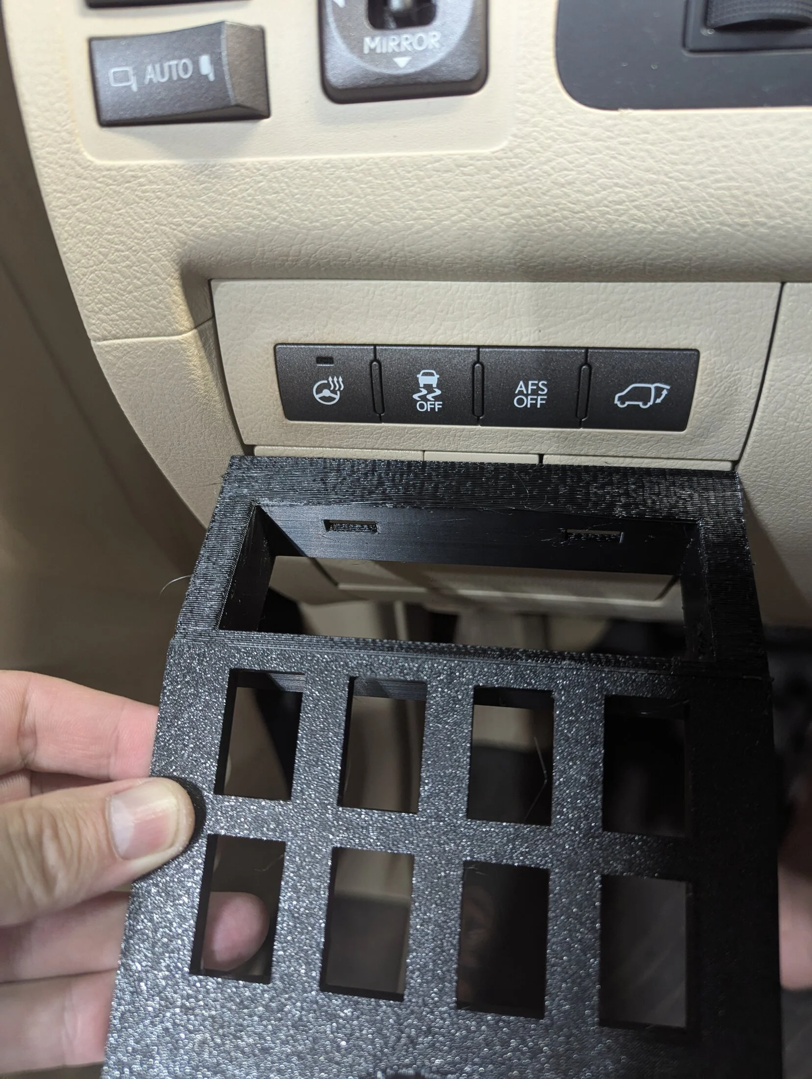

I went ahead and printed a version of what the other guys had. But I crudely filled the trailer brake hole. Its a good start but it's still too wide overall. The top button section is also too big.
