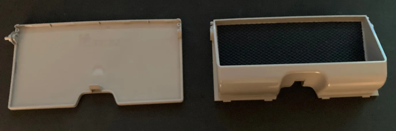

Here's how the sunglasses holder looks when you detach the two pieces. When detaching them, insert something thin into the top part at the seam, then it just lifts out.

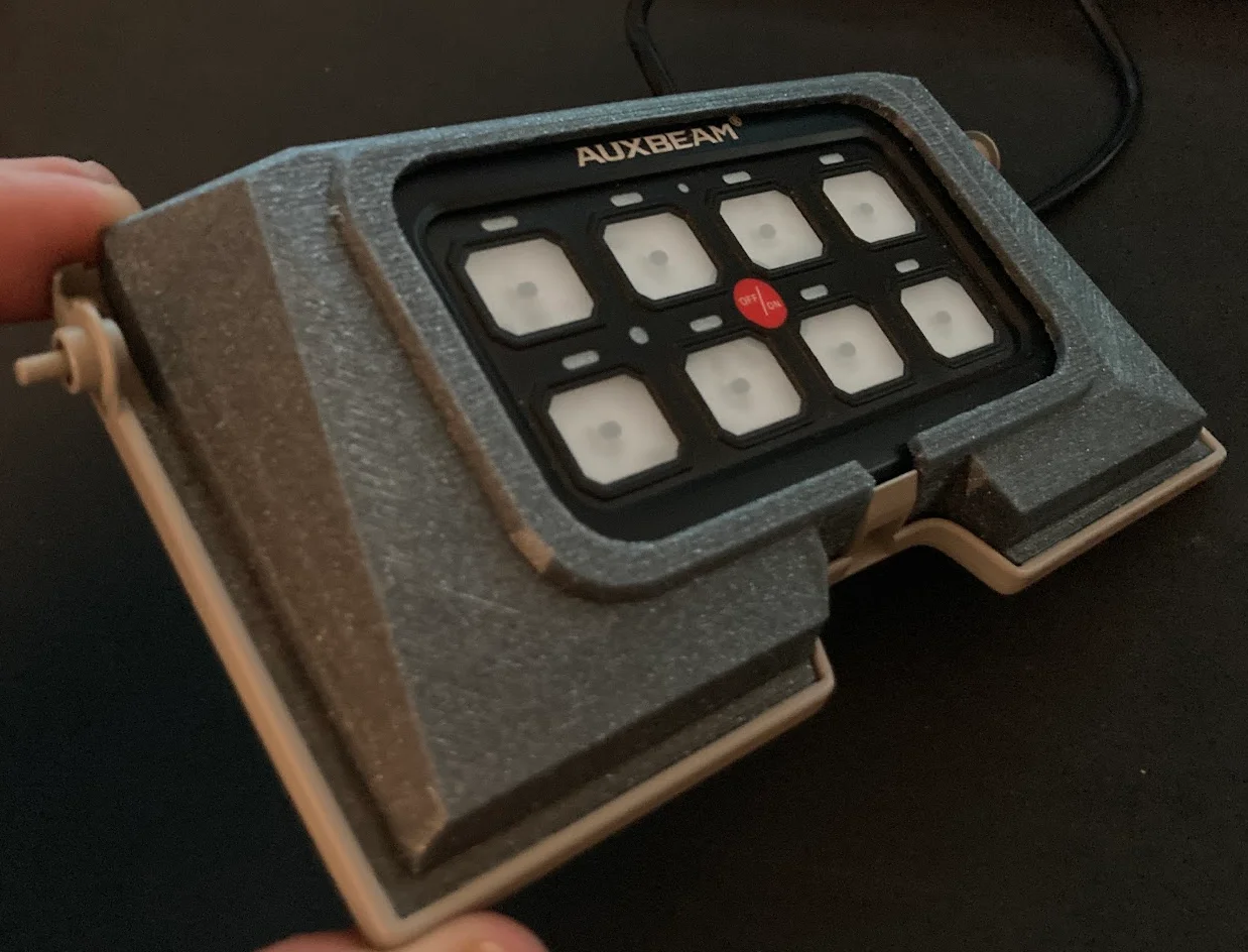

The 3d printed piece I made then clips into the panel in place of the holder...

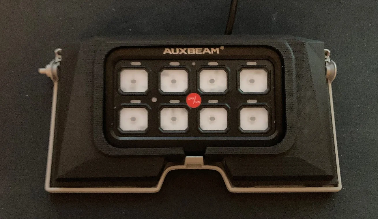

Another shot with the lighter plastic. Did a few prints in PLA for now but I'll do an ABS version for the final one before the summer hits.
Let me check fitment up in place. Make sure I don't have to make any other mods. I'll make a thingiverse post when it checks out.

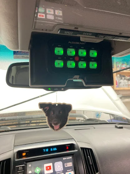

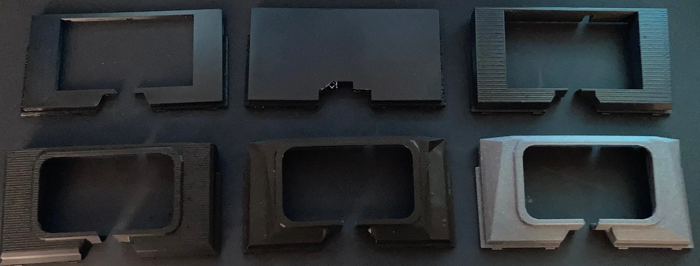

Success! Took me a little longer than I wanted to get back in the garage. Had to make some modifications to the design to make more clearance on the back side, but the latest version fits good.

I looked through the previous iterations, I don't think any of them would help more than the latest CAD file. Most of the adjustments have had to do with fitment into the factory piece and for overall thickness.
