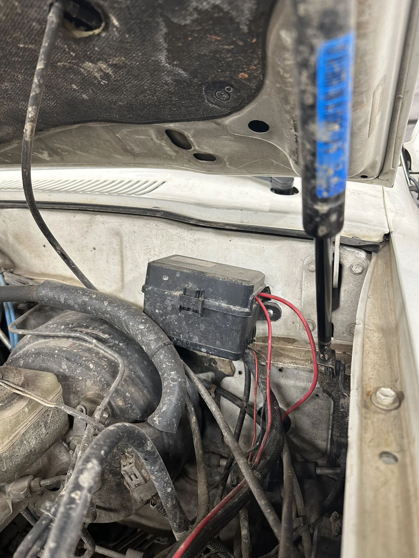

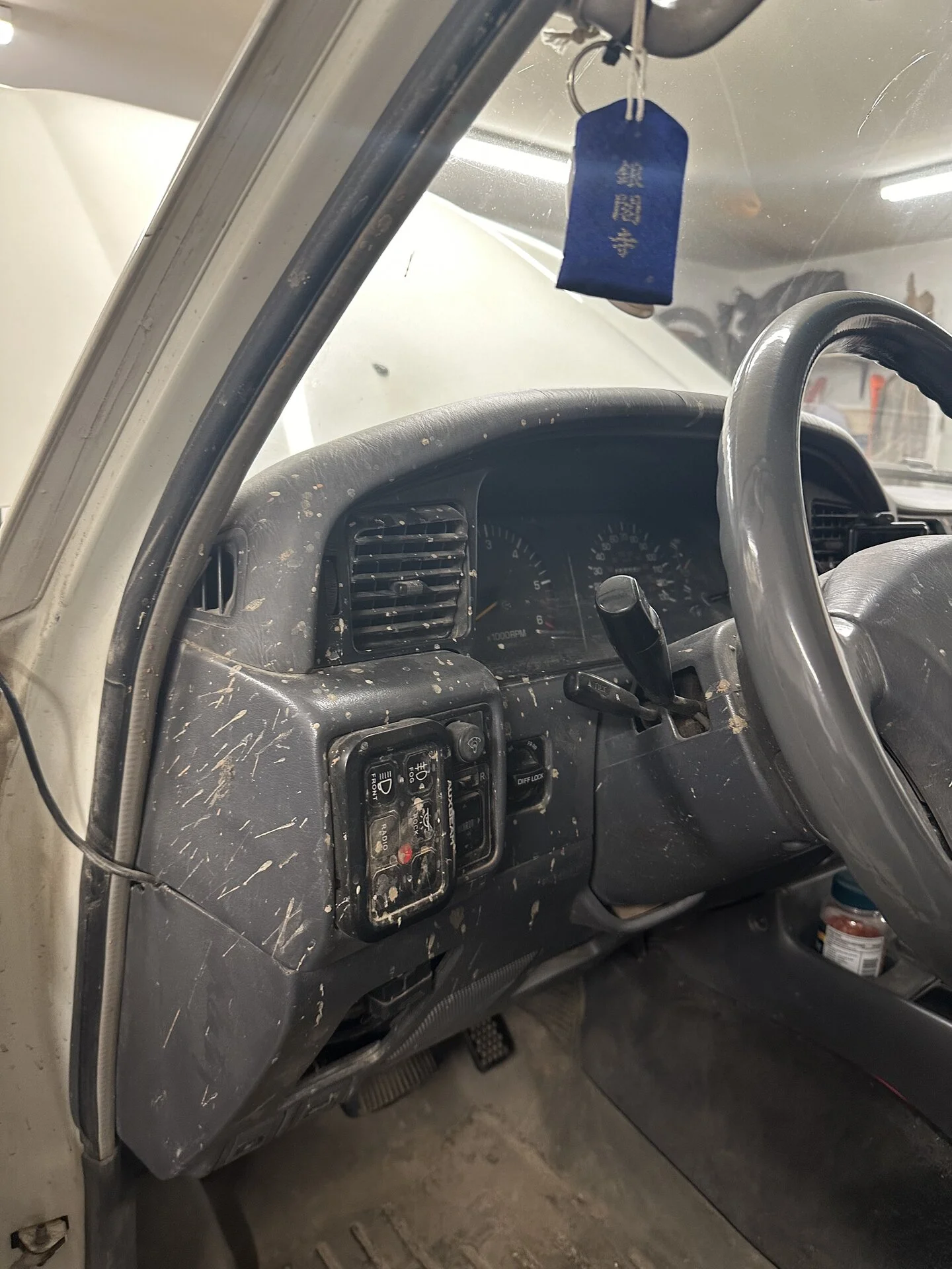

I just used the supplied 3M tape and fed the wires into the dash. I extended the harness and mounted the fuse box on the firewall. It’s been like this for over a year and I dig it

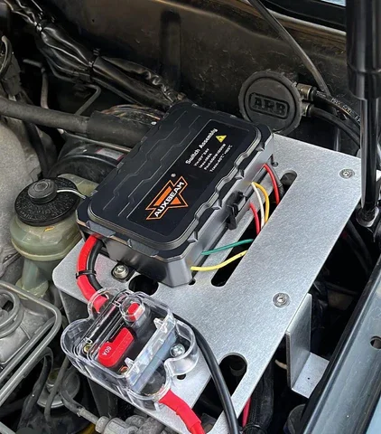

I am not affiliated with these guys at all but i have been looking for a similar solution for mounting a fuseblock or an auxbeam under the hood and found this:
This is from Bullet Proof Fabricating...ive never heard of them to be honest
