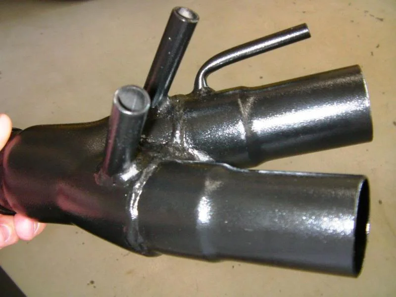

Here is a very crude, but simple schematic of the the tank install and a pic of the dual filler neck.
As you can see, it would be virtually impossible to plumb things wrong given the diameters of the main supply lines vs the vent lines vs the transfer line as well as the angles of the lines welded into the neck. One main supply/vent point towards the main tank and another main supply/vent point to the aux. And the bent transfer tube/inlet is unmistakable.

Even worse then.
Not given the pump only puts out 4 psi.

AFAIK just about everyone that has added an aux tank, mine included, has ended up with higher tank vapor pressure at the cap. I assume this is mainly due to not having a larger or dual evaporate canister.
I still don't like how the feed tube appears crimped...they did a poor job bending that tube. Remember: You have an unresolved problem ;)
I had the same opinion about the crimp in the tube, however after watching it operate it doesn't appear to be a bottleneck given the low psi of the pump.
