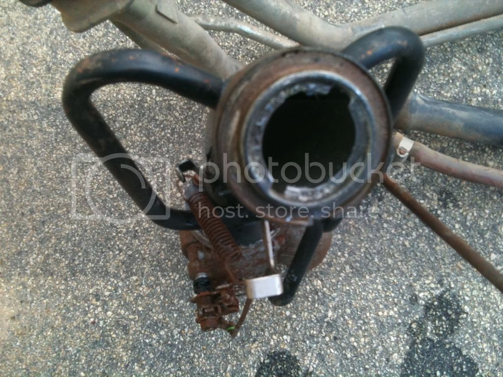

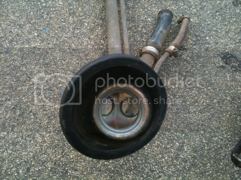

my 80 series and 100 series duel filler necks are for sale.
PM if interested

100
80

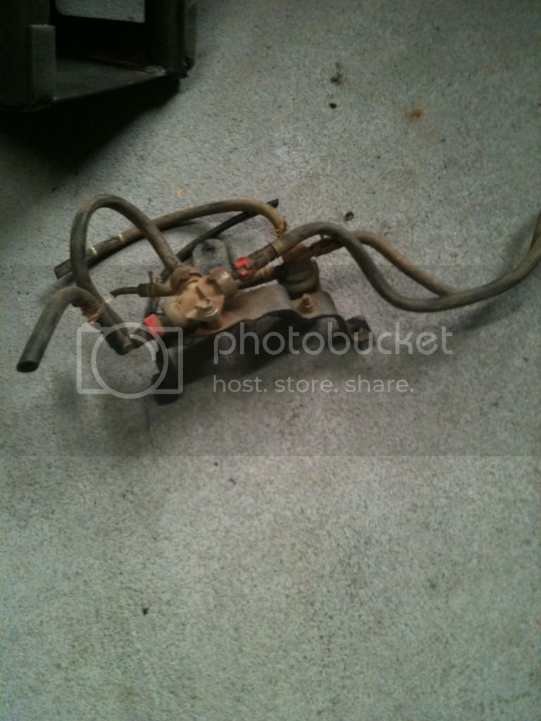

100series solenoid
