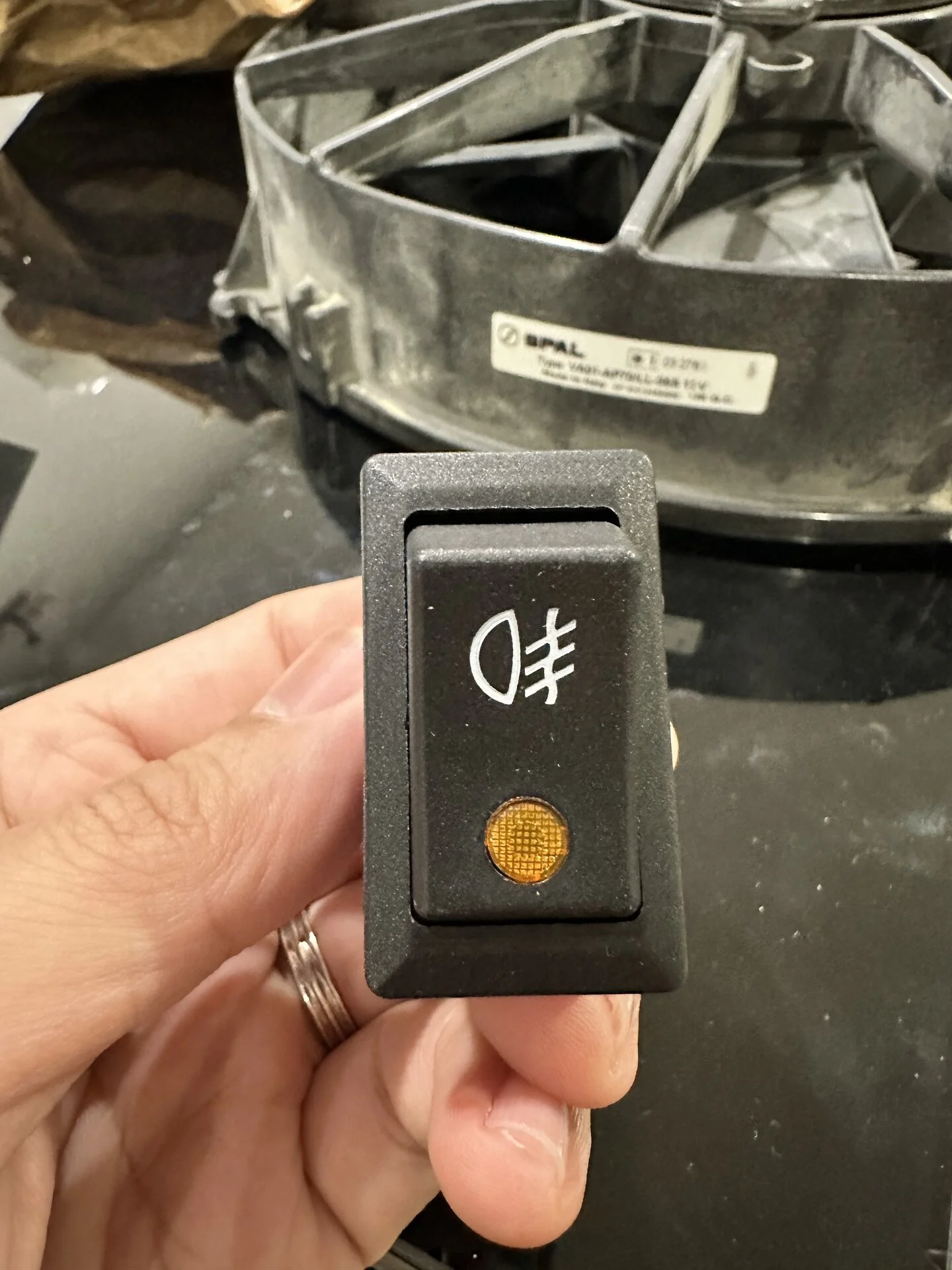

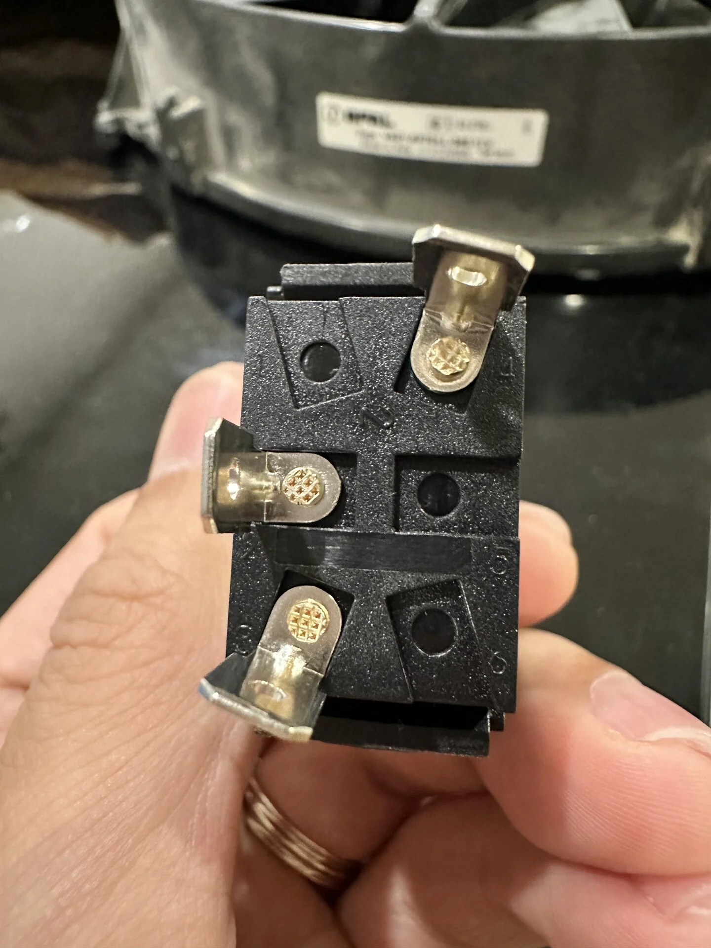

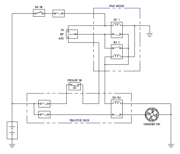

I would like to install a pusher fan to increase AC cooling during summer together with a revamp AC system and parallel condenser. I'm not very good at wiring, even reading electrical wiring diagram so I would need the instructions that a 6 year old would understand.
Reading ABC of cooling, I plan on hooking it up to the medium pressure switch in the AC plus an override ON switch for hot and slow traffic days. How do you make an override OFF so the fan will not run when the vehicle is not running regardless of AC pressure?
Parts:

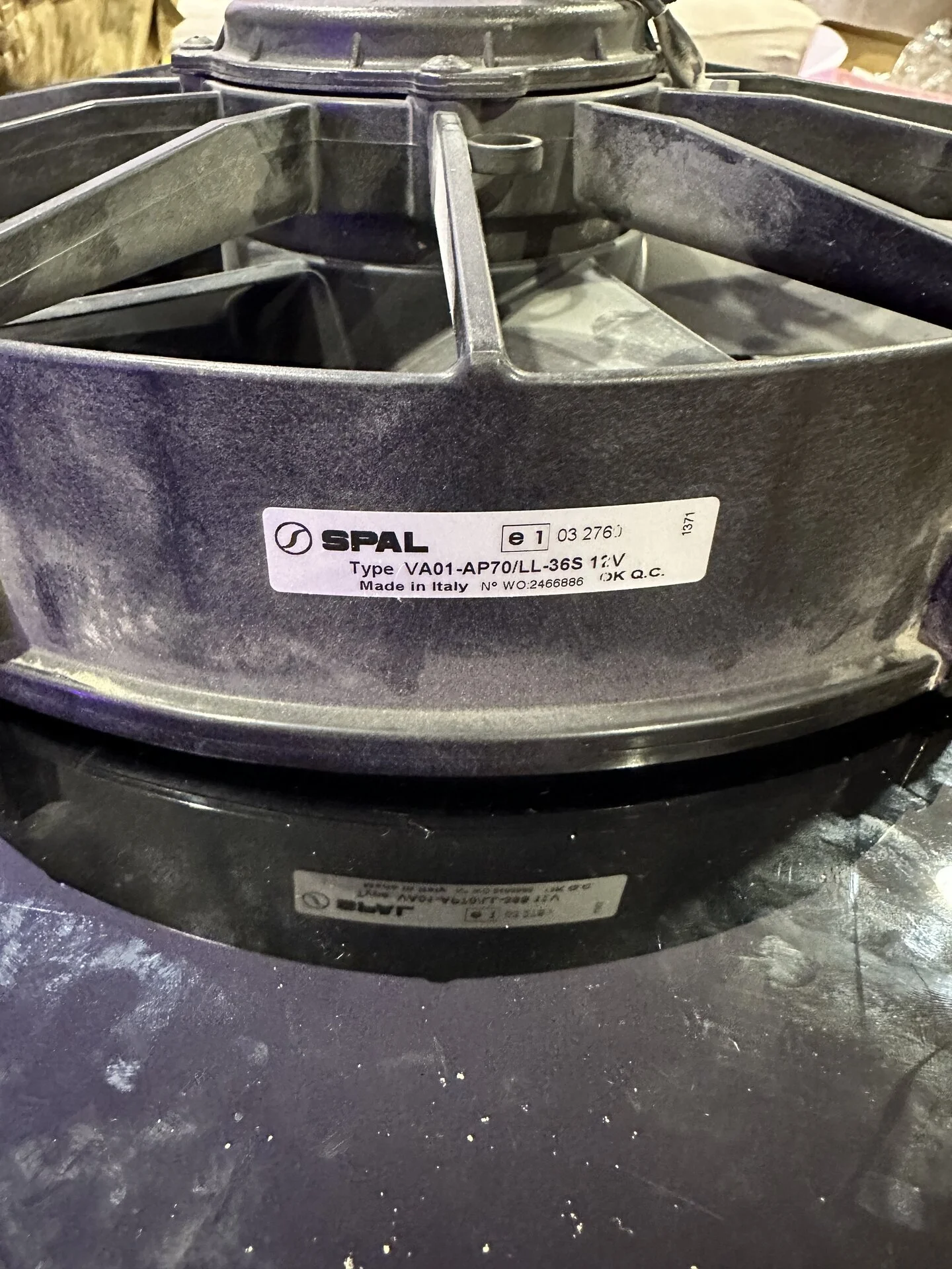

Spal VA01-AP70/LL-36S
Toyota switch (3 prong)

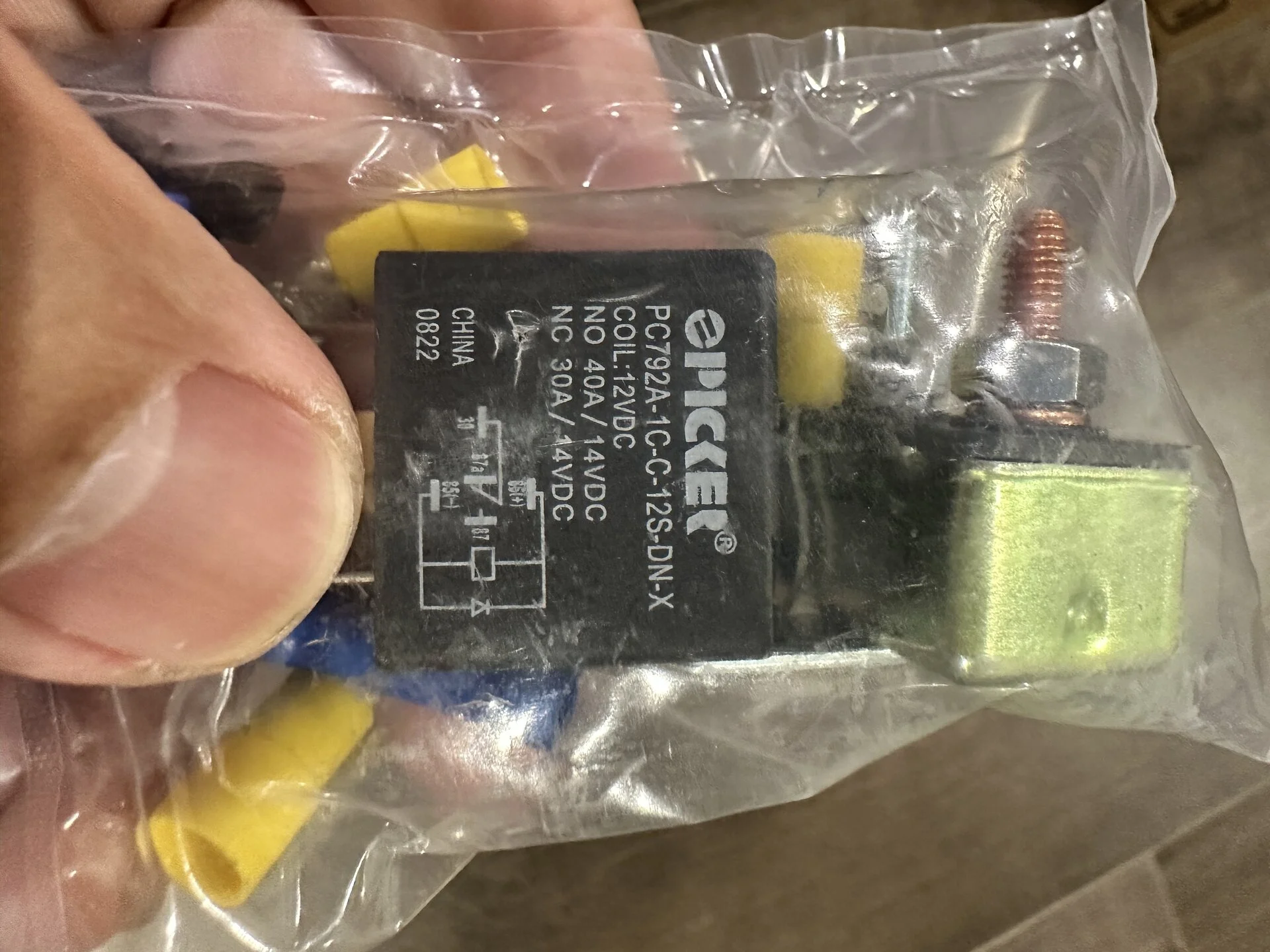

Painless relay kit
  1. SPST 40 Amp relay
  2. 30 Amp circuit breaker
  3. Relay base with harness (6' input, 4' output
Thank you!

You asked: How do you make an override OFF so the fan will not run when the vehicle is not running regardless of AC pressure?
You could use a power source for your fan relay that is only energized when the ignition is on.
I'd probably wire the relay to constant 12v power and use a 3 position switch, wiring one position for always on, one position for always off and one position for "normal" (thermostat controlled electric fan) behavior (on vehicles that come stock with electric fans) - so it can be used to continue to cool the engine even while the engine isn't running when it is too hot.
I wired a former rally car like this and it gives you lots of options.

I came up with a plan to do all of this using an ON-OFF-AUTO switch. I can dig up all the diagrams later tonight if interested.

I’m running a 100 series fan
The one you posted looks pretty thick it may not fit between the grill and the condenser?

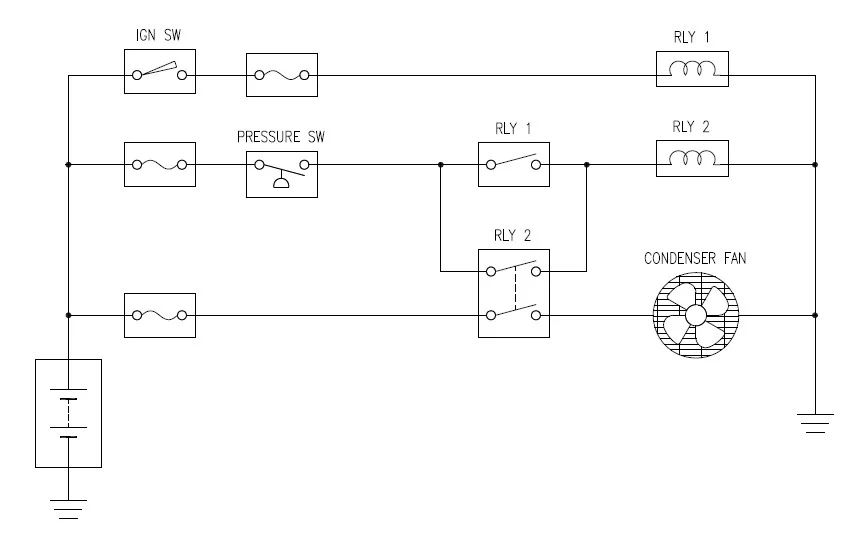

OK, so here's the basic concept for an automatic CDS fan that will only start if the ign key is on.
It will continue to run after the key is turned off, until the pressure switch opens.
Thanks to some extra relay logic though, the fan will not automatically re-start when the key is off
This diagram just shows the concept, laid out for your 6 year-old inner child to wrap his head around.
in this diagram, Relay-2 is shown as a double-pole relay for simplicity.

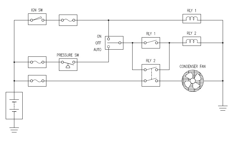

Now here's the same concept, but with an ON-OFF-AUTO switch added.
Thinking about how to implement this though, the actual wiring would look more like this.
With this arrangement, two small-signal relays are combined into a single module that gets wired into the dash, and only two wires have to run out to the engine bay.

Thank you for spending the time, will have to study this and find a good 12V ignition wire to tap into!

The CIG fuse circuit would be a good source for the control relays.
The fan relay switches power directly from the battery.
No personal experience, but those sorts modules don't really have a great rep for reliability, especially for an automotive environment - dirty, temp extremes, vibrations, etc...
I was actually suggesting creating your own module using relays of your choice.
Good to know though.
