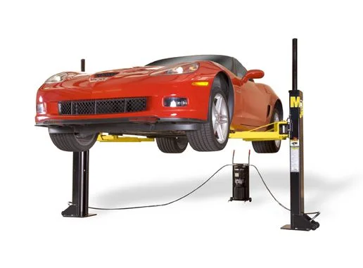

Hi - does anyone have any experience or opinions on this Danmar auto lift for garages with low ceilings? Danmar MaxJax Lift
Hey Randy
Does the red car come with it?
Interesting idea, but I'm wondering about the maximum lift height of only 52". The frame on my pickup is already 23.5" above the floor, so in my case I'd only get about 28" of lift out of it before I'd be at the max height. That would be great for doing stuff like brakes and knuckle jobs, but not so much for working underneath, dropping a tranny, etc. Not sure it's worth the effort and expense.
Heya Ken,
Regardless, I don't see you or me in a red 'vette :rolleyes:.
Good point on the lift height. It would be great for wheel swaps, brake work, tranny swaps, pulling body of frame, and getting under the rig on a rolling stool rather than a creeper. Might be worth it for someone that maintains multiple vehicles or is into a restoration.
